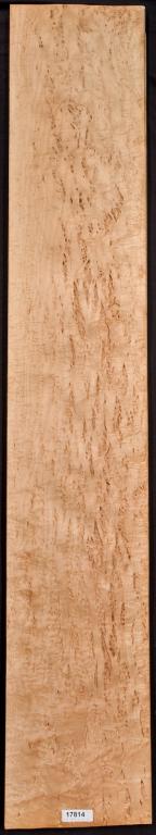

      Ordered freak maple burl veneer from Joe Woodworker. Similar to this, but a bit shorter so less waste.
      Click image for larger versionName:	maple freak burl.jpgViews:	1Size:	19.7 KBID:	860002

        Ordered freak maple burl veneer from Joe Woodworker. Similar to this, but a bit shorter so less waste. http://www.veneersupplies.com/produc...s-Per-Lot.html
        Starting to see light at the end of the construction tunnel.
        Holy crap - that looks like some special veneer. Going to be interesting to here your experience with laying on that :-D
          #274
          I bought a gallon of veneer softener to go with it.

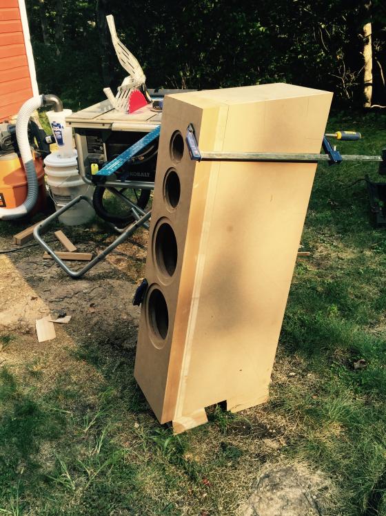

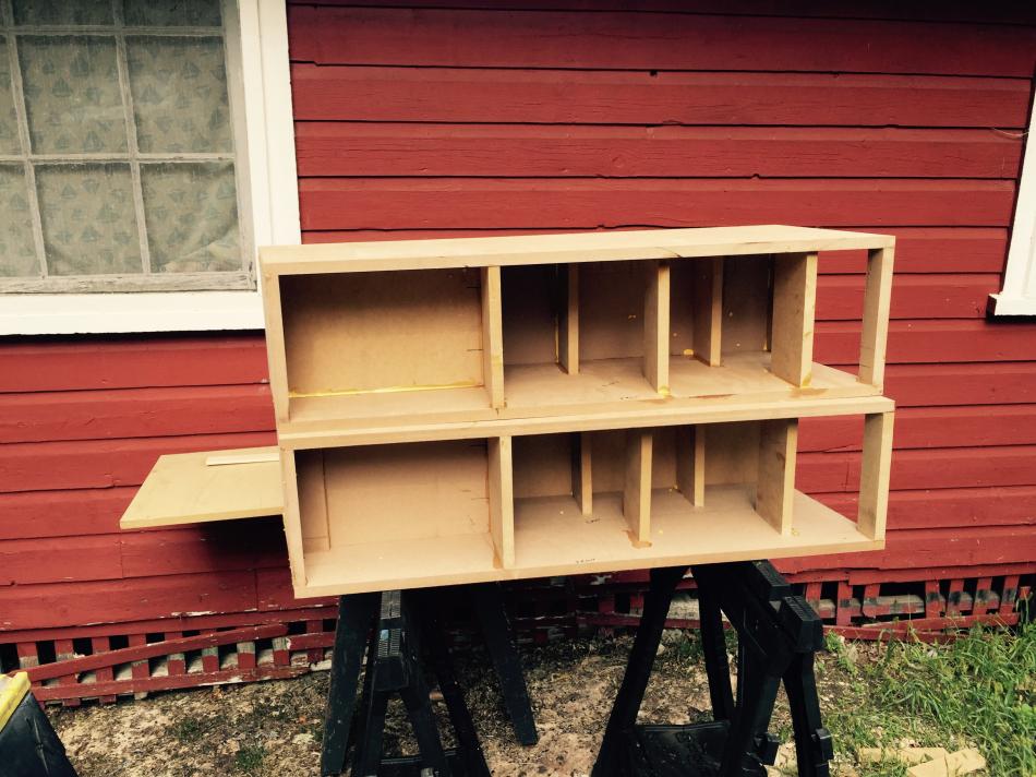

            Originally posted by BobEllis

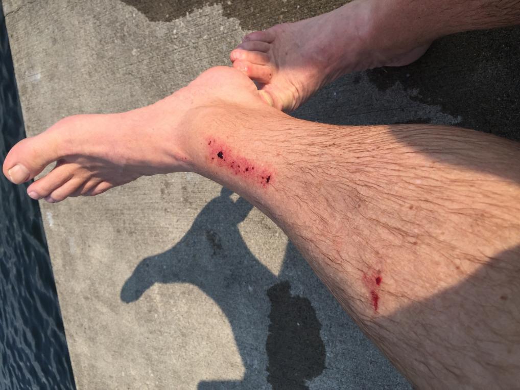

            Progress again. Both cabinets assembled and braced. Baffles cut to length and 10°. That part was interesting because as I started assembling a crosscut sled I realized that I didn't have the depth of cut needed to cut the baffles if they were on top of the sled. Luckily I had enough extra baffle length to make a few practice cuts to hone my technique. Overall it came out pretty well considering the flimsy miter gauge that comes with my saw. I will probably take the week after Labor Day to cut facets and attach baffles. My back doesn't like the lifting or bending over, so it goes slowly.
            Click image for larger versionName:	image.jpgViews:	1Size:	102.2 KBID:	859995
            Click image for larger versionName:	image.jpgViews:	1Size:	101.0 KBID:	859992
            Yes, I used a rip blade to cut the baffles and trim to width, figuring there's no way I could push an 80 tooth blade through 3" of MDF
            Click image for larger versionName:	image.jpgViews:	1Size:	101.2 KBID:	859993
            By the way, it's always a good idea to maintain a firm grip on the cabinets when moving them. At least the cabinet was undamaged. The lake is one of the many distractions that have slowed progress on this project.
            Click image for larger versionName:	image.jpgViews:	1Size:	100.9 KBID:	859994
            Ouch! That's gotta hurt! BT, DT. :W
            But you're making a lot of progress, Bob.
              Pretty nice looking stuff, the veneer softener is not just a good idea, it's likely mandatory with stuff like this. I used a ton of it on the first Ardent build.

                This is going to be an interesting first raw veneer project. I've never been one to make my learning experiences easy.

                      Not sure why it's called freak. Compared to other maple burl veneers at the site it's got more color variation and range. He has dark, light and freak. Wood turning supplies seem to call it a freak burl when it's darker than normal. I chose it for the color mainly. The size and girlfriend approval were nice bonuses. I ended up buying the rest of what he had so I can do the wavecor version and center channel consistently.

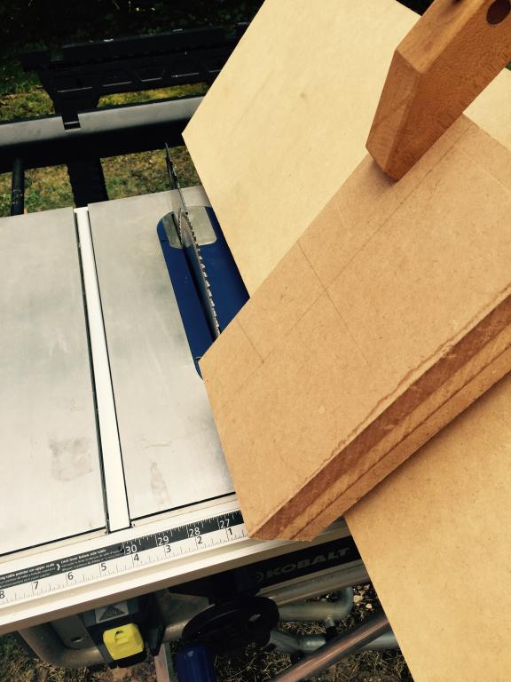

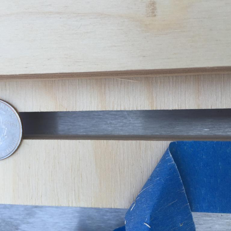

                        Dynamic Saw update.
                        Putting this blade back on the saw I couldn't help but notice how much sharper the teeth feel than my nearly new Freud glue line rip blade.
                        Cuts in Baltic Birch are essentially tear out free. I cut with and without painter's tape and it seems the tape pulled up as many splinters as it prevented.

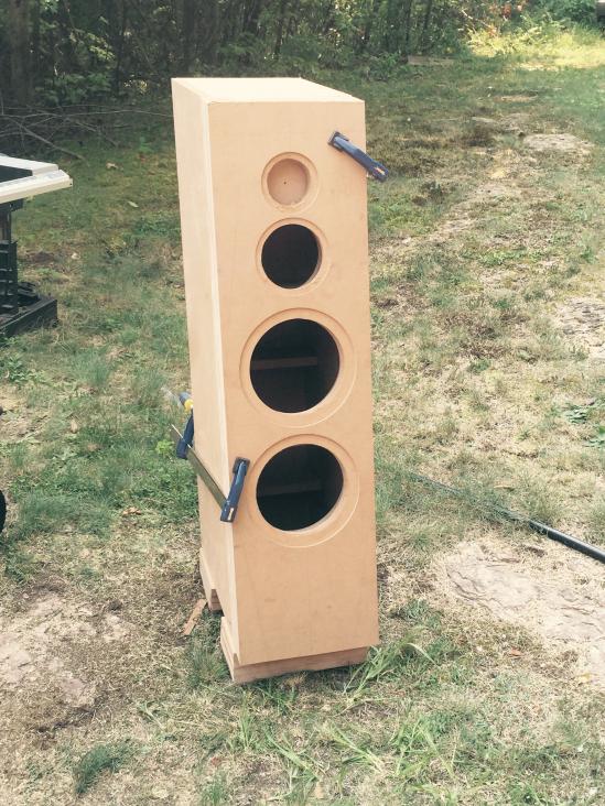

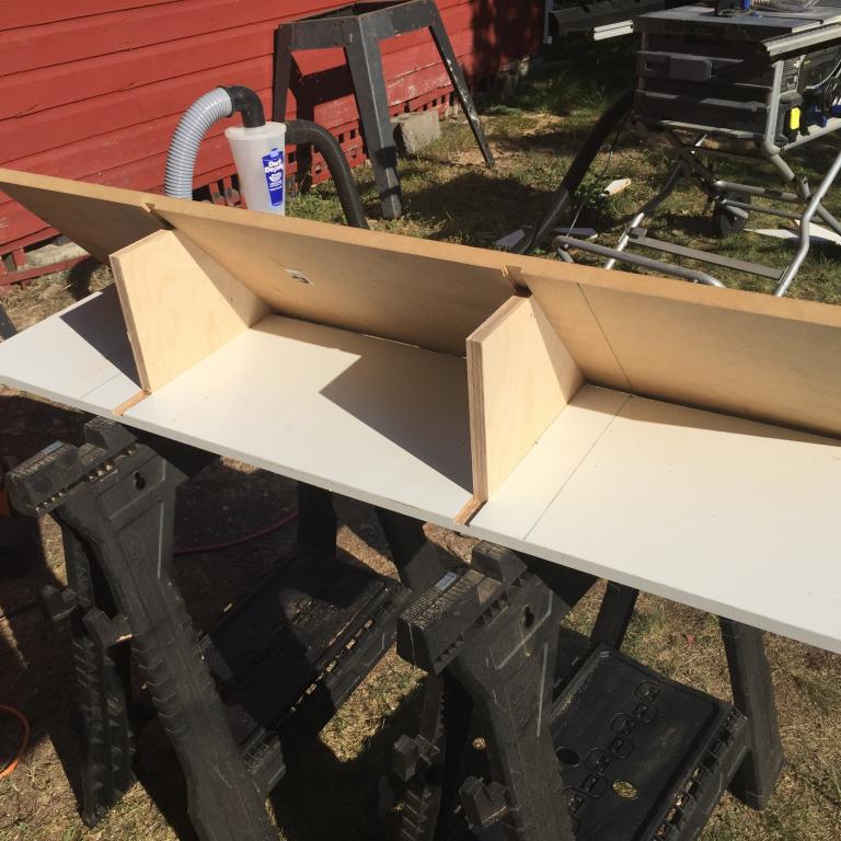

                          Facet jig dry fit. That 23/32 router bit cuts the perfect slot for 18 mm BB ply.

                            It's weird how many strange bit sizes I've acquired just because of things like that-- generally, they are for matching metric dimensions with imperial tools.
                            Cool that the new blade is working out so well... might have to look into that for my funny not so small small speaker.
                            OK, went hunting for that, you clever fellow, you're using a laminate blade (I've used that trick with other brands in the past...

                              I'm not that clever, just following their recommendation for BB ply. Although looking around that seems to be the consensus on geometry for smooth cuts in plywood. It also matches the article Ron shared with us. I replaced a Freud ultimate cutoff blade that did almost as well when it was new. The main geometry change is the Freud has a higher hook angle. It will be interesting to compare them once I get the Freud back from sharpening.

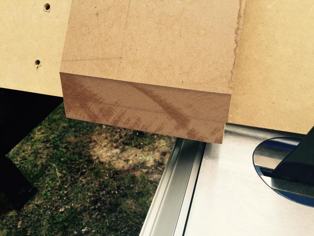

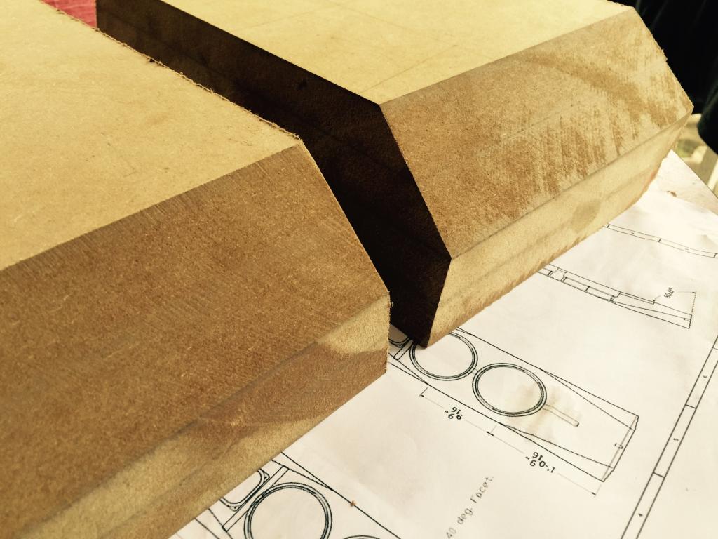

                                  A bit of progress. The weather guessers predicted rain arrival was only off by 18 hours. At least it came with a boom at 0200 and I was able to get things inside without significant damage. Lesson learned the hard way (again).
                                  The facet jig fits together so snugly that I decided not to glue it. Drywall screws hold it in together. Test cut on a piece of baffle cutoff.
                                  On the left is a 45 degree cut using blade tilt. On the right is the cut on the jig.
                                  I might be able to get another 1/8 inch of facet width, but as you can see it ain't much due to the fourth layer keeping the cut off the table and I only have 3.5" maximum depth. This baffle will either go with small facets or I will make a router jig to hog off another 3/4" of material.
                                  My question is how to do it for the Wavecor build. I'm thinking cut the facets with just the outer three layers of baffle glued together which should allow me to cut the facets almost 3.5" wide. Or should they be wider? The drawing doesn't really define the width of the facets. Thoughts?

                                    #287
                                    There are a lot of methods to create the Ardent facet's.
                                    - Using a belt sand grinder, if I remember correct that what the gay fixing this for the "CNC-gang" did.
                                    - Use a (electrical) planer - I used this method on my Avalon inspired subs. Quite similar to the grinder method I guess.
                                    - Use a jig like yours, or a circle saw with angle support
                                    This is what I did on mine (Festool circle saw). I had the same problem as you have, the blade did not go deep enough to cut all the way through.
                                    I used the saw to cut as far as possible. Then I used a japanese saw to cut the last bit, and finally I sanded down anything not even enough.
                                    (the japanese saw has the tooths' on a straight line, so it makes a much nicer cut than a regular saw)
                                      #288
                                      Ah, an excuse to try a Japanese saw. Thanks TEK. I have a power plane, I may give that a shot, too.

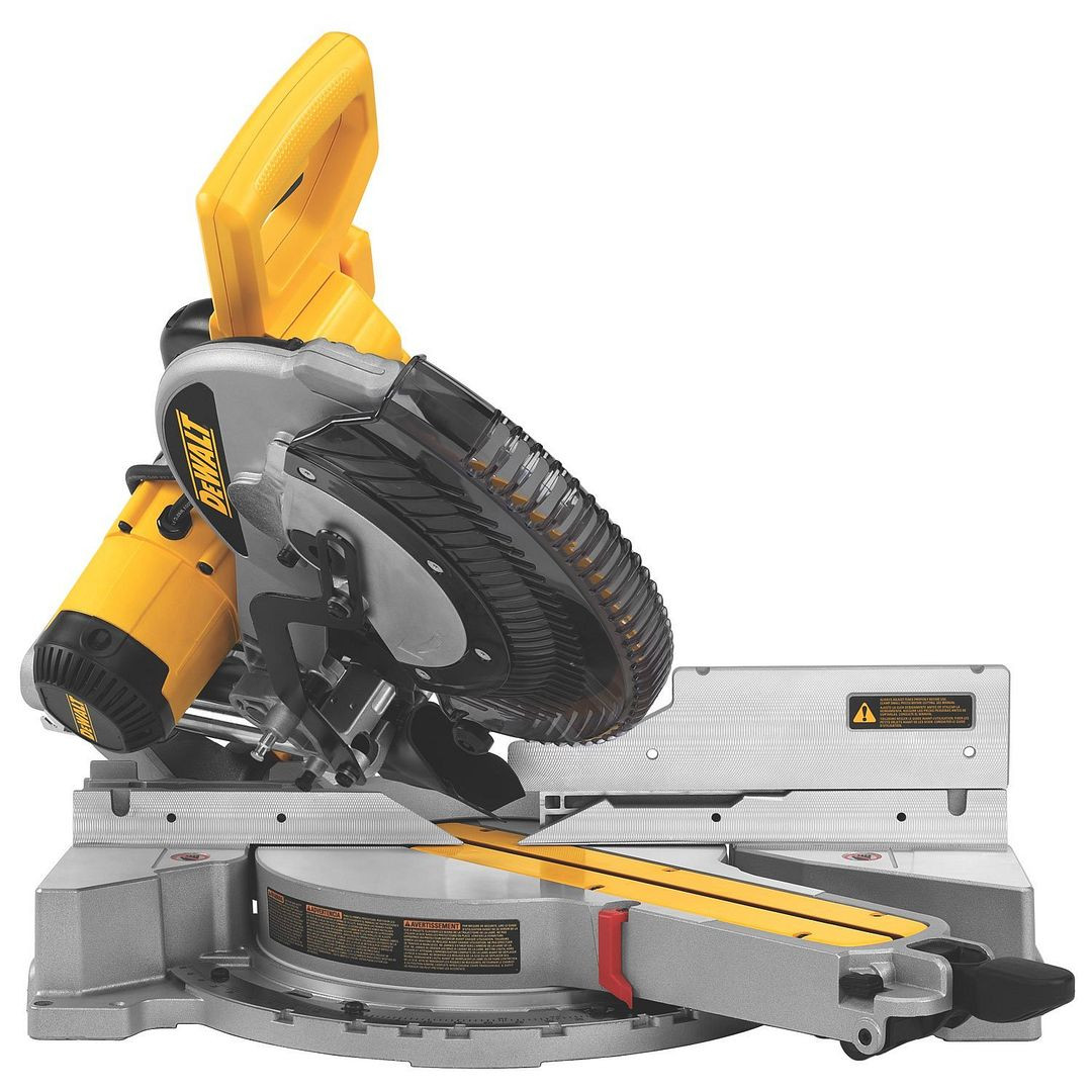

                                        Don't hesitate to consult the Ardent and Isiris threads. My 10" circular saw is a Ryobi/Craftsman, and due to the arbor and pulley design, cuts much deeper than most 10's- as deep as many 12" saws. For the Isiris, and it's even deeper facets, I used the DeWalt DWS780 12" compound sliding miter saw, setup for optimum depth of cut. I picked the DWS80 because it had a longer crosscut capability than any other comparable saw, including the big Bosch. It was/is well worth the money. It's almost like cheating...
                                        And on the worst of the cuts on the Isiris, I, too, used a Japanese hand saw to finish the last little bit...
                                        Last edited by theSven; 12 August 2023, 18:25 Saturday. Reason: Update image location

                                            Looking good Bob ........ I made a jig for my Bosch Trim router that does exactly what you are describing for the fourth layer. If your interested I can post some pictures, I also have a drawing with dimensions and all that stuff.
                                              #292
                                              So a proper upper facet reaches the fourth layer? How wide should the baffle be at the top where top and side facets join? How far up is this edge from the center of the tweeter? I'm working in really flaky cell coverage where a page can take minutes to load so it's hard to look things up. I can get a decent signal at the lake but that tends to end work.
                                              Early on in this thread a kind soul posted a router jig for cutting facets with a straight bit acting as a plane. That seems pretty straight forward once I get a router table insert to use as a base.

                                                If I was doing the facets,
                                                For the MDF version cab I would cut with your jig and finish with any hand saw. You can use some belt sander paper attached to the face of a long flat board to true up the cut with the table saw cut. This is not much work with the softer MDF.
                                                The BB end grain will be tougher so I would try a few passes with the table saw and jig increasing depth till your saw maxes out. The router with same angle jigged can plow to finish the cut very close. I didn't have to try but that was my thought if we had to go this route.
                                                The table saw jig we used had 2 different bases with apposing tapers that could be flipped around to line the jig with the saw fence differently depending on what facet was being cut. ( I'll get Ben to post our jig or give the taper angle). This allowed cutting from reference marks placed in the middle of the baffle on both sides of the baffle.
                                                The top of the baffle facet cut was cut first. Then marks to start the facet cuts on the sides were made in the middle of the baffle on both sides of the baffle. This is the reference on the drawing. 1'- 15/16" from the bottom for the bottom facet start cut and another 9 9/16" from the bottom for the start of the cut for the top side facet. Page 5 of the long thread kind of showing our guy with the panel saw using reference marks in the middle for 1 pass cuts.
                                                With the thickness of our baffle material cutting through all layers at 40 deg cuts there was 1/8" of baffle left to meet with the side of the cabinet at the deepest point. If your baffle thickness is greater you will just have more material to meet the side of the cabinet. If less or like Tek you change the angle you will not flush with the side of the cabinet. The angle you cut determines how close you get to the driver holes so you can't use that as a distance reference unless your widiling to get there closer then us.
                                                I would try a full facet cut attempt with the MDF on scrap and finish with the saw to get it down then go to your MDF cab.

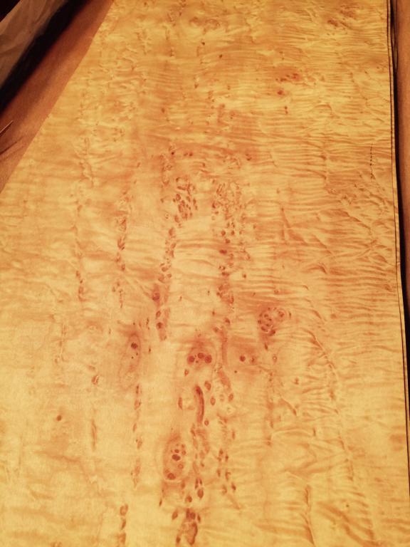

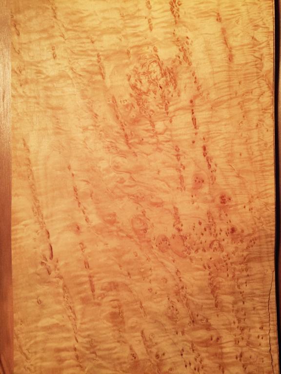

                                                  Veneer arrived. I'm happy. Surprisingly flat right out of the box.

                                                    Nice, and your another brave soul with the raw.:T

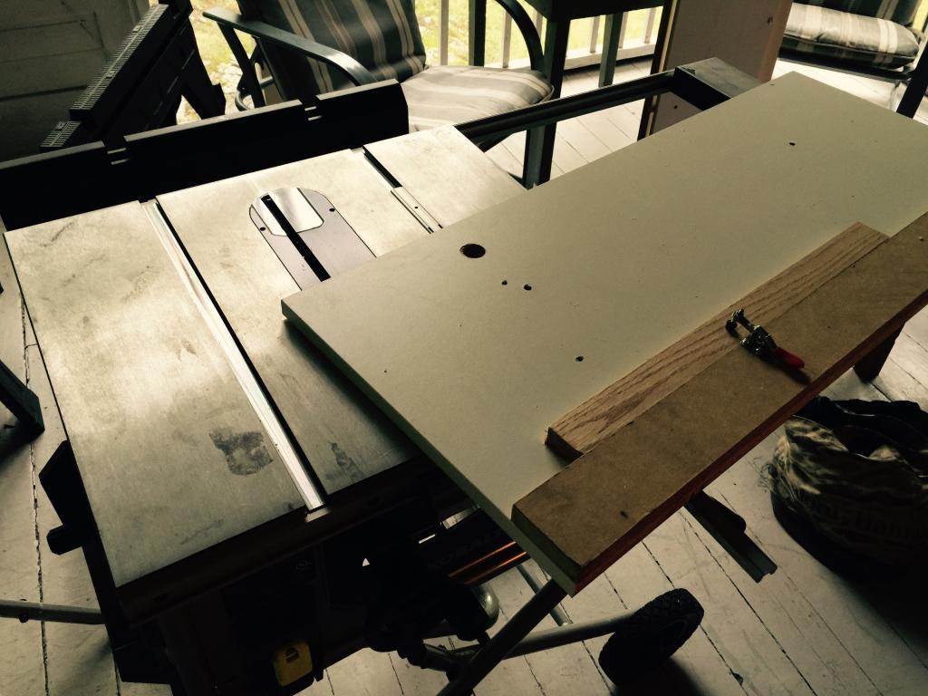

                                                      Crosscut sled for top and bottom cuts on sides. Rain kept me inside so I couldn't cut the end. Incra 24" slide.

                                                                                    #311
                                                                                    Thanks for that input.
                                                                                    Click image for larger versionName:	image.jpgViews:	1Size:	55.8 KBID:	860019
                                                                                    Click image for larger versionName:	image.jpgViews:	1Size:	57.1 KBID:	860020
                                                                                    Looks like great stuff, Bob!
                                                                                      #312
                                                                                      Thanks for the vote of support, Jon. I'm sitting up here at 62 degrees hoping it will get warm long enough for me to get to the epoxy steps. The forecast is to return to the 80s next week but then cooling so I have to get cracking.
                                                                                      I'm really happy with the way the veneer looks and perhaps more importantly my girlfriend thinks it's wonderful, too.

                                                                                            Frequent rain kept me from working on facets, but I made a little progress on the Wavecor build. All panels laminated, ready for final trim to size and rabbets/dados. The sides:
