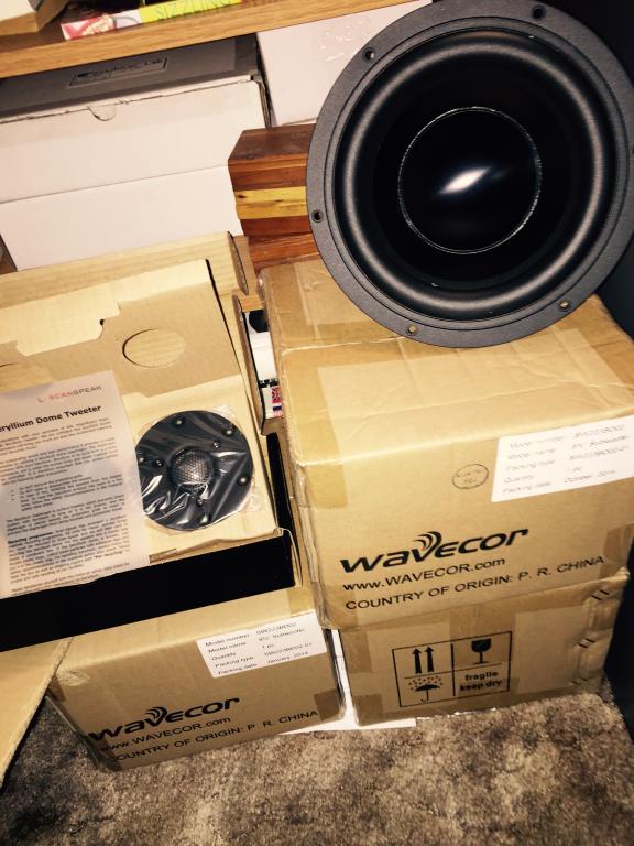

                                                              Bringing this thread back from the dead. Life has interfered with speaker building. I spent the day tuning my saw - mostly removing rust, lubricating and adjusting after many years of disuse. Next weekend I should be ready to start cutting panels for the Poor Man build.
                                                              In the meantime, I have received my drivers for the original Wavecor Ardent build, using the 002 woofer. Must resist temptation to start that too soon until my skills have recovered from lack of practice.
                                                                #211
                                                                Without pictures, I'm not sure we believe you have any Wavecor drivers.
                                                                  #212
                                                                  OK, I should have expected that... Transducer labs ceramic tweeters and C79s in the background
                                                                    • 16072
                                                                    #213
                                                                    If there are pictures on the internet, then it is real! :W :B :T

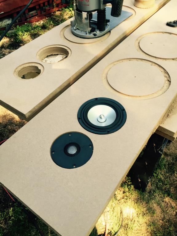

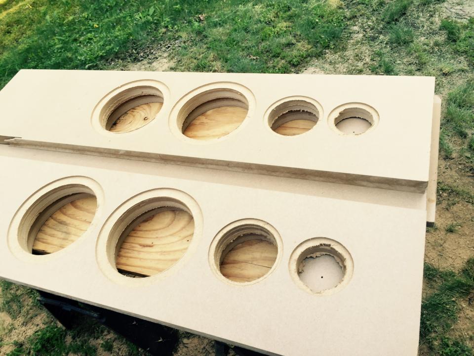

                                                                                  Finally, some progress. Baffles routed for SS6600, ZA14 and RS225. I glued up inner and outer layers before routing. Still need to chamfer the ZA14 openings, but didn't have a suitable bit with me.
                                                                                  Outdoor work is interesting - focusing muscles aren't the only ones that get slow, weak with age. Going inside to change bits and get dimensions of the next cut took a long time to adjust.
                                                                                  Obviously that's not a 6600 in the tweeter recess, just seeing how a 27TBFCG looks if I decide to stay with things I already have.
                                                                                  I'm glad I went practice route first. This did not go smoothly. I used a 3/4" straight bit to do the recesses so it took several tries to get it right. I didn't have the Jasper Jig formula with me, but I was off about a 16th just subtracting the additional radius of the bit. Then I used a cheap digital caliper to measure the ZA14. Inside and outside measurements differ enough that the driver didn't fit the first attempt. Going the PMazz suggested route and using templates and a pattern bit for the good build.
                                                                                    • 16072
                                                                                    #221
                                                                                    That's not a bad idea at all... though I'm reasonably handy with the jasper jig and a caliper, it still comes down to measure three times, route once... if it all goes well!
                                                                                    Well, I'll have some more practice coming up soon, routing test baffles for driver testing. I'd better tally up the number and types of drivers to test- I have three spare front baffles for the 0.75 cu ft PE box, but that may not be enough at this point!
                                                                                      #222
                                                                                      I'd have thought I'd be OK with a caliper, too. But, the too small recess still measured "big enough". I guess it depends on the meaning of zero...
                                                                                      As long as I use the standard 1/4" bit the Jasper gives me the size I expect. Maybe a downward spiral for the rim then use the straight bit to cut a flat for the mounting surface. Test cuts and learning coming up.
                                                                                      Looking forward to your test results.
                                                                                        • 16072
                                                                                        #223
                                                                                        My trick with the Jaspar is NOT to use their calculation, just to use measurements. So, after mounting the router and the bit I want to use, I pick the hole that gives me the needed radius between the jig pin and the outer edge of the bit. Just measure it with a steel rule, and I mark my own radius hole locators, because I'm virtually always using a 3/4", except for the spiral bits- again, just measure from the bit edge you're using to the pin locator that gives the right radius.
                                                                                        Don't need no 'rithmetic... :W
                                                                                        • Renron
                                                                                          • 751
                                                                                          #224
                                                                                          I always get it close enough with jasper jig #s, then test it on scrap mdf. You don't have to plunge more than 1/16" deep to determine the correct diameter. Adjust the pin as needed. If you start out on the small size you can even use the same hole.
                                                                                          Very quick and cheap way to get a perfect size every time.
                                                                                          Especially if your bits have been resharpened.
                                                                                          Ron

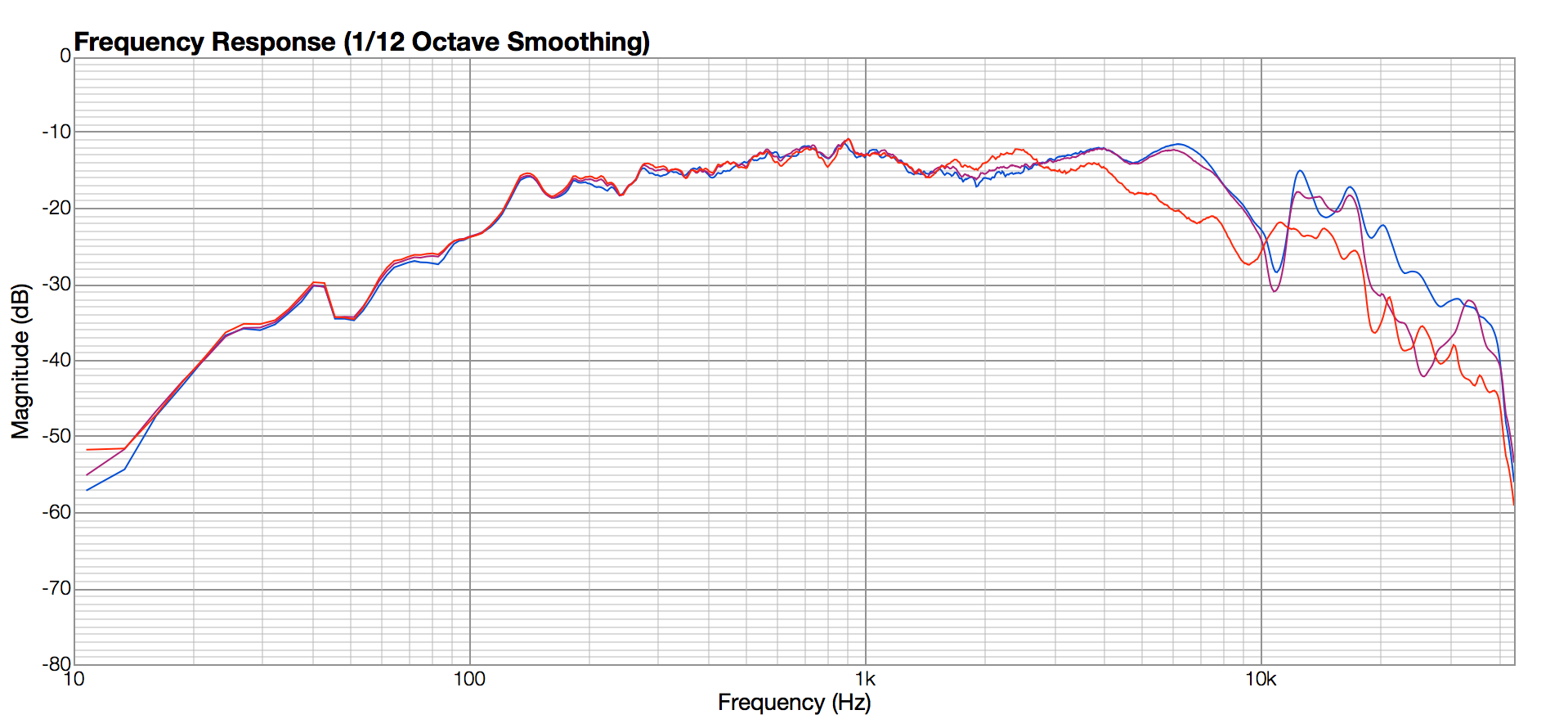

                                                                                            OK, have the data now for the ScanSpeak 12MU4731- have FRD and ZMA files, too-
                                                                                            First, a composite set of curves at 0 degrees, 15, and 30:

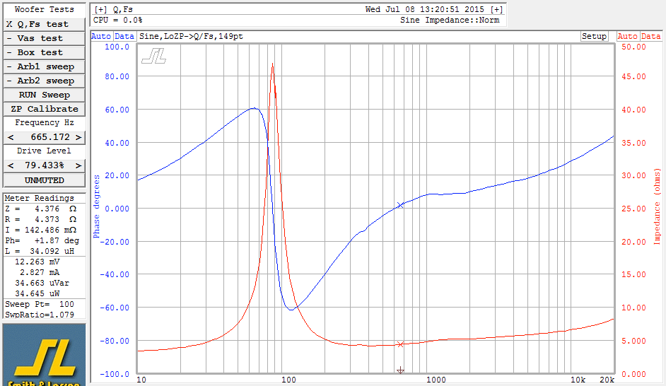

                                                                                            Here's the impedance curves- point to a fairly clean motor with good inductance control:
                                                                                            It will certainly be easy to work with, as regards crossover filter- no undesirable gyrations.

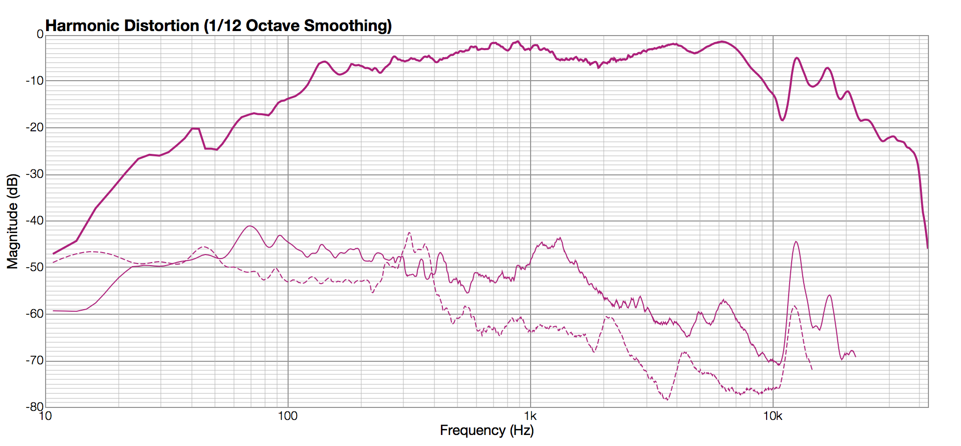

                                                                                            Here, we have a look at distortion- standard 2.83VRMS drive, for comparison to my other measurements:
                                                                                            A fairly typical SS profile- somewhat higher 2nd order, but pretty good performance on 3rd harmonic. This points to doing a crossover on the low end around 600 or above, which is no problem with the current Ardent design.
