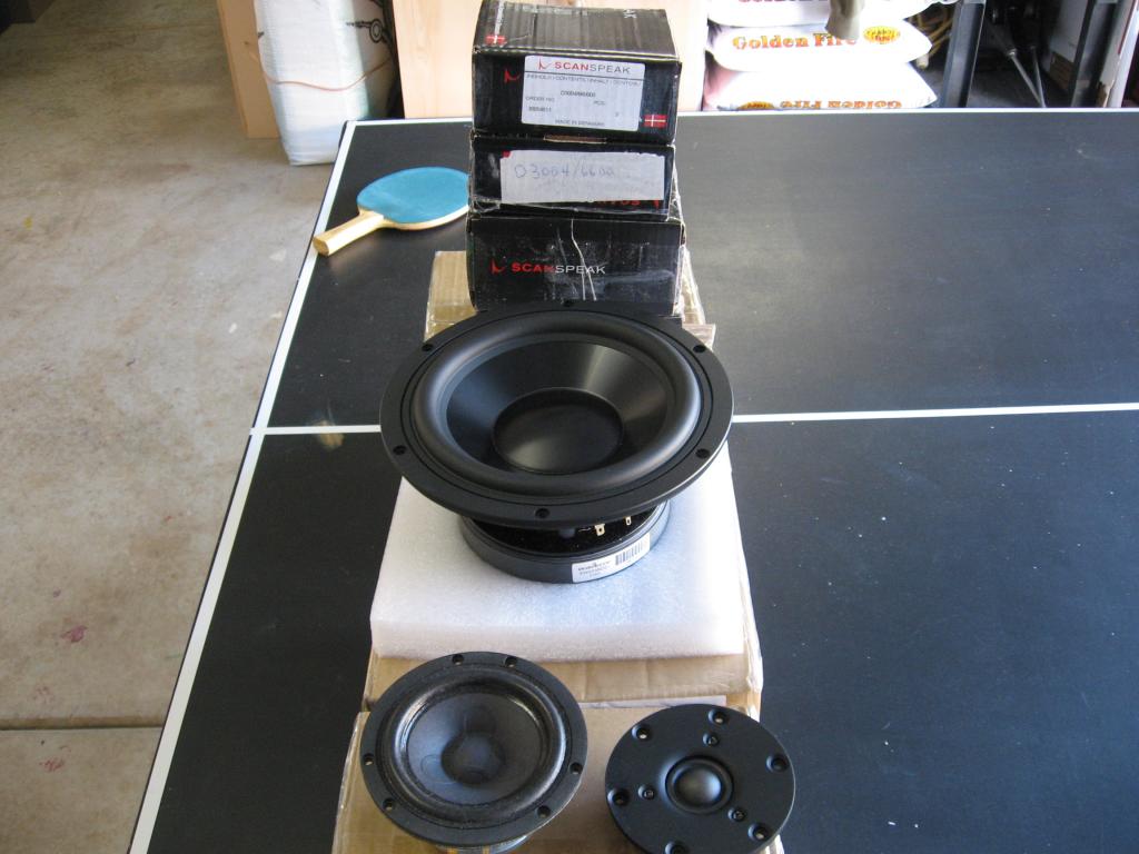

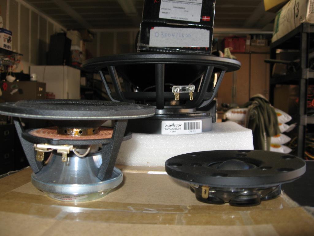

            Solen Canada has the Wavecor drivers on sale..............I bought 4..........so much for "Poor Man's Ardent". Now I am a poor man, but with excellent drivers for the Ardent!
            SS 3004/6600 Tweeters
            SS 12MU/4731 Mids
            Wavecor SW223BD01
            8 week wait for shipping because they only had 3 on hand. I'm in no rush.
            Only the Tweeters weren't on sale, fate saw my refund check and decided to give it to Solen.

              12mu/473100
              Thanks for the encouragement Bob, Jon, and 5th Element.

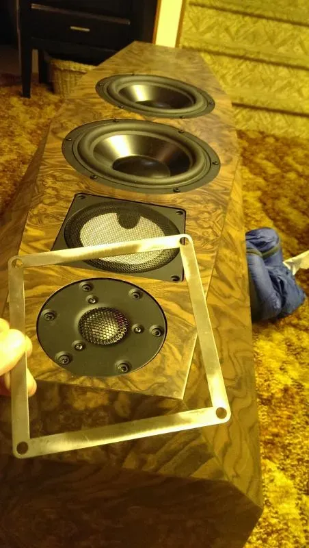

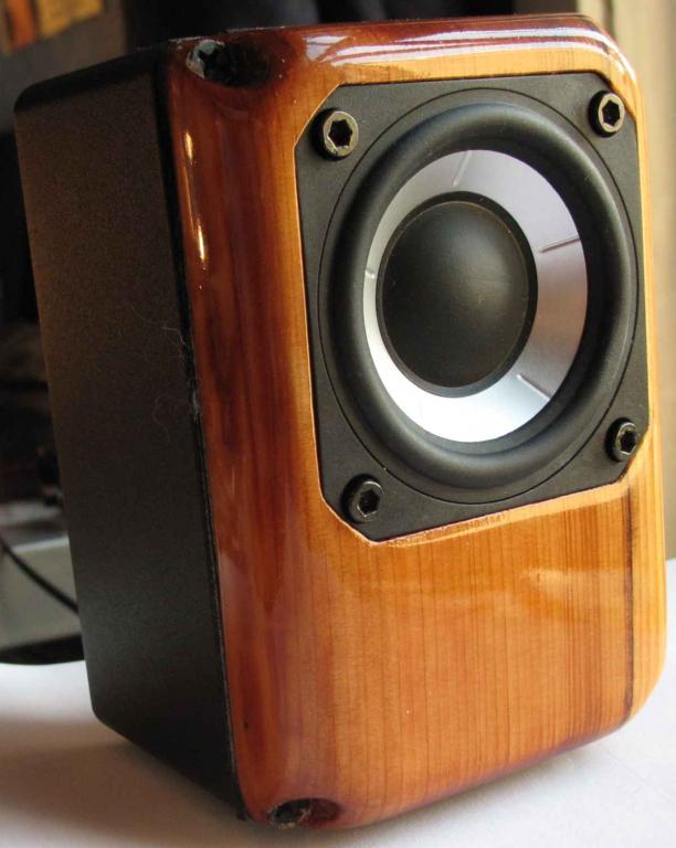

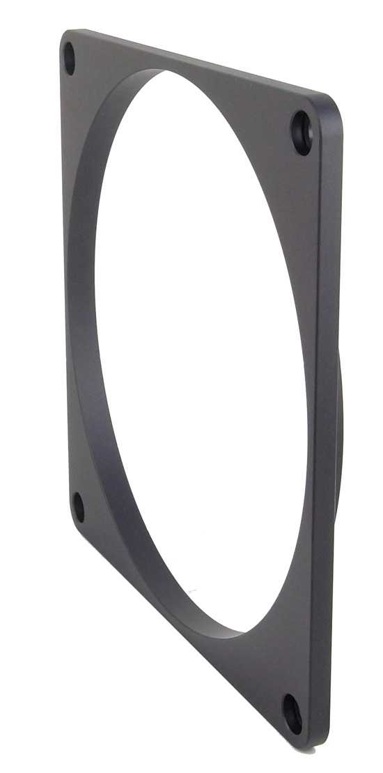

                        Interesting, 5th. I was thinking along the same lines. With a C79's 130 mm faceplate and any standard tweeter, that gives you 120 mm between centers and pushes the crossover frequency down to 1440 Hz even if the drivers touch. You lose a little more with TL's round tweeters at 120 mm dia. I suspect that we get a little slop because the drivers are not point sources, I wouldn't go as far as to use the space between the radiating surfaces as the distance, but I think we can go further apart than center to center distance would indicate.
                        Anyway, these are nice to look at, still hoping for unseasonably warm weather to let me do something with them. I'm thinking that I can get away without flush mounting since I won't be going grill-less and need felt anyway. I may need to rig up something just to test them for function.

                          Well indeed the vertical off axis response is usually seen as largely secondary to other design criteria, but most designs get sloppy even with the horizontal off axis response, which imo, is a complete no no. Either use a tweeter that will allow you to cross lower enough to avoid midrange beaming, or use a wave guide and a suitable mid range that allows you to cross over high enough for a good directivity match. Of course using the wave guide will increase the C2C distance and as a result the vertical off axis response will deteriorate but that's a decent price to pay.
                          I know that the thought of flush mounting those square frame drivers is probably giving you nightmares but really you should investigate ways of making that happen. Not flush mounting always causes diffraction problems that you really don't want to deal with. When designing a crossover it's all those little wiggles and bumps that deviate from what would be normal that cause problems.
                          One of these would work well but you'd have to protect the drivers whilst creating the initial template from them. For the Accuton this would be very easy as all you'd need to do is tape up the front side to prevent dust from getting in and tape up the rear for similar reasons. The TL tweeter would be a tad harder as you'd need to protect the dome, but using some stand offs would be an excellent way of doing this.

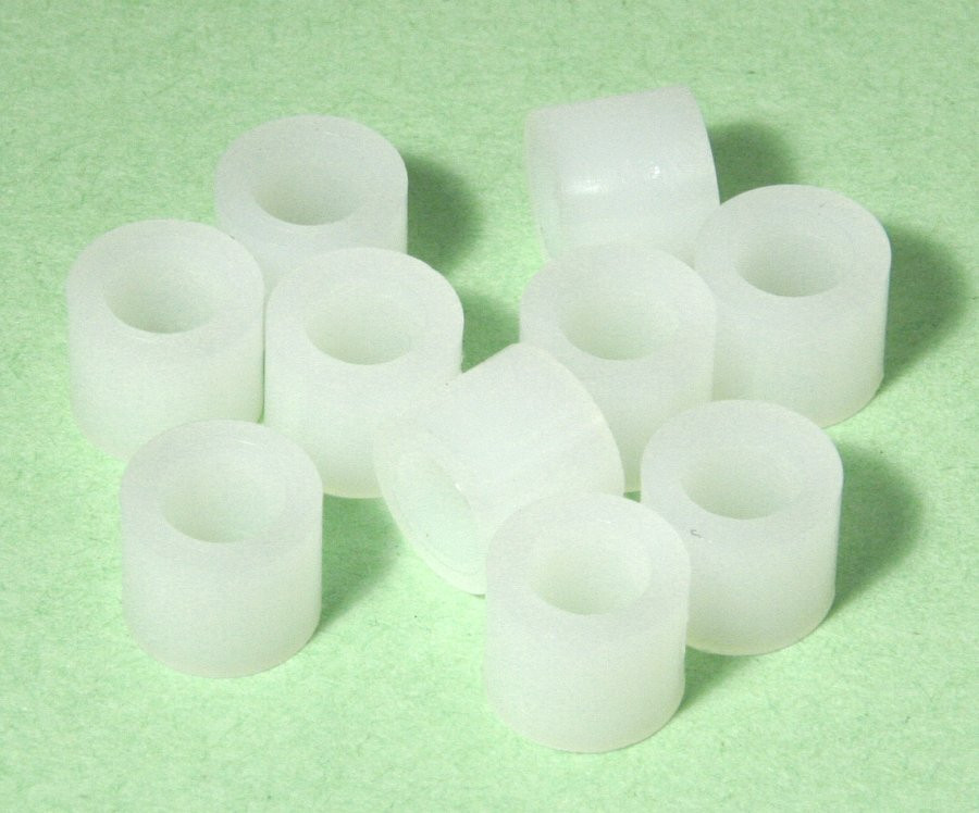

                            I suppose a bit more explanation to how I do this would probably be helpful.
                            The first thing I do is take the loudspeaker and clamp it, by the magnet, in a vice. The second is to attach a 6mm piece of MDF to the topside of the driver with bolts through the drivers mounting holes. The piece of MDF should overhang the size of the drivers frame by a few mm, say 5-10mm. You will of course need to countersink the bolt heads into the MDF so that they do not protrude up at all from the MDF itself. To keep the piece of MDF away from the driver itself you can use standoff/separators like these.

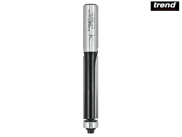

                            You then take the router and lay it on top of the piece of MDF and use one of these bits.
                            And use it to follow around the faceplate/frame/basket of the driver. This will create a template of the drivers frame out of MDF.

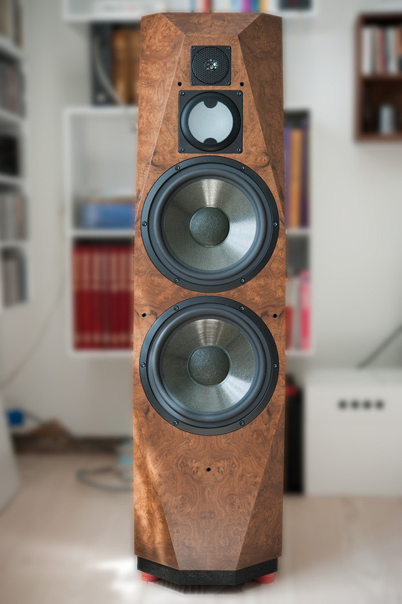

                                              Any pictures of a Dark wood Ardent?
                                              Ardent TS

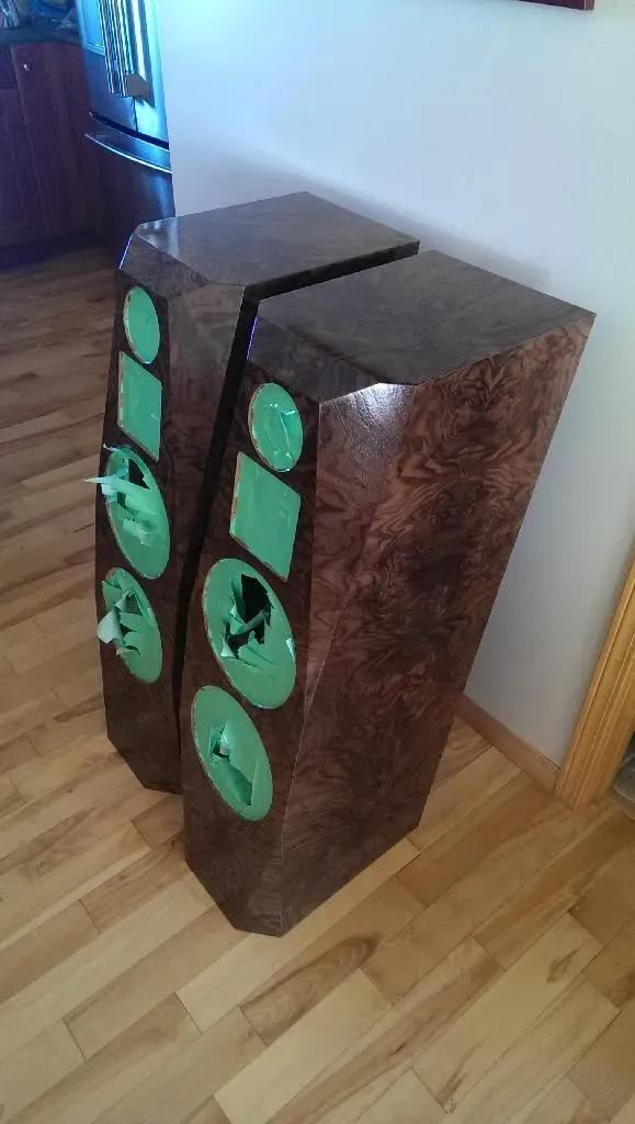

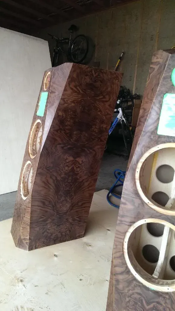

                                                  Ben has his Walnut burl Ardents up and running but they are in a dark basement and he hasn't had time too take great shots yet.
                                                    #160
                                                    Ron, somewhere in the Ardent thread are some shots of a cool walnut burl.
                                                    I'm going with 4 layers of bamboo on my good baffles, for a total of 3" Since I can't see how to get facets wider than 3.5" with a table saw, that is plenty of depth. Unless I go for the router method mentioned earlier.
                                                        Just to clarify; I speculated that I may not be able to hear the difference between the materials used in ours and ones made of MDF. I haven't actually heard a version made from MDF
                                                        I'll dig out my flash and try to take a decent picture this week. In addition to hideous wood paneling and carpet the basement of the house I'm renting has terrible lighting in the basement.
                                                        But these are what they look like more or less:
                                                        Last edited by theSven; 12 August 2023, 18:23 Saturday. Reason: Update image location

                                                                  Ben hasn't been very cooperative with providing nice pictures of his speakers, :W but these in process pics after the first pass on finishing isn't bad at conveying what to expect with a dark veneer like walnut burl.
                                                                  And below, an Avalon Time with a similar finish, in satin.
                                                                  White balance in color rendering is tricky if you take pictures under various types of artificial lighting, and Ben's pic above has a strong yellow cast likely due to that- either warm fluorescent or incandescent, with the camera set to daylight or shade.
                                                                  Last edited by theSven; 12 August 2023, 18:24 Saturday. Reason: Update image location

                                                                      Those are Friiiiiikkkkkkkiiiiiiiin Aweeesum !
                                                                      Thanks Doc!
                                                                      Ben those are beautiful, I am impressed!
                                                                      Ron

                                                                                    Sunday bump
                                                                                    The Driver fairy stopped by last week, aka the UPS driver. He brought me 2 packages one of which he used his hand truck for, ( I have a long steep driveway)
                                                                                    The smaller (and lighter) of the two, contained the Air-Circ tweeters and the 12MU/473100 mid drivers from Scan Speak
                                                                                    The hernia inducing box contained 3 of the 4 Wavecor SW223BD01 sub woofers I had ordered, Solen only had 3 in stock. I'm not planning on starting the build for a while anyway.
                                                                                    What surprised me is the weight of the Wavecor driver, This thing is built like a tank with a huge magnet hanging off the back. Underhung drivers just look cool. Same with the 12MU.
                                                                                    Jon, er....Doc maybe even E.T. , is that offer still available to send you one of the 12MU for testing? That would be great, as I'm still in the Red-Neck driver testing laboratory myself. I could not resist just trying it out! It sounded great btw in a 5 gallon bucket! Should have been flush mounted. LOL .
                                                                                    Nude driver shots follow.
                                                                                    Click image for larger versionName:	IMG_2998.jpgViews:	1Size:	81.5 KBID:	859598
                                                                                    Click image for larger versionName:	IMG_3000.jpgViews:	1Size:	76.7 KBID:	859599
                                                                                    Click image for larger versionName:	IMG_3001.jpgViews:	1Size:	84.6 KBID:	859600
                                                                                    Last edited by theSven; 12 August 2023, 18:38 Saturday. Reason: Update image style

                                                                                      I'm going to have to do similar testing with my C90s soon to at least verify basic operation.
                                                                                      Also, I'm a bit too scared to try Matt's template making with the C90, but then there is this to allow me to make a template and keep the drivers dust free. Mounting plate for the cell driver, appears to be identical shape as the C90 faceplate. Not cheap, but I feel a lot more comfortable.
