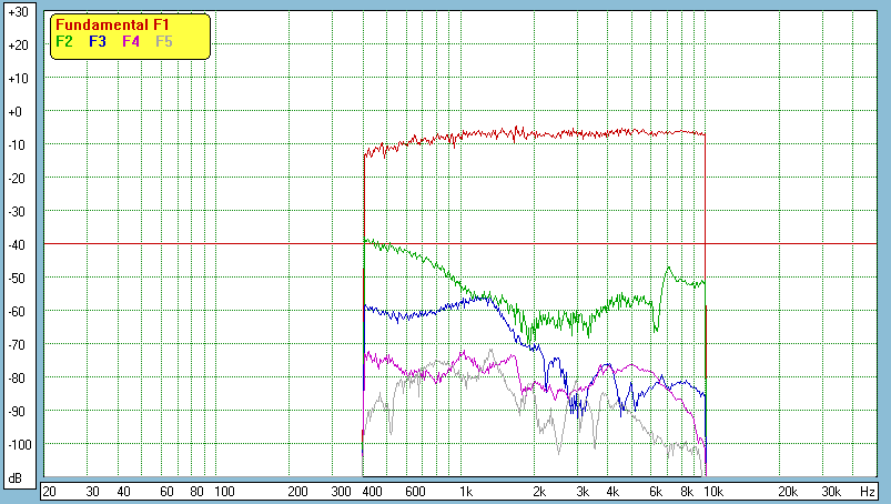

        A tweeter worth considering might be the Scanspeak D2604/833000. This is similar, in more ways, to the AirCirc than it is not. Same wide surround/dome shape, similar looking HD plots, similar-ish looking FR plots along with kinks in the top octave and high sensitivity...$50.

        If you can cross the 833000 over high enough, which you probably can in this design, it should be a pretty good choice. Yet another tweeter, oh joy!

                Good inputs. I don't have any experience with the 833000 though I have looked at it briefly recently, it came up in another discussion... and while I consider the Air Circ as "budget", now and then I have to be slapped up the side of the head to remind me that most folks wouldn't... thanks for the probie slap, I needed that!

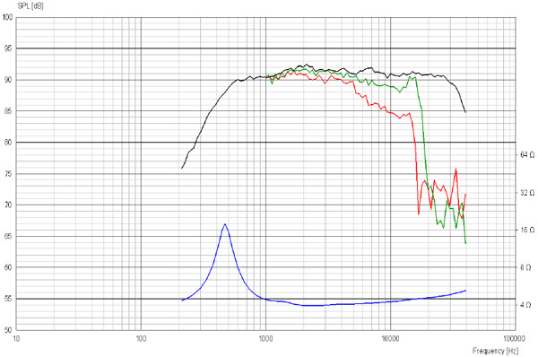

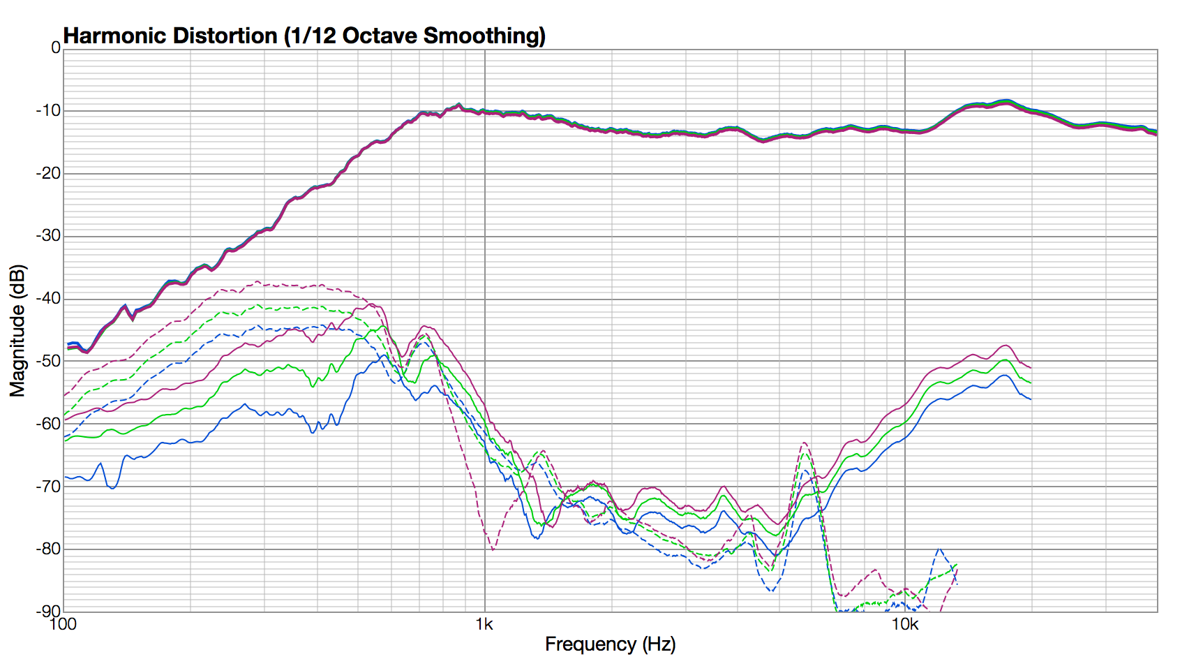

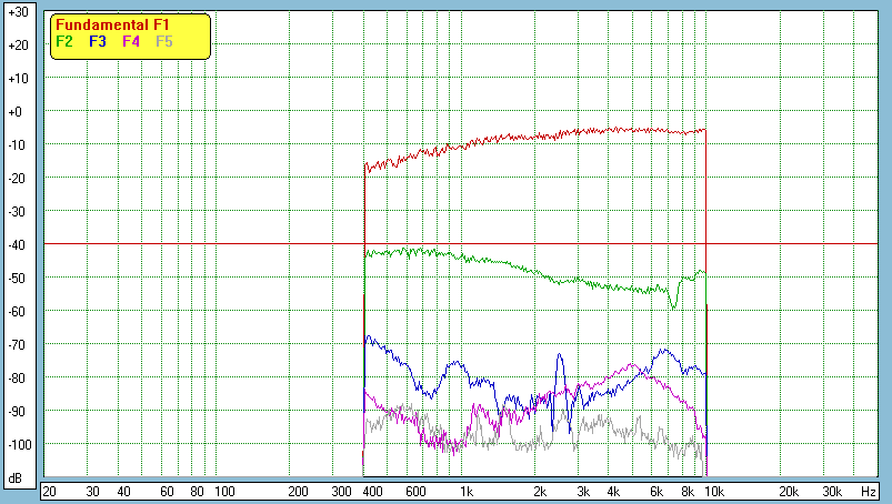

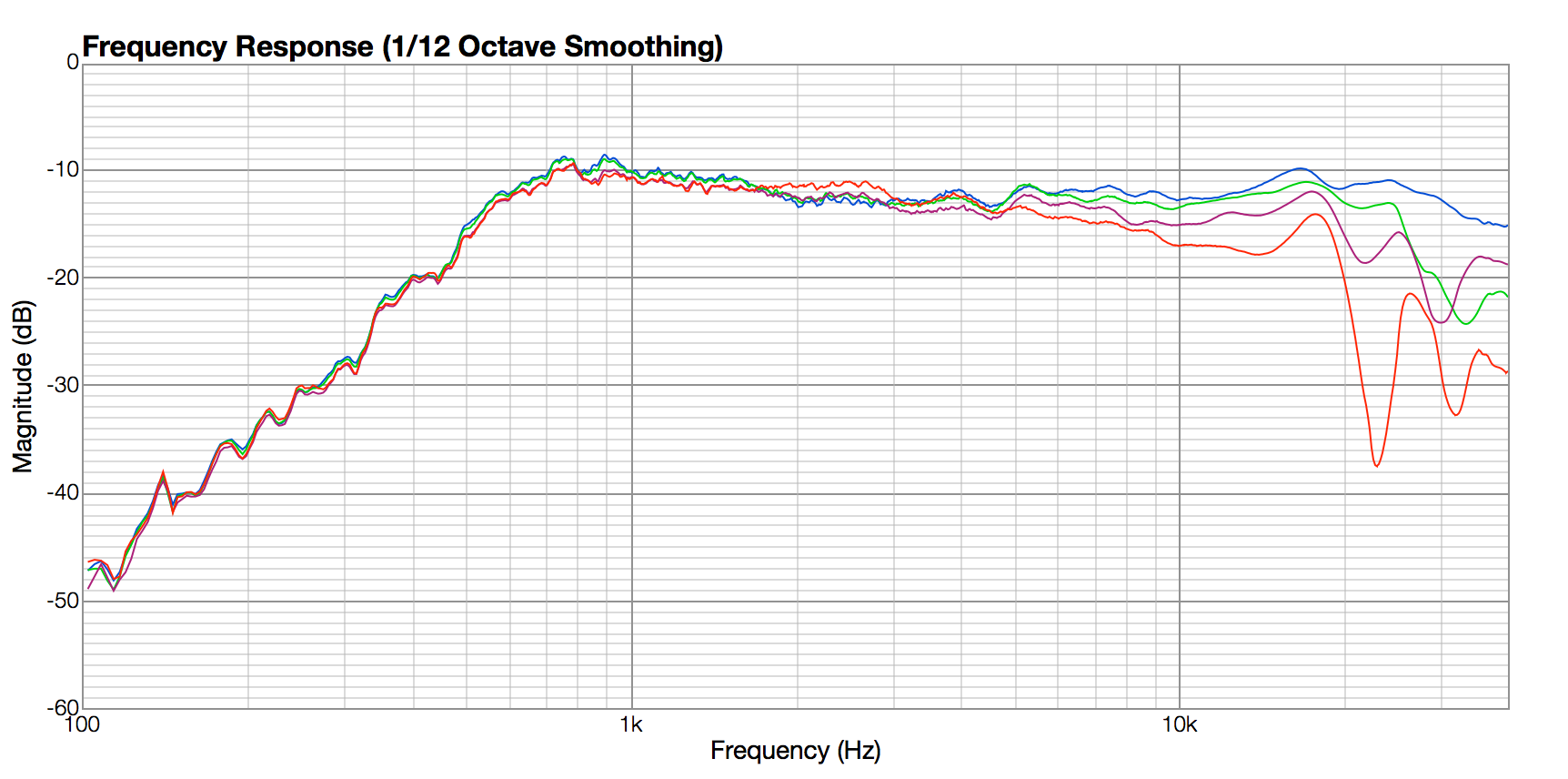

                With the transfer function in the Ardent, Zaph's distortion profile looks fine... but...
                Zaph's measurements and the factory measurements highlight why I haven't had more interest in this part...

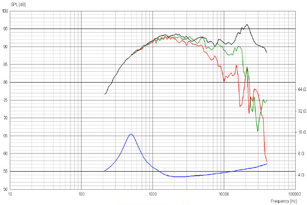

                That 5 dB peak in the output centered at 20 kHz. Now, yeah, it's a soft dome, and there aren't any resonance amplification of distortion products- but that same characteristics is what I tracked down to a big part of what bugged me about a rather pricey SS soft dome, the 6620, which didn't show that kind of behavior in the factory published curves,
                but did in my own measurements.

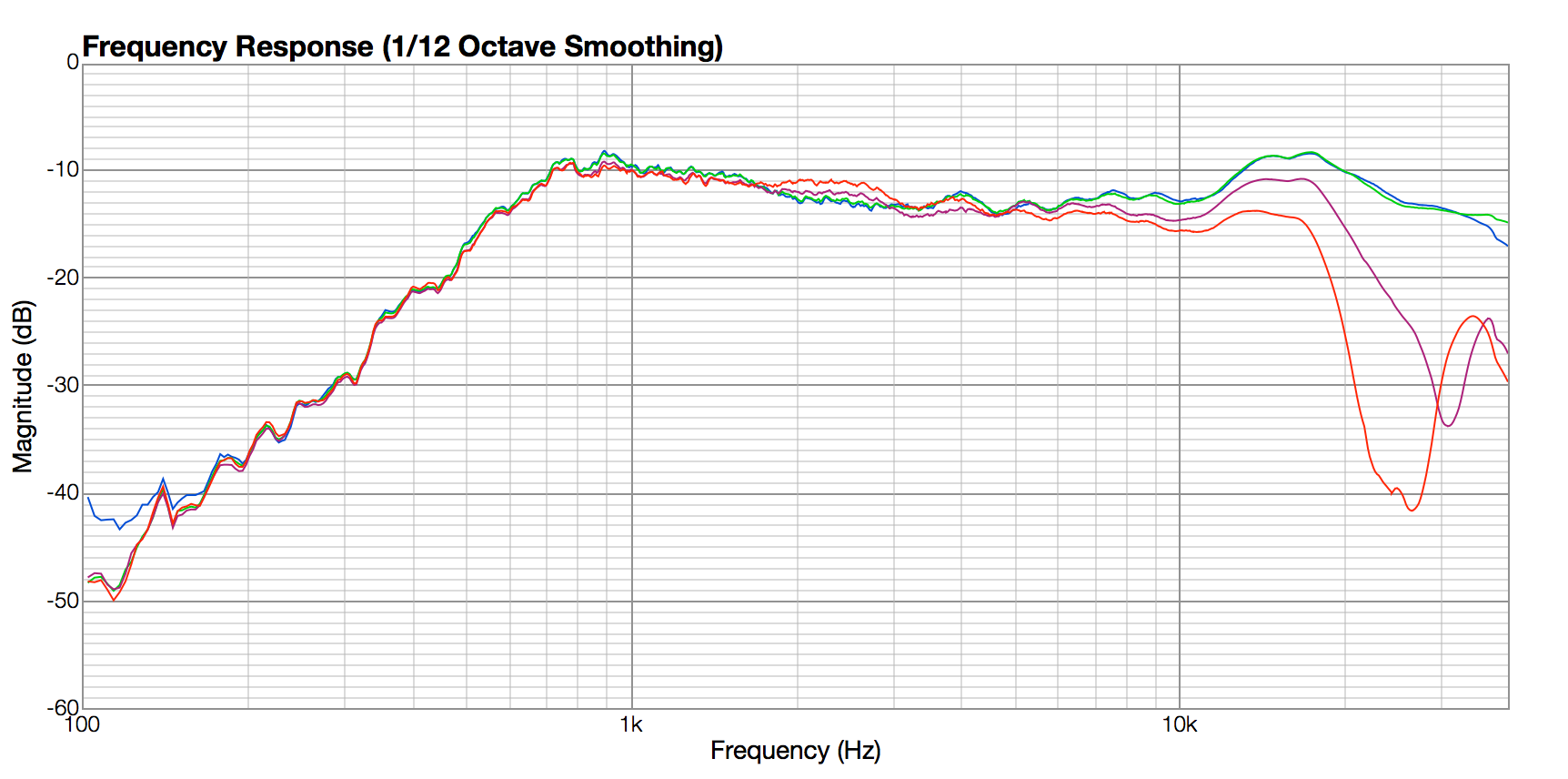

                So, maybe I better get out those SB26 small form factor samples SB26STCN and see how the nonlinear looks (they are also a candidate for the revamped Modula NeoD CC), or just go with my old favorite, the D2608-9130. (the Audio Excite data shows decent odd order HD performance, and expects good results if crossed over at 2500 to 3K- bingo.) OTOH, would prefer for this to use a standard 105mm tweeter, so that upgrades are possible.
                Feedback welcome, of course.
                Last edited by theSven; 12 August 2023, 18:16 Saturday. Reason: Update image location

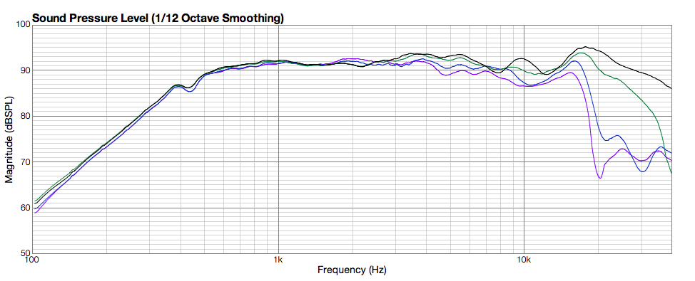

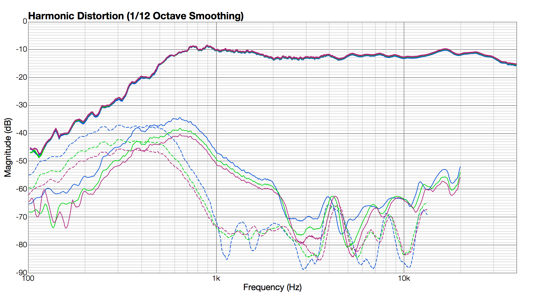

                    #99

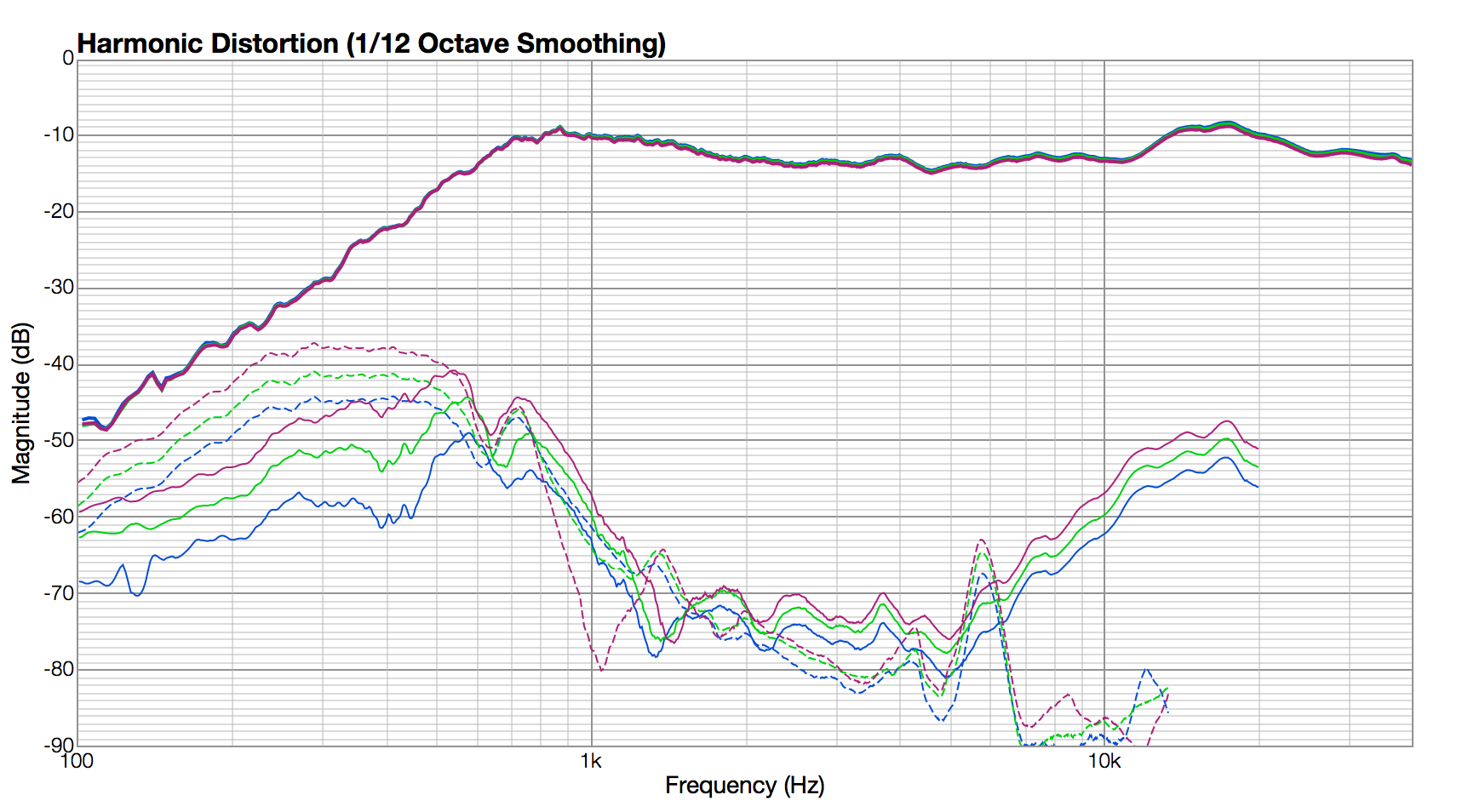

                    Well, checking online with sites like AudioExcite, the SB26STAC has a significant edge in HD performance- yet it doesn't completely charm me...
                    I think I'm going to have to get out some RS28a and measure with the current setup- as Ryan pointed out, a lot of these newcomers are just different, and often not as neutral or clean- just newer!
                    I wish the new Esoteric tweeter was a more continental design with smoother response- that might be interesting.

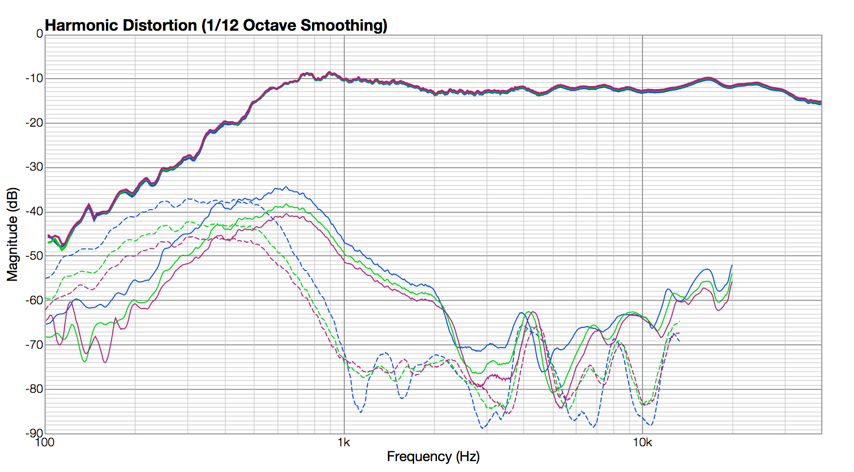

                    The metal dome SB26ADC appeals more to me...
                    But we need a fresh look at the RS28a to see how it compares. On flatness of on axis response, the SB26ADC has the edge, and distortion is pretty fair. Fine for a three way.

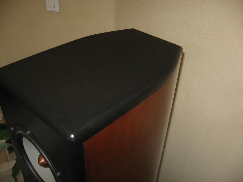

                                                As to other material properties, go to Home Depot and get a small piece of MDF and a small piece of red oak or maple (similar in strength and hardness to LBL, though not quite as good...) . Get some Drywall screws, which are the right size for mounting many drivers. Drill some 1/8" pilot holes, then put the screws in and out of the board scrap a few times. Watch how the MDF threaded hole turns to mush compared with the other wood projects. (I'm assuming you can't buy any LBL at your local HD).
                                                Please, PLEASE, do yourself a favor, use two layers of LBL (such as from Woodworker's source, 48" boards to source) for the front panels, two layers of BB ply for the next two layers, and use BB ply for the walls and back. If you must use any MDF, use them for the braces, as it's mostly a matter of compression strength, and it's sort of OK in that mode.

                                                        As to the STAC, it has a nice general slight downward slope in the frequency response, then this bump in the upper octave, which for me produces an unpleasant subjective reaction (no extra "air" for me, thanks...)
                                                        Also, the HD2 curve above 5 kHz doesn't "charm" me, either... could be nothing more complex than a soft breakup mode of the dome... but that's also a characteristic soft dome coloration I don't like, and seem to be sensitive to (YMMV, etc, all the usual disclaimers).
                                                        While the SB26ADC isn't perfect either, it comes closer to being a 9800 on a budget with some extra Xmax, something I'd say I can live with. I also think is sounds cleaner on the swept sine chirps that Fuzzmeasure uses for measurement. (Not MLS, but does do convolution to an MLS type signal for gating) (works like Praxis in this regards).
                                                        It's a free country, and all, and if you're on a really tight budget, well, I think the ADC version costs about $10 more. But I would go for it.
                                                        I should redo the distortion on the ADC sometime, too, because I think the variation with frequency could be due to the driver or baffle not quite being tightened down enough.
                                                        The STAC seems to have the edge in LF distortion, and would be better as a two way, but as we're crossing over at 3 kHz, it's sort of moot point. Like I say, I should make another baffle and retest the ADC sometime soon.

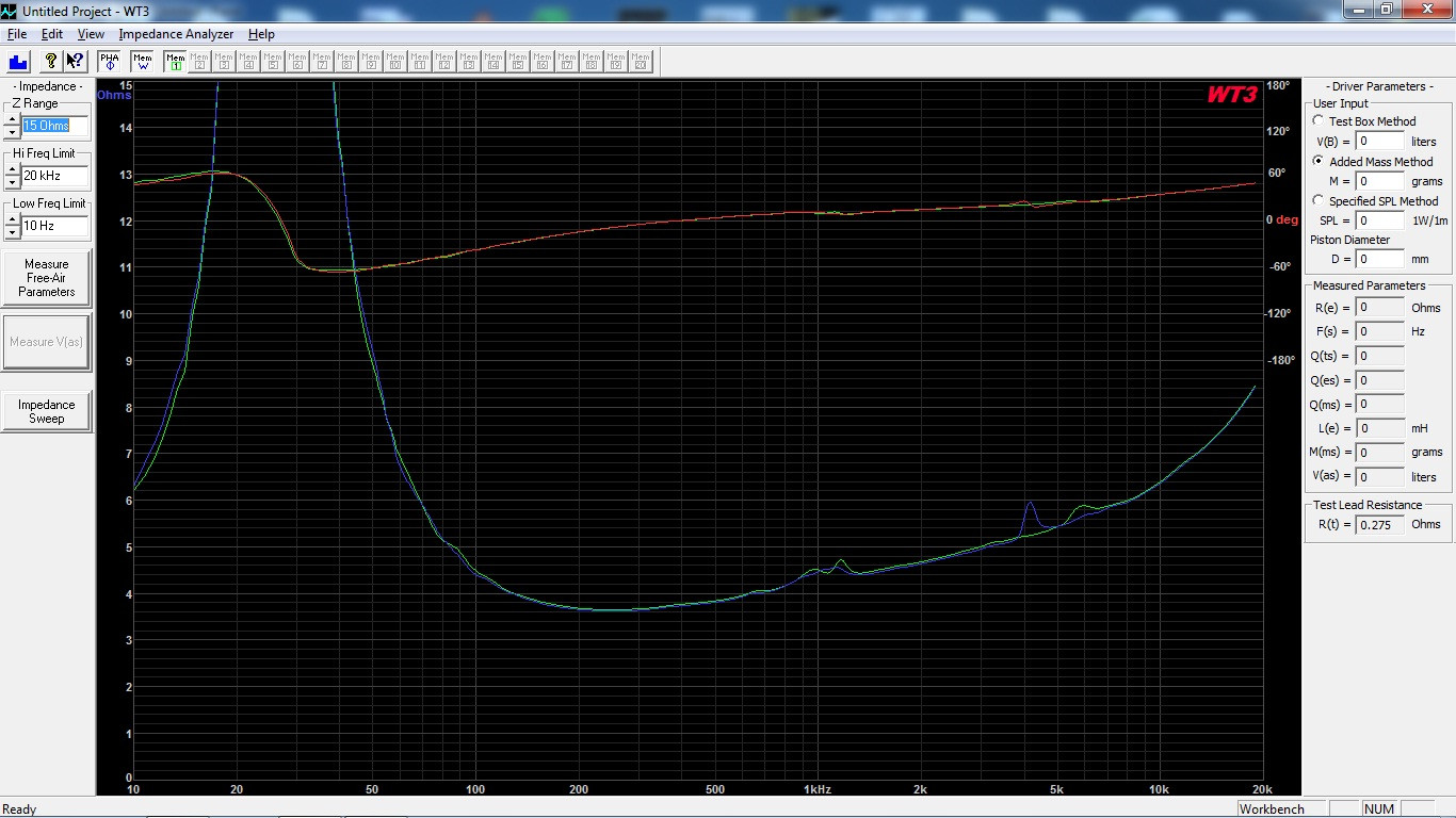

                                                                This is the measured impedance curve of that Satori.... which shows the bobbles in the impedance curve which results from mechanical resonance.
                                                                Two samples of the Satori measured at AudioExcite.
                                                                A lot of folks like these, and YMMV, it's a free country and all, but the whole concept behind what I was doing in the 70's and which Avalon did at it's introduction was finding drivers without these issues in the pass band. The ZA14 is quite clean up until it's breakup mode at ~8.5 kHz.
                                                                IF you have the resources for measurement of the drivers in the cabinet, I can help design a crossover for whatever drivers you select, but if you plan to follow the Ardent form factor, a 6-1/2" woofer won't really fit as a midrange with the existing design.

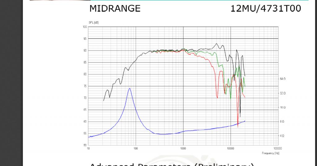

                                                                      I would appreciate opinions about this driver combination for a version of the Ardent.
                                                                      2) Dayton RS225 4 Ohm in series
                                                                      1) ScanSpeak 12MU/4731T-00 4 Ohm mid (the 4 Ohm FR is flatter than the 8 Ohm)
                                                                      1) ScanSpeak D3004/6600 AirCirc Tweeter 4 Ohm
                                                                      The financial manager has decided that it may be possible to extend my credit limit for higher end drivers than originally proposed. (I begged the wife, and promised to take her to S.F. soon. Amtrak makes getting there easy peasy.)
                                                                      As I understand it (or don't), each driver presents itself through the XO uniquely to the Amp, so Impedance is per driver and where crossed, not all drivers summed. Is that right?
                                                                      My reasons for choosing these drivers are the flatness of the FR and the behavior of the 2nd and 3rd harmonics.
                                                                      Jon, I looked at the impedance plot too. Thanks for that tip!
                                                                      Not cheap drivers by a long shot, I know, and maybe a bit dyslexic to use the Dayton RS225 with the premium SS, but playing down low maybe the $$$ difference between the Dayton and Wavecor will help buy the SS 12MU/4731 Mids.
                                                                      I have metal cone drivers now, Seas W18EX-001 and Seas T25CF-002 Millennium Tweeter (soft dome) in a modified (larger) Thor cabinet. They are almost too clean sounding, if that is even possible. Some of the old recordings from the '70s just aren't worth listening to, even though I enjoy the music. Is this common?
                                                                      I've heard speakers built with SS drivers that sound excellent. I'm hoping to build something a few steps up from the Thor's.
                                                                      Being able to compare the two side by side would be fantastic.
                                                                      Thanks to any and all for your opinions.
                                                                      Ron
                                                                      Click image for larger versionName:	12MU 4731 FR.jpgViews:	1Size:	63.5 KBID:	859566
                                                                      Last edited by theSven; 12 August 2023, 18:28 Saturday. Reason: Update image style

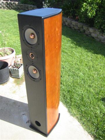

                                                                            The original "Thor's" that were designed by Joseph D'appolito were a compromise on cabinet size, which crippled them as a TL. They were re-designed by Dave (Planet 10) Canada and (ScottMoose) from England. ScottMoose has a background in aquatic audio engineering (sonar) and has the same style of writing as 5th Element, Hence why I asked about 5th's educational background. I built the resized cabinet and added curved sides after I modeled water ripple action to simulate audio waves inside the cabinet. The redesigned speakers work well, but it's time for another build.
                                                                            Jon, you had mentioned that you'd like to see a version with curved sides. So would I. When I actually start my build, I'll start another thread and not pollute this one any further than I already have.
                                                                            I've got some honey-do's to complete first and a built in hutch w/drawers I've been putting off for a while now.
                                                                            Amp wise, I've built a Pass F5 that is scary good, but only ~50 watts@4 Ohms. I've got the parts for a Honey Badger Amp waiting to be built too, ~200 Watts @ 4 Ohms.
                                                                            DAC I've got a Denon DVD1600 w/ BurrBrown parts and an Oppo BDP-83, I've built a "HotRod" DCB1 preamp that is very clean and silent with a little gain if needed, rather than strictly a buffer as designed by Papa.
                                                                            On a personal note, I went to the dentist last week and he informed me that I needed an "Implant" (not the wife type) . ops: Oral Surgeon the next day pulled the tooth and ground out a spot in my skull, placed a titanium threaded insert (just like the kind we use in MDF) added some Cadaver bone and skin graft, then told me to come back in 3 months. Meantime I sound like Sylvester the Cat and whistle a little bit when I say "S" words. :T Unbelievable as it may sound there was only very minor pain and 1 Advil took care of it the same day as the operation. Now when I "Toot" in presence of my wife, I tell her I "had a procedure", our standing joke after her heart surgery last year.
                                                                            Getting older, hopefully wiser, has it's downside as well as it's upside. Part of life's plan I suppose.
                                                                            Jon, how's your Girlfriend doing with loss of her dog(s)?
                                                                            Ramblin' out.
                                                                            Ron
                                                                            Click image for larger versionName:	IMG_2989.jpgViews:	1Size:	47.3 KBID:	859571
                                                                            Click image for larger versionName:	5 12 07 004 (Small).jpgViews:	2Size:	40.6 KBID:	859570
                                                                            Last edited by theSven; 12 August 2023, 18:29 Saturday. Reason: Update image style

                                                                              I followed that evolution of the Thor thread very closely back when you built yours. They were actually going to be my expensive last speaker project for a long time but then my dad talked me into the Ardents.

                                                                                The Thors were a very nice project for their time- looks like you did a very nice job with these! :T
                                                                                Speaking of aging, I actually feel like I have a bionic girl friend, as due to her excess of athletic activities at younger ages, she's now already had joint implants for both hips... I figure that's sort of cheating, but I can hardly blame her- made a big difference in her mobility and gait.
                                                                                The second doggie is still hanging in there- his slow growing cancer isn't a problem yet for his functionality, as old as he is, it's hard to predict what will catch up with him first- he also has a heart condition, with abnormally slow heartbeat. She misses the girl dog, who was especially sweet- but life goes on.
