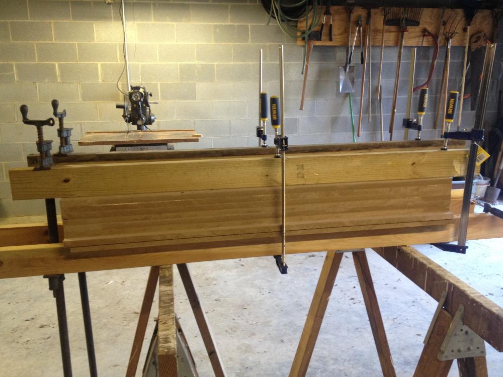

                                  Some progress. Dad's not a subscriber to the "you can never have too many clamps" theory of woodworking. Using 2x4 cauls to make up for the lack of clamps, I have the baffle pieces glued up in double thicknesses. Tomorrow I can rout driver holes
                                  Click image for larger versionName:	photo (1).jpgViews:	1Size:	100.7 KBID:	859487

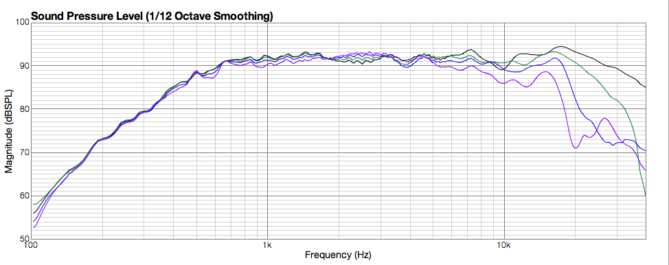

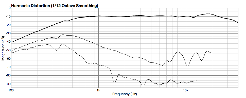

                                                                                        27TBFG, the aluminum version:
                                                                                        Might be inclined to recommend this version- but then it's not what you've got!

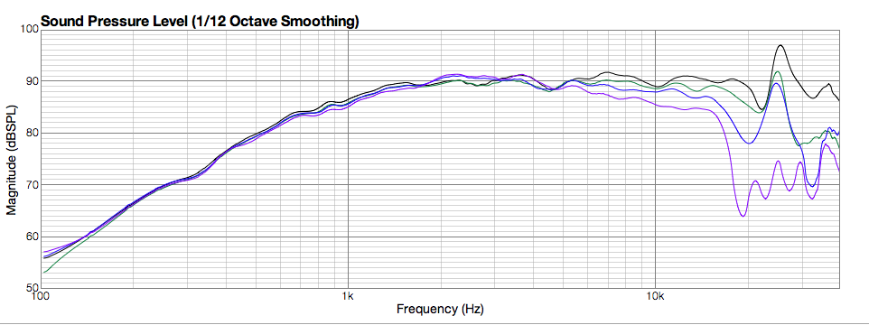

                                                                                        Air cir for comparison:
                                                                                        Classic late model SS distortion characteristics:
                                                                                        Will the SS sound better than the Seas? Or better for the buck? Only you can decide...

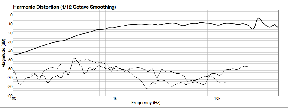

                                                                                          Zaph ZA14
                                                                                          Last edited by theSven; 12 August 2023, 19:14 Saturday. Reason: Update image location
                                                                                            The effort going into the cabinet is what lead me up the path for the "final" build. It's a big stretch financially, but hopefully will keep me from wishing I had reached higher for quite a while. I also have a pair of 27TBFCG as well if you want to see what they look like in this cabinet. With an external crossover you can swap out the tweeter section readily if/when you are ready to upgrade to the Air-Circ.
                                                                                            Nice to see how well the ZA14 does up high compared to the W15 I am listening to in a 2 way at home now. It will be interesting to see if my Oppo BDP-103 and Pass clone amps can resolve the difference between W15, ZA14 and the C79. I also have an M-Audio FW410 interface with one 192/24 set of outputs that may be a bit better, I'm not quite sure.
