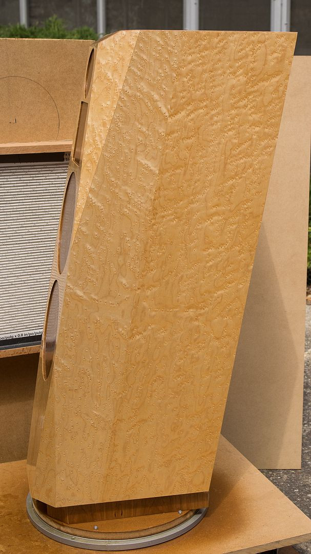

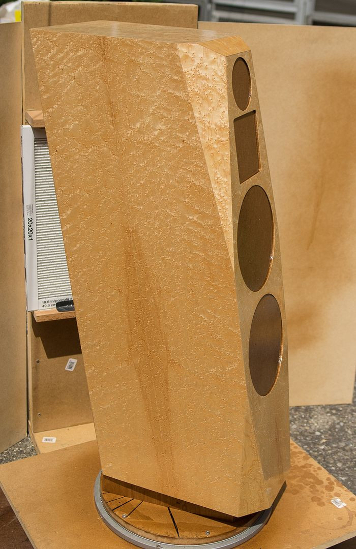

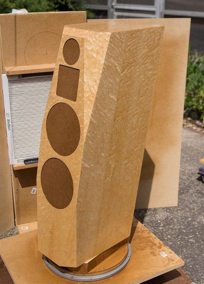

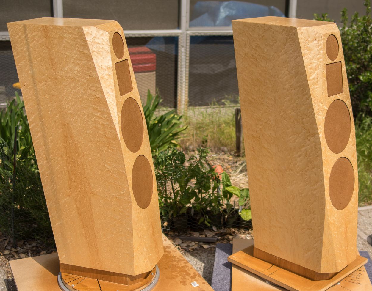

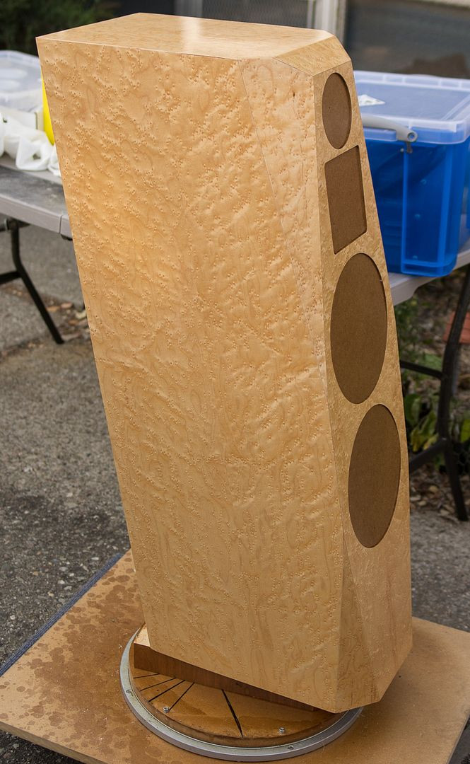

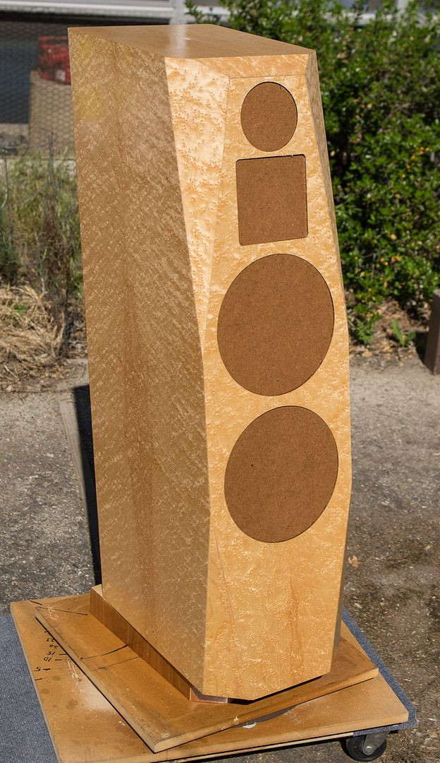

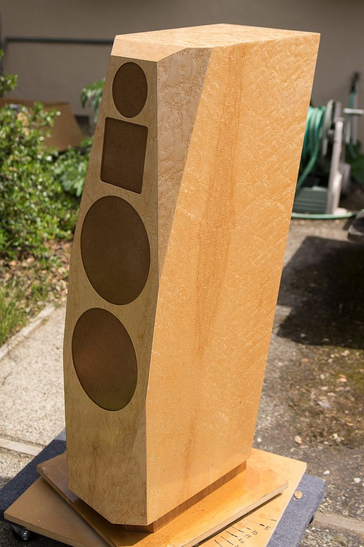

                            Wavecor Ardent Spring Break, Thursday edition!
                            A bit more progress today... I can enjoy the sweet smell of lacquer solvents!
                            Several preliminary tasks today- one was using the drill guide templates sent by the Winnipeg team, but using them for creating masonite plugs for spraying- just trace the outside with a permanent marker, then cut away on the trace with a good laminate blade, and the pieces just pop in snug as a bug in a rug, to use a really, really old saying...

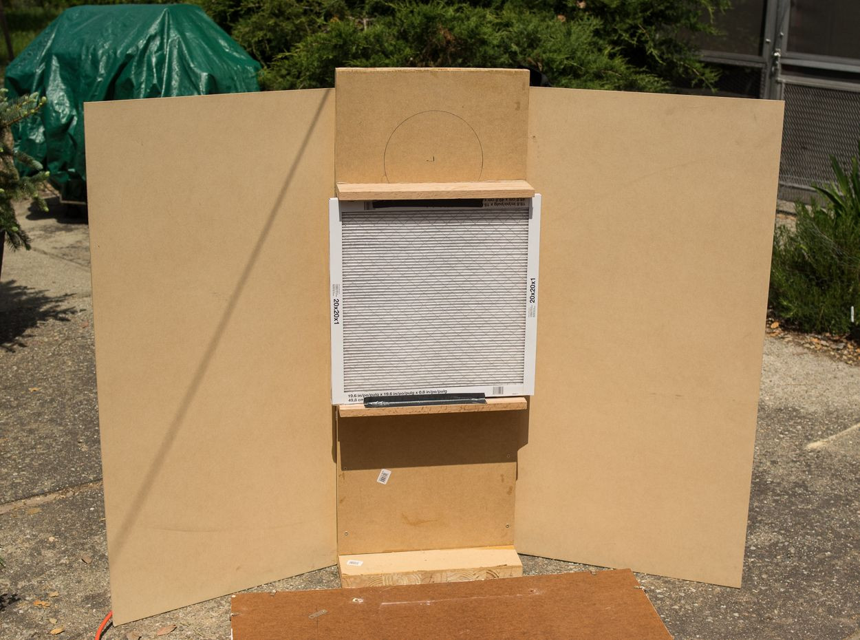

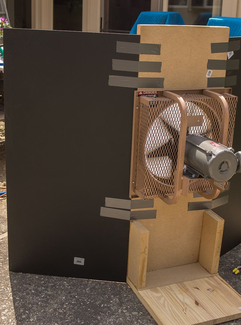

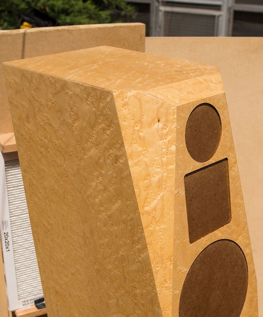

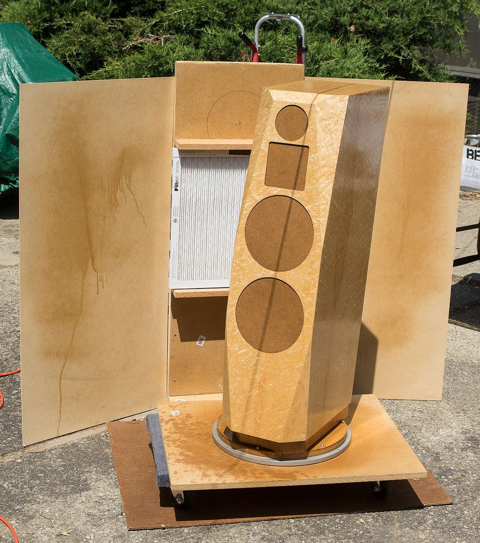

                            Well, the home made spray lean to was ready to use by late morning- just had to glue up the filter frame with construction adhesive and let it setup a couple of hours... (don't laugh- it's homemade, with re-cycled speaker test stand stuff.. very practical! :T )
                            From the spraying side:
                            And a peak around back, with the Jenny fan quite visible.
                            Yeah, if this is the part where some wise guy say the whole thing looks like it's held together with baling wire and duct tape, well, you are 100% correctomundo! :B
                            However, pretty is as pretty does.... it did keep the vapor moving away from me, and overall the spraying went smoothly once I dialed in the flow control and pattern on the sprayer, shooting on one of the wings. Cleanup with lacquer thinner is fast and easy, just have to shoot a pint or so through to clean out the works (don't tell the California Air Resources Board on me.. however, it was not a spare the air day). (we had a lot of those last winter, what with the inversion systems we don't normally get that time of year).

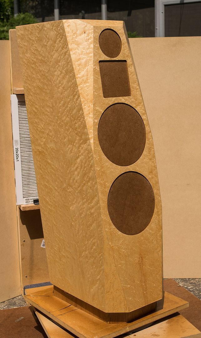

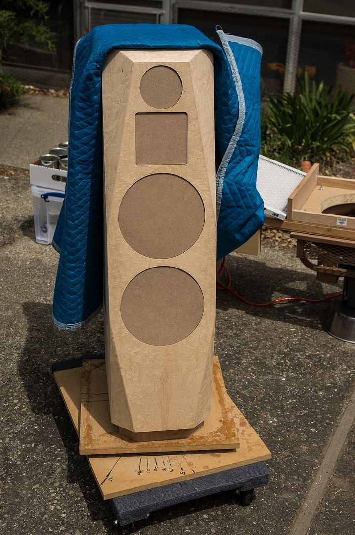

                            With the turntable system for each cabinet, the spraying part was a total breeze...

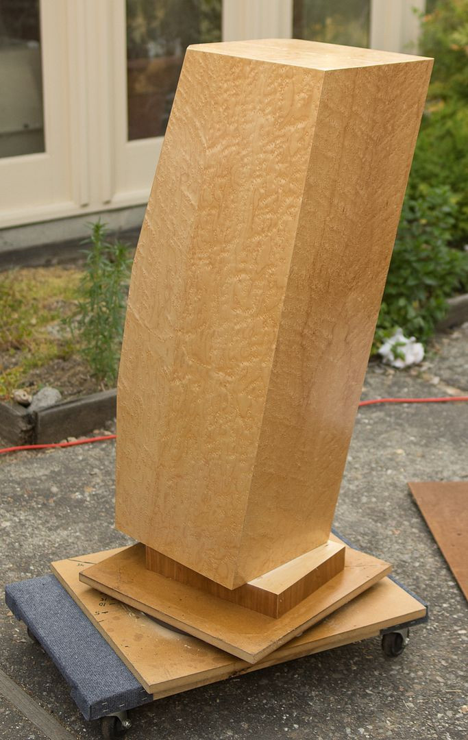

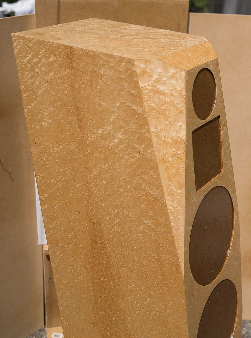

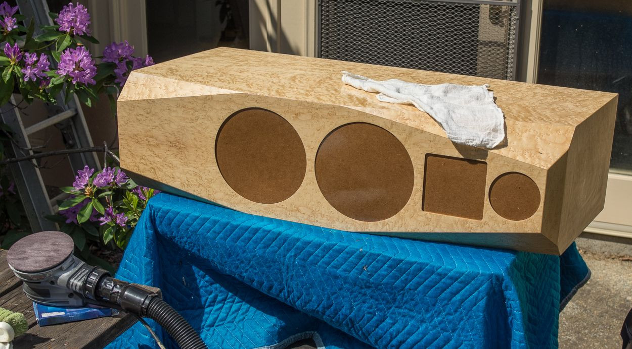

                            Today was just the two coats of sanding sealer- but this pretty well established the color and contrast of the birds eye maple. These are not AAA veneers, but they do still have pretty nice contrast and directional pop and depth as you move around, like all good curly/flame maple and birds eye maple should have. I think I'm going to be fairly happy with them.
                            It's a bit too late to do the sanding today, and we have a dinner date anyway, so first thing tomorrow the sealer sand, then if the conditions cooperate, back to spraying. Otherwise, very nice weather is forecast for Saturday, and I'll work on crossovers and sanding only tomorrow, perhaps the cut and route the sides of the new bases, too.

                                  #601
                                  You know looking at the lines of these speaker with the 3 different skins I have to say these are right up there with any commercial offering.:B
                                    • 16144
                                    #602

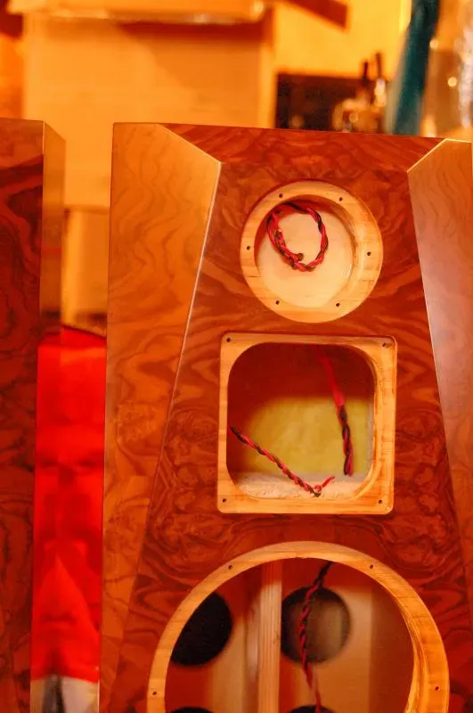

                                    I agree- and i particularly think they will look very sharp once the black grille panels are complete and mounted.
                                    yes, I've been trying to do some balance in this time off, as GF has been very understanding and tolerant. Today I also got approval to take time off the begining of August for her neice's wedding up in Ashland Washington- that will take about a week. It's all a balancing act, but one must keep some balance, somehow.

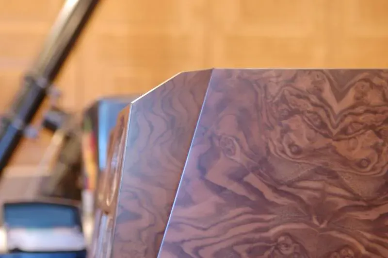

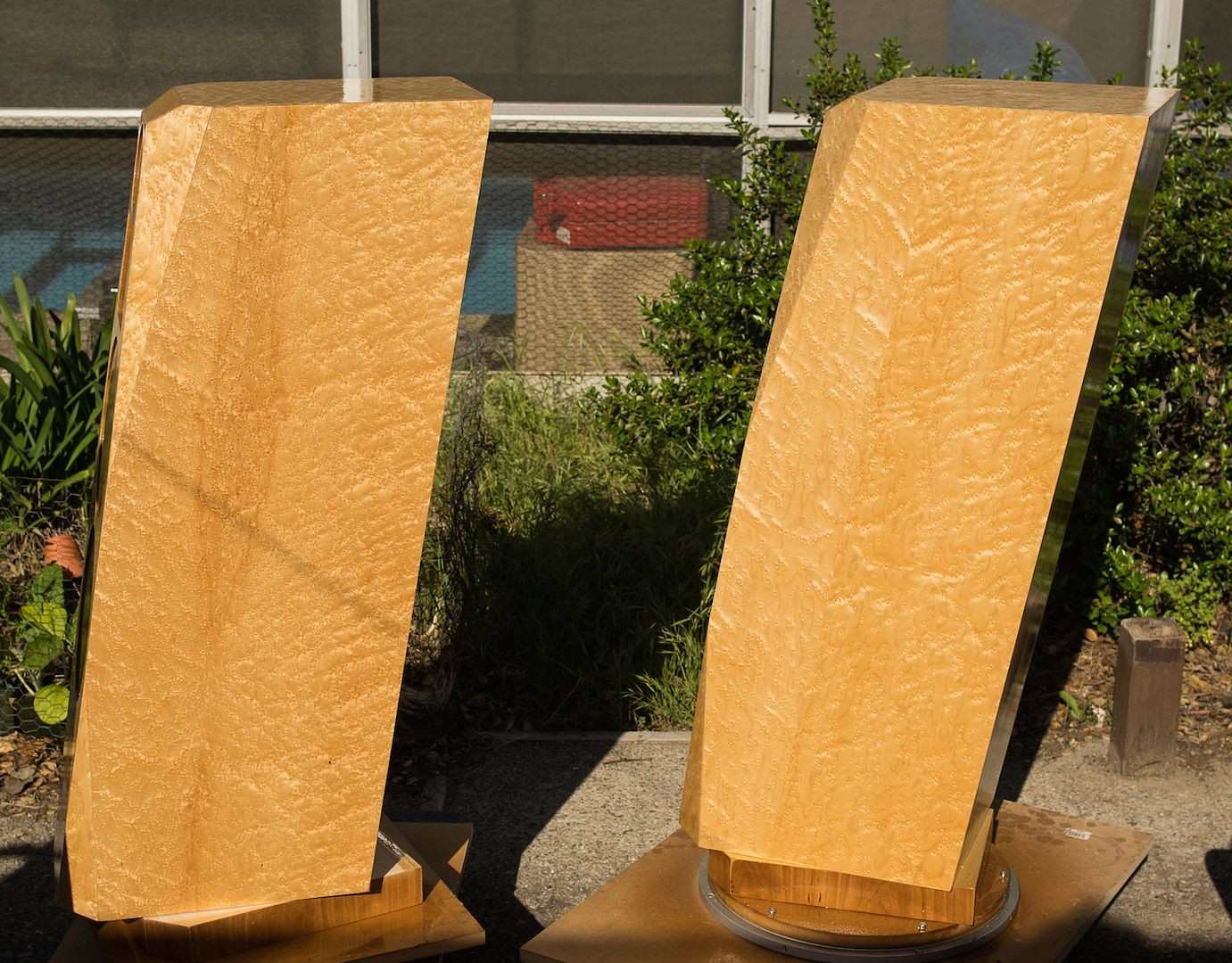

                                      Wow does it ever pop-- looking forward to the results with the lacquer!
                                        • 571
                                        #604
                                        Beautiful job!...that has always been one of my favorite combination, birds eye maple and lacquer...and you say you are just a wire and sparks guy:P

                                                        #612

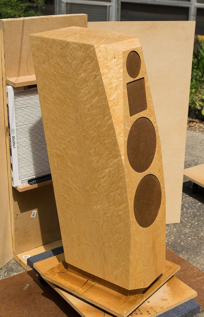

                                                        Ardent Spring Break Saturday Edition
                                                        Thanks! And welcome to HT Guide!
                                                        Just a few pics this afternoon during the lacquer spraying- the weather is cooperating, and things are moving along pretty well.

                                                        This is about the half way point for now- four coats on, four to go in this initial pass. Hopefully this will do the trick, but their may be another coat or two after the next finish sanding.
                                                          #613
                                                          Wow very nice, the veneer seams disappeared and all angles are sharp.:T
                                                          The way the finish is laying down looks like you can get your gloss no problem.
                                                            • 16144
                                                            #614
                                                            Hah Ha! In the flesh, it doesn't look quite that perfect- but as my GF says, they'll look great from horseback (a little distance...) It's hard to convey with pictures how the birds eye maple looks- the bands of light reflection move around as your angle and the angle of the light changes- it's fascinating, but pictures can't really capture it. There's also a certain glow to it all...
                                                            My lacquer skills are rusty, so I'm expecting to do a leveling sanding, then maybe 1-2 more gloss, then possibly a satin coat. Still unsure what might be the best look- we'll see how the gloss looks after this initial effort has setup.
                                                            This is what I expect the remaining steps to be like, if I don't need any additional coats after sanding: (taken from a post found on a forum online)
                                                            5. Wet block sand with 400grit paper. The purpose is to flatten the orange peel and dry spray. It helps slightly to sand with the grain, but this is not completely necessary. Spray a little water on the surface. Sand a little. Wipe dry to check your work. Spray a little. Sand a little. Wipe dry and check your work. It will be obvious in reflected light when
                                                            the finish is rubbed flat. There won't be any shiny spots from the glossy finish remaining..
                                                            6. Wet sand with a 2000 grit Abralon Pad. I use a Porter Cable 7336 for this operation. I also use a household sprayer. An old window cleaning container works well. Spray a little. Sand a little. Wipe dry to check your work. Spray a little. Sand a little. Wipe dry and check your work. It will be obvious in reflected light when the finish is rubbed good. The other possibility is to dry sand with 1500 grit automotive paper. If sanding by hand, I recommend 1000 grit then 1500 grit automotive 3M sandpaper.
                                                            7. Rub with 3M Perfect-It III Machine Glaze and a glazing pad. I use a Porter Cable 7336 for this operation too.
                                                            The result is a deep clear mirror-like finish.
                                                            I think it would be cool to go for this; if it doesn't work out for some reason, I've got a couple of cans of satin...

                                                              Time to put the tools away....
                                                              And time to put these away for a week or more to harden, and then decide what the next step is.
                                                              There's too much mundane stuff that has been neglected this week and needs attention, so those chores will have to take priority tomorrow, though with some luck I may finish wiring up the second crossover. But, I don't see any way to get the bases built and these assembled before next Saturday- Monday is back to the normal grind, leaving home about 5:15 and getting back 8:30 or later. So I'll be going to the Northern CA DIY to bring a playback system, but won't be bringing any speakers, as I just can't face the idea of loading up the Isiris for Sacramento again, even though they've been fixed up substantially. Just a bit too much work! :W
                                                              At this point I want to take my time with the rest of the work and be sure it's done to my satisfaction. This still has a high priority so that the crossover can be finalized for Ben and his Dad.
                                                                #616
                                                                Still One Hell of Week
                                                                Great progress.:T
                                                                I kind of figured when you decided to go a different route on the bases you would be in tough. For it always seams the last 10% takes 90% of the time especially with the finish. You and Ben just have to baby your finish a little more and your done. I think this the first time I didn't have to struggle with a finish, mostly cause I told myself your not going to touch those with a brush and bugger them up. :rofl:
                                                                We are finally getting some spring temps and I'm going to try and finish spraying my bases black, probably a couple more rounds with some sanding between. My work has picked up and I haven't got to the drawings in the evenings either, got to get at that. I'm kind of happy with the xover pace as my kids have been over lots lately with Ben leaving soon and wedding festivities, they have been literally eating my budget away. I swear I saved $1500 a month with 2 moving out and 1 mostly not around.
                                                                So don't worry every night your going to come home and walk by them and that will eat at you.
                                                                  • 16144
                                                                  #617
                                                                  Originally posted by dar47
                                                                  Great progress.:T
                                                                  That's usually the case, but the remaining time can't be 9X the time we have so far into these! :E
                                                                  We've got the man cave cordoned off, door closed, and a window cracked, for their out gassing, with reasonably controlled temperatures. I won't hit these with a brush, but it wouldn't surprise me if I sand and then put another four coats of clear on, then sand again, then maybe some satin, just because it's a bit more forgiving that way, and I like how the satin finished Avalon's I've seen look. But I'll just see how things look and give it a bit of thought and time.
                                                                  Frankly, I think you guys got a deal for what you paid- I wouldn't shoot these in lacquer for someone for that kind of money! But then, it's a bit more work and uncertainly for me- you're obviously dealing with a pro.
                                                                  Yes, them and the work I want to do on the Isiris! What would be great is if I can get these wrapped up just working as available on weekends, and get them done BEFORE GF's niece's wedding the beginning of August- we've got plans to drive up to the Seattle area for that. Right now I figure one weekend for fabricating the updated bases built around the crossover boards, one more weekend for a finish update, and another weekend for the detail work on the cabinets for the grille cloth panels and base plate mounting (still using the same hole layout and the guide you sent, plus the gaskets). Throw in another one for random chaos and final assembly, and that's four more weekends after the Northern CA DIY, which puts us in early June (if I don't get called in for Saturday work again).
                                                                  These are still on the priority track...
                                                                    #618
                                                                    Should please the blind man on the galloping horse, as my mother would say
                                                                    Birds-eye maple is one of my favourite veneers. These help to show why
                                                                    IMO you can neglect chores for a bit if you get all that done.
                                                                      • 2136
                                                                      #619
                                                                      Those are looking awesome Jon :T ...... That maple has really popped with the finish. I just finished up a new computer desk and I'm still amazed by how the wood looks now that it is finished. Makes all the time in the finishing process worth it.
                                                                        • 16144
                                                                        #620
                                                                        I hear you Steve- I felt that way about my first full on speaker veneering project (actually, a combination of veneer and hardwoods) back in the mid 70's, a clone of the AR LST. That was just a Watco oils finish, but it was 12 coats deep and took two weeks, but it was pretty amazing looking when finished. I'd definitely rather take my time and go for the gusto. I've been reviewing more pictures of finished speakers online, and the more I think about this, the more I think satin will be the final couple of layers...
                                                                        All in all, I'm quite happy with how this Sauer veneer has turned out. Now I just have to keep up a measured pace to getting this finished and not rushing anything just to get them making music ASAP!
                                                                          • 2136

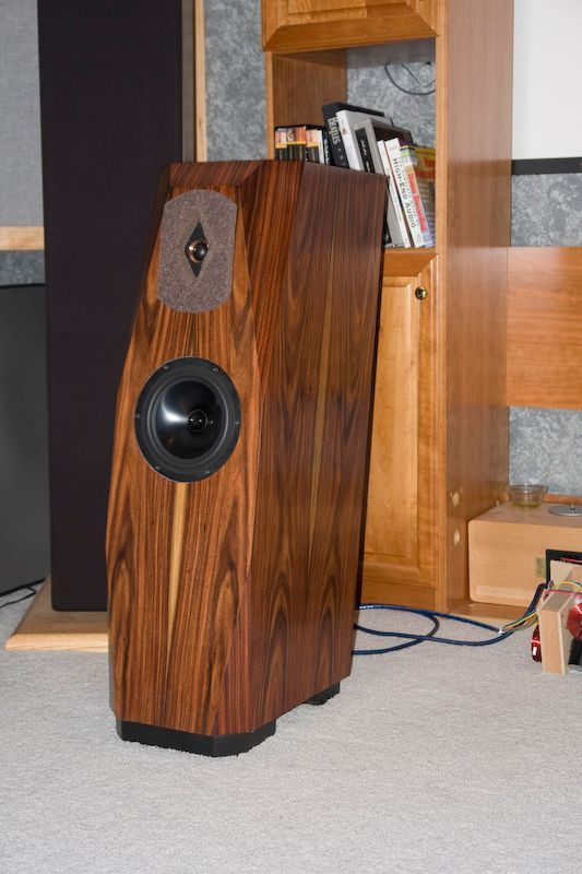

                                                                                      #627
                                                                                      Yeah, some white balance and color temp issues, for certain! Happy to see you got your cabinets back, though!
                                                                                      But the cabinets look VERY nice! :T The overall flatness and veneer work quite well with the satin finish you've got now!
                                                                                      I was sorry to hear that Charlie has some health issue forcing him to cancel the DIY meet, but this will give me a Saturday of time to work on the cabinets that I wasn't expecting, so my first task will be a leveling sanding and assessment, then likely a few more coats of gloss for now, followed up by another week to harden, a light sand, and a couple of coats of satin. No reason not to take my time and try to do this right-
                                                                                      Time permitting I'll also be working on the second crossover and cutting out the pieces for the base walls and bottom- if the weather is good this weekend, I'll give that priority.

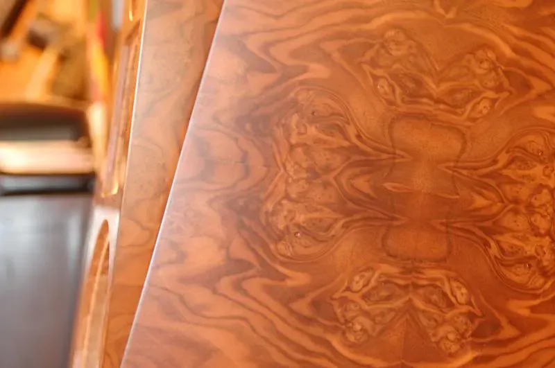

                                                                                      I like how your walnut burl turned out- I'm giving serious consideration to modifying and updating the M8ta cabinets, converting to the 8" aluminum Revelator woofers that I've got, add RS52 midrange, and the 71000 SS tweeter, and sanding off the partial walnut veneer on them now, and doing a full walnut burl. (but don't breathe a word of this to GF- I don't think she's keen on the idea of more speaker work soon! Later I'll be able to justify it as a wedding present for my daughter and her fiancé, if they want a floor standing speaker like this (have already approached her about it, but haven't got any feedback- she needs to see the Wavecor Ardents, anyway, and also decide if they'd like light or dark wood finish).

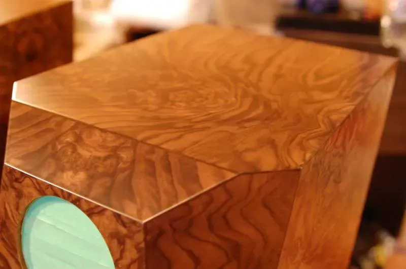

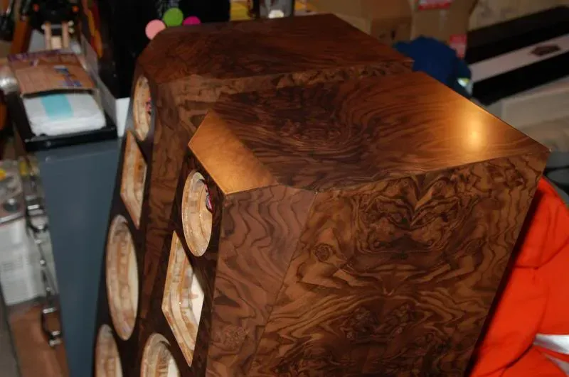

                                                                                      Evolution is the name of the game for these cabinets... from M8a HiVi to RS225 and Excel Millennium tweeter- I do also have a pair of Seas W22 I was going to try out- I should have a shoot out between those and the SS Revelator woofers, though there's little doubt in my mind at this point which way to go...
                                                                                      I do also like how Kris's turned out:
                                                                                      As well as Colorado Tom's

                                                                                        BTW, nice choice of air filter, Jon
                                                                                          • 16144
                                                                                          #629
                                                                                          Nothing but the best, Hank- just the best!

                                                                                            More watching Lacquer dry!
                                                                                            Well, with the Northern CA DIY meet cancelled, I had the opportunity yesterday to dive back into the finishing process, and dive I did!
                                                                                            First step was to do the leveling sand, with 400 grit Mirka disks- that went fairly smoothly (pardon the pun), and while it took the contrast out of the finish, it also gave a nice flat surface for the subsequent coats. This was just on the border of whether it would benefit from wet sanding or not- I ended up not to save time, and considering my venting orbital sander, that worked out fine- but I did use five disks for each cabinet, as the Mirka disks were getting just a touch loaded with lacquer powder in spite of the suction from the dust collector. I did wet wipe down the finish and dry with additional tack cloths. Surface preparation is everything in both veneering and finishing, in my limited experience.
                                                                                            By now the routine is very familiar- to finish up I applied 4 coats of gloss, followed by 3 of satin. A coat is just one pass of the gun, with hardly any overlap on the horizontal spray pattern. After completing each pass and heading indoors, I set my timer for 25 minutes, then did another coat; what with setup and mixing lacquer and thinner, it was more like 30 minutes between coats.
                                                                                            In pictures like this the results would be hard to distinguish from the shots from last weekend....
                                                                                            But the resulting surface at this point is very smooth, visually and to the touch...
                                                                                            And I'd say these are going to need very little time with the 1000 grit and 2000 grit pads before proceeding to the rubbing compound.
                                                                                            But they WILL get a couple of weeks to harden up to get ready for that phase!
                                                                                            Now, today, back to the second crossover!
