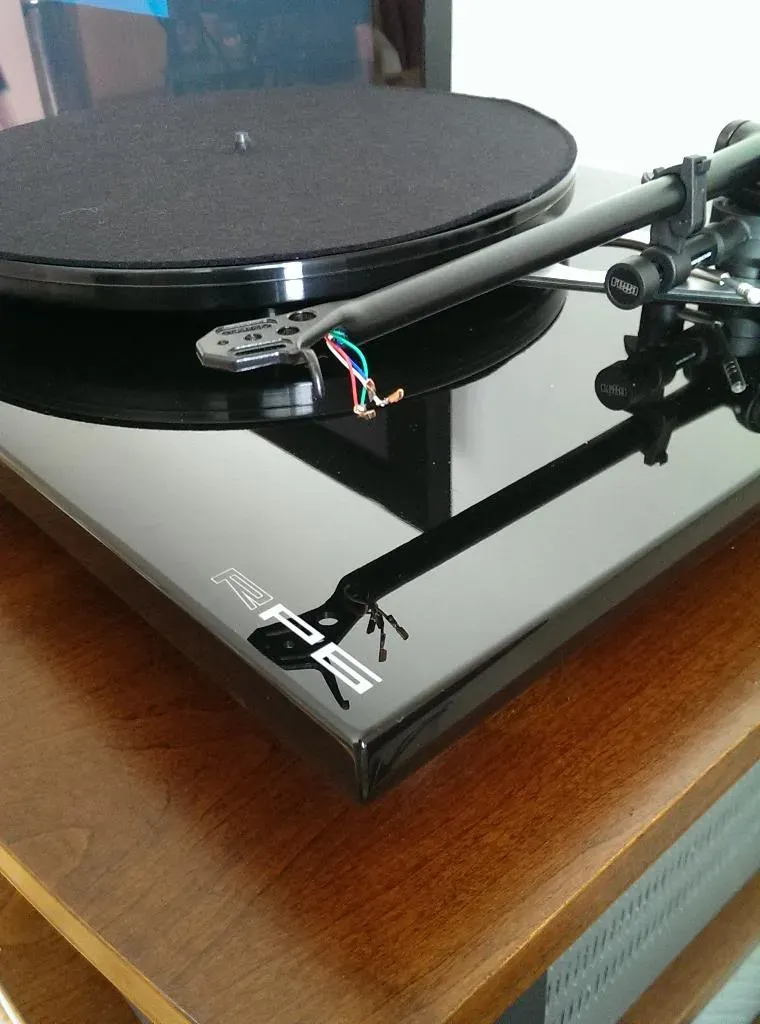

          Well my wife just surprised me with this for my 30th birthday, I can't wait to hear this guy on the new speakers:
            Click image for larger version  Name:	IMG_20140112_122725_zpspp3gz4ii.webp Views:	21 Size:	57.3 KB ID:	934229
            Very cool! :T
            And Happy Birthday!

              What a wife! That's a keeper.
              Congrats!
                #142
                Rega RP6.....
                Sweet!
                What cart are you looking at?
                Oh, & happy B-Day, too.......
                Jeez.....i can hardly remember being 30!

                  Haha thanks. She got me an Exact as well, there seems to be some debate if that's the best cartridge for for the price but so far it sounds leaps and bounds better than the 90s Denon it replaced. I'm limited to MM because of my Cambridge phono stage but the shop said I could return/exchange it if I want something else.

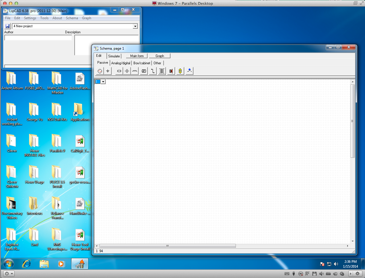

                        With my 17" Macbook pro crashed (both figuratively and literally after tripping over a sprinkler head in the dark and smashing one corner of it up), it's time to up my game and productivity for dealing with Windows programs.... hence,
                        32 Bit WIN7 runs fine with 4 GB of RAM, which my 16GB system hardly misses- I'm still learning the ins and outs and little tricks of how Parallels 9 does things, but I have to say it's amazingly flexible and much improved over the version 5 I tried and discarded some years ago.

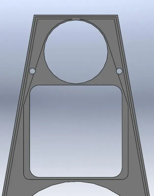

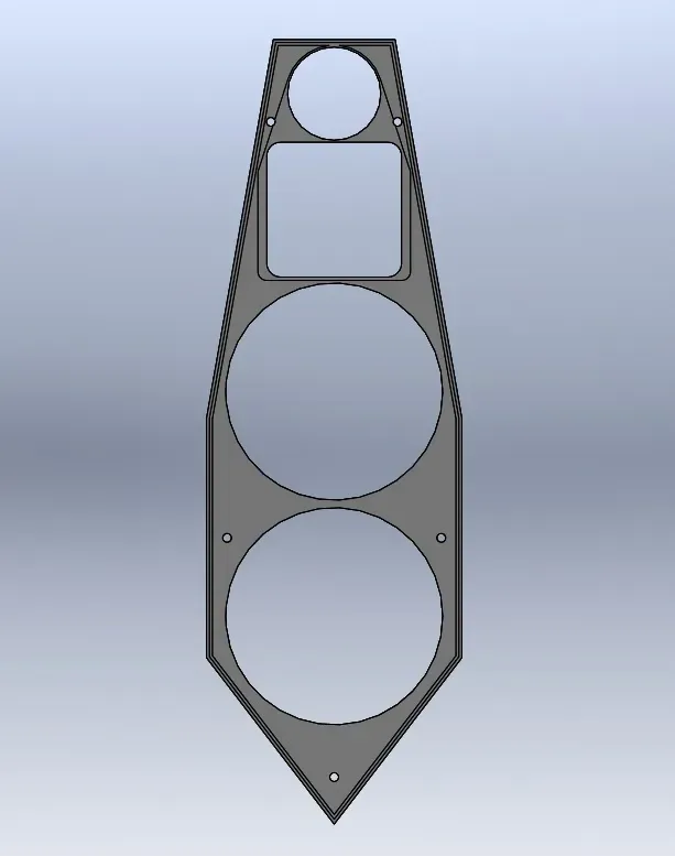

                            So the last of the boxes are assembled and we are waiting on parts and our baffle cutting guy. I expect (hope) he'll be available this weekend because we are running out of stuff to do.
                            We still need to pick up some more wire to pre-wire my mids/tweeters and waiting for a mcmaster order to come in with our cap screws and hardened steel inserts to mount the bases.
                            So this evening I revised the grill conundrum. Part of me just wants to run no grills at all but I'm on the fence.
                            I came up with this:
                            This image shows a pocket for 1/4" felt to sit inside and there is a groove on the perimeter so screen door spline can be used to attach the fabric. My dad has used this method with success in the past.
                            The felt I'm considering using is this stuff it seems to be the best compromise in price, form and color. I just thought of it tonight but I'll find out tomorrow how well the felt can be laser cut. This would make it a bit easier than trying to hand cut it and fit in a somewhat tight space.
                            Still needs some tweaking to adjust the geometry and I can take some more meat out of it. I suppose the xover would have to be designed with the felt/grills on?

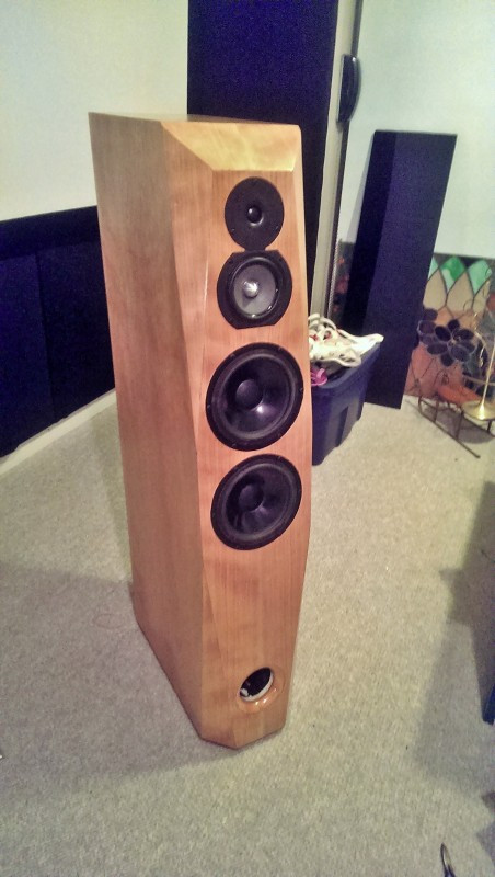

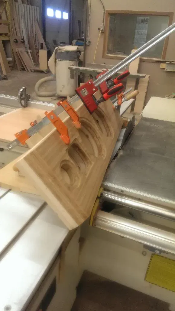

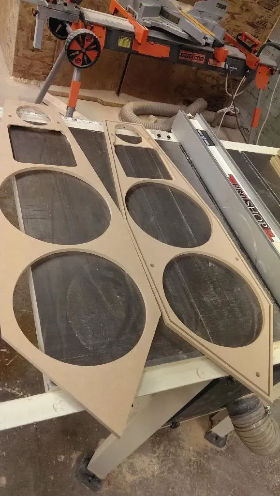

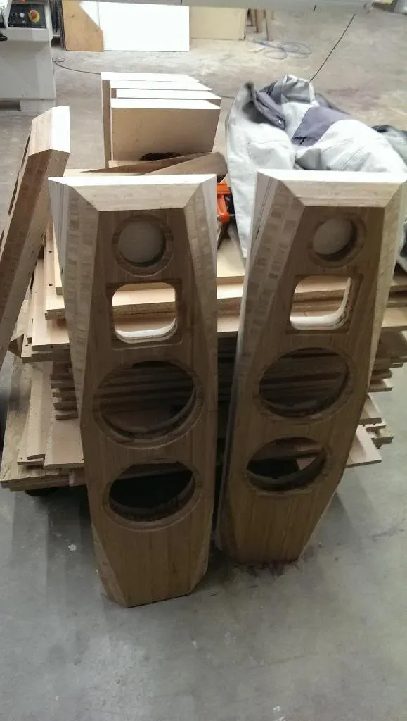

                                                              We met up with a local cabinet maker and got the facets cut:

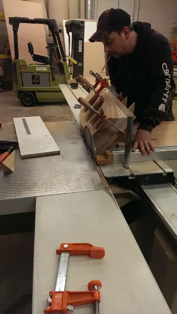

                                                              His 14" panel saw cut through the BB/Bamboo like it was butter:
                                                              Now it looks like things are really coming together and things should be a bit easier...until we start stressing out about finishing.

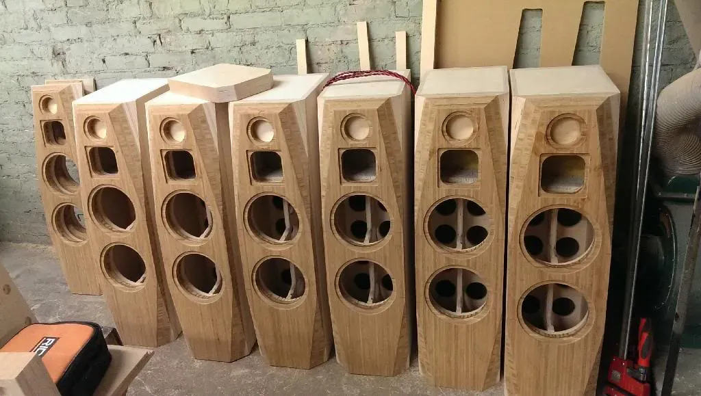

                                                              We got a lot done and the Jets beat the Oilers so all in all I would say it was a pretty good day at the Ardent Factory.
                                                                • 16176
                                                                #166
                                                                HOLEY MOLEY! Is that ever a beautiful sight to my eyes! :W :T
                                                                Jet's fans, eh? :W
                                                                Great set of pictures, this makes my day - (though the Indian dinner I just had with GF was pretty nice too- we're working on the plans for a concrete pad and storage shed to put into her back yard. Its interesting having a former IBM systems engineer as a girl friend... some things just go so much more smoothly... ) :B
                                                                Well, this is the closest we'll ever come to mass production- it's impressive what you've done. :T

                                                                  Ya Jon, it was fun watching this guy do his thing. We thought an hour to do the 32 cuts but it took 2, with a few tells along the way. He is a talented guy he just makes a few reference marks then hits them every time. We were so happy with the cuts as in you don't need anything on the facets but a light sanding before veneer, we both looked at each other and said lets double his vary reasonable fee for the extra time :P I even got my youngest to help out and cover for me as I bailed on an appointment for an estimate on the new double garage door because these cuts were a lot more fun.
                                                                  When you see them altogether it sure makes sense to do group builds, more guys local to each other should try it.

                                                                    The guy in the picture at the saw is wearing my favorite hardware store brand- I've been buying a lot of Carharrt work shirts and jeans, partly to spoof on my daughter who works for Nordstroms, and pointing out my chic hardware store clothes... :W
                                                                    There's a slight gray short sleeve shirt with front pocket that is my standard uniform shirt wearing to my Cupertino work site. :B

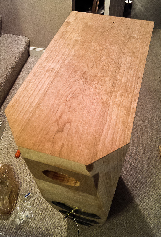

                                                                                        You know, I think after looking at Ben's walnut burl sheet picture I'm going to have to go take a long look at various Avalon's finish and decide which way to go... the originals were being done in Curly/flame maple, with a clear finish, and I may fall back on that, but I suppose I should consult with GF, too- (actually, I did once, if I remember correctly, but got a non-committal response). I really like the way lacquer finished curly maple changes it's appearance depending on the angle of light and viewing. And light colored speakers are a little less visually imposing. But Walnut burl is intriguing- though probably more challenging to make all the veneer look correctly patterned on a cabinet like this.
                                                                                        Here's curly maple for the Indra.
                                                                                        These are in Cherry, I believe- they look nice in the "flesh", in a more conventional way, like Chris's Nebbiola build.
                                                                                        These pictures don't capture what the cherry looks like "live" that I find appealing- this picture of CJD's veneering work comes much closer:
                                                                                        Decisions, decisions.
                                                                                        Note, I will mount a set of drivers in the raw cabinets and do all the crossover development work prior to starting veneering work- don't want to slow you guys down! With regards to crossovers, I'll offer some options on BOM- including scaled to say, the 6600 tweeter and keeping the cost and bulk down, as well as no holds, and something in between.
