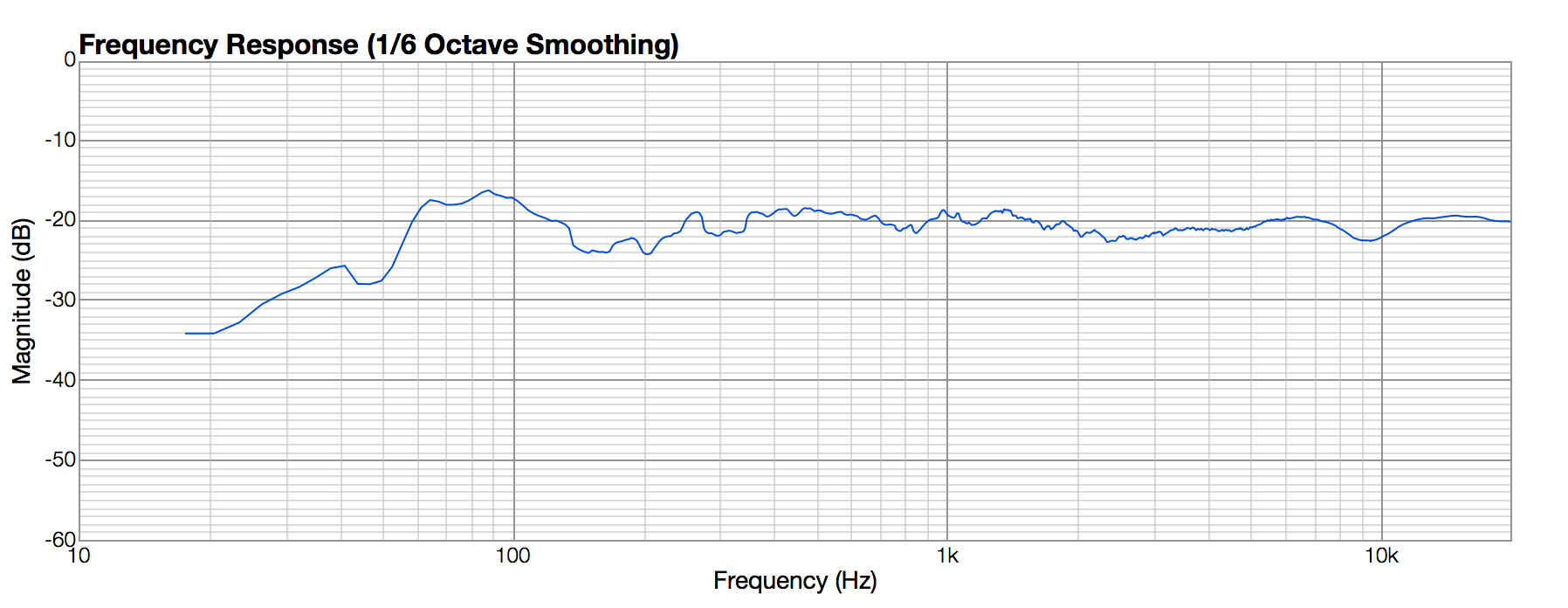

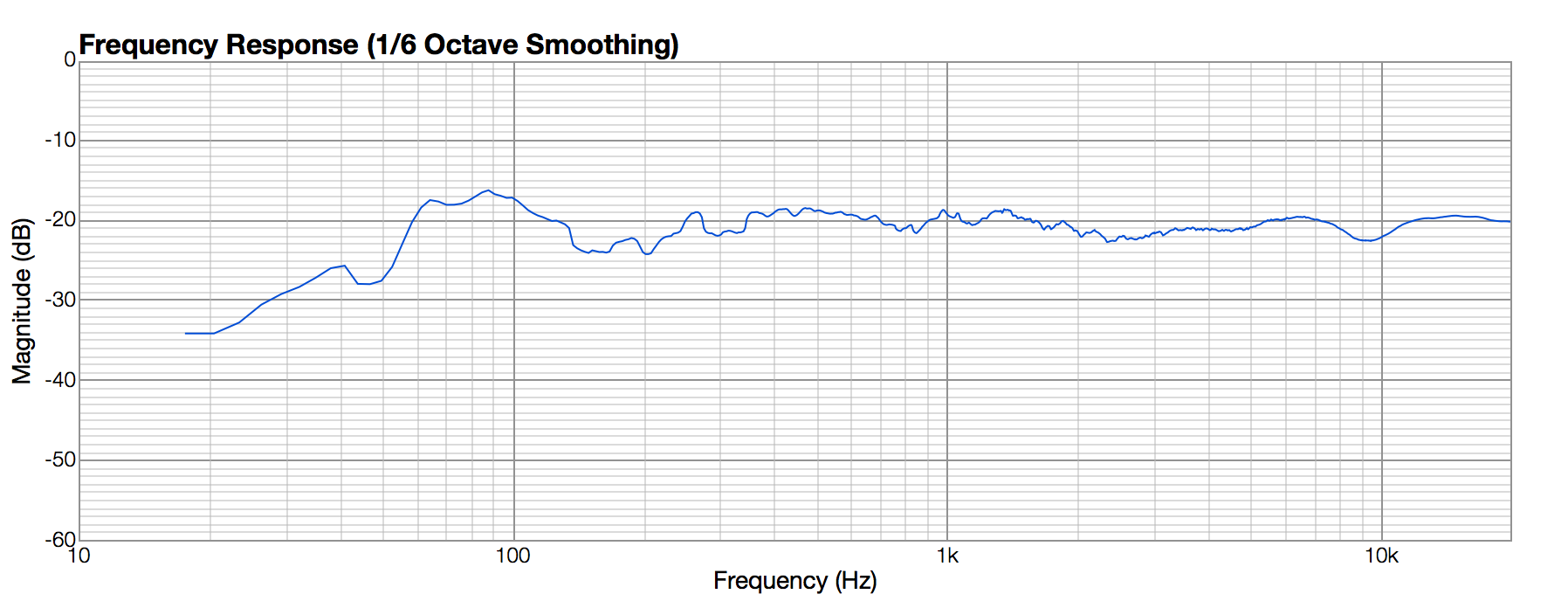

                                    Houston, we had a launch hold this morning while connectivity and gain issues were sorted out regarding the measurement microphone system; a reboot of the measurement program sorted things out, and we have measurements this morning in sunny California. The test setup is not ideal, as I'm just using the back half of the family room, behind the main sofa, with the equipment rack for measurement as far away on the left as I can get it (not very far, umm, maybe 1 meter?), and crossover assembly area and other utilities closer at hand than I'd like. But...
                                    First measurement, 42" distance, at nominal seated listening height.
                                    Understand, we have the usual low frequency dip in the 40-50 Hz area due to boundary distance not optimized in the test position in this room, and there is no diffraction control in place, and no grille assembly - expect the HF response above 8 kHz to be attenuated by ~2 dB after the normal assembly is complete.
                                    Further checks on vertical window wave launch show parameters within anticipated targets.

                                    Ardent Spring Camp base, you have a launch go-ahead for this crossover configuration; do not, repeat, do not investigate crossover adjustments for now until final cabinet configuration and grille panels are ready- we will proceed for now with the configuration determined by computer simulation and confirmed by today's measurements.
                                    Begin primary cabinet disassembly and driver unit removal after completing initial listening checks with "Spiral" (Hiromi Uhera)- main evaluation focus is bass and drum reproduction and of course, piano tonality and dynamics. Then proceed to cabinet preparation for veneering.

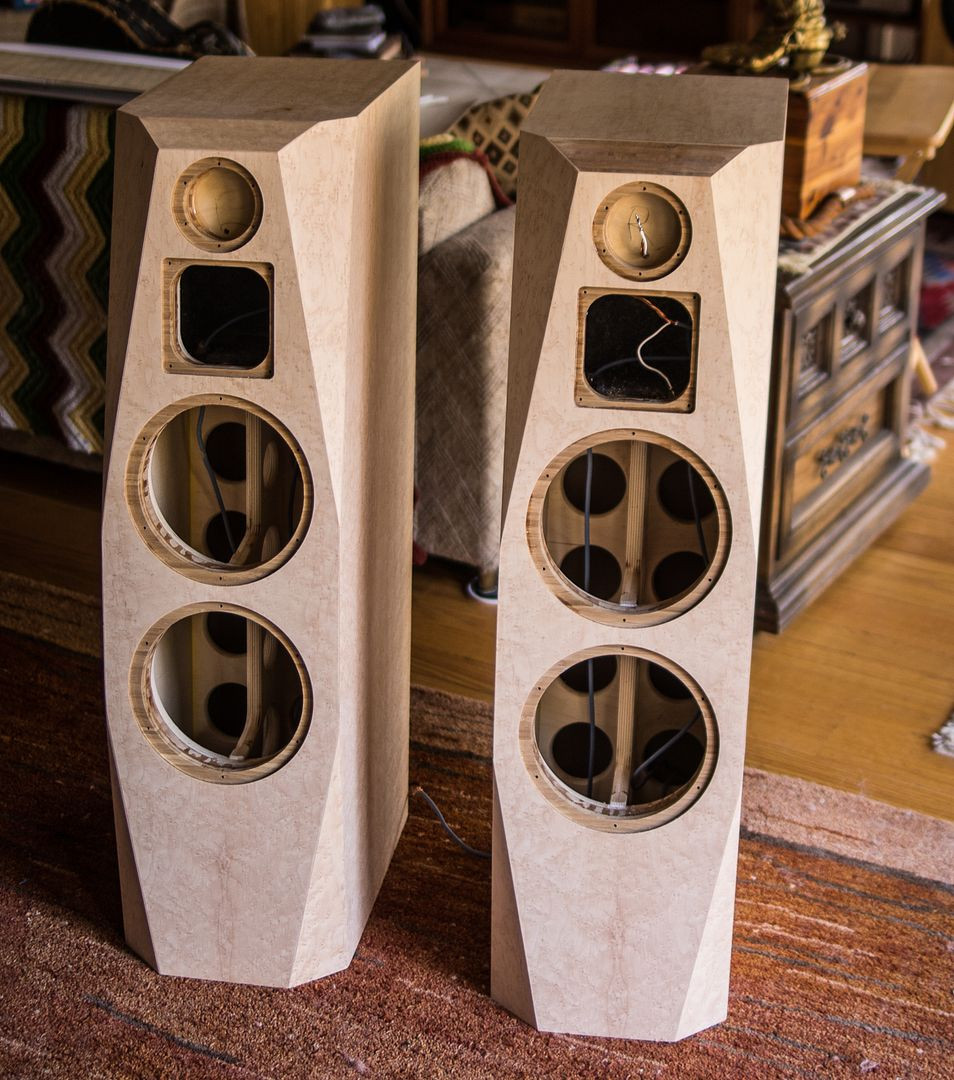

                                        Very cool! What are you driving them with? I'm concerned my receiver wont cut it even as a temporary solution.
                                        Is the plan still to cut a star-like shape for the tweeter in the felt with a chisel? I picked up some grille cloth from solen when I received my fasteners but haven't put them together yet.
                                          #560
                                          Fantastic, very exciting! look at that everything as you foreseen.
                                          So glad you got the week off, enjoy working on those cabs too.
                                            #561
                                            The simmed impedance that Jon posted a while back suggested that these should be pretty easy to drive, if being relatively insensitive. They qualify almost as an 8 ohm load and don't have any difficult phase angles to drive either. With most amplifiers on these loudspeakers, you'll be voltage limited, ie the amp will clip because you've run out of head room, NOT current. This is a good thing. It will mean that you're never going to trigger the protection circuitry and that the amplifier, if of less than perfect design, will sound better. Amplifier flaws tend to be exaggerated when the load impedance drops.
                                            The receiver should be fine.

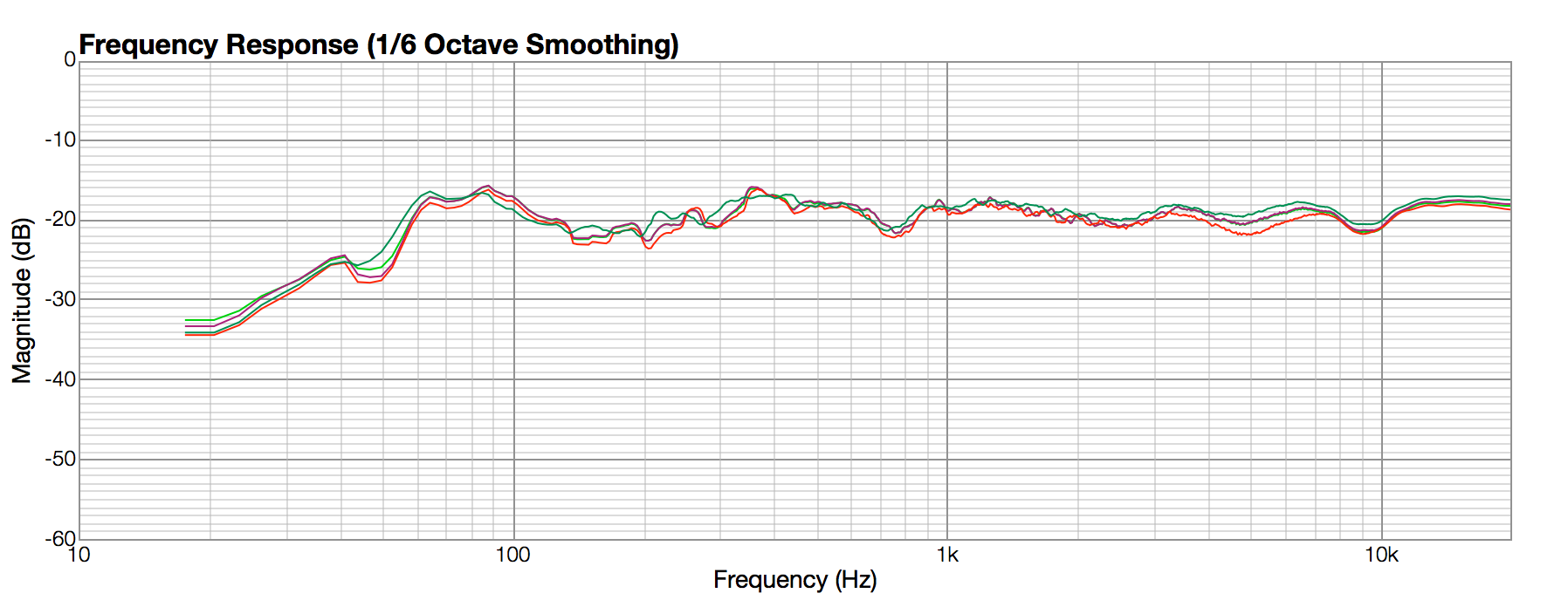

                                                +1. Keep in mind, these are about the same sensitivity as a Modula Mt, but with more frequency extension and much more power handling. Baseline woofer system sensitivity is about 87 dB, and once you factor in about 5 dB of baffle step, then you're sitting at about 82 dB/2.83VRMS. In most of the bass/mid bass range, these are around 5 ohms or a skosh more, averaging 7-8 ohms above 800 Hz. As 5th element pointed out, they're a fairly easy load, just take a few more volts to get going. Under most listening conditions, you wouldn't notice the difference. I'd say 75-100 good watts would be fine under most conditions; if one desires more headroom, well, you only get 3 dB upping that to 150-200 watts. there's a reason people create projects like "FirstWatt" amplifier- I'd recommend the focus on the first 20 or so, of course... :W
                                                The actual setup driving them today was just the TC Konnekt 8 into the Ayre K5 preamp and one channel of an Aragon X3; but that's certainly overkill. As it was, considering I was only driving one speaker, I had that one speaker pretty loud at times, and it wasn't at all stressed. It was hardly an ideal playback setup, just coming off my Macbook into Thunderbolt then Firewire into the TC Konnekt audio interface, and I had the TC Konnekt running at 96 kHz, and everything else was being resampled on the fly by Fidelia to that resolution, whether 44.1 CD ALAC or 176.4/24 AIFF.
                                                One of the things I observed with the original Ardent is that you really had to get back to about 2 meters for the measurements and perceived balance to really correlate well; I didn't quite have room for that today. Where I didn't see what I heard correlating with the plots was in the upper bass-
                                                Where the plot above might give you the impression that things were a bit soft or down in that area, that's not what I heard at all, including on things like the high res PCM version of "Ballad of a well known gun", "Spiral", or "Gaia" or "San Marco Modena" from Consequence of Chaos SACD rip at 176.4/24. The bass is very well defined with very good pitch definition, all up and down the bass scale. "Ballad of a Well Known Gun" is a particularly fun cut with with Dee Murray on bass and Nigel Olsson, Elton John's best rhythm section by far.
                                                I did a few other checks, and with a reverse wiring of the midrange, the expected strong dips in the crossover points are there- phase tracking appears to be spot on. (all drivers are normally wired in phase for this quasi LR3 design- just like for a NatalieP).
                                                Later when the cabinets are more complete and the grille's and diffraction details finalized, I will go back and see if it's worthwhile to tweak the crossover, but frankly, I really liked what I heard today, very musical and very resolved and dynamic at the same time. And that was without the good gear... not even an NAD M51 DAC! Those Wavecor woofers finally bring this to the level I was originally hoping for, along with the 6640 tweeters.
                                                For the next few days, my focus is on getting the driver test cabinet caught up with the other one, and when something is drying or setting, doing other work such as the base fabrication or second crossover fabrication. This afternoon I sanded two sides and this evening one has a fresh coat of epoxy on it. So, I expect cabinet work to dominate the next few days... and I'm looking forward to it!

                                                              Well, I got the back coated with epoxy last night after going out to dinner at our favorite local Italian place; now there's one side left to rough in sand before epoxy, and I have a plenty of materials and time on hand.
                                                              This AM I also ordered a cap I found I was short on for the crossovers, and some nice 5/16" AWG10 ring terminals for connecting to the vampire binding posts. I expect to get the side sanded and coated, then head out to my storage unit to pick up the pieces to start assembling the temporary sprayer setup. I've also got most of the parts either bolted down or hot glued for the 2nd crossover base plate, and my digital protractor to help with crafting the base plates has shipped and is scheduled to arrive on Monday.
                                                              I also plan to bring over the DCD8 and other goodies for sorting out the re-clocking setup while I'm waiting for other stuff to set or dry...
                                                              Things are looking good for Ardent Spring Break! :T And I think we'll put some chicken on the barbie this afternoon.... :W
                                                                #571

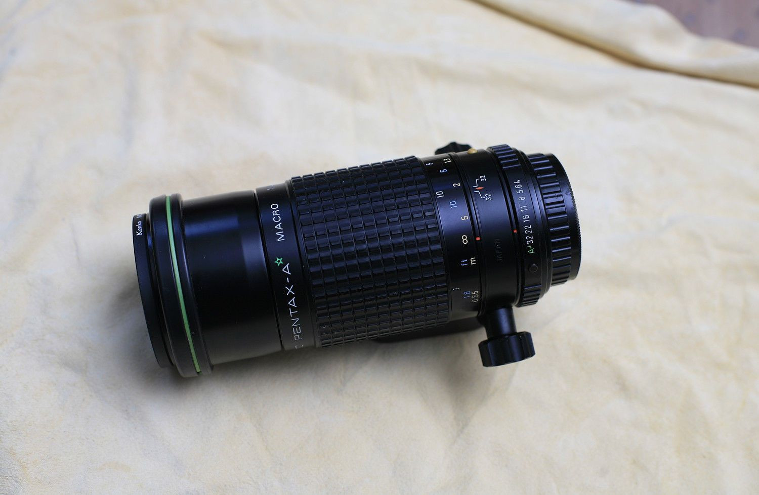

                                                                          And I lost the auction yesterday on the Pentax 200mm Macro lens I was bidding on, but miracle of miracles, there's another listed now, from the USA also.... and it looks to be in even better shape.
                                                                          Doesn't mean I'll win this one either, a last minute snipe with someone determined to bid high and deep pockets will usually take it. (of course that suggests a strategy, but one I don't have deep pockets for...)

                                                                                            Tuesday Spring Break Reort
                                                                                            Ardent Spring Break Report
                                                                                            Yesterday was busy, besides another morning logistics expedition for a couple of optimally sized furniture dollys, I ALMOST finished the veneering for the second cabinet.
                                                                                            I've still got the last beveled veneer piece to go, because we had a planned stop time based on evening activities that I ran up against. That will get taken care of shortly, then it's getting setup for spraying, assembling the spray vent exhaust system and getting the gun setup. I expect to at least get the sanding sealer done today and that sanded; it will probably be too late to do the main spraying on these today, unless things go quicker than I expect. Plus we have a light dinner date out this evening, and a cool front did move in yesterday, though no rain with it.
                                                                                            I did take a some instructional pictures, too, for the official hints and tips build thread, California Dreamin' version. (as opposed to the RCMP version? )
                                                                                            I'm even more impressed with DAR47 doing the veneer job for both of his in just one long day... that's either righteous or crazy, or a little of both! I'm really itching to see how these look after the coats of sanding sealer, because that will show the darkening and contrast of the birds eye, or as much as I'll get from this set.
