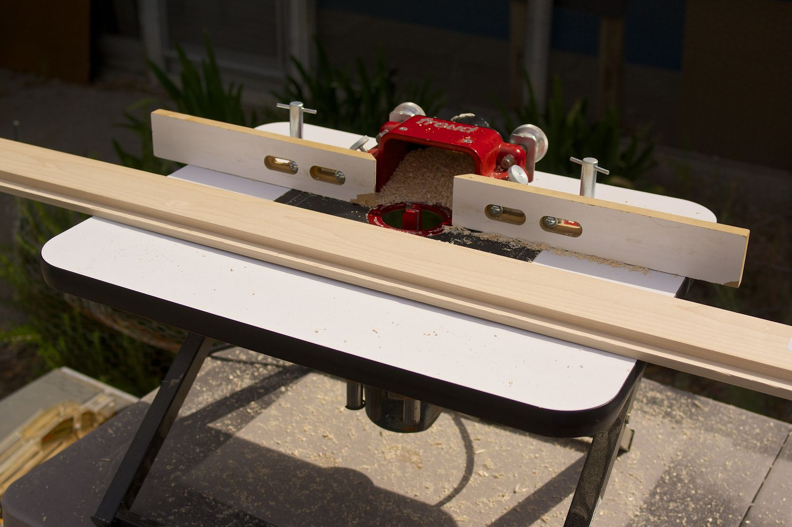

    Continuing one of the off topic topics, not much time to put into this, but on this cloudy morning I took a couple of test shots. With the magnification of this lens, and the narrow depth of field this 200mm macro has, using a tripod and using Live View with magnification is the only way to get at least part of the image in focus! But the overall characteristics seem to fulfill my expectations; this will require some further experimentation and tests to see how well it can do what I want. I expect to be able to use it as a conventional telephoto also; that may be a bit trickier, because focus at infinity is trickier for this type of lens than a normal telephoto.
    Click image for larger version  Name:	IMGP0349_zps7a17acbc.jpg Views:	18 Size:	117.3 KB ID:	934381
    Click image for larger version  Name:	IMGP0346_zps7e3fe009.jpg Views:	23 Size:	244.4 KB ID:	934382
    As usual, Photo-bucket compression is degrading the image but what the heck... you can get the general idea. 100% is a lot nicer.... :B

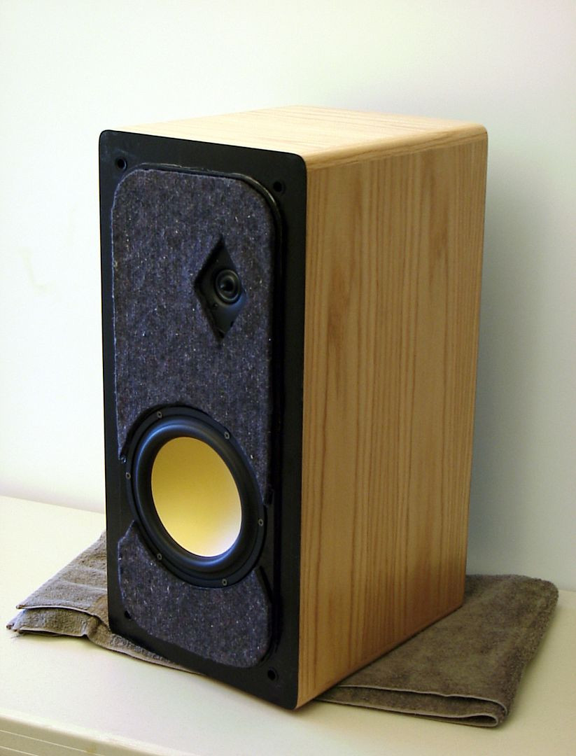

            Yeah, I was planning on some artful surgery with a Xacto knife after using one of my simple drawing programs to create a template guide for the cuts- better than free hand!
            I can easily imagine the situation with the binding posts- that's why I usually use large ring terminals for connecting to the posts. In order to have sufficient bolt thread clearance for the Vampire posts I'm using,

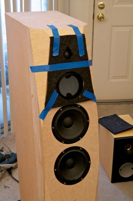

            I'm going to use a Forstner bit on the outside to counter sink the outside plastic cylinder so that it's at least 65% recessed in the back panel. I believe that will allow nicely for connections, while having enough threaded shank for using the 5/16" gold plated ring terminals from Parts Express on the inside to connect to the crossover.
            The other technical point to investigate will the the size and shape of the vertical diamond diffraction control over the tweeter...
            It will be a subset of this, which may be hard to see the contrast between the felt and the tweeter.

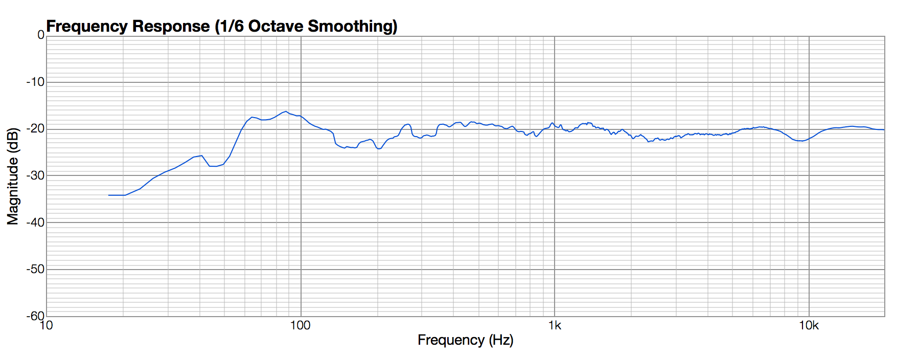

            Worked the same results on the original Ardent as it did for the old M8a "book shelf" project

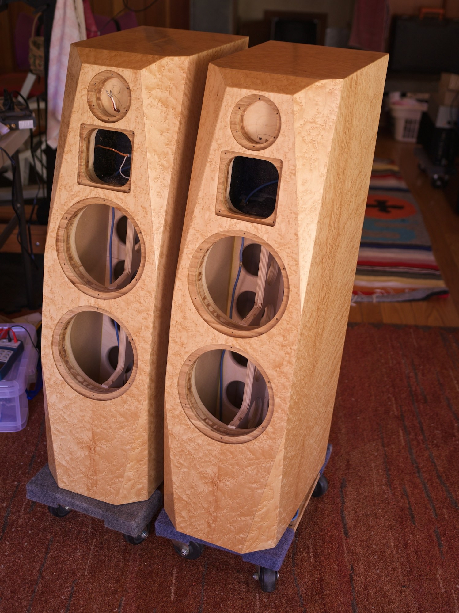

              We pulled the cabinets in for examination after a week of drying/hardening, and removed the driver hole shields. Everything is looking fine, and the paint shop supervisor (shown in pic) agrees they should be ready for final sanding and rubout next weekend...
              Hopefully tomorrow we'll make some progress on the crossovers and new crossover base construction... it's not out of the range of possibility to be actually assembling these next weekend, as I have put in for Friday off as well as the Monday Memorial Day holiday, making for a 4 day weekend!

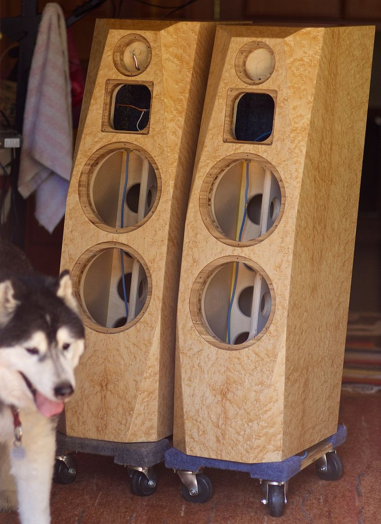

                I read that then scrolled down and went Awww That's one cute dog.
                  #638
                  That dogy looks hot, he should be up here pulling a sled. Maybe not, we got our hottest day of year 23 C.

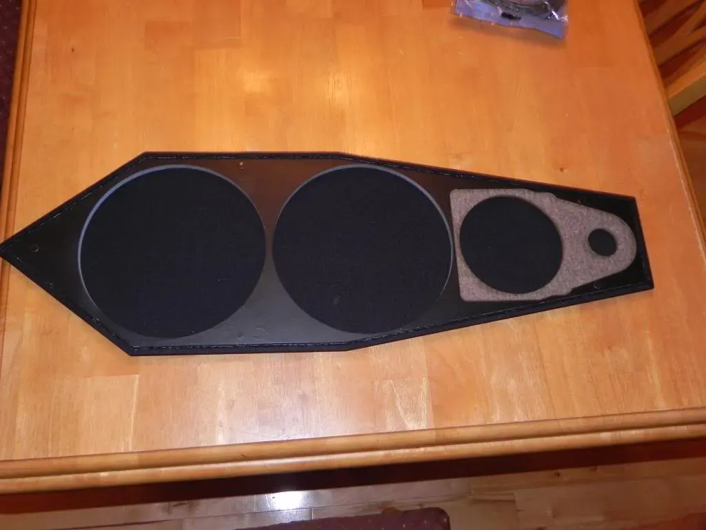

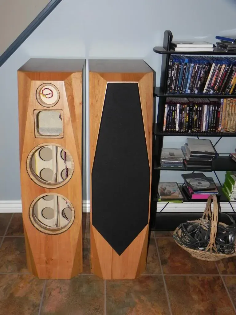

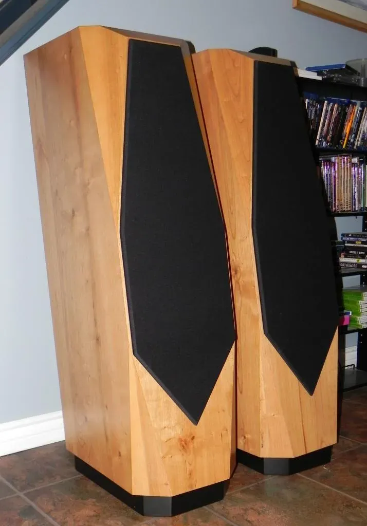

                      Well the grill (system) seems to work, it was a bit tricky tucking the edges in but doable. I just ran a utility knife around to trim the cloth.
                      the magnets grab nice, I'm happy.

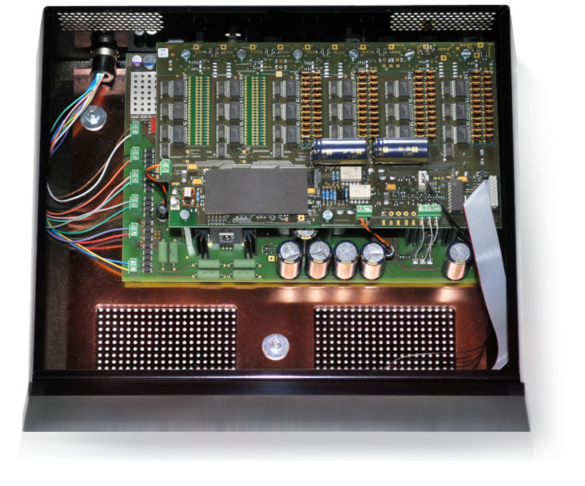

                                        I had one of the first ones using the solid copper baseplate for EMI/noise improvement- I picked it up in early 2013.
                                        It is the most utterly natural and lucid sounding piece of digital hear I've ever heard; my friend and I in Munich listened to a lot of high end DACs, including Meitner, EMM labs, and the MSB Platinum signature, before settling on the TotalDAC-D1. It's an R2/R ladder DAC, using discrete Vishay 0.01% foil resistors. He has two, and one of their music servers, besides. He also uses the DCD8- this is something we'd figure out for him back when he had Antelope Zodiac Golds, as they imaged better and sounded more articulate and smoother at the same time with the DCD8 in the path.

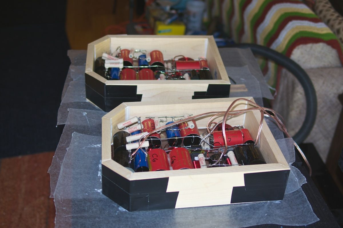

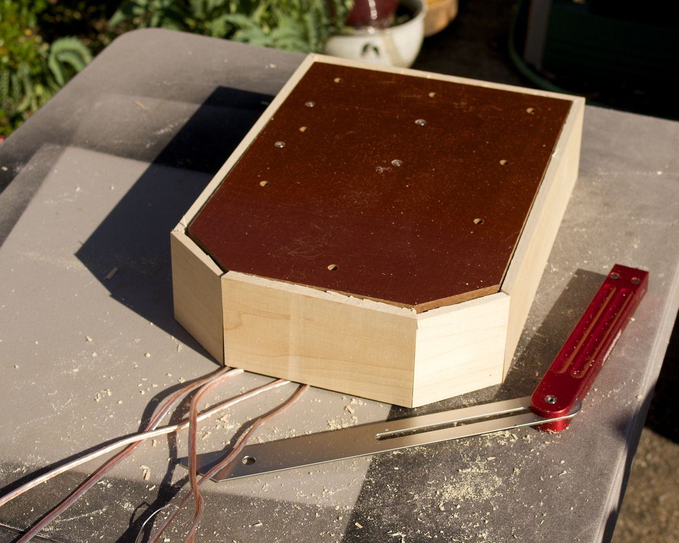

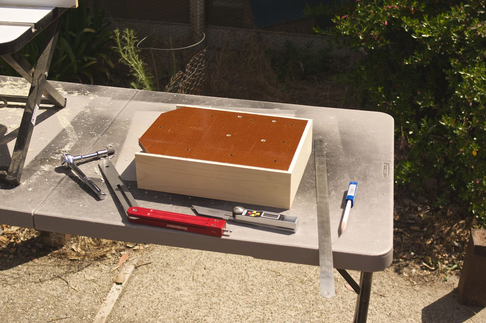

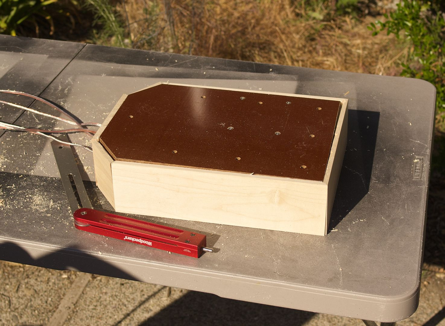

                                                Had quite a few Honey Do's this weekend, things we needed to get done around here, but had some time to make a bit of progress on the bases. One time consuming part was rabbeting out the Maple, an eighth of an inch at a time- you don't rush this kind of hardwood- it's not MDF! This was to make the rabbet that the crossover plate/top base sits in.

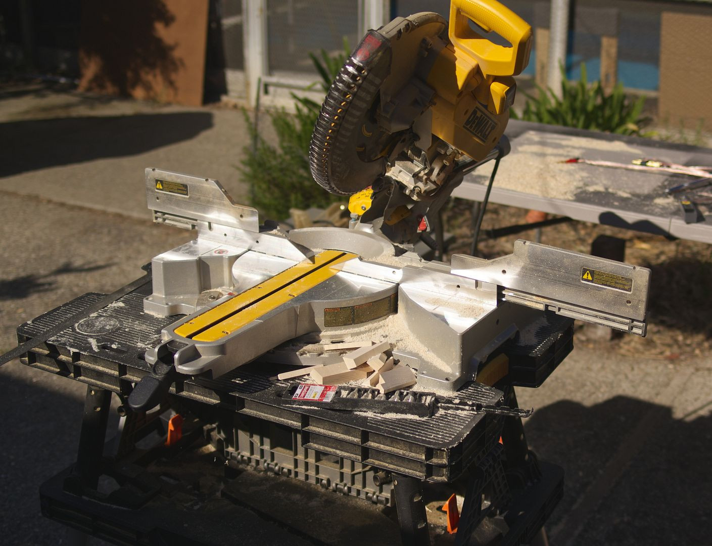

                                                Then it's a matter of sizing the pieces needed and cutting them out step by step...
                                                The DeWalt DWS-760 did it's usual stellar job doing all the tricky cuts with impeccable accuracy (any errors were my own...)
                                                Getting some of the angles was a little tricky, as my battery powered angle reader crapped out (probably not much shelf life with the included batter), but between the manual tool and GF's Jeppeson protractor left over from her flying days, I was able to sort things out OK (remember, I only play a woodworker on Television...) (and on a forum or two).
                                                I made these out of Maple with the idea that I might want to finish them natural, (in spite of the time that would take) but after pondering the first set of Ardent's with natural maple bases, I'm thinking black may be better, as well as much faster.
                                                Four day weekend scheduled next, so with any reasonable effort, and no unexpected issues, I expect stereo noise by Sunday or Monday!

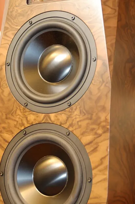

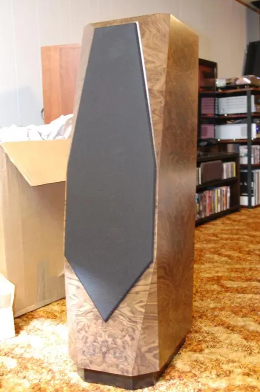

                                                            Amidst unpacking I found a little time to work on the speakers. I assembled one grille, assembly was surprisingly easy. I'd like to buy the DIYer who first used window spline to hold the cloth a beer.

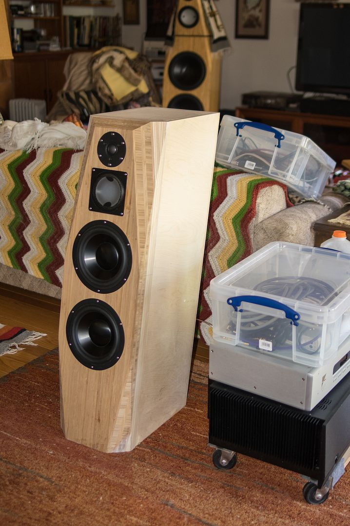

                                                            Also installed the woofers, I'd recommend those socket head cap wood screws, they gave it a nice touch without having to mess with t-nuts and the like:

                                                                      Wavecor version (just for driver testing, unveneered)
                                                                      the older ones look skinnier, but they're not. They're on taller bases, and of course there's the difference in the woofer diameter and positioning.
                                                                      The crossover in the newer version is simpler and lower cost, and much smaller physically. I stole from myself from the NatalieP design. The concept would be adaptable to the older driver configuration, BUT, being an opened ported cabinet, you have to deal with the vertical column resonance, so there's an extra LCR that would be required. Really, the new configuration is much better, IMO.
                                                                      For something a bit more reasonable in cost to build, take a look at Chris's Nebbiolo. I don't think he's quite finalized the crossover details, but I think he's getting close...

                                                                          Well, I did get the 2nd crossover wiring finished- then I was ready to start on the baseplate glue up, but all three tube sets of Loctite Marine Epoxy from Home Depot were bad- the hardener was literally hard, and couldn't be pushed out the plunger- this is a frequent problem with this product from Loctite.
                                                                          Well, I took a run down the Ace Hardware in Danville/Alamo, just to see what they had on hand, and they did have a few sets of their own house brand Marine Epoxy which seem to be made by Devcon. I picked those up, and they worked fine, and better than the Loctite stuff does when it is working- of course, there wasn't enough at that store, so a run up to Walnut Creek to another store was needed. That worked out OK, in the end, but put me way behind my self imposed schedule.
                                                                          I can hear the comments now, this is what happens when you let a wires and sparks guy loose and you wind up with high grade epoxy and Gorilla Duct tape for clamping... because he doesn't have the right miter clamps on hand and doesn't want to drive 40 miles to pick them up from at home...

                                                                                    Additional work on bases done- including a little bit of fill work with epoxy. Crude, rude, but strong.

                                                                                    As much as I went over the sims and thought about things and tested the reverse phase behavior, I think we're in pretty good shape- might need some small resistor trims- but I'd suggest holding off until next weekend - I'm not sure that I'll get to the measurement phase this weekend.
                                                                                    Reviewing the initial result, my concern is to see how things look after the diffraction control (should take care of the dip in the top end) and grille cloth (will lower level 1-2 dB above ~8kHz).
                                                                                    That may leave us with a very slight dip in the 2-3 kHz area (not very close to a BBC dip) and for most people with most electronics and modern recordings, it's probably best to leave that in... Then, if my thinking is right, we'll have a pretty smooth flat transition from the mid to the top end.
                                                                                    I will measure these outdoors, and its my intention to be ready to do that by next weekend. At this point, if anything changes, it's likely just to be a series or shunt resistor, which likely COULD be tuned just by adding a high value resistor in parallel. SO, if you're getting itchy, it's likely pretty safe to order now (I'm not planning on changing any of the major components after my initial measurements and listening). But safest of all is just to wait another week.
                                                                                    This has been my Home priority to get wrapped up, and it's good to be closing in on the final results...
