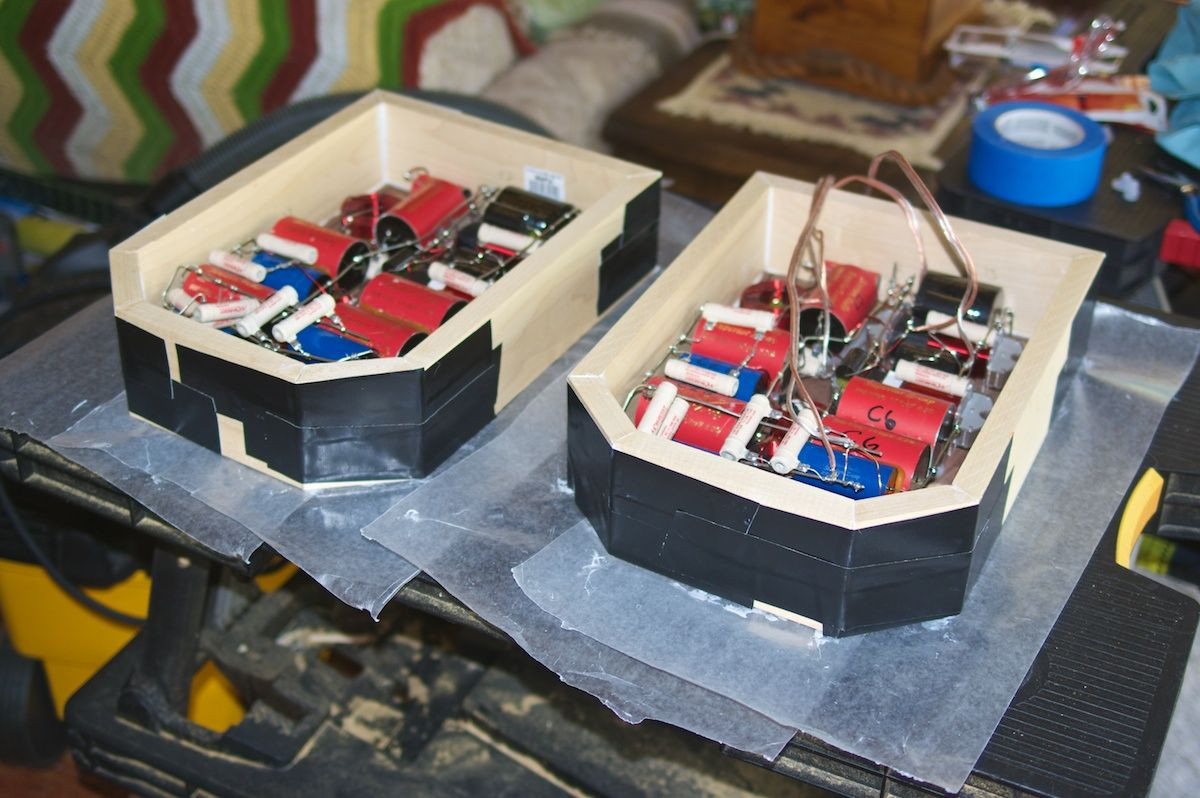

    Well, just had too many chores and errands to do this weekend- definitely slows me down when the only free time is on Saturday and Sunday. Not finished, but made some real progress, shows the general concept which looks like it's going to work, but doesn't give me the room I would like for using feed through connectors and what not- going to just have to drill holes in the base for feeding through the Cardas SE-11 and sealing with hot glue.
    Click image for larger version  Name:	CrossoverConstruction_zps7354e772.jpg Views:	1 Size:	276.0 KB ID:	934556
    My gravestone epitaph will likely say something like "he lived and died by hot glue... a true believer!".
    The tweeter crossover is in the lower left corner, the woofer crossover is in the upper left corner, and everything else is midrange! :B
    Main input and ground buss wires are just AWG 12 tinned solid copper.
    Built up, ready to install

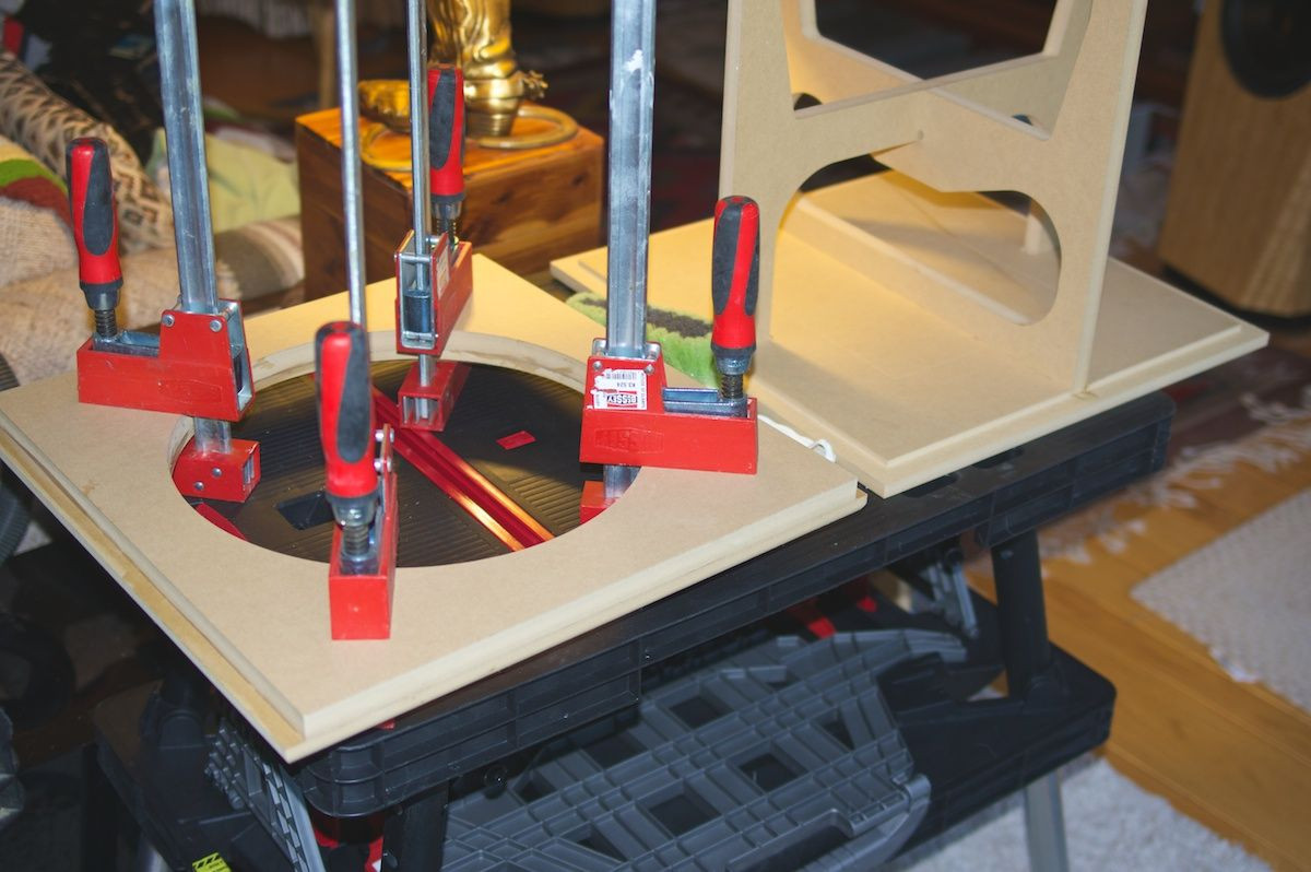

      Well, I did get the 2nd crossover wiring finished- then I was ready to start on the baseplate glue up, but all three tube sets of Loctite Marine Epoxy from Home Depot were bad- the hardener was literally hard, and couldn't be pushed out the plunger- this is a frequent problem with this product from Loctite.
      Well, I took a run down the Ace Hardware in Danville/Alamo, just to see what they had on hand, and they did have a few sets of their own house brand Marine Epoxy which seem to be made by Devcon. I picked those up, and they worked fine, and better than the Loctite stuff does when it is working- of course, there wasn't enough at that store, so a run up to Walnut Creek to another store was needed. That worked out OK, in the end, but put me way behind my self imposed schedule.
      Click image for larger version  Name:	IMGP0380_zpsff7e788a.jpg Views:	1 Size:	230.0 KB ID:	934406
      Click image for larger version  Name:	IMGP0381_zpsae00be08.jpg Views:	1 Size:	178.6 KB ID:	934407
      I can hear the comments now, this is what happens when you let a wires and sparks guy loose and you wind up with high grade epoxy and Gorilla Duct tape for clamping... because he doesn't have the right miter clamps on hand and doesn't want to drive 40 miles to pick them up from at home...
