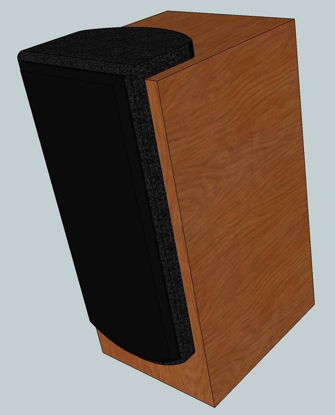

    With all of that being said, here's the "look" that I'm going after:

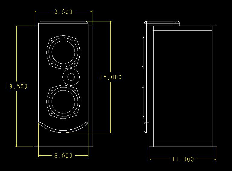

    Here's a shot of the dimensions:
    And here is an image of what they are SUPPOSED to look like when they are done:

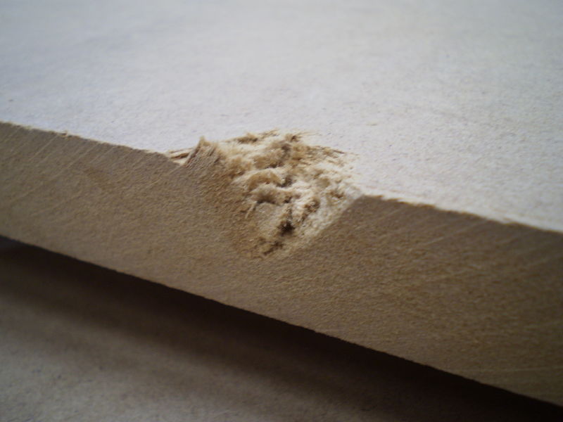

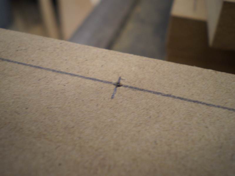

      But, I cut on the wrong side of the mark for one of the pieces, and I don't have enough pieces big enough to remake it, so I had to join two pieces together to make a bigger piece that I'll then cut down.

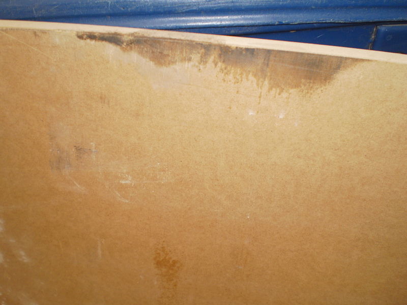

      I said that the lumber that I got was pathetic. Here were some shots that I took after I had it cut up, and these are some of the better areas!
      This type of stuff was all over the back of the sheet:
      and this was one of the lovely banded edges:

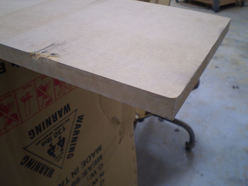

      This is what happens when you let a piece fall out of your hands while your table sawing, and it hits the edge of the cast iron table saw table, which is pretty much unforgiving. For some reason, I was having a hard time today holding onto the MDF. It was like the sawdust on there was making it super slick and it wanted to fall out of my hands. I didn't experience this when I built my Stentorians, because it was cold outside, and I used some thin rubber coated gloves, and they gripped onto the MDF even when it had sawdust on it. But this is an OUCH!!! Luckily, I was able to cut this piece out of the finished boards, so it wasn't in play:

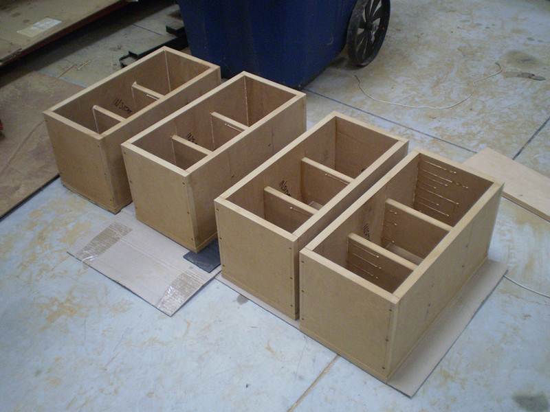

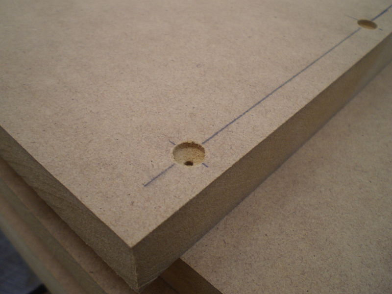

      When I did the build on my Stents, I used screws to hold the boxes together while the glue dried. That really worked out well for me, since I never did use any clamps to hold it together. While I do have some clamps, I'm more or less clamp poor at the moment. Because of the success that I had with the Stents, I decided to do the same thing again here. I lay out the lines, and then drill a small hole, and then a large hole for the head of the screw to go into. I suppose that you could say that it takes longer to do it this way, but the payoff comes in the end, because you can really put the box together quick, because you don't have to wait for the glue to dry. Here's a picture of one of the holes:

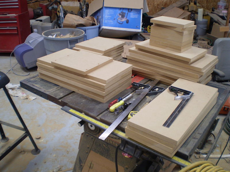

      Here was the progress at the end of the day. Not a bad pile of lumber, minus the two panels that I still need to trim down to size after the glue is set:
Name:	P3030027 (2)_opt.jpg

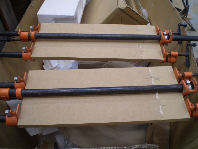

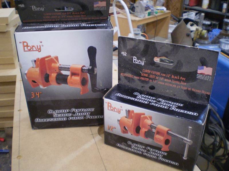

            ... While I do have some clamps, I'm more or less clamp poor at the moment. ...
            Just to prove that I AM clamp poor, here's a shot of EVERY bar clamp that I own holding the panels together:
            I do have 3 hand squeeze clamps (don't know what they're called), but I never have used them for clamping up boards. Pipe clamps work a lot better.
            Hummmm.... That reminds me... Somewhere in the shop, I have another set of clamps that are NOT on a piece of pipe. I should probably find that sometime and get a piece of pipe in there...

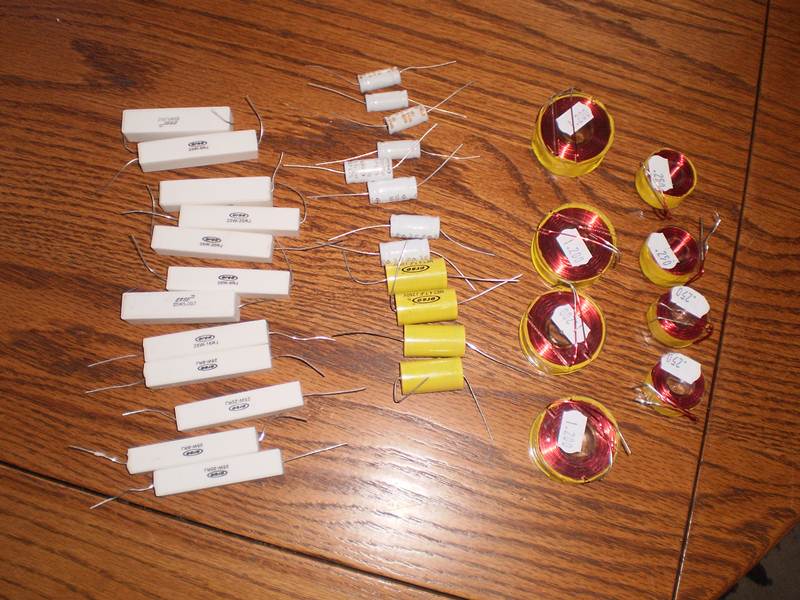

                More Parts!!!
                Mailman arrived today with more parts! WOOHOO!!
                This is the first time that I've ordered something Erse. Seemed to work well, and the shipping was fast. It was actually cheaper for me to order these type parts from Erse, even with shipping, than it was for me to order everything else from PE with FREE shipping. They did short me one part that shows on my original order, but is not on my packing list as shipped or on backorder. I sent them an email, and I'm confident that they'll take care of it.
                Here's the stuff that I got today:
                I still did order my drivers from PE, though, which is always great as well. In this case, I have the tweeters already, but the drivers are backorder until MAY 5!!!:E:E:E
                At the rate I'm going and want to go on this project, I'll have the cabs done and waiting for drivers for a while!
                Started laying out the crossovers, but then I had to go and get the wife from work...

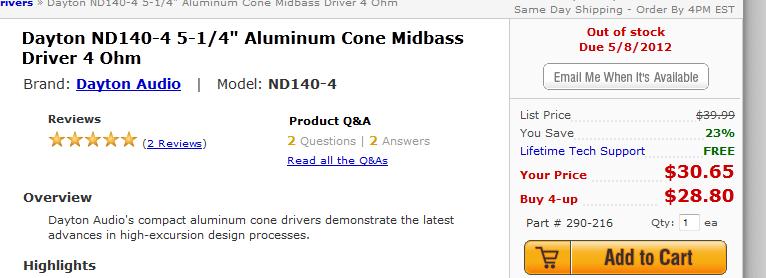

                  May 5th? Och. That's rough. Hopefully something changes and you get them sooner.
                  • CADman_ks
                    • Jan 2012
                    • 497
                    May 5th?...
                    OH!! My bad. It's NOT May 5th. IT'S MAY 8TH!!!! :banghead:
                    Maybe it's the Chinese New Year or something...
                    What ya gonna do??? :huh:

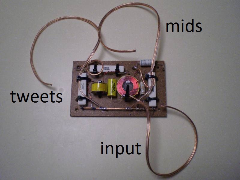

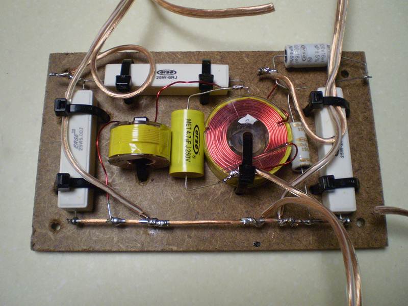

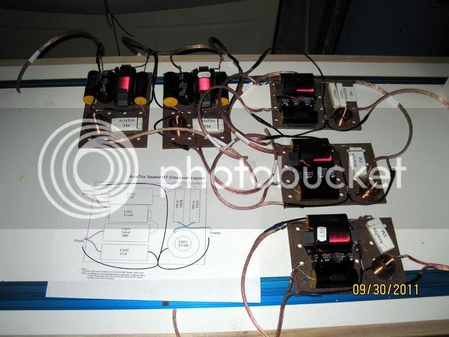

                      Busbar question...
                      I like to have decent looking crossovers. I know. It doesn't make the speakers sound any better, and no one ever sees them, BUT, I would know.
                      I've looked at the schematic, and the pics of ---k---'s crossover, and I'm going to rearrange things a little bit differently. However, the size of the resistors, doesn't lend itself well to a whole lot of variation. Those things are HUGE compared to all of the other components.
                      I'd like to use a solid piece of wire for my negative busbar. Something like a piece of 12GA from a piece of romex. I'm assuming that this should be the same as using stranded wire like ---k--- used.
                      Before I proceed, I just wanted to make sure...

                        12ga? Where's the overkill in that?!
                        Yeah, that'll work out just fine. Just keep the inductor relationshiphs correct relative to each-other and you'll be all set.
                        And let's see, 5 and 8 seem to be numbers that sync with this project a little, no? At least, I do think that Ocho and Cinco ... *ahem*
                        Anyhoo... Maybe there's a reason.
                        • CADman_ks
                          • Jan 2012
                          LOL!!
                          No overkill, just some pieces of Romex I have laying around. 8)
                          Ya know, someone once told me, "That if something is worth doing, it's worth doing right." (It was probably Confucius that told me that 8))
                          Maybe that's the MO that I'm operating under making the XO's look nice? I don't know.
                          And, while it's worth doing "right", there's still a part of me that is a cheap bastard, and I'm always looking for ways to recycle "crap" to make it into something else. And, I have a WHOLE bunch of pieces of 12GA Romex about 24" long from when I installed the main panel in my shop. I couldn't bear to throw them away, so I've kept them all this time. I have to use it for something! Hence the need to use some 12GA Romex for a busbar.
                          Should be stout, not??? :T

                            Are you calling my crossovers ugly??? :P just kidding.
                            There are probably an infinite number of ways to arrange the crossover. Feel free to lay it out differently. I think laying these things out can be a bit of an art form. When I do mine, I'm trying to balance: 1) logical layout that can be easily checked against the schematic, 2) size, trying to keep it as compact as possible, 3) spacing and arrangement of the inductors. It doesn't always work out...
                            If you split the mid and tweeter crossovers up onto two boards, it might make it cleaner. I don't know what you're look for..
                            Be careful with the resistors. IIRC, the leads aren't the strongest and I broke several when tweaking. I think I was able to keep all Erse in the photos, but the a few of the boxes have NTE resistors from Fry's. No biggie for me, but if you don't have a local supplier of resistors....
                            In general, I don't see a problem with using solid wire as long as you can get a good solder connection to it. But be careful with thick wire such 12GA. It takes a lot of heat to get thicker wire to solder. Some of the parts you're soldering to it are very small and can't always take that heat. With the right techniques, I don't think it is a problem.
                            • CADman_ks
                              • Jan 2012
                              • 497
                              Nope. At the end of the day, yours work JUST as good as mine, and you'll spend a lot less time on them than I will. All it really needs to do is work.
                              ...I think laying these things out can be a bit of an art form. ...
                              This is an excellent way to say it, and in some respects, that's sort of where I'm going with it. Making them look pretty, in some sick sense of the word, makes me feel like I'm feeding my artistic side.
                              That's good to know on the Erse resistors.
                              I'm most concerned about getting them together. I think that I should be able to tell if the solder joint is cold lapped. I'll probably scuff up the wire as well with a Scotch-brite or sandpaper, so that the surface is a little bit rougher. That should help as well...
                              Thanks for the input!!!

                                I used a shield, sinks, and a torch to solder the cap banks in the WWMTM to the bus wire. And separate flux. Cleaning the copper is a must. I have a much better soldering setup now so might not need the torch.
                                • CADman_ks
                                  • Jan 2012
                                  • 497
                                  Maybe this won't work, but I have a big Weller soldering iron that I was going to use to do this with. It's appears to get things pretty hot pretty quick. Not torch, quick, but still pretty quick. I used to have a locking pair of needle nose somewhere, that if for no other reason I could use a sink. I wonder where those are. ???? :scratchhead:

                                    I use a big Weller soldering gun now. Try it and see how it goes. We're probably being overly cautious. At least your not trying to weld 12GA wire to a tweeter. That would could be very very difficult. Solid wire might be easier than stranded.
                                      Sorta. 12ga isn't much fun to solder, ever. Stranded heats up the close strands very quickly, and once the solder flows it carries the heat, so it helps. But often as not you still get half a joint that's good, and half that's mediocre.
                                      The key for me is making sure I use solder only to hold the joints together, not to make the connection.
                                      The prettiest crossover layouts I've seen tend to use solder to actually make the connection - no twisting of wires prior, far too often. I test every crossover before I touch the solder. Do this, and it'll be fine.
                                      DO use a sink on caps. Because if you twist first, you can not heat up the copper and THEN touch the cap wire to the hot spot. Any old pliers with a rubber band around the handles can do the job.
                                      • CADman_ks
                                        • Jan 2012
                                        • 497
                                        OH CRAP!!! This is how I made my Stent XO's. I used the solder to make the connection. As far as I can tell, the XO's are working, or should I say, the sound is coming out what appears to be good to me. I never thought that this would be a problem.
                                        But, if I don't actually use the solder to make the connection with the busbar, I don't see how else I would do it. In that case, I can't actually twist them together.
                                        DO use a sink on caps. ...
                                        Good to know. I did not use a heat sink on my Stents, and probably should have. I did find those clamping pliers, so I can use them...

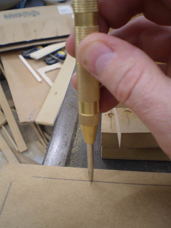

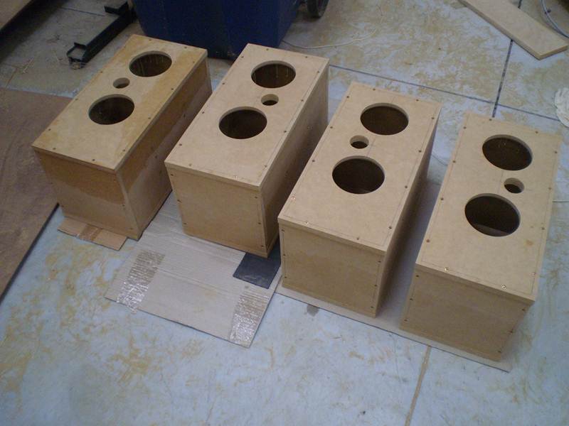

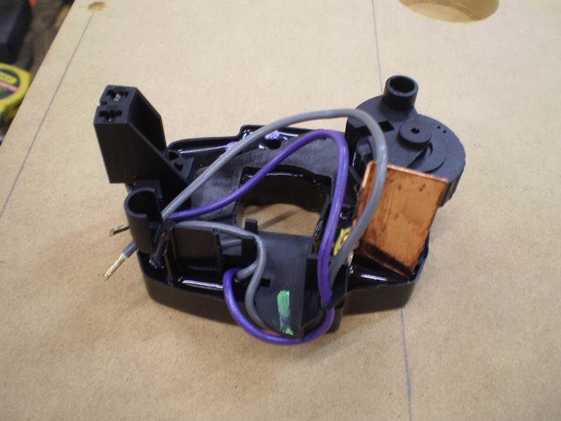

                                          Last nite I was able to get all of the main cabinet pieces completed. Now all I have to do is just assemble them. Supposed to be cold here over the next couple of days, so I'll either need to wait, or do it inside.
                                          I had to fix my router last nite before I could continue using that. I posted here that I was having troubles with it:
                                          I got the part a couple of weeks back, and I had never needed my router, up till now, so I put it in last nite. Here's what an electronic module looks like in a DW621, if you're never seen one:
                                          Click image for larger version  Name:	P3060041_opt.JPG Views:	4806 Size:	44.8 KB ID:	857336
                                          But one thing that does suck about life, is that it sucks getting old. I can't remember crap, anymore, or so it seems. I could NOT find my home-made circle cutter for my router. I KNEW where it was, and I knew where it was supposed to be, and it was not there. I "remembered", that I had put it some place "special" the last time that I used it, so that I didn't lose it. It was lost.
                                          BUT, as I searched around in vein, for the missing jig, I DID find those missing pipe clamps that don't have the pipe on them, and a bonus, I had TWO that were missing, not just one!!:
                                          Click image for larger version  Name:	P3060052_opt.JPG Views:	2506 Size:	64.4 KB ID:	857337
                                          I FINALLY did find the circle jig, and it was NOT where I thought that I had put it, and it really wasn't were it should have been. I don't really know what I was thinking when I put it where it was. After getting it set up for the new circle size, it worked pretty well. The rest of the evening was pretty uneventful.
                                          I could show you the pile of lumber, but it pretty much looks like the last pile, it just has some holes in it now...

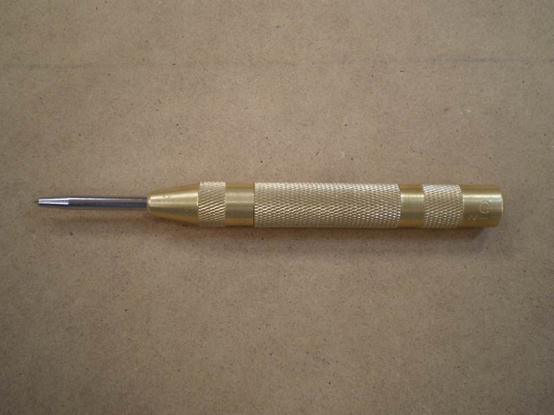

                                            Tool recommendation...
                                            I was using this tool last nite, and I thought that I would pass this along to others. You can take it or leave it.
                                            As I stated early on, I like to put cabs together with screws. But, one of the things that comes with that, is that you have to drill a LOT holes in the panels before you start, you our risk splitting out the MDF. Even I were using birch plywood, I would still pre-drill everything.
                                            One of the tools that I use to mark all of the holes with is an automatic center punch that I picked up from HarborFreight for a mere couple of bucks, literally:
                                            In order to use it, you just line up the point to the mark and push down. A spring loaded "action" in there drives the center punch into the wood:
                                            What you're left with, is a nice little "dent" in MDF, that grabs your drill point rather nicely and centers up the bit:
                                            Even if you don't use the screw together cab method, this is still a great tool to have in your arsenal. Puts a nice dimple in MDF or birch, and it's very quick to do a bunch of holes.
                                            CADman_ks

                                                  CAP tolerance???
                                                  I was getting ready to build my XO's tonite, and all of the sudden I realized that one of my resistors is a 16ohm, and not a 5!!
                                                  I don't understand. I have (4) 6ohm, which I need, but I have (3) 5ohm, and (1) 16ohm. I could understand if they read the 16 as a 6, but somehow it's in place of a 5.
                                                  So, at the minimum, that means I can't build at least one XO, until I get that replaced.
                                                  But, since I had the multi-meter out checking that, I decided that I should check all of the components.
                                                  The resistors are pretty close, and probably within tolerance.
                                                  The MET caps (4.77uF) are very close, and definitely within tolerance. However, the NP caps are much higher than what they are supposed to be. I have some 8uF that are running 9.5, and I have one 16uF that is running 19.4! Is this normal for NP's?, and can I get them replaced, or should I even worry about it? I don't think that I have one NP cap that is even inside of the tolerance that they state on the cap of +/- 5%.
                                                  CADman_ks

                                                    NP caps do that. It's the main reason I recommend poly.
                                                    • CADman_ks
                                                      • Jan 2012
                                                      • 497
                                                      I take it that means that these will be OK to use, but obviously not ideal?
                                                      Is it really off that far, or is that my meter won't measure them correctly?

                                                        Crossover building nite...
                                                        ...well, at least a start. It did get cold(er) here tonight, so I moved operations inside.
                                                        I did finally manage to get one done. One of four, and at this point, I could only do three anyway, since I'm one resistor short now.
                                                        I gotta tell ya. I have no idea who the flippin' idiot was that suggested the idea of a busbar, but that guy has NO clue what he's talking about. :crazy:
                                                        All in all, I guess, once I got going, it's not really all that bad. The resistors in this crossover don't really lend themselves well to any kind of decent placement, so at the end of the day, I basically have the same layout as the original design, but with a busbar. :B
                                                        I personally think that my Stent XO's look better than these, but I guess they will have to do.
                                                        Here's a pic of the completed XO, and what the different circuits are for:
                                                        Close-up of the completed job, including the now infamous 12GA busbar:
                                                          I did find the owner's manual for my meter, and the tolerance on this range of capacitance values is +/- 3.5% for my meter. So, I guess that makes my TOTAL percentage that I could be off 8.5%.
                                                          Obviously, it's not a high dollar meter. Just one of those digital RadioShack models. I think that this is the first time that I've even tried reading capacitance.
                                                          The readings did come down a little bit after I changed the batteries in it as well. I didn't realize at first that the low battery indicator was on. But, even after changing batteries, they were all still higher than they should have been....
                                                          CADman_ks
                                                          CADman_ks
                                                          - Stentorian build...
                                                          - Ochocinco build...
                                                          - BT speaker / sub build...
                                                            I had the NPE caps in mine too. Mine were probably just as far off... or maybe not. I did NPE to hit a specific price point. But poly or mylar are a better.
                                                            If it were me, I would twist the crossovers together and listen to them. After I had listen to them and was satisfied with the sound, then I would solder them up. If something doesn't sound right, then consider upgrading the caps.
                                                              I knew that you had used the same caps, and that was part of my thought process as well, that yours were probably off as far as mine. CJD, also said that it was typical for NPE's to be off. I figured with all of this, it couldn't be that bad. Yours worked.
                                                              But, it's ultimately too late at this point, because I got all of the crossovers done tonight, except for the one that's still missing the resistor. And, I don't have drivers at this point, either, so I just went for it.
                                                              Here's the pics of the completed crossovers:

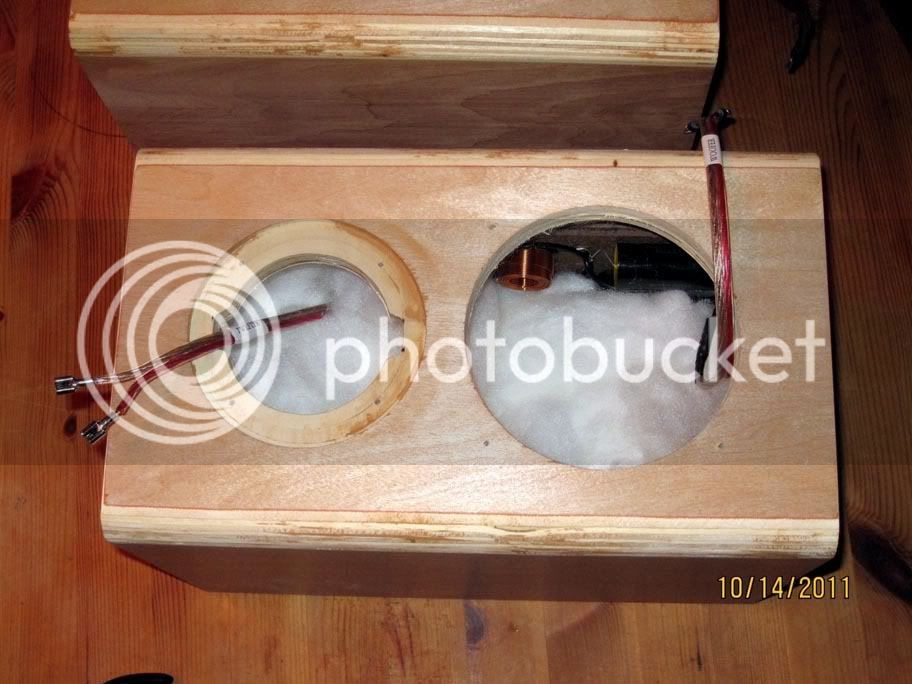

                                                              • BeerParty
                                                                • 475
                                                                A small suggestion: you might want to put labels on the wires indicating which is input, tweet, and woofer. I just used some old address label material for mine.
                                                                Here is a photo showing one of my crossovers installed with the labels:
                                                                Last edited by theSven; 09 March 2023, 19:18 Thursday. Reason: Update image location
                                                                  LOL!
                                                                  I did that on my Stents when I built them, and I'll do that here before I install these in the final boxes. At this point, I know EXACTLY which run is which.
                                                                  Over the last two nites, I've become pretty intimate with these things, especially after building (4) of them!!!
                                                                  You can see in the picture where I've at least marked the "+" side of the wires that I have ran at the moment. That will at least keep me from figuring that out later on as well...

                                                                          The 5 crossovers I build for my AviaTrix build:
                                                                          Last edited by theSven; 09 March 2023, 19:19 Thursday. Reason: Update image location

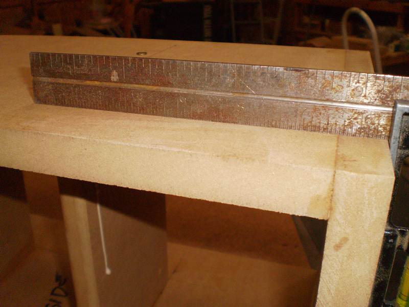

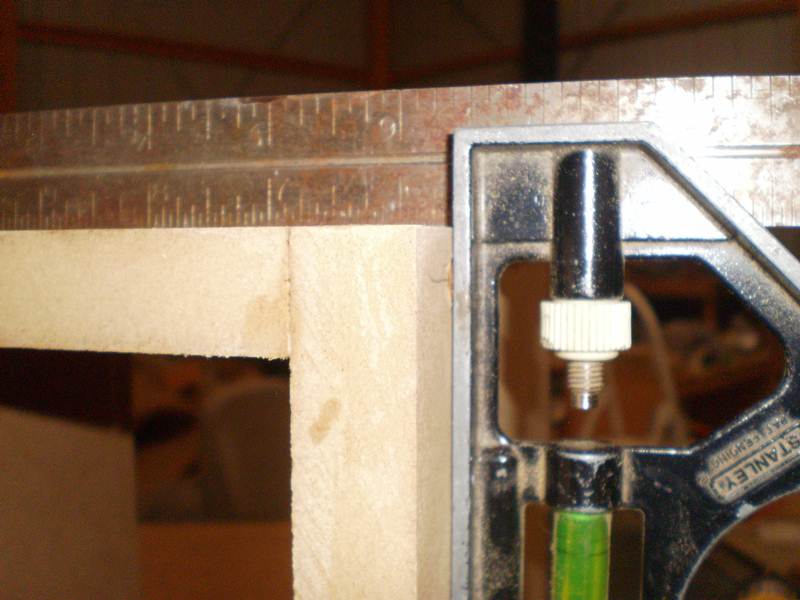

                                                                                Glued and screwed...
                                                                                Today, I was able to get my boxes completed in the rough. I still need to trim the fronts and backs, since they were oversized, and after that I need to fill holes and sand smooth.
                                                                                Here's some pics of today's progress...
                                                                                It's kind of hard to tell in this picture, but my joints are very square. It does pay to take the time to get everything 90deg BEFORE you start:
                                                                                Other end of tri-square:
                                                                                Also, when everything is square, you end up with boxes that are square as well. These measurements are from one corner to the other, and then opposing corners. This particular box, they are identical. All (4) of the boxes were +/- .03 from the measurement that you see here, and no one box was more than about .04 out corner to corner:
                                                                                Dimension 1:
                                                                                Dimension 2:
                                                                                (continued in next post)...
                                                                                Last edited by theSven; 09 March 2023, 19:20 Thursday. Reason: Update image location
                                                                                CADman_ks
                                                                                • CADman_ks
                                                                                  • Jan 2012
                                                                                  • 497
                                                                                  Glued and screwed (continued)...
                                                                                  Here's a picture of the boxes with all the sides on, and the tops off. I finished machining the remaining parts for the accent pieces while these dried a little bit before I put the tops on:
                                                                                  Everything that you see there was done with this ONE clamp, and I could have done it without this clamp, if I would have had to. The clamp just made life a little bit easier. The only time that I ever used the clamp was when the side pieces were splayed OUT instead of in. In that case, I would put the clamp on there to tighten it up, so that I didn't have to hold all of that with my hands. On the cabinet where the sides were splayed in slightly, I would need to bow them out to get the other side in, and in that case, a clamp is not needed:
                                                                                  And here is the picture of the all-glued up cabinets:
                                                                                  I said in one of my earlier posts that I personally like the screw together method. With this method, you can build a cabinet really really quickly. Yes, you might have to do a little more finishing later on, but, getting to completely glued cabinets can happen pretty quickly.
                                                                                  I did everything that you see in the first picture in 2 hours. I left them dry in this state for about an hour, before I put the fronts on. It then took me 30 minutes to put the 4 fronts on.
                                                                                  So, in 2 1/2 hours, I was able to build (4) completely glued cabinets. Because the screws hold panels in position, and are NOT in your way like clamps, you don't have to wait for the glue to completely dry before moving onto the next step. And, on top of that, I was NOT hurrying at all to get this complete. I was taking my time, and making sure that pieces were lined up before I screwed them together, and I test fit both the tops and bottoms, so that actually took additional time. In my case, because I knew pretty much how square my cabinets were, I probably could have skipped the dry fitting step, but I wanted to get a feel on each piece how much was hanging over before I screwed it on. I did NOT measure any of that, I just used my fingers to make it feel like the extra hanging off was about the same all the way around.
                                                                                  I really like this method, and I think that it's a nice method if you're someone who has a limited tool budget, and you don't want to blow your budget just on clamps. It's also a good way to try out a hobby that you may find you don't like. In that case, you wouldn't have broke the bank buying clamps that you may never use again. But, I realize that there's not much chance of that happening either, since this hobby is actually pretty addicting...
                                                                                  YMMV...
                                                                                  CADman_ks

                                                                                    Those look great! It is going to be painful to wait until May for the drivers.
                                                                                    I agree that the glue and screw method can be a lot quicker. I did my brother's with a brad nailer and it went really fast.
                                                                                    • CADman_ks
                                                                                      • Jan 2012
                                                                                      • 497
                                                                                      You aren't kiddin'... :M
                                                                                      ... I did my brother's with a brad nailer and it went really fast.
                                                                                      I can't speak directly to this, because I haven't done this large scale, but I had an issue using brads with MDF, and so I didn't try anymore. I was going to put my braces in with staples originally (remember the prodigal stapler story?), but switched to brads because I figured that would work just as good for what it had to do.
                                                                                      Just holding the pieces together, and nailing it, the brad woudl actually slightly push the brace away from the outer panel, leaving me with a small gap in there. I ended up changing to screws then to hold it together.
                                                                                      I wonder is MDF isn't so dense that the nail has a hard time going in there, and so it starts pushing it apart? I've done this same thing a LOT with wood, and I've never really had this same problem. Maybe it was just the way that I was holding it, and since I couldn't really grap it, I couldn't put enough pressure on it to keep there???
                                                                                      I don't know. It's all speculation on my part, because I only tested with one part basically...
                                                                                      CADman_ks
                                                                                      CADman_ks
