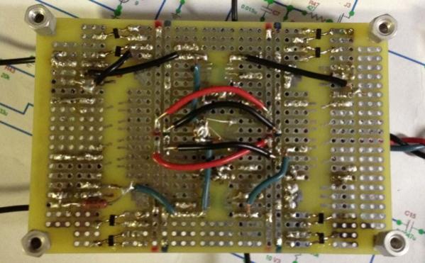

              More progress. This is the high pass and low pass 4th order circuit and represents 1/4 of the complete crossover. Still haven't put in the JFETs in and test it.
              Compare Canadian online casinos ranked for no deposit bonuses, game variety, CAD payments and licensing, so you can pick with confidence.

                • 1913
                #322
                Well, I soldered in the JFETs and tested the one crossover. It biased up well and I was easily able to zero the small DC offset with the pots at the outputs. Sounds good huh? Not so fast. I got no signal from the output of the high-pass when testing it on the scope. On the low-pass I got a 3 dB crossover frequency of 1.1KHz ... should be close to 600Hz. I found that when the Low pass input was hooked up there was a signal equal in level to the input at the High Pass output! Go figure!

                  #323
                  Ha, I found a couple errors where I had one input wire hooked up to the wrong side of a resistor, and also had a wire which shouldn't have been in the circuit which was shorting the input to ground on the HP filter. But may be another problem or two.

                    #324
                    Well, that's good progress, John!
                    You're a braver man than I am, though- now and then I still have to build up something without a custom PCB, but it's so easy to make mistakes I avoid that like the plague anymore! For "cheapies" and one offs I use PCB express;

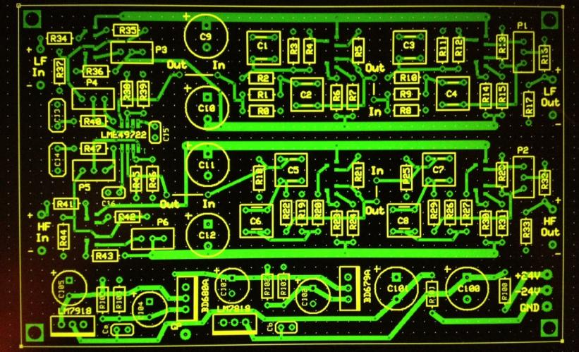

                                            • 1913
                                            #336

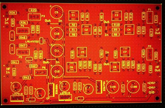

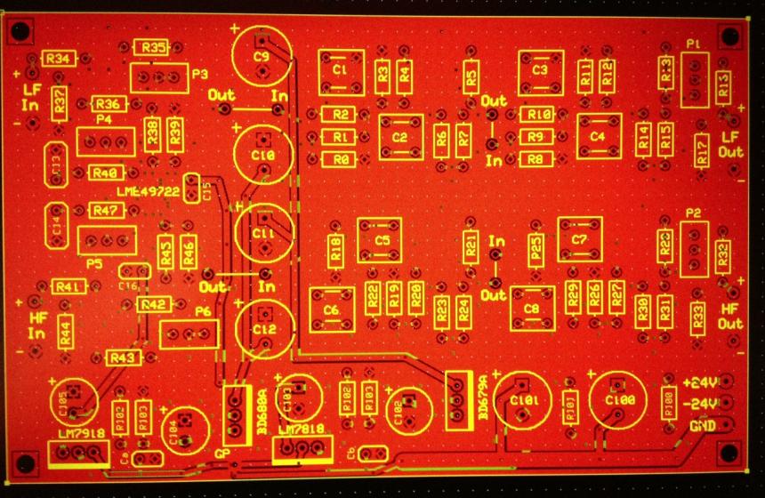

                                            I'm working on wiring up the equalization part of the crossover for one channel, and also been tweaking my PCB design (below). Oh, yeah there is a top layer ground plain and the board is 2.4 in by 5 in. So, I'll finish the one channel prototype crossover and I have a box for it already, and just have to plop in in and wire it up to the connectors. I left out the regulator circuit on the PCB cause I won't leave my option open there. I will be doing a +/-12v battery power supply to start with, and a simple regulator to adjust the voltage to +/-9V.

                                              #337

                                                  Nice symmetrical layout there John - and good you've got a complete ground plane planned. We'll soon be seing response plots here

                                                      Well, been preoccupied, but still inching forward. I've about got the circuit wired up and have the parts for the power supply. I've also made some nice gemstone necklaces for my girlfriend and her daughter. Will post some pictures soon.
                                                      I've decided to incorporate a regulated supply onto my printed circuit board and am designing that now. The benefit of this is that I can make the board 3 inches wide an 4.85 inches long. That is the golden ratio dimensions! That of course will yield better sonics!
                                                      John unk:

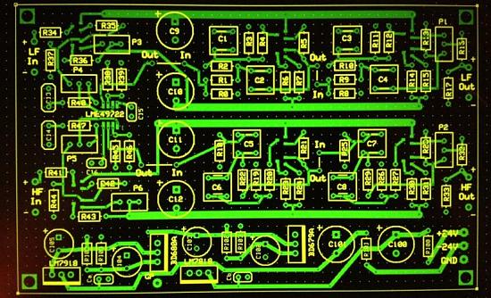

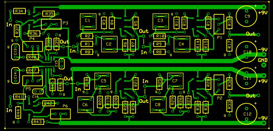

                                                                Thanks Hank! Oh, I have not yet even touched the surface Hank, got more audio enhancement ideas, but better keep mum till it's farther along in development. There is some scientific evidence supporting my ideas as well.
                                                                Things going pretty slow. Having all kinds of miscellaneous problems, distractions, but won't bore you all with them. Did get a PCB design that includes the DC regulator, but still have to wire it up and test it. The LM7818 and LM7918 provide +/-18 volts to the op-amps, and then that is further filtered and reduced to +/-9 volts for the JFET filters. I haven't wired it up yet or tested it with an unregulated supply, but it should work well. If I need to change something I may of course have to change the PCB layout. The transformer and rectification will be located away from the board.
                                                                The top layer is red, and includes some necessary power supply traces. I did manage to incorporate golden ratio dimensions in this board. :W
                                                                Next up wire this puppy up and see if the circuit works well with one speaker.

                                                                  #347
                                                                  Any progress is good progress.
                                                                  As Jon always says, "slow work takes time".
                                                                  Those boards look fabulous, John!
