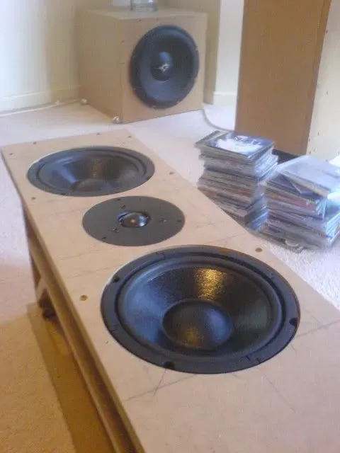

    My first real pair of DIY speakers had to be TLs and had to be floor standers. So I choose Dan Browns dB616TL. Design specs can be found at Dan’s website https://web.archive.org/web/20070104...2/db616tl2.htm. It’s simple construction and crossover was a good learning experience and a fun pair of speakers to build.
    I started by converting all of Dan’s original plans to metric so I could have all the necessary parts cut using CNC. I mocked up all the panels (bar one side), everything was spot-on.
    Click image for larger version  Name:	1.webp Views:	0 Size:	15.6 KB ID:	937986

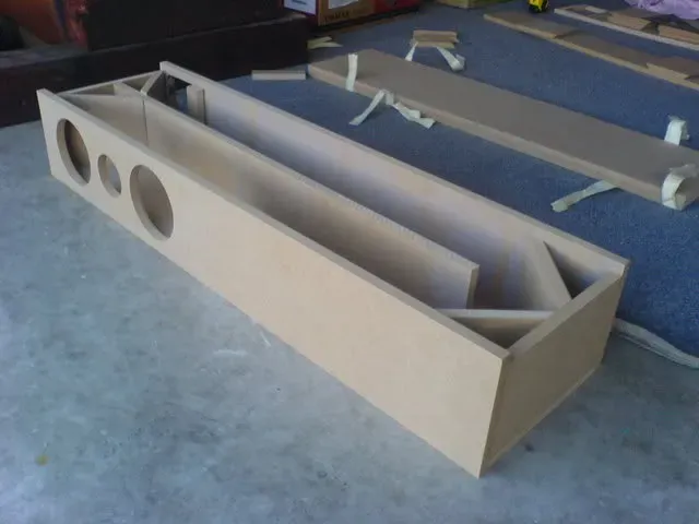

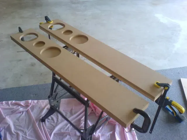

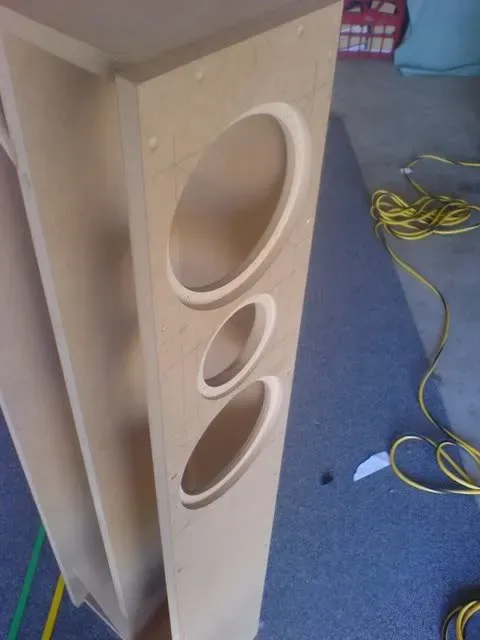

    General construction followed. Due to my lack of clamps I decided to glue and screw all panels together. I found it easy to overlay like panels and pilot hole both at the same time.
    Click image for larger version  Name:	2.webp Views:	0 Size:	22.8 KB ID:	937987

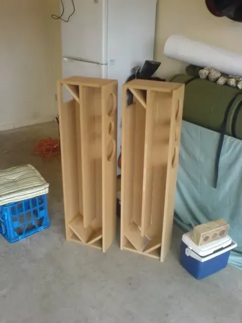

    After some screwing and gluing I had most of the panels in place.
    Click image for larger version  Name:	9.webp Views:	0 Size:	16.7 KB ID:	937988
    Now some people looking at this pic will think “there’s nothing wrong with that”. But, I didn’t angle the internal divider. I quickly contacted Dan and he said that I can compensate for my mistake by filling the first half of the line densely. Thank goodness: Measure twice cut once…where was I for that lesson.
    Anyway Being “down under” I though that Parts Express would take awhile, how wrong was I. 4 days for all the parts to arrive, I was very impressed. The AU$ to US$ isn’t that bad at the moment so the purchase didn’t hurt too much. This design utilizes PE own DC160S-8 6 ½’ Classic shielded woofers and DC28FS-8 1 1/8” shielded silk dome tweeter.

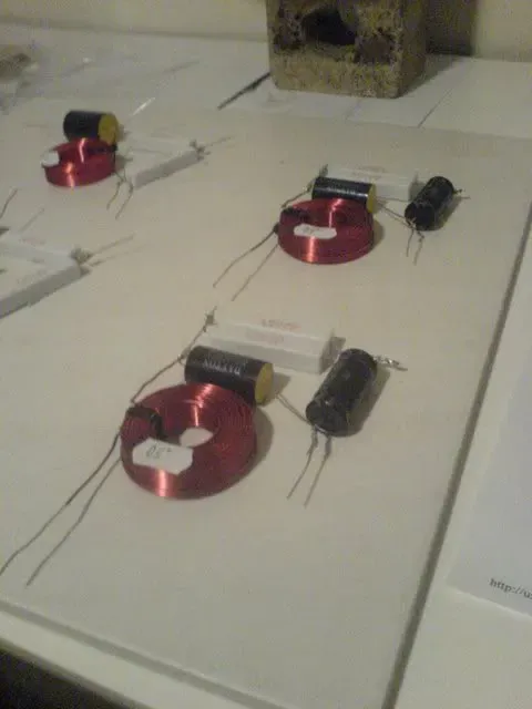

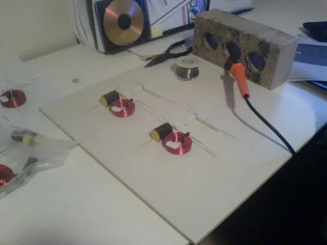

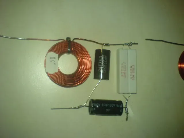

    Crossover construction time! I’m going to have the crossovers external so I constructed them loose for mounting in aluminum enclosures later. I tried my best to wrap the conductors of components around each other for good solid connections.
    Click image for larger version  Name:	12.webp Views:	0 Size:	13.6 KB ID:	937990
    Click image for larger version  Name:	14.webp Views:	0 Size:	12.7 KB ID:	937991
    Click image for larger version  Name:	15.webp Views:	0 Size:	10.1 KB ID:	937992
    Tweeter x-over.
    Click image for larger version  Name:	17.webp Views:	0 Size:	11.4 KB ID:	937993
    Woofer x-over
    Click image for larger version  Name:	16.webp Views:	0 Size:	12.0 KB ID:	937994

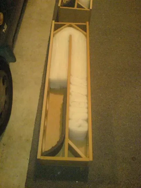

    After getting my hands on some scrap Dacron from work I started exploring the stuffing of the line. I used 80oz Dacron throughout. Sandwiching 5 layers together within the first half and folding a long strip on the back end of the line was my starting point.
    Click image for larger version  Name:	18.webp Views:	0 Size:	25.1 KB ID:	937995

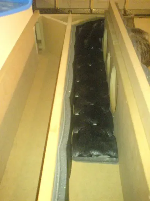

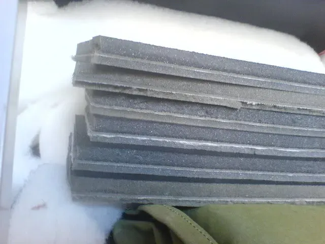

    I also wrangled some sound deadening material for behind the drivers. It uses 2 foam layers on either side of a lead/bitumen sheet (will appear later).
    Click image for larger version  Name:	19.webp Views:	0 Size:	26.9 KB ID:	937996

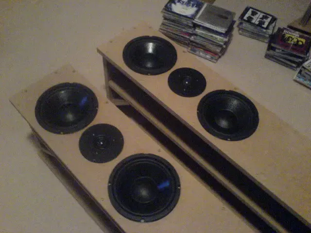

    I flush mounted the drivers next.
    Click image for larger version  Name:	20.webp Views:	0 Size:	18.5 KB ID:	937997
    Click image for larger version  Name:	21.webp Views:	0 Size:	17.5 KB ID:	937998

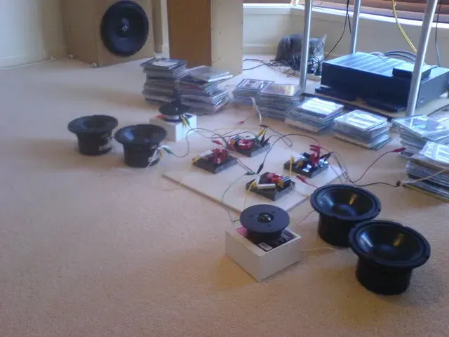

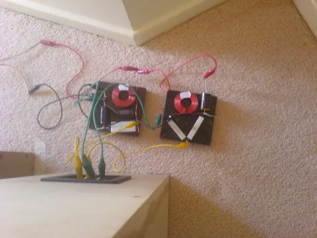

    At this point I had the crossovers fully constructed and was ready for a free air test. So I hooked everything up to my trusty NAD C320.
    Worked beautifully.
    Click image for larger version  Name:	25.webp Views:	0 Size:	25.8 KB ID:	937999
    I glued and stapled the sound deadening in behind the drivers and the adjacent panels.

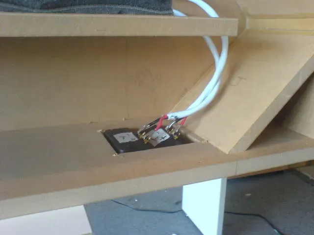

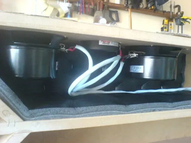

    Internal wiring and terminal cup was up next. I choose Supra Rondo 2 for all internal wiring.
    Click image for larger version  Name:	32.webp Views:	0 Size:	13.6 KB ID:	938001
    Click image for larger version  Name:	34.webp Views:	0 Size:	23.4 KB ID:	938002

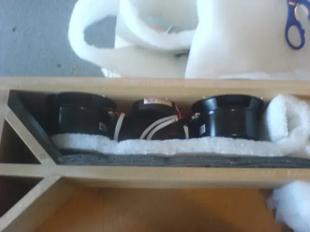

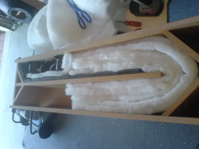

    I filled the line and added some fill behind the drivers
    Click image for larger version  Name:	35.webp Views:	0 Size:	17.3 KB ID:	938003

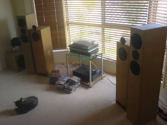

    I can honestly say these are the fantastic speakers. I very happy with the SQ. I don’t think I’ll need to add or remove any stuffing to the line, The response from the rear port is all low bass. The treble is a tad bright, but I suspect this will round off with time. The bass response is full and weighty in my small listening room. The WAF meter even registered a, “they sound excellent”, so I must have done something right. The first tracks put through were Brahms Symphony No.4 Allegro Non Troppo, Norah Jones Come Away With Me and Massive Attack Tear Drop.
    I’ve found them power hungry, from memory the C320 is only rated to 40W RMS. Might need to get a 372 or add a 272 power amp to the mix. A little more drive and power never hurt.
    I’ll finish them off with some American Walnut veneer soon (the next learning experience). Any new DIYers looking for a rewarding first project, this is a good one.
            Looks like they're Cat Approved... and that's usually a meaningful vote of confidence.
            We occasionally find one of ours sitting in the stereo focus.. ears at attention...

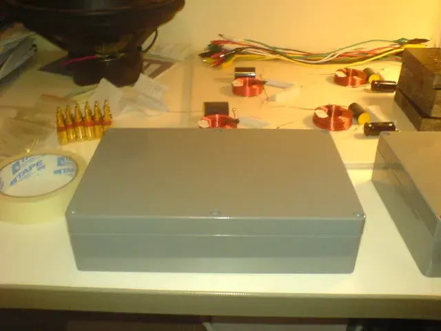

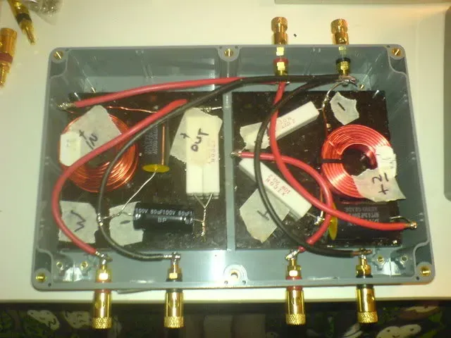

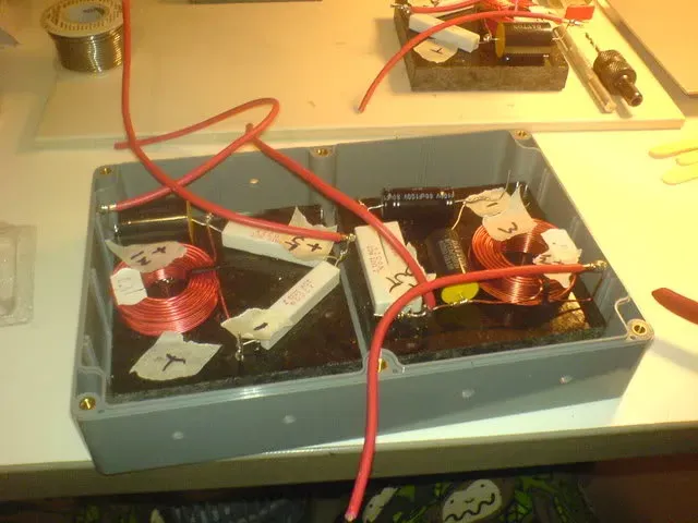

              Below are the steps I took to mount the x-overs in their enclosures:
              I picked up some ABS enclosures and binding posts from my local electronics store (Jaycar).
              The inside of the enclosure had small up-stands for mounting on the inside, so I just used the router to trim back.

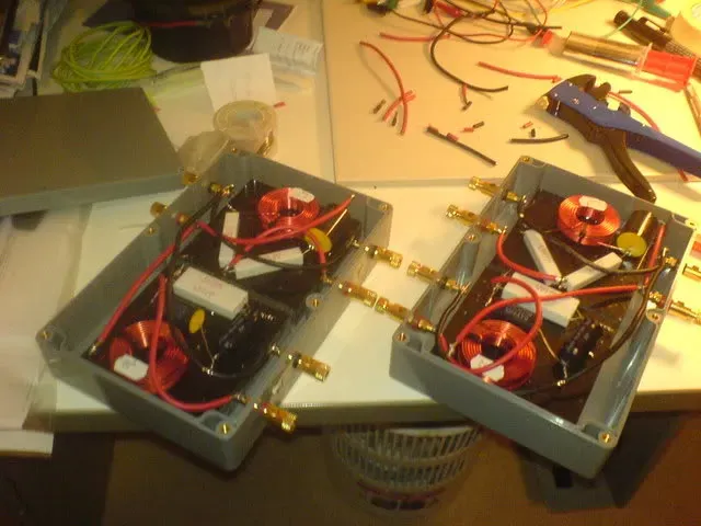

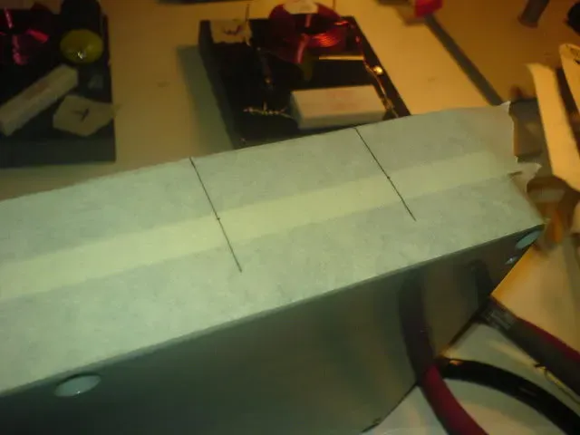

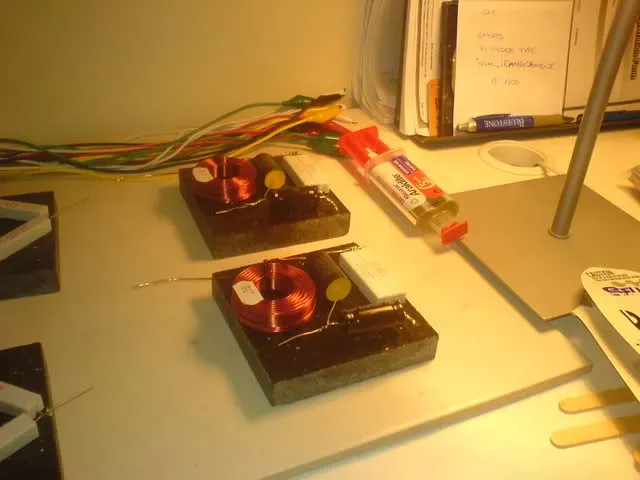

              I’m using granite as the substrate for mounting the x-over components to. I used epoxy to adhere all the parts to the granite. I decided to use stone to give the enclosure some weight since on their own the cross over components and the enclosure had no real substance.
              Located the holes for the binding post on the ABS enclosures.
              I soldered fly leads to all the positive ins and outs, then used epoxy to secure the stone inside the enclosures.

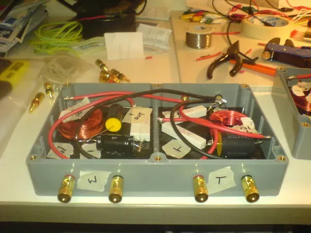

              Binding posts added and all the fly leads connected up.

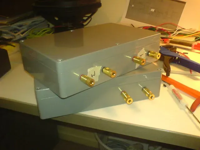

              Both done…looking pretty good
              All hooked up

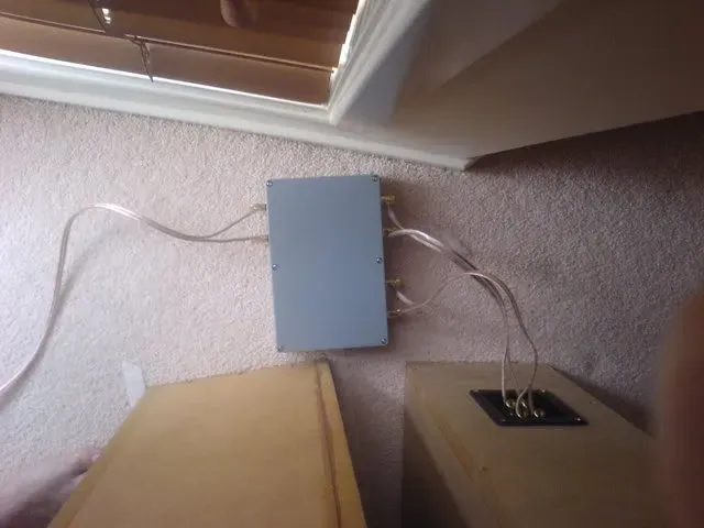

              I removed the dampening in the back end of the line based on Thomas' comment on over dampening of the line. The bass has become deeper as a result...i appreciate the comment Thomas thanks. I'm slowly learning that speaker building is alchemy not chemistry. Trial and error comes with the territory.
              I'm still waiting on a price to make outriggers so I can get the speakers on spikes. I think it'll be awhile before I veneer them up...time and money.
              Tom (the cat) is happy...something else to challenge his jumping ability. I think he enjoys the sweet tunes as well.
              Canadian heart, Aussie home!
