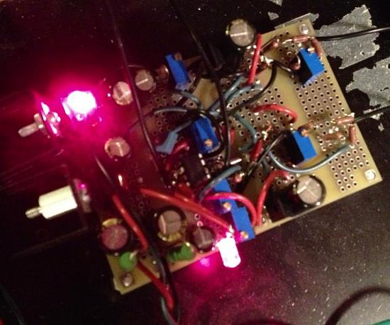

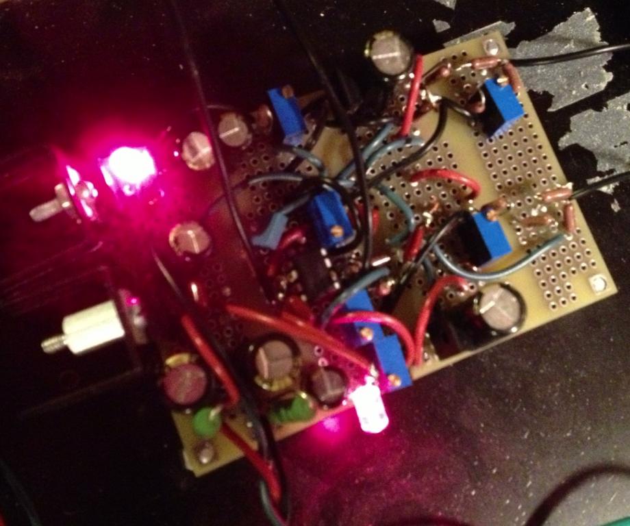

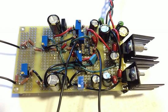

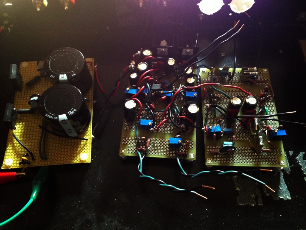

      Okay, more progess ... here is the prototype EQ and gain circuit, and includes the power supply regulators. I still need a couple parts - the op amp and power supply - which will arrive here soon. I had initially planned on using the LME49720 but changed to the LME49722, since it has better performance, but need to used the LME49720 in my prototype circuit since I wired it up for an 8 pin DIP socket and the LME49722 is only a surface mount device. So, if I'm like super lucky this circuit will test out fine and I can get it and the crossover circuit wired up in the box I have waiting for it.
Name:	Kleos EQ Board.jpg

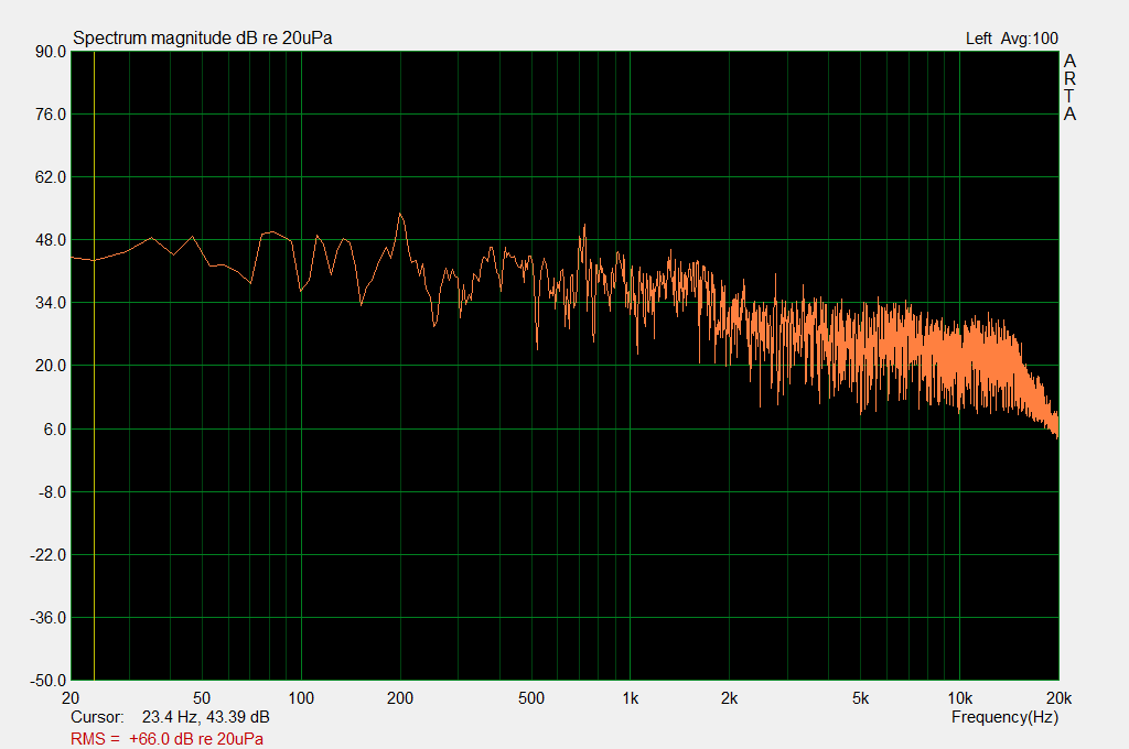

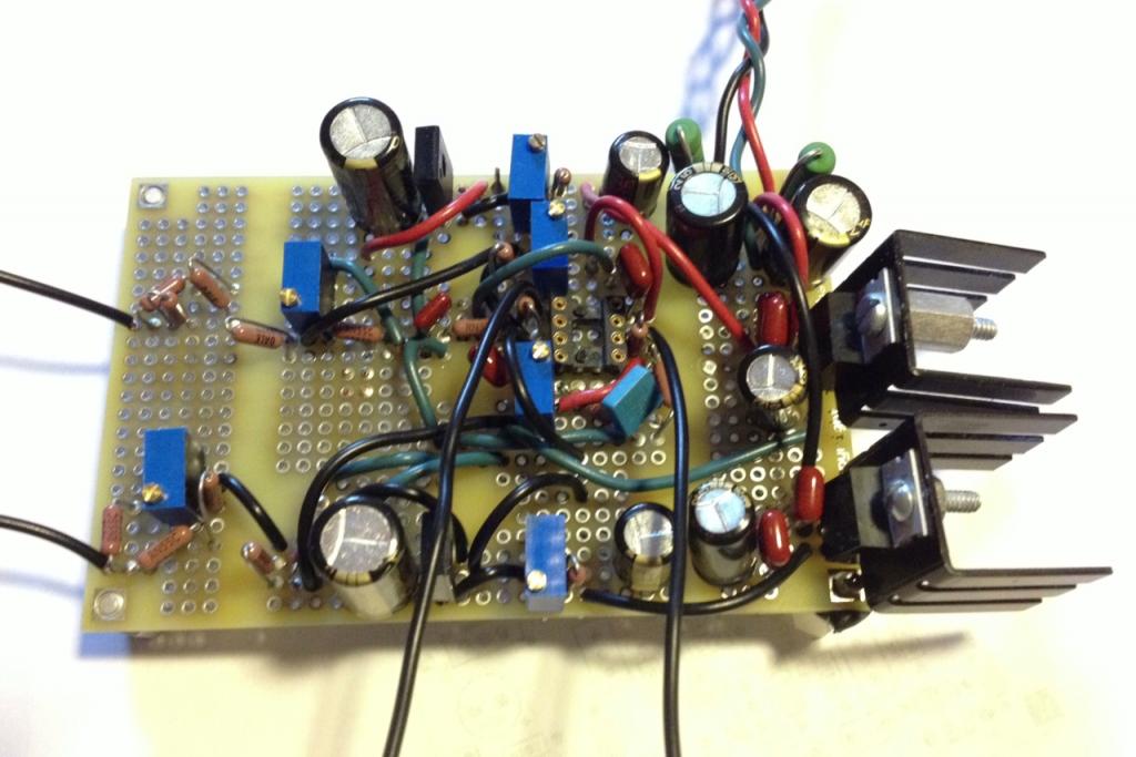

        Okay, it works!!! Ha! It did take some - close your ears kids - correcting "WTF!" "SOB!" "how did I manage to do that??!!!" errors. But, all is well that ends well. I did get some ringing from the op amps so I had to put in compensation caps across feedback resistors. So, I need to find a way to fit those on the PCB. So next up, I need to install the circuit boards in the box and hook up to the connectors so I can test it on my speaker. I used an unregulated AC/AC wall wart for 16VAC to power the circuit. That barley works to provide +/- 22 volts and with the extra load from the crossover board it will not have enough voltage for the +/-18 volt regulators to work. So going to order a 20 AC/AC wall wart. It's easy and keeps the transformer away from the circuit. Oh, and the batteries you see are not used. They were for a different project.

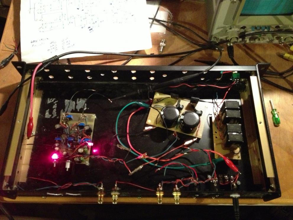

                  Well, I'm back at it, and put it in the box with the boards power connected. In a final check of everything I noticed the DC offset of the low pass filter on the crossover board was 0.5 volts. That's way off and it wasn't like that before. So I think i may have mishandled the board and damage some of the FETs which are ESD sensitive. I'll look into more tomorrow and replace the FETs that are misbehaving.

                    • 1913
                    #369
                    Okay, measured the current through the FETs and they are pulling like 28mA and should only be 10-12mA. So, they are broken!!!! But at least i know what the problem is and I'll have to fix the two JFET buffers on the lowpass section. So, will get on tonight I hope. And then finish wiring it up in the box.

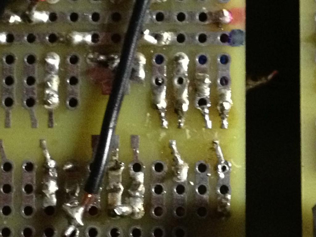

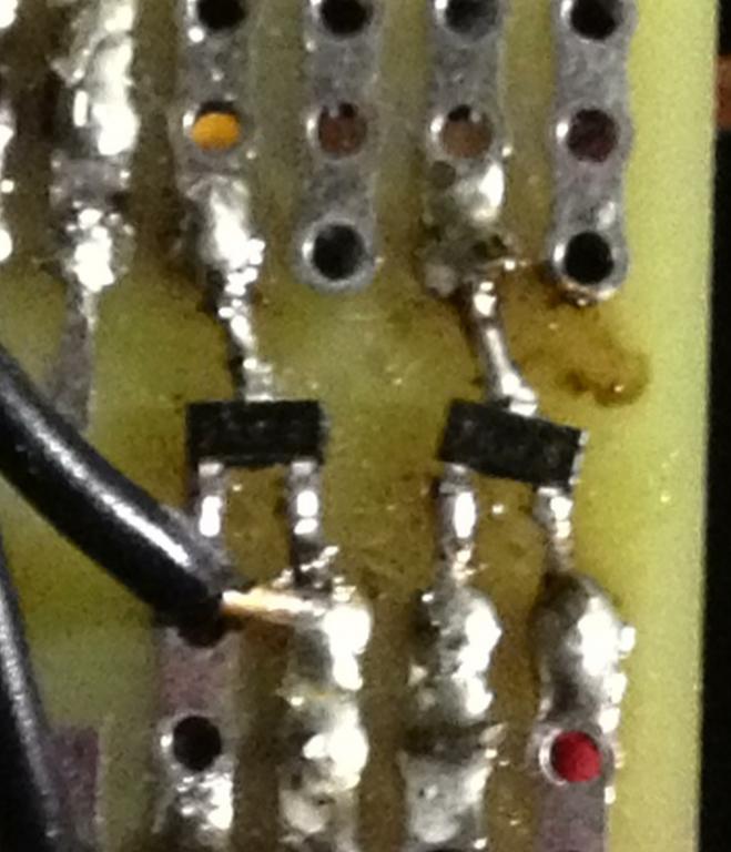

                                      Progress! I removed the offending JFETs and put in the new ones, matched. This picture shows the one of the JFET pair after I pulled them out.
Name:	jfets removed.jpg
                                      This picture below shows the JFETS after I put them in, but not soldered. I had to put a small bit of silicone sealant on the bottom of the JFETs to keep them in place for soldering. This worked out well. I have powered them up and they are pulling about 11mA as they should and I was able to adjust the DC offset to zero. So, I think all is well now. Except for the emotional turmoil I've been going through the past month due to getting ditched by my girlfriend. Well, she found someone else but we are still good friends, somehow, and still get together. I don't really care for the guy she found, and don't really get it. But, I have a friend (great guy) who's ex wife hooked up with a guy who hits her. Oh well ...
                                      So, that partly explains my lack of progress and I'm also working hard at getting exposure desensitization, to overcome my sensitivities to sounds and activities which means getting out as much as possible. Excuses, excuses, I know, but it really is hard work and getting back to completely "normal" is a step many with this condition never get a chance to take. But, I intend to get there and my goal is to get back to school next fall and finish my EE degree at the University of Utah.

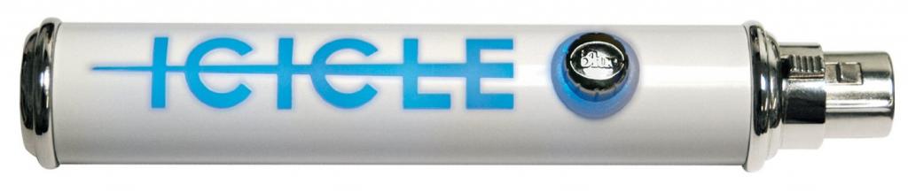

                                        Okay, tested the crossover and it works good with a crossover point of 600Hz. So, got to wire it up the volume controls and the inputs and outputs on the box. I got this USB to XLR mic adapter so I can use Arta and my Dayton XLR mic to take some better measurements using my laptop.

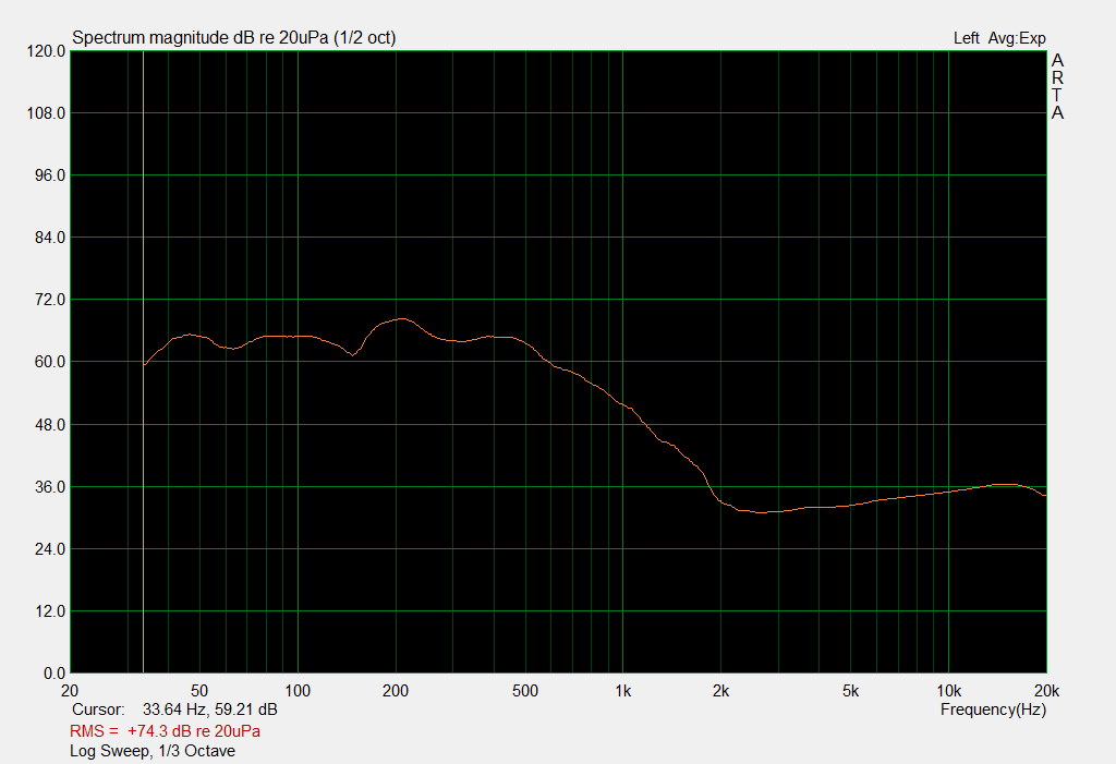

                                                  Took some more measurements today and made some more adjustments to the crossover adjusting out the high frequency shelving filter. Didn't need it cause there appears to be something wrong with the RD50? or the amplifier I using, but I kind of doubt that.
                                                  There is about a 12dB attenuation above 2kHz. But I did listen to some music and heard some really nice things! Enjoyed it but all the sound seamed to be coming from the woofer array. This, most likely due to the mentioned dip in HF response. Any thoughts? And I did check out the crossover on the scope and it is perfectly flat in HF response.
Name:	kleos response 11-14-2013.png

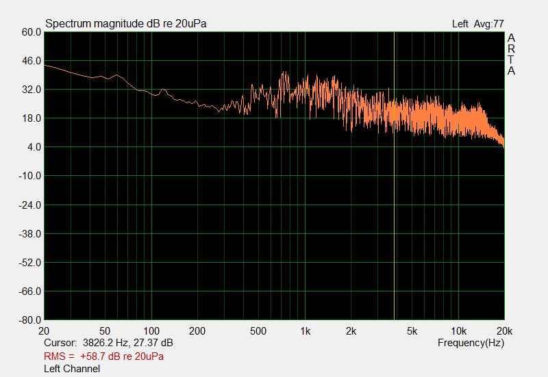

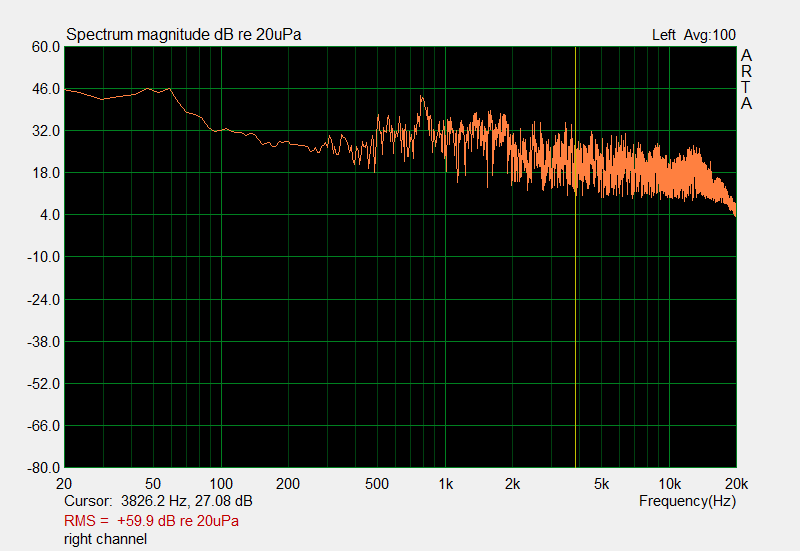

                                                      I just took some measurements of both RD 50 drivers. They look pretty similar in response and both drop off some above 2 khz. Could it be the different mic I'm using. But it's a Dayton mic and comes with a calibration file that is pretty flat. So looks like I need to change the shelving filter on the crossover to give some boost above 2khz, instead of attenuation. Anyway, will get things worked out. going to try to get "Steps" to work with my mic preamp or may have to buy yet another sound card.
                                                      Right Channel
                                                      Left Channel

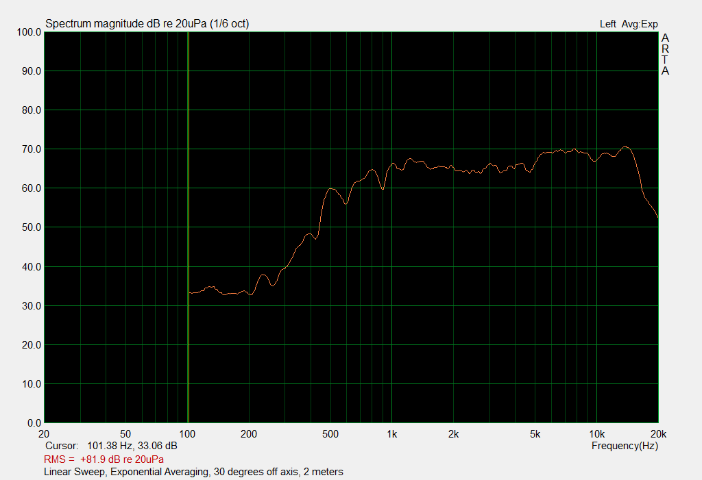

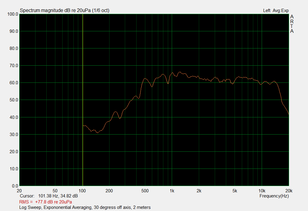

                                                              Well, I think I got some decent measurements now. I'm using my iPhone app, Signal Scope to generate a swept sine signal. I was told that the Log sweep was the one to use. And it looks more reasonable. I used Arta set up for external generator, 1/6 octave.
                                                              Here is the linear sweep -
                                                              Here is the log sweep -

                                                                That's pretty believable- how fast is that sweep- is it like a sine chirp, or relatively slow stepping? with a dipole you always have to worry to some extent about what you get reflected from the rear wall and how your setup influences that. For crossover design, if you aren't using software with strong windowing capabilities that can ignore a lot of the stuff after 10 msec or so, I recommend measuring outside for an initial crossover design. Better to get the crossover right and then work on the room issues separately, IMO.
                                                                Oh, and Hank, ThomasW and I determined some time ago that the sweet spot on the RD drivers was 600Hz and up; below that, HD and IMD rises too much. That's why Tom's setup uses the Acoustant 1+1 in the lower midrange and upper bass (100-600) (hint, hint).
                                                                  • 1913
                                                                  #392
                                                                  Hi Jon! It's a pretty fast sweep, sine chirp describes it well. The signal generator in Signal Scope won't let you control the sine sweep period, but in IOScope you can control the sweep period, so I will try that next time.
                                                                  Measuring outdoors would be nice, but we live only a block away from I-80 and the belt route, so traffic doesn't get much quieter than about 55dB and it's really windy right now with canyon winds blowing all the time and cold! But would like to try that sometime, maybe a 3am measurement when conditions are more favorable.

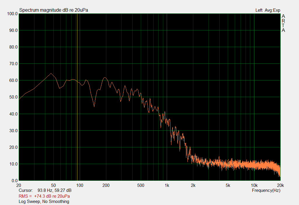

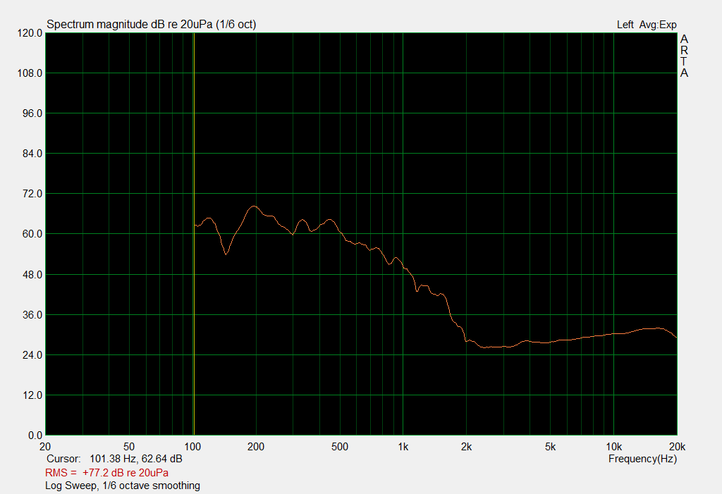

                                                                    Here are the measurements I took of the Woofer array. These were taken with the mic in the same 30 degree off axis position as with midrange driver. I think the 150Hz room mode goes away on the other wall. -
                                                                    1/6 octave smoothing

                                                                    No smoothing

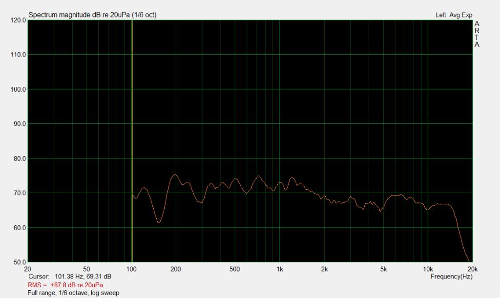

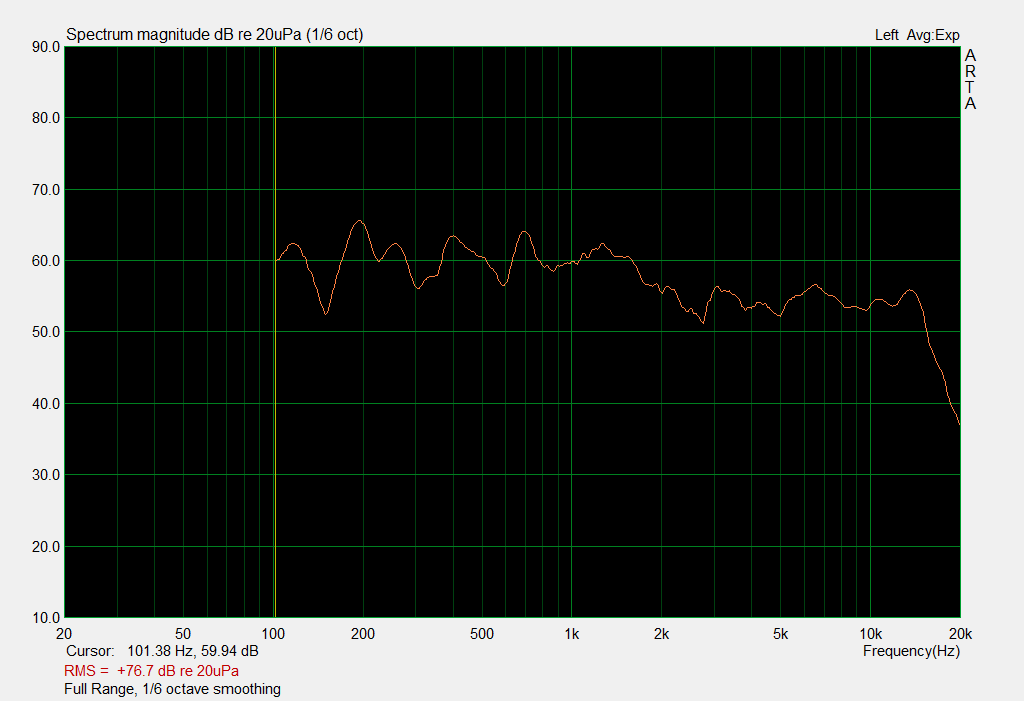

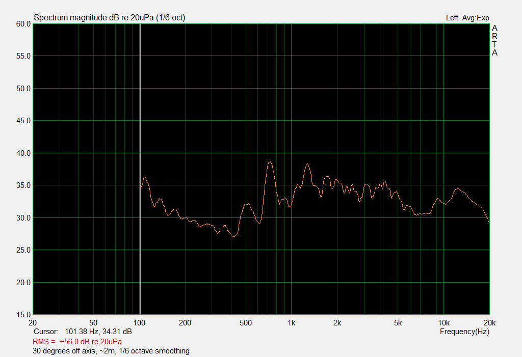

                                                                        Took some more measurements of the total response, and I'm going to change the crossover's high frequency shelving filter. Going to instead change it to have adjustable high freq boost above 2khz. the way it looks is just how it sounded with music. The music seem to all be coming the woofers.
                                                                        Okay, here is the on axis total response:
                                                                        Here is the 30% off axis response:

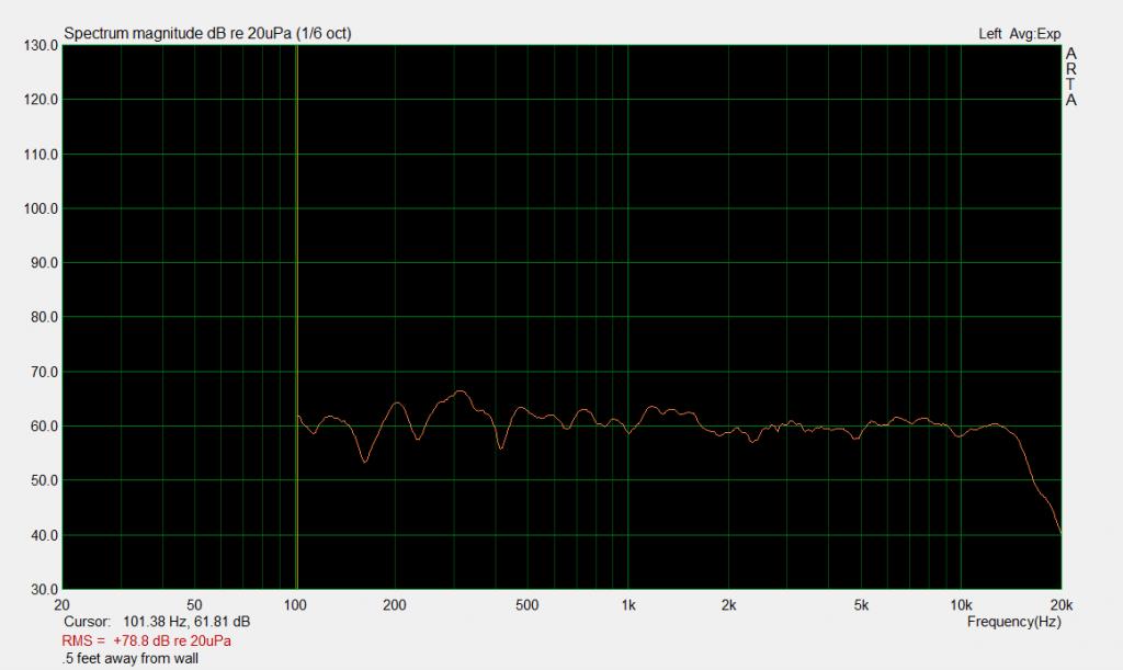

                                                                              Okay, fixed the HF response and all is well! Except one thing which I will mention in just a second. But first, let me say I heard some very nice sounds from my speaker and even my dad was impressed, and he loves nothing more to trash my efforts when given the chance! It has real thump in the bass and plays low. So no need for subs anytime soon. Pulling the speaker out into the room another 6 inches really helped and it got rid some hollowness in the sound.
                                                                              One problem though, I start to get a lot distortion when I turn it up. Sounds very pleasant and musical ... then gets harsh and bright when I turn up the volume. And I don't play it very loud. This can't be the speaker assuming all the drivers are working correctly. So I'm thinking crossover distortion, or perhaps my iphone (my current music source) doesn't like driving the long cable to the crossover? I kind of doubt that though.
                                                                              Anyway, will have to investigate that, try a different source and take some distortion measurements of my crossover.

                                                                                          Originally posted by Saurav
                                                                                          Never used a distortion analyzer before. Are you planning to insert this in various parts of your signal chain to see where the distortion is coming from?
                                                                                          I suspect the crossover, so gonna try that first. Hope it's not the speaker cause that would be bad! But I will probably take distortion measurements of the speaker too using ARTA once I check out the crossover.
