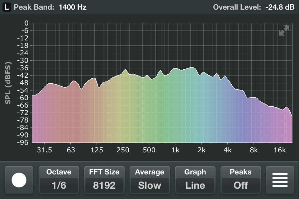

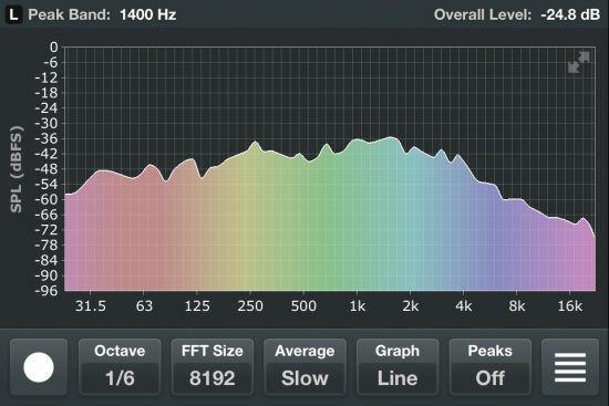

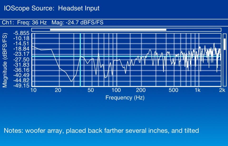

                                                Okay, I'm still kicking. I took some measurements with my iphone with the speaker positioned where It'll be when I'm done with the crossover. I moving the speaker a bit did affect the response quite a bit. This is about 30 degrees off axis from the woofer, at the listening position.
                                                Images not available
                                                Anyhow, my I will be sticking with my iphone and designing the crossover with those measurements. Just don't money right now for a sound card or anything, girl friend is struggling and I am too now.

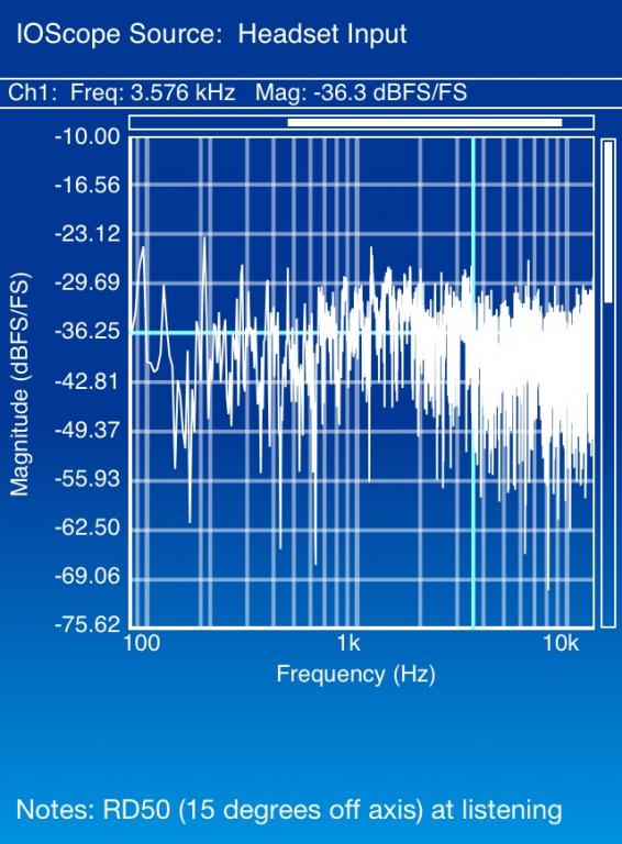

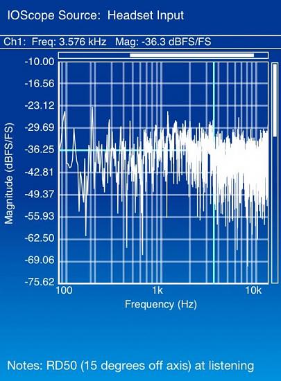

                                                  Here is the RD50 response graphs:
                                                  Everything below about 700Hz can be ignored because of a high filter at the amp input cuts off the low frequencies. The top graph is not really flat below 700Hz, it's just a software artifact.

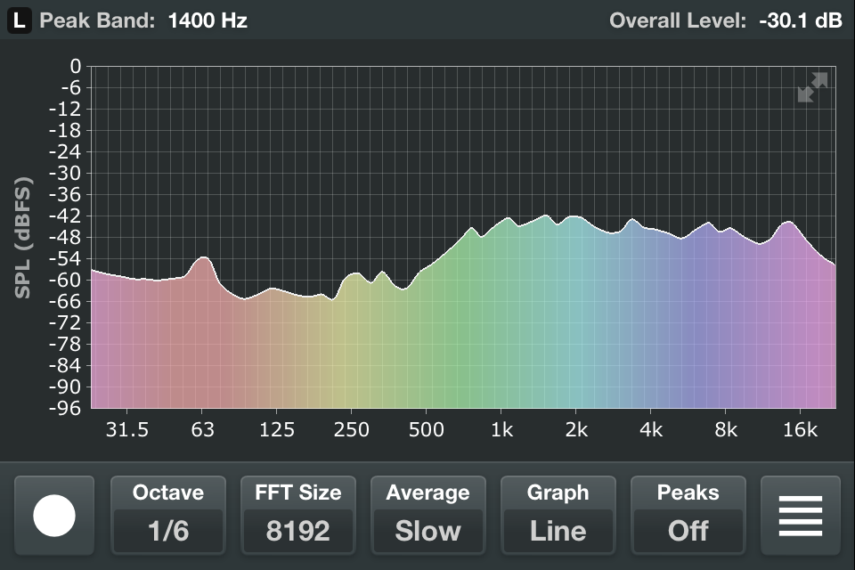

                                                        Response Graphs
                                                        Okay, I've attached the response graphs that are missing above. The first two graphs are the woofers, sweep and pink noise response smoothed. The next two are the RD50, same deal.
