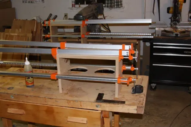

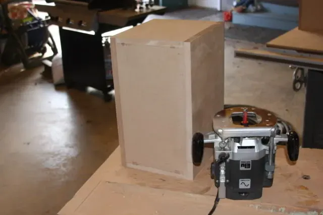

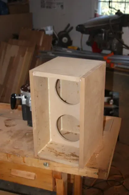

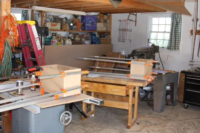

    I started my modula mt's this weekend. I went with the pe box design but I think I messed up on the depth. The depth of mine are 11-1/4" so with the front baffle they will be 12". I think what I should have done was to make the box depth 12" for a total of 12-3/4".
    Is the way I did it fine or should I start over?
    Here are a few pics. This is my third speaker build and I am 18 so be easy on me.

    Another question should I make the front baffle 3/4" or 1". I have mdf in both sizes so it does not matter to me. Also what is better for the woofer cutout, a round over or a chamfer? I have round overs in 1/8", 1/4", 3/8", 1/2" and 3/4" and I have two sizes of 45deg chamfer bits all are Freud and are in good shape.
    I split your post from the main thread so it gets more attention.
    The options are
    1) leave the box as is and live with the slightly different port tuning
    2) change the port length slightly to accommodate the bigger box.
    3)if you haven't permanently attached the fronts or backs carefully run the box through a table saw to cut down the depth.
      Nice looking job so far, Rob. PE uses a 1" baffle rabbeted 1/2" into the cabinet. If you just glue it onto the front, that will recover 1/2" of the missing 3/4" and I don't think 1/4" net missing depth is enough to worry about.
      A chamfer bit is good for the back of the woofer hole.
      Bigger is better for the front roundover or chamfer. 3/4" is good although PE uses 1/2". It's all about helping to eliminate diffraction when the sound from the tweeter hits a sharp edge.

        Maybe I missed something, but the original poster is stating that he built the boxes too small. He has an inside depth of 11 1/4" while it should have been 12". Both reponses above talk about how to make the cabinet smaller while they should be disucssing ways to make it bigger.
        Rob, you could try adding a 3/4" filler strip all the way around the face of the box, and then put the baffle on. Not pretty, but depending on your choice of finishing, it could be hidden fairly easily.
        • rob17
          • 29
          So then if I glue the baffle on to the front then I will gain a 1/2" of what PE lost when they dado the back of it. So I will be short just 1/4" which equates .019ft^3. So I don't think that will be too much different.
          What do you guys think?
            It's not enough difference to be of concern.

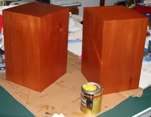

                    Anyhow I got them veneered this weekend. I used blistered Brazilian mahogany. They turned out gorgeous I think. I put one coat of polyurethane on them to seal them up and then I will do the cutouts for the ports.
                    I got the woofers friday and the binding posts cups from PE. I cut the front baffles and made them a 1/4" bigger in length and width. So I will glue it on to the boxes and then use a flush trim bit on the edge and then use the 3/4" round over on it. First I will cut the driver cutouts and things. I should have the rest of the stuff from madisound tomorrow or something. So this weekend should be fun.
                    a few pics-

                      Looks pretty nice
                      • JonP
                        • 692
                        Cool... they look great!
                        I did mine in African Mahogany... a striped or ribbon figure, it was nice stuff. Actually glued the baffles on, roundovered just the long sides, and did a solid veneer wrap around. Lost the benefit of the roundover on the top and bottom of the baffle, but it is a nice look.
                        I'd say 1" to 1.5" would be good, but 2" would be starting to be overkill (though depends on who you ask!). Mine were done with 5/8" Baltic Birch, with a two layer laminated front baffle at 1.2". The Birch is somewhat stiffer. Still, you notice a bit of sound energy if you put a mechanics stethoscope near the drivers while playing. But, they are pretty close to quiet.

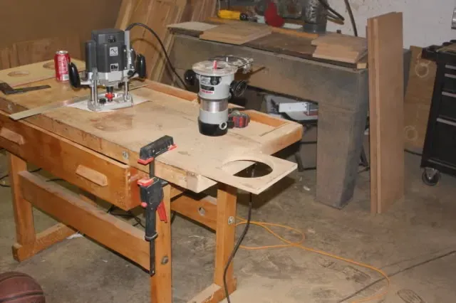

                                      Here is the chamfer on the back of the woofer:

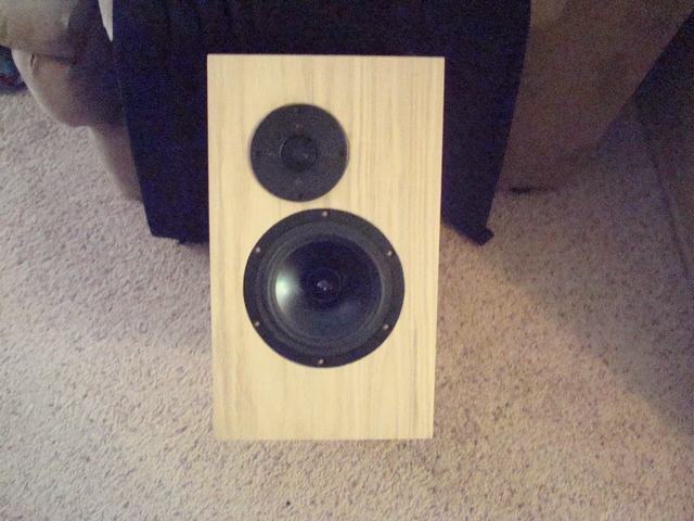

                                      The driver layout:

                                                This past weekend I got the holes for the ports cut, another coat of polyurethane on, painted the bottom and the cutouts in the back black and got the crossovers wired. Wiring took longer then I would have hoped, most of the evening on Saturday.
                                                With the port in

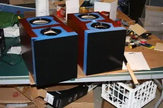

                                                Painted the bottom with a rust-oleum flat black

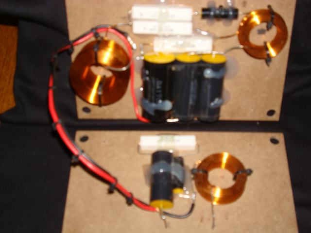

                                                and one of the crossovers, tested them both and they worked the first time around!
