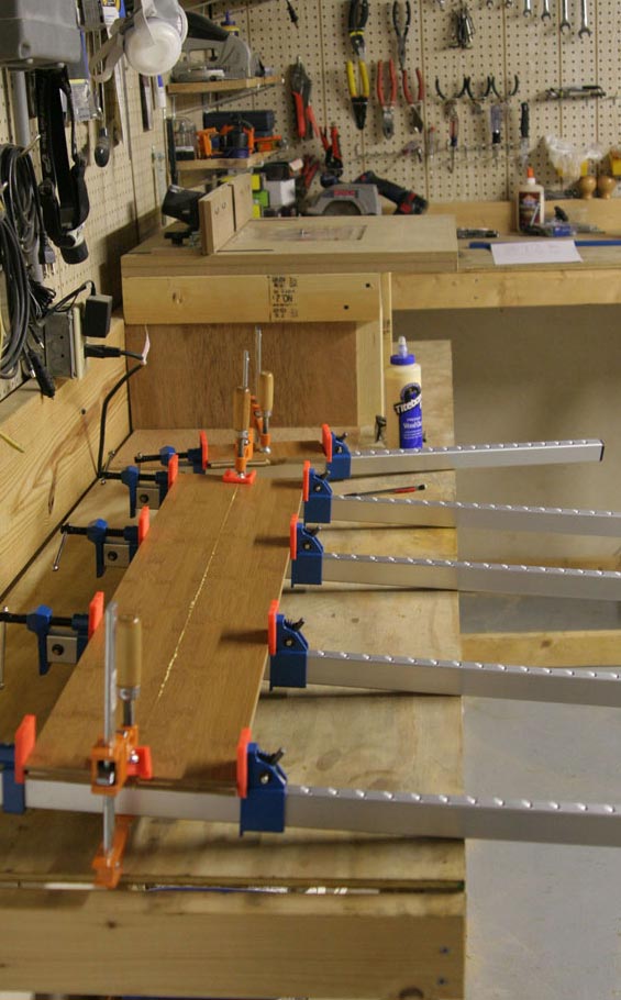

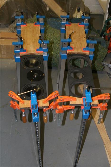

    Step 2: Once I had 2 strips (per speaker) ready it was time to glue them up.

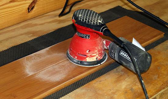

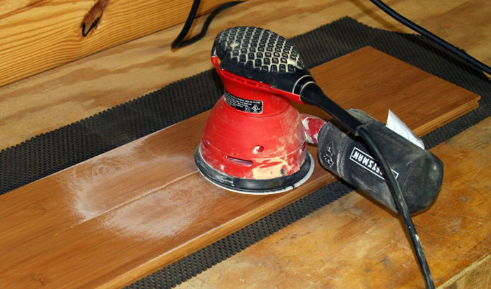

    Step 3: Sand off the finish that was put on the flooring at the factory. (dang this finish is hard to get off, still got some more to work on).

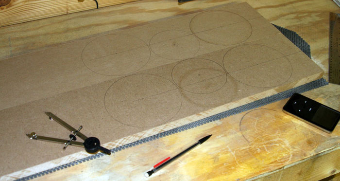

    Step 4: Bevel layout on the 3/4" MDF that will back the bamboo.
    I did all my cutouts with a Jasper circle jig after this, but forgot to take pictures (also didn't want my camera in the workshop with all the MDF dust).

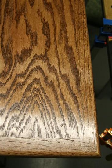

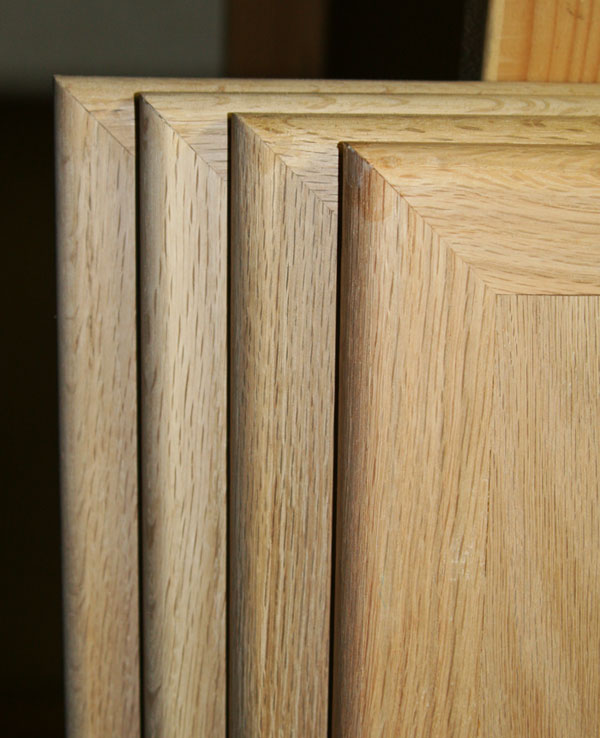

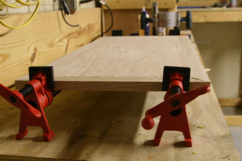

    Step 5: Starting on the side panels... Decided on red oak hardwood ply because it was easy to match the hardwood side strips to it. (It was an easer grain pattern to match than Baltic Birch). Spread some wood glue and get ready to clamp.

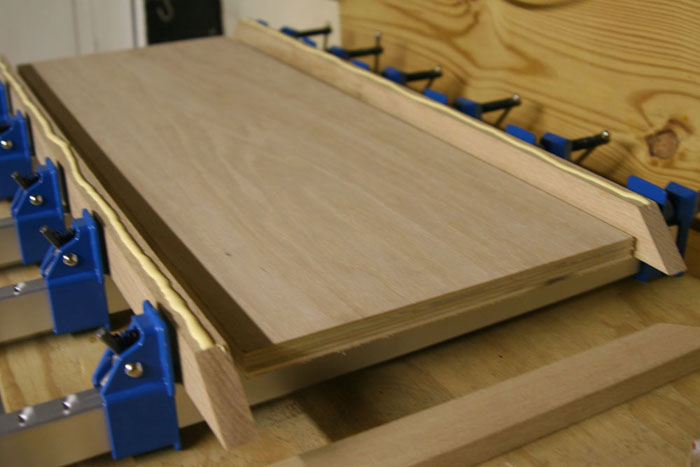

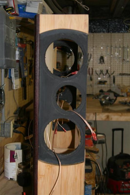

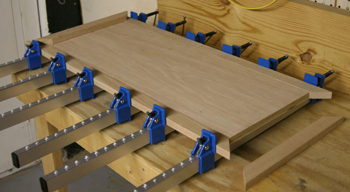

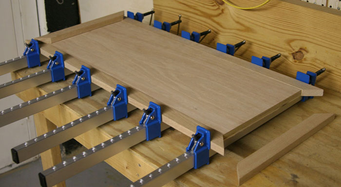

    Step 6: Square everything up and clamp it down (1/2 of 1 panel finished, 3 more side panels to go after this one)

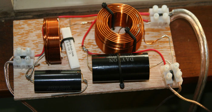

    Got one of the crossovers finished and tested

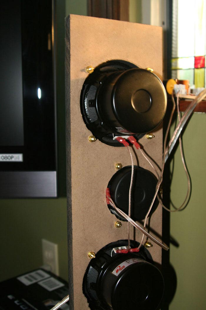

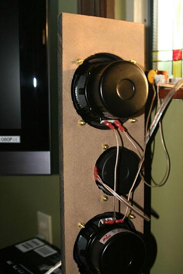

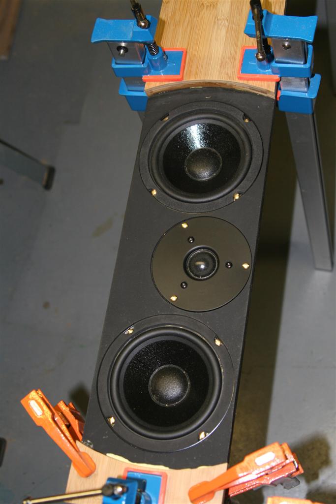

    Speakers mounted in the MDF
    Tested, and wow they sound so much better than my Altec Lancing even without the box (no low end of course). But they are so much clearer sounding!!! Makes the Altec's sound supper "muddy". I think I'm going to have to replace every speaker in my house. (I think the kitchen is next)

                Step 7: Got the ends glued on for a complete panel last night
                And got steps 5 & 6 done on 2nd panel. and got the 1st panel sanded down to 220 grit this morning.
                Now I just have to repeat #5-7 on 3 panels so I have my sides ready for routing and staining. (may be no pictures for a few days as I just duplicate stuff I've already done, yay for duplication/production :roll: )

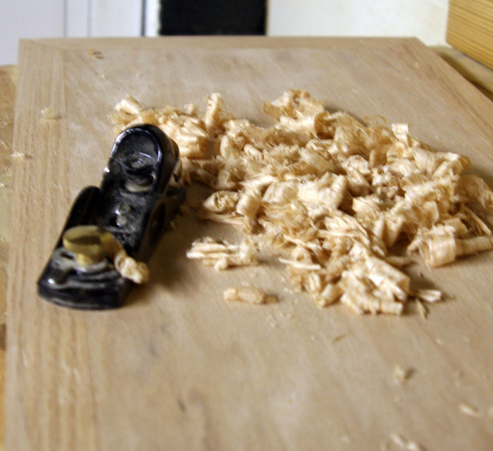

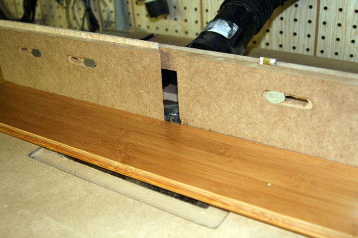

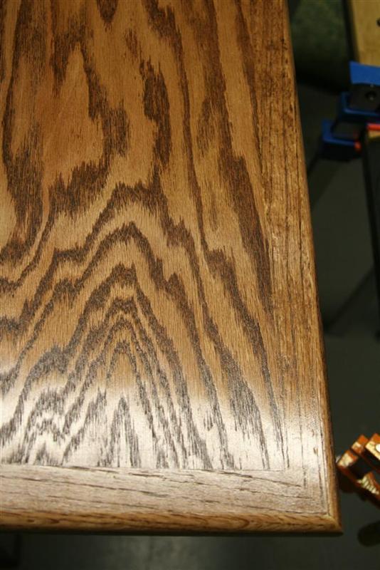

                    Well the sides are finished. I spent the week finishing up my glue ups and then used plane to flush the hardwood strips to the plywood.
                    Next I routed the edges with a 1/2" roundover bit.

                    I sanded them down to 220 grit and prepped the surface for staining with a 1lbs cut of Shellac to promote even stain absorption.
                                I love seeing a guy with a SHARP block plane. Nice shavings.
                                • dacodo
                                  • Apr 2008
                                  • 21
                                  I just got it. Spent 3 hours sharpening it before it touched my panels. Nice mirror finish on the back of the blade and a nice small mirror micro bevel. Still tweaking it. It's my first non power hand tool, but I think I like it.
                                  I picked up an old stanley no. 5 (complete, just a cracked handle) at the flee market this weekend for $7. This one will take a bit more work to get into shape. But, I'm really starting to like this woodworking thing. Figured speakers were a good first project... Hey they are a box, how hard can THAT be? :W
                                  -Nik

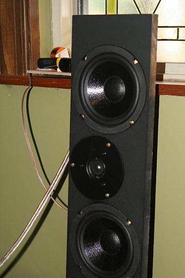

                                        So sides are redone, got the x-overs finished and in...

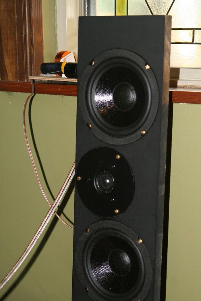

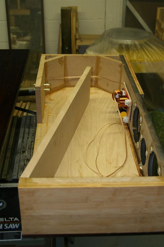

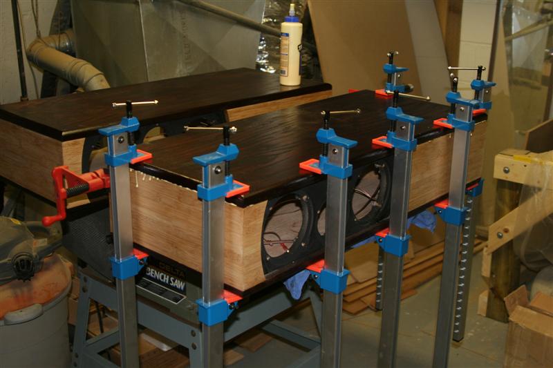

                                        And I just finished testing them and gluing them up
                                        Tomorrow I'll finish sand them with 600 grit (I have a seal coat of water based poly on the sides), and start applying the final finish coats of Shellac.
