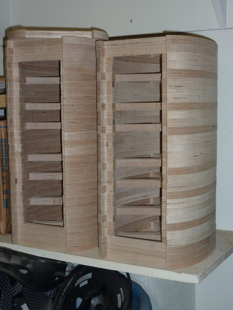

    Yes, I'm doing all of the routing myself, which makes me 100% insane. When I first saw the Magico Minis, I knew I wanted to do a translam. The Minis are crazy expensive and I’m looking for something on the other end of the price scale. This is to be a 5 speaker setup for my family room, about 80 % home theater, 20% music. After much research, I went ahead with Curt’s tritrix. The mains and center are to be MTM, while the surrounds will be MT.
    I ordered 4 sheets of 4×8 Baltic birch plywood (B/BB). Doing a translam, I suppose the most sane thing to do would be taking it to get CNC’d, but I had a hard time finding a local shop with a CNC willing to cut plywood. I guess I didn’t look that hard (plus I like the idea of doing it all myself).
    I studied quite a few translam builds from other folks and decided to use the same approximate proportions as the Magico Minis while using Curt’s baffle dimensions. I love the sound of sealed enclosures, and I’ll be using this setup with a sub, so sealed it is. The resulting enclosure volume is a little more than Curt’s recommended sealed enclosure, but I’m trying to leave the door open for the RS150 MTM should I choose to upgrade in the future. The baffle will be replaceable, so upgrading won’t involve rebuilding the enclosure. And with a roundover, the baffle dimensions are very close to the tritrix. This build is going to take plenty of work so I hope the compromise doesn’t impact performance too much.
    When I researched for this build, I found that pictures of the process were really helpful, so I thought I'd return the favor. More build details here:
    http://speakerstuff.com/?cat=3 (Excuse the bare site, I just threw it up last night)

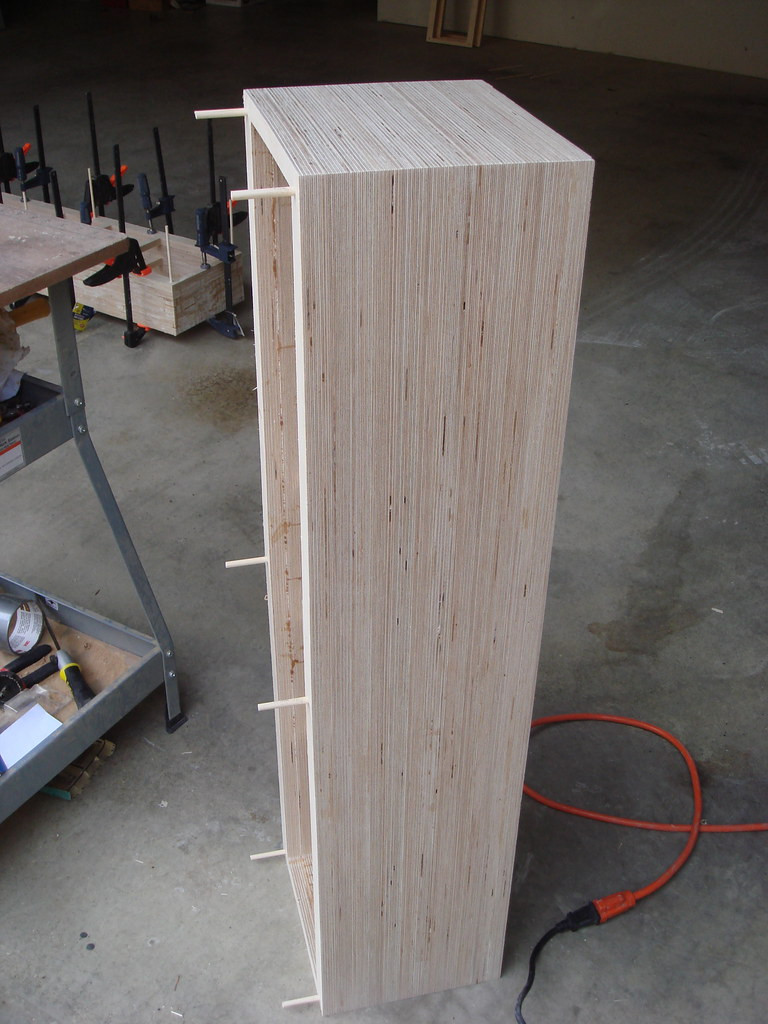

    Here's the first enclosure, dry stacked, no sanding.
    Click image for larger version  Name:	P1000759-768x1024.jpg Views:	21 Size:	197.8 KB ID:	953134

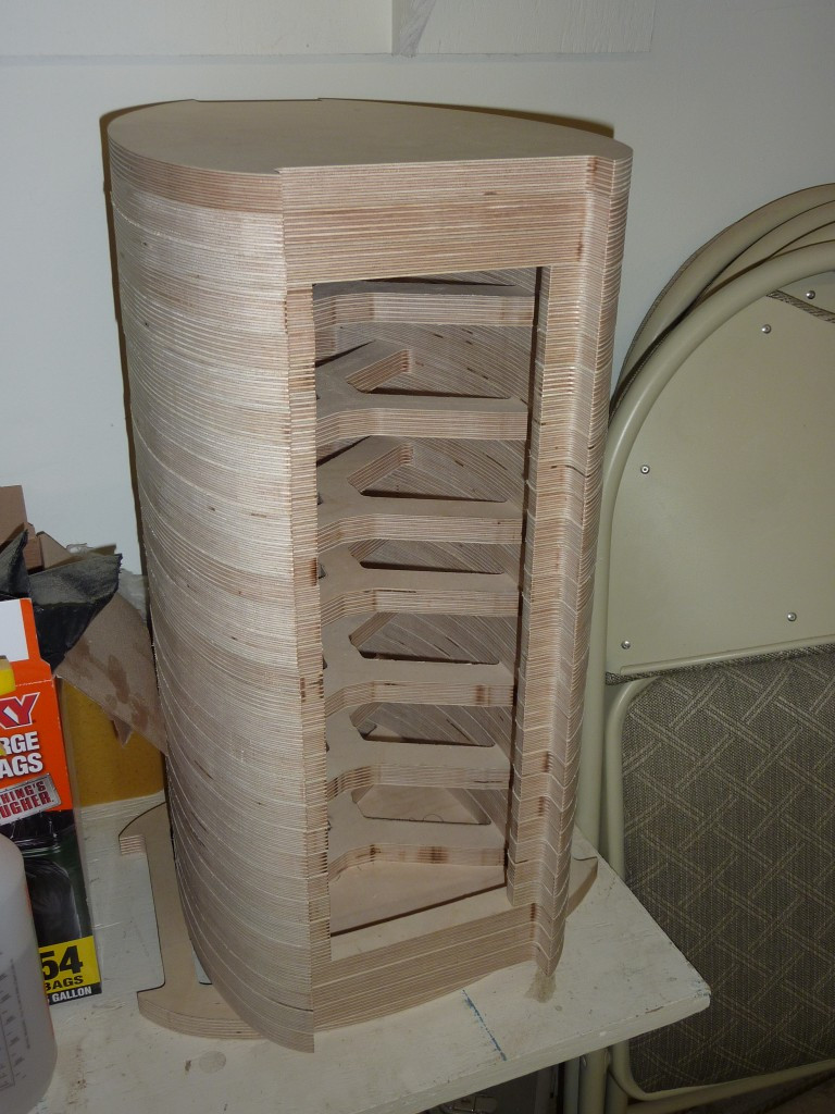

    Update 1-18-2010
    Alright, I'm done cutting the mains. Need warmer weather to start gluing.
    Click image for larger version  Name:	P1000799-768x1024.jpg Views:	21 Size:	207.3 KB ID:	953133
    Click image for larger version  Name:	P1000797-768x1024.jpg Views:	21 Size:	176.1 KB ID:	953132
    Click image for larger version  Name:	P1000800-768x1024.jpg Views:	21 Size:	222.5 KB ID:	953131
    Click image for larger version  Name:	P1000802-1024x768.jpg Views:	21 Size:	208.5 KB ID:	953130

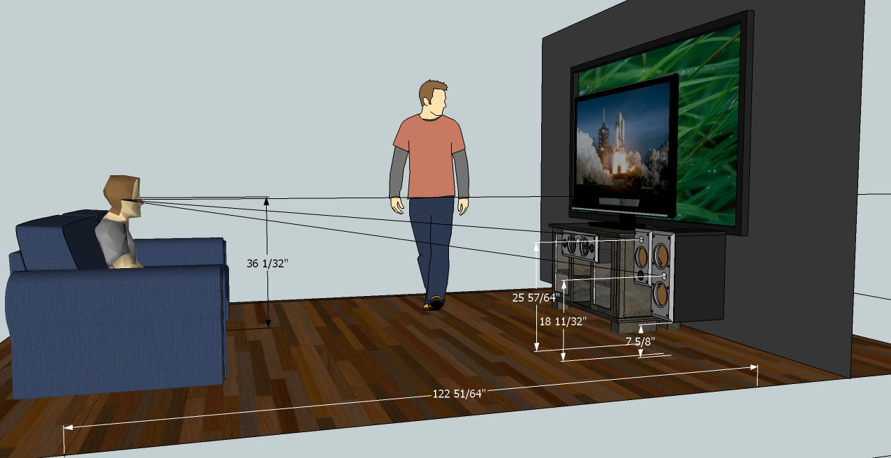

    Click image for larger version  Name:	fam_room_mains.jpg Views:	4 Size:	139.2 KB ID:	953135

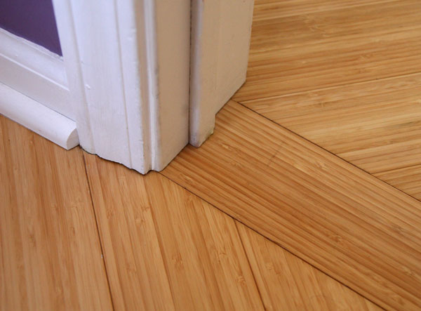

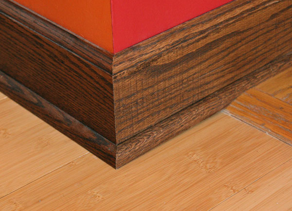

                                        Pardon the thread wandering here...
                                        The oak floor was already there. The rest I've installed. Almost done, still have the living room + stairs (and the stair is why I've not yet done it...)
                                        Last edited by theSven; 01 May 2024, 18:17 Wednesday. Reason: Update image location
                                          • 16202
                                          Nice! :T

                                            When you're gluing them up I recommend you use some dowels to keep everything lined up. That's what I did and it helped a lot. Also be prepared to do some serious sanding.
                                              (Pictures are now in the first post)

                                                Hey djn, I've read up on your build, awesome work. What did you do with the inside waste?

                                                    As djn04 mentioned and you've no doubt thought of, those things will slide like mad when you start gluing them up. How are you going to keep them aligned for gluing?
                                                    • dpg
                                                      • Dec 2009
                                                      • 27
                                                      I was originally planning on gluing each layer one by one... glue, clamp, shoot in some brad nails, then to the next layer (this after reading gmed's experience). I'd like to use dowels as djn mentions, but I'm concerned because these pieces were built from 4 templates that are almost identical on the outside, but from the constant routing some of the templates showed some wear that was then transferred to the new pieces. I'm concerned the dowels won't give me any flexibility should I want to adjust any once piece slightly. Maybe I'm over-thinking it, I dunno. Anyway, like most things in my shop, I'll get out there and see what does and doesn't work. Thanks to this board, I have a few ideas now to play with.

                                                          I'm not married to the BB ply idea, it's just here. I live in Central MD, between DC and Baltimore. I'll look around for a hardwood store that sells smaller pieces, I'm sure they're around. What other hardwood should I be looking for, oak, maple?

                                                            I just let the guy who did the cnc'ing for me keep it. I didn't have any plans for it and I got a good price on the cnc work. I probably could have used it for another project but I didn't have anything in mind.
                                                            The brad nail idea will probably work just make sure you line them up well even a little bit off will leave you with a lot of sanding.
                                                            These are going to look awesome when you're done.

                                                                For anyone who needs small pieces of bamboo ply or maple-face ApplePly, check out this link: Plywerk. They sell these as artist panels.
                                                                  Maybe a bit far from you, but a quick google turned up:
                                                                  http://www.worldofhardwoods.com/
                                                                  http://www.mcilvain.com/index.php
                                                                  The hardwood store by me sells pieces in all shapes and sizes and about 30 different varities that change frequently. Much of the shapes and sizes are dictated by the knots in the wood and such.
                                                                  If nothing else, it is fun just to visit a type of store like this.
                                                                      Thanks Ryan, I'll check it out this week!
                                                                            I think if you use a temporary front and rear baffle board as you assemble them, it will force each layer into alignment where it matters most. You shouldn't need dowels. But the sides will need sanding afterward.

                                                                                        Thanks, and no worries. I knew when I posted this stuff, everyone's first question would be, "why not pop for more expensive gear?" I'm seriously considering moving up to the Dayton ref drivers. While I'd love a scanspeak setup, man that's just too much money for me. Maybe one day.
                                                                                        Nah, no basement. I'm thinking I'll keep the wood and glue inside, then go out to the garage to glue for a bit, then bring back in to let it dry. Or I can just wait for a warmer day, but I'm not sure one is coming soon.

                                                                                          I would not use brad nails, they wouldn't really make things any easier and as pointed out, they have the potential of making things a living hell if you mess up even a tad. jbateman's advice above is pretty good in my opinion.
                                                                                          They're coming along beautifully.
                                                                                          Yeah, I think I'm going to follow jbateman's advice. The only reason for the brads would be to glue, clamp, then brad, which would let me remove the clamps and let the brads keep the clamping pressure while I glue the next piece. Not sure if it would mess anything up, since I'd only be using brads once it's already aligned and clamped, right? Or maybe I'm missing something...?
