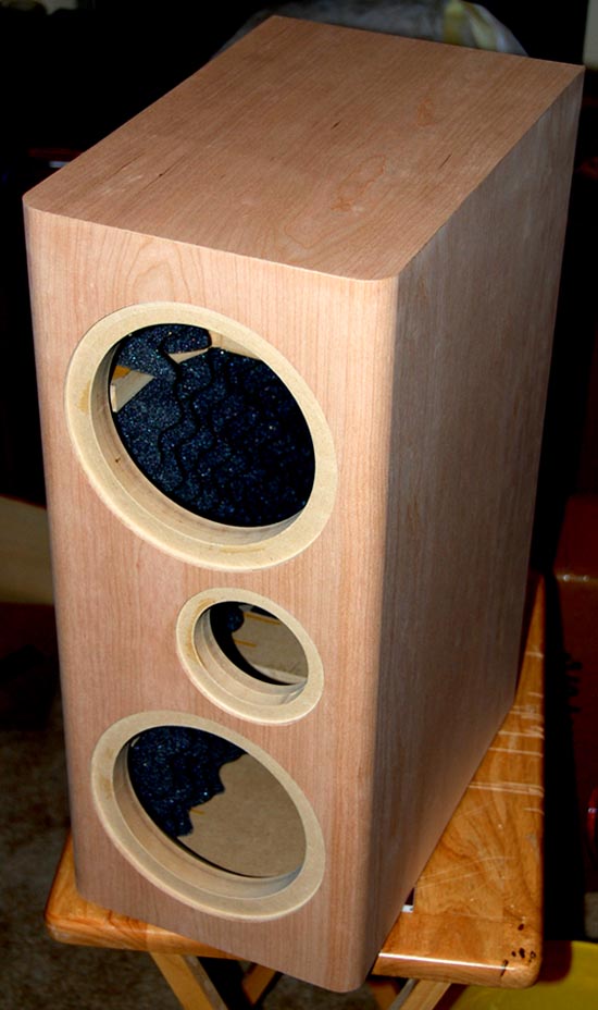

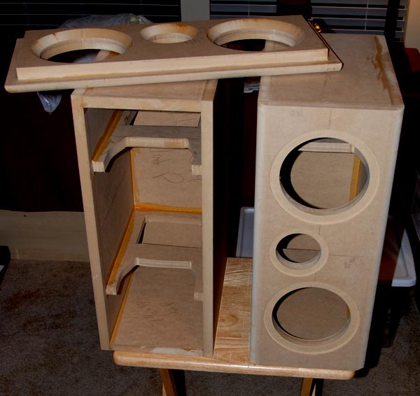

    I'm building a pair of Nat P's for myself and they are coming along pretty well. I do have a few questions, however.
    1. I plan to use these with bass bins and a sub, can I leave them sealed or should I still port them?
    2. I searched for bass bins and found alot of talk but few who actually finished them. Has anyone beside speedle paired these with bass bins? If so how do you like them? I'm planning to use the RSS315-HF but I'm not sure if I should use one per side or two. Also how much volume would a sealed box need for either of these configurations?
    3. I've veneered these with cherry, it looks very nice, but I've never worked with cherry before and I've heard it takes stain very unevenly. Has anyone used cherry with good results and if so how did you finish it? I like the look of it now and would just like to bring out the grain a bit and perhaps get it slightly darker. Any suggestions?
    Thanks for the help and for all the great info I've found here.

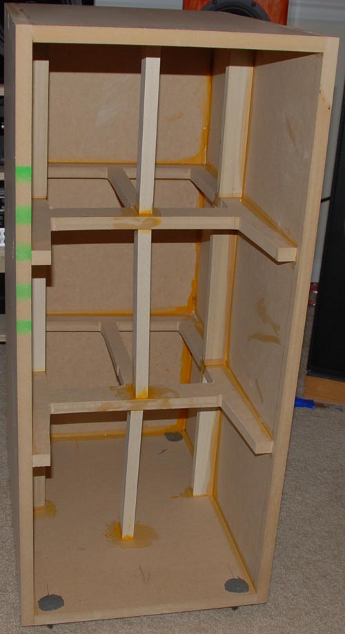

    First of all, those look absolutely beautiful, Jim!
    I really like the way you designed your internal braces.
    As far as porting, IIRC, advise was given by our moderators that porting is advisable if you don’t have base bins or a sub to get a little more LF extension.
    Concerning the finish on the cherry, it has been a while since I have done any, but with a quality wood like that, my personal preference would be tongue oil. I like a minimal approach to inherently sensuous woods like cherry.

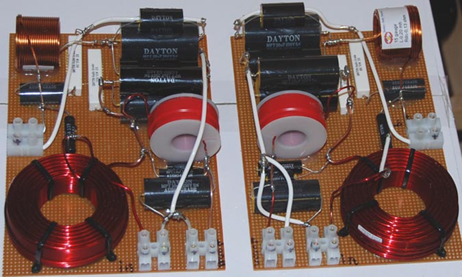

                                          I got my crossovers finished this weekend! Could have done more but I finally got my first HDTV and have been mesmerized by DiscoveryHD. I really can't stop watching it.

                                          • digital desire
                                            • 250
                                            Looks nice!
                                            I don't think I have seen mirror image crossovers before!
                                            (If I have, I did not notice...)
                                            Peter
                                            Syracuse, N.Y.
                                              V nice work, Jim!

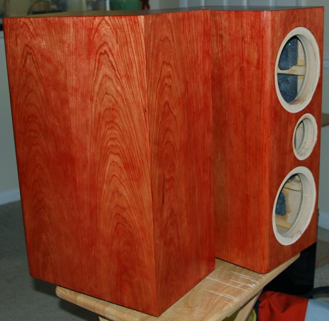

                                                Here they are! Thanks to all the good suggestions for finishing. I ended up using 3 coats of boiled linseed oil thinned 50/50 with naphtha, 3 coats of button shellac with just a bit of transtint bordueax dye in the shellac, finished off with 2 coats of original Waterlox. I think they look better in person than in the picture, I guess I have to statr working on my photography skills.

                                                • digital desire
                                                  • 250
                                                  Wow, I *really* like that finish!
                                                  Nice Job!
                                                  Peter
                                                  Syracuse, N.Y.
                                                    Marvelous, Simply Marvelous!!!!
                                                    Of course, it is your opinion that matters the most, but I think you should feel pretty good!

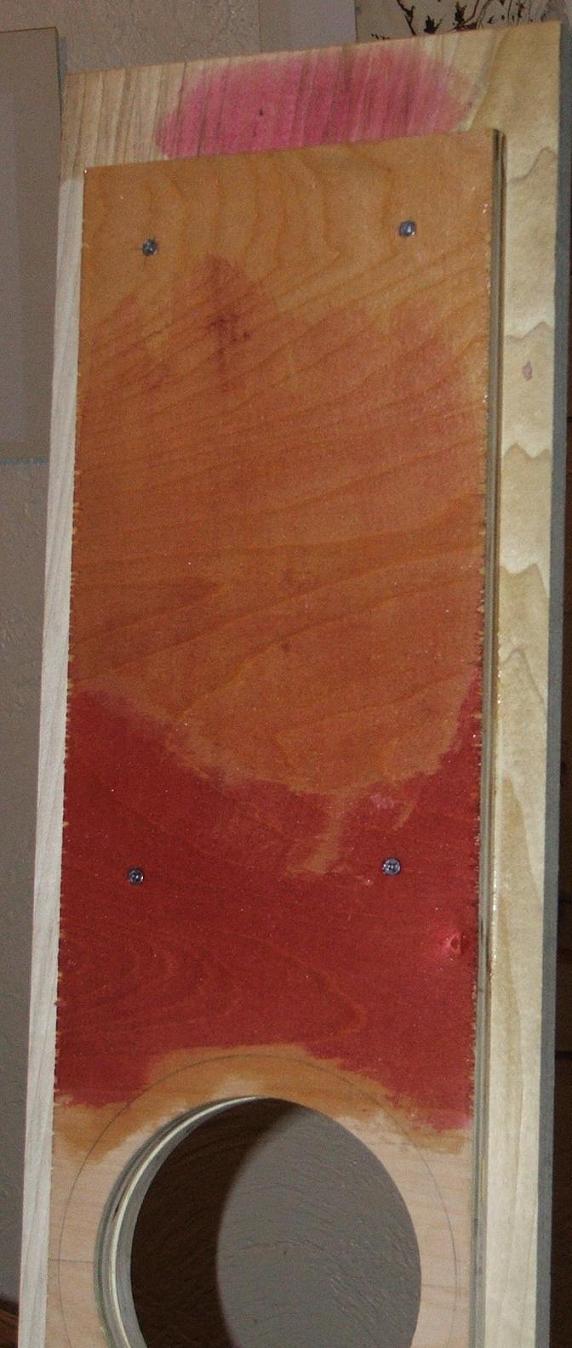

                                                      Gotta love Woodcraft! Go easy with that Transtint dye. I only used 3mL of it to tint just under 1 quart of shellac and the difference was quite noticeable. If you plan to use it mixed per the label as a dye I woud imagine the results would be much more dramatic. Can't wait to see how yours turn out.
                                                        I tried some techniques today.
                                                        Top section on inner Baltic Birch baffle is 3 coats of tung oil.
                                                        Section below is 1 coat of tung oil, the tint over top of it, with 2 coats of tung oil on that.
                                                        Bottom section is 1 coat of tint on the bare birch, with two coats of tung oil afterward.

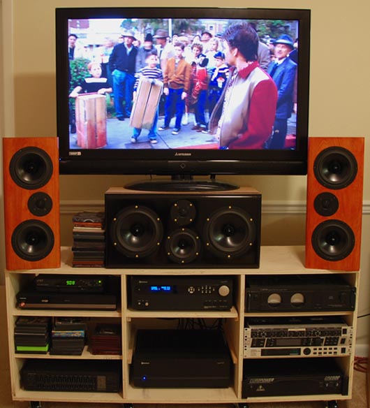

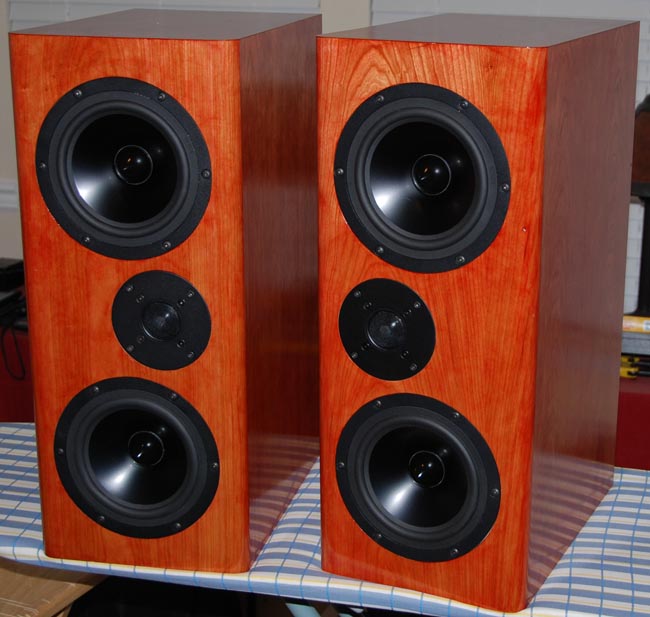

                                                            THEY ARE DONE!! And they sound great! Of course I still need to build the bass bins, but for now they can live next to my TV.
                                                            Last edited by theSven; 18 March 2023, 08:31 Saturday. Reason: Update image location
                                                              Looks great. Very impressive finish. I bet they do look even better in person.
                                                              Oldly though to me, your NatPs look visually smaller than most I see posted. I guess that is a good thing.
                                                                • 16197
                                                                Well, that's a "BIG" CC speaker (the RS WTMW Dawaro and others have built), and a pretty good size LCD. I use a smaller CC as the base in my bedroom for my Westinghouse- Modula MTM's look bigger then, though. It looks like he's used the same cabinet size as the original PE cabs, whereas many folks up the size to get more bottom end.
                                                                Very nice looking results! :T

                                                                    Honestly, I think if you told anyone you built those, they would not believe you. They are just too good looking!
                                                                    • BigJim_inFLA
                                                                      • 203
                                                                      Thanks everyone. I'm very happy with the results, looks and especially the sound! Thanks to Jon for the kind words and for designing a great speaker, and to everyone else who helped me along the way.

                                                                            One bass bin is almost complete! I should have it completed except for the veneer this weekend. Since this is my first attempt at something that wasn't already designed by someone else I'm gonna get one together and see how it sounds before I start the next. If I have to I can scrap the box and try something else. Oh by the way, this thing is BIG! 8O

                                                                                    Originally posted by speedle
                                                                                    Just how "big" would big be? And what's going inside?
                                                                                    It is 34.5" x 22.5" x 15.5". It is currently lined with fiberglass and will probably also get some polyfill depending on how they sound when assembled. I'll be using 2 RSS315-HF 12" drivers. I'm going out to route the baffle right now, should be together by this evening!

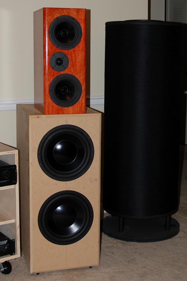

                                                                                        Ok, one is done! I'll be spending the rest of the evening trying to get it set up, never used an active crossover before.
                                                                                        So what is the best way to move a speaker that weighs over a hundred pounds with really sharp spikes on the bottom?
                                                                                          Remove the spikes, reposition the speaker. Once repositioned, rock the box backwards and insert the front spikes, then lean it forward and insert the rear spikes.
                                                                                          2"X4"s work great for leveraging a speaker with spikes up or down.
