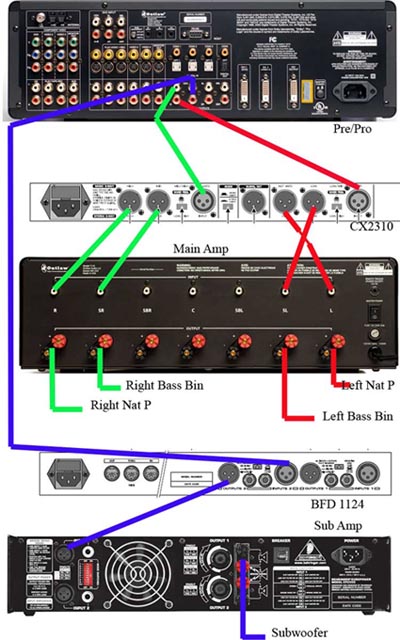

        Yo, BigJim. Do you have a skecth of your setup? I mean wiring from Preamp to Amps to Active Crossover to Speakeers to Bass Bins to Sub? My head is still trying to get around this configuration.
        • BigJim_inFLA
          • 203
          No sketch, but maybe I can explain it.
          Sub out on preamp to in on BFD1124. BFD1124 out to sub amp, that's it for the sub.
          Left main out on preamp to left in on CX2310 crossover. CX2310 has left out low that goes to one channel of my amp which powers the bass bin, and a left out high that goes to another channel of my amp that powers the Nat P. The right side is exactly the same just substitute right for left.
          The hardest part is finding all the right interconnects - balanced to unbalanced, rca to XLR female, XLR male to rca...
          I'll see what I can sketch up if you need it.

            You looking for something like this.
            This is my receiver-------->cx2310----------->amps
            I think is the same setup as Jim.

              Thanks Mike! I knew I saw that somewhere. Mine is very similar, but like this.

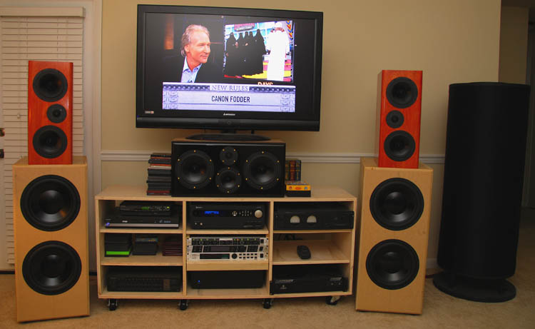

                      Last update until summer vacation. I finished the second bass bin and will live with them as they are until I can take the time to veneer them when classes end. They do sound awesome! I don't know how much my neighbors appreciate them though. I'm going back to listening! :B

                      • WillyD
                        • 675
                        Pimp!

                          Jim-
                          I love your Nat P + bins build.
                          I'm considering Nat P's and possibly putting bins under my L and R. How significant was the improvement after adding the bins?
                          Max
                          • Jonasz
                            • 854
                            Love these speakers!
                            Why not upgrade the crossovers to Modula MTM?
                            • BigJim_inFLA
                              • 203
                              Originally posted by coctostan
                              Jim-
                              Max
                              I would say it was significant enough to be worth the time and money invested. Taking the LF load off of the 7" mids allows much cleaner sound especially at higher SPL. I can also cross to my sub at a lower frequency, or just not use the sub at all, which I think sounds a bit more natural when listening to music.
