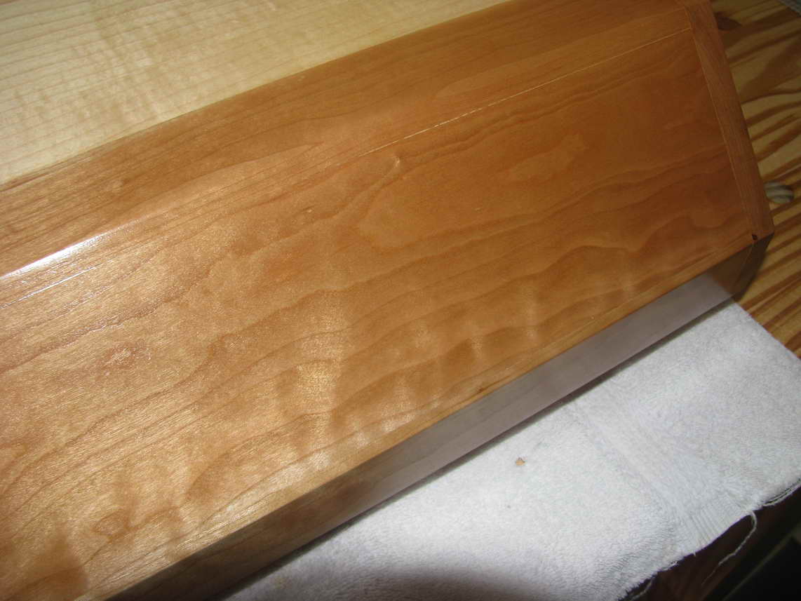

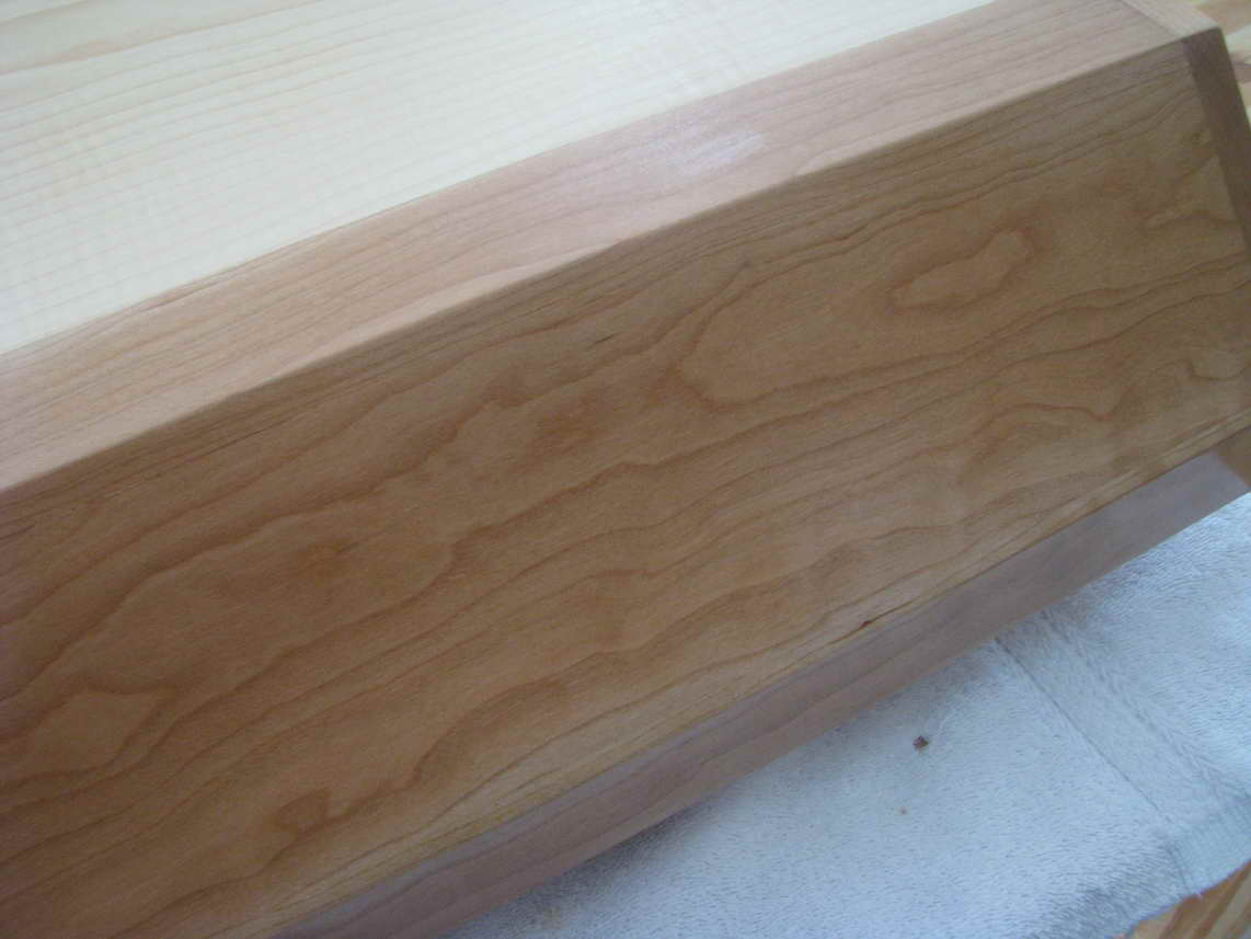

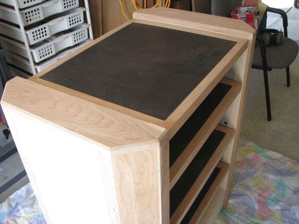

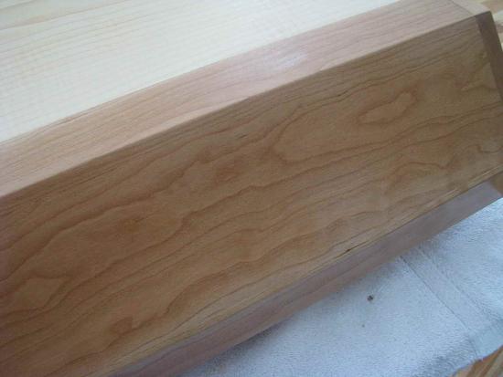

                • 2142
                To answer your question about fading ...... I have not seen any so far. I finished the project I used it on, an equipment rack, back in 2011. I did use it to tint wood putty rather than stain, so I would expect the putty to age a little differently than the real wood. The color did change a little differently when I put the clear finish on it compared to the real wood, I'll attach a few pictures. This would not be an issue since you are dying the entire project.
                I'm with CADman on getting it close enough though, if your new box is a different species of wood it's going to fade differently anyway, and I can attest to driving one's self crazy trying to get it perfect, I'm never completely happy with any project, though I still keep trying.
                Here's a few pictures of where I used the dyed putty...... left side at the intersection of the cherry top cap there's a little chipping if you look close.

                After finish ......

                A comparison of how the color change some after putting the finish on, blended in very well with no finish .... something else to keep in mind next time I use it.

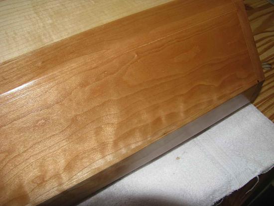

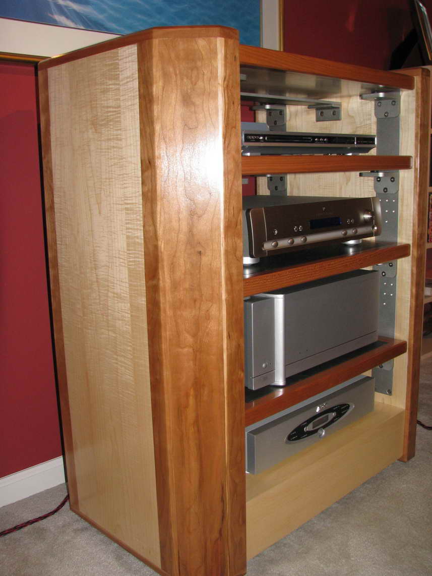

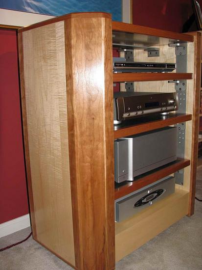

                    Really nice work on that equipment rack, Steve... If we had a woodworking hall of fame in Mission Possible, I'd nominate that for it!
                      I concur. Very simple and elegant. I like the contrasting woods....

                        Definitely, excellent work Steve. :T Thanks for the follow up as well - thats some excellent work blending that putty in.
