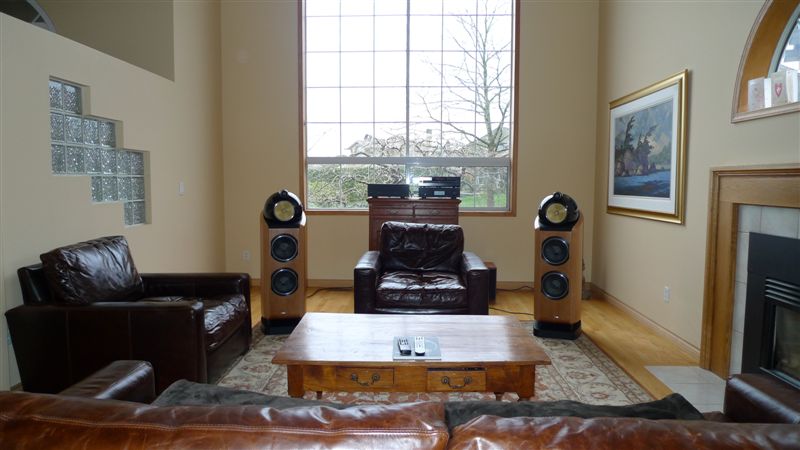

    I am considering an upgrade to my 2 channel stereo system which currently consists of my 802DI speakers, Cambridge 840W 200 watt amplifier, Cambridge 840E pre amp, B&W ASW CM subwoofer, and squeezebox touch for a source. If you had a $1,000 budget, what do you think would offer most bang for the buck to improve my sound.... a Rega Dac or buying 2 corner bass traps for the front of my room behind my speakers. My listening room is 22 feet long x 14 feet wide with a 16 foot ceiling.

    Do the bass traps. Definite bang for your buck. I have an 11 X 16 room with 802D's. I put some Real Traps Mondo's in the corners behind the 802D's and immediate improvement occured.
    I would consider the following:
    2X Mondo Traps, $300 each.
    2X RFZ Panels, $250 each. Covers the first point reflection. Although from your picture, there might be tight placement options.
    You will love these improvements.
    Hope this helps.

      Yes, and a non-reflecting throw on top of the coffee table.
          +1...(Re)moving the coffee table...biggest bang for the buck...

            I agree about the room treatment, although for your room I might consider acoustic panels before the traps to eliminate reflection. WAF might be a problem unless done right.
            I am in the process of building my on panels using OC 703. So far I have them all made, I just need to cover in micro suede or something similar. This would cost much less then $1000 if you are a little handy..

                  Hi Spacemanrick,
                  long time I'm away from the forum... If I remember well you're the guy that posted pics of the listening room from the upper floor, meaning there's totally lots of air volume considering the room in the three dimensions. So I'd say maybe bass traps are not the first choice.
                  My 2 cents, I'd go for a good power cable for the CD player (if you don't have one yet), and Finite Elemente Cerapuc below the speakers.
                  The power cable should improve the level of detail, and make the sound more natural.
                  The feet for the speakers, should tighten up the bass, increase the dynamics and the low-level details. If you plan to stay on the rug, spikes are best. But I recommend the Cerapuc feet straight on the wood.
                  And remove the coffee table, that's for free. +1 to it.

                        • alebonau
                          • 992
                          yes I'd say upgrade the pre and power amps as well if can.
                          just looking at the pics very hard to see, and have a lovely room but the speakers look a tad too close for the listening distance ?
                          ie they could be moved a bit apart for benefit of the sound stage ?
                          also the lounge chair inbetween the speakers right in the middle of the sound stage ?
                          even if dont spend a $1000, would consider playing around with speaker placement if not something tried as yet.
                          postion positon position is critical with speakers. mess up the positioning and no amount of room treatment and eq etc can fix things up. so any improvement gained in postion will pay huge dividends and any money spent on treatments, equipmetn etc will only bring additional benefit on top.
                          could also consider postioning along the long dimension of the room if too narrow way you have it. will give you more width and perhaps enough depth to achieve what could be a pretty good result

                            You have a very nice looking room. I have to agree with most of the other posters. You will get the biggest bang for your buck with room treatments and proper speaker placement. No equipment in the world will give you a better return on your investment then room treatments. You definitely have to do something about that table. It's definitely causing you to have some reflection issues based on its' position. I don't know if you can get some artful bass traps; but, I do know that you can get some artful panels to cover the first reflection points that would blend with your room very nicely.
                            We all have to make compromises and live with what we have. So, I would suggest that you do what's acceptable between you and your wife.

                                "2X RFZ Panels, $250 each. Covers the first point reflection. Although from your picture, there might be tight placement options." .....htsteve do you mean placing these over the windows behind my speakers or behind my sitting position on the sofa?[/QUOTE]
                                I believe he is referring to the walls to the sides of your speakers. However First Reflection Points can also be floors and ceilings. Since your ceiling is so high and you have a thick carpet, your walls are the concern, IMO.
                                To find your first reflection point, see:
                                Create a reflection-free zone to improve stereo imaging.
                                I did not want to mention an amp upgrade since your budget is $1k however doubling my amp power was an enormous upgrade. Although a substantial increase in your budget, I would definitely put an amp upgrade atop your list asap to fully appreciate your 802Di's.
                                  Spacemanrick,
                                  This is exactly what I meant. The side walls. Also, I believe the Realtraps come in a tan color that might blend well. They also have a more decor friendly line, see below.
                                  Also, I like your idea of placing traps in the corners and removing them when warranted. Most Real Traps can come with stands that make this a real possibility. My bass traps are on stands.
