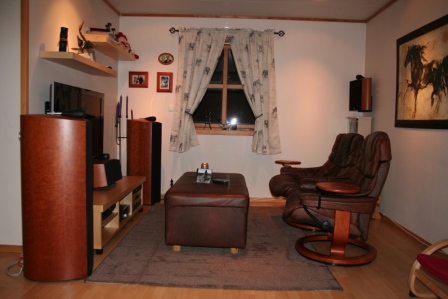

    My room is shaped like this:
    And this picture might give an impression of the distance between the speakers and the listening position:
    Thanks, TEK

    The space is a nightmare!....might as well use headphones....
    803 are good speakers you'd be hard pressed to build something better.
    Looks like you could use a BIG deep diffuser and absorber on the back wall.
    But first.....
    Make some frequency response measurements to see where there's peaking. Then does your receiver/pre-pro have tone controls? If so start playing with them.

                That's a tough set up. Have you considered rotating your entire set up 90 degrees clockwise? So that the window is in behind the tv. That way you'd have a more symmetrical wall arrangement. Right now, you're getting vastly different side reflections from the left vs right speakers. If you rotated everything, you'd have a decent starting point from which to add bass traps and first reflection absorbers.
                Overall, you need to get your reflections and RT60 under control. Only then will you actually be able to tell if your speakers are too bright. In the current arrangement, any accurate speaker is likely to sound overly bright.
                If you don't have the option of adding acoustical treatments to your corner of the room, you might want to consider an Audyssey Pro eq system as a contingency.
                • warnerwh
                  • 261
                  Something to keep in mind is that the bass to treble relationship needs a good balance besides measuring good. Btw you don't want a flat frequency response in your room because it will sound thin and bright. You want the lowest frequencies under 120hz or so to be boosted a bit.
                  It's a room/taste adjustment so nobody is right or wrong. As mentioned above the Behringer DEQ 2496 is a very wonderful tool. At it's price it's an absolute killer bargain. With it you can adjust your speakers to your taste with ease.
                  Before I did anything I'd cover up that window with very thick curtains. Also a nice sized absorber made with rigid fiberglass behind your head about 4" thick will help a lot. The right corner needs one of these 2'x4' absorbers stradled in that corner.
                  Room acoustics make a huge difference in sound quality. It's hard to understand until you experience it first hand. Your room is an acoustic disaster. No offense meant what so ever, it's just what you have to work with.
                  I'd also try changing speaker position a bit. There's no rule set in stone where your speakers need to be, just rough guidelines. If you point them so they aren't pointing directly at you this will reduce the strength of the tweeters as you'll be listening off axis where output is down.
