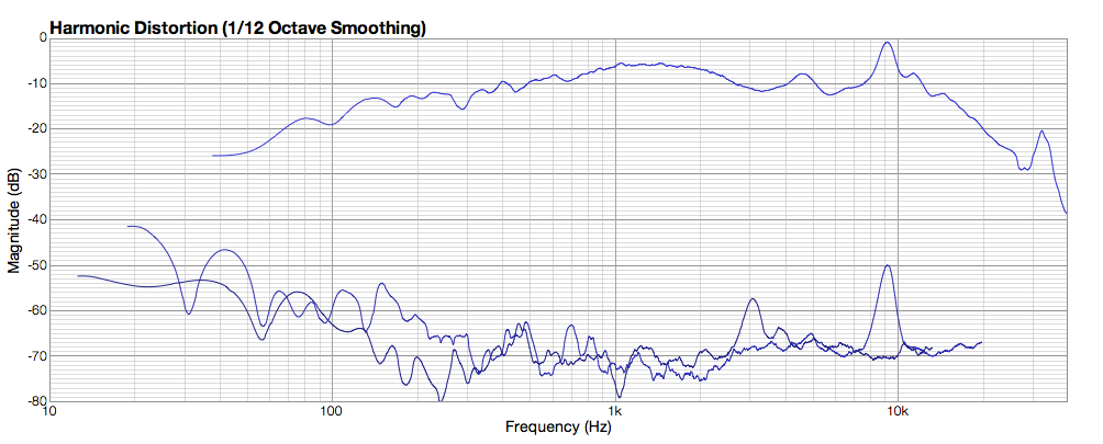

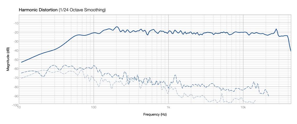

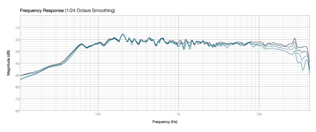

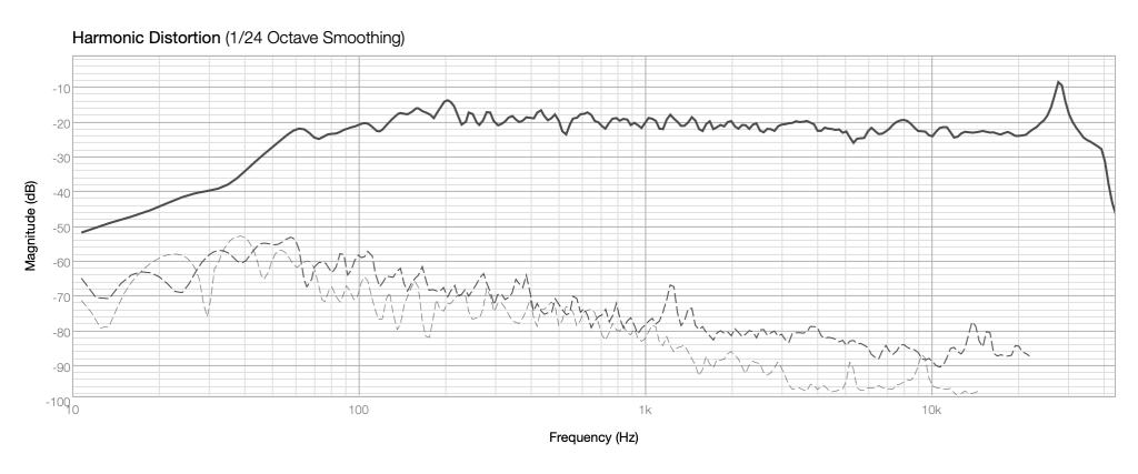

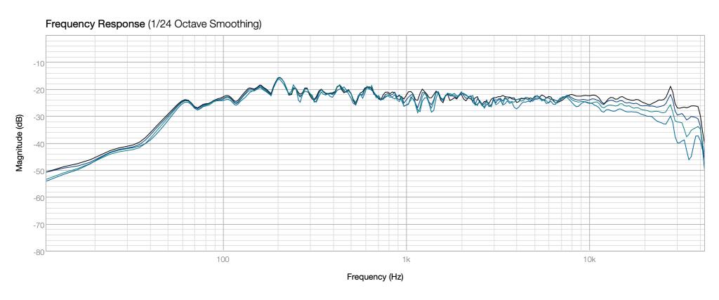

    This is a test setup with just a 1 cu ft sealed enclosure on the woofer, no attempt to address sub 100Hz yet. Measured in room with a 200ms window; 1/24 octave smoothing- no trying to make things pretty and smooth with 1/3 octave smoothing.
    For those that are curious, with and without the notch filter, showing distortion products. With this tweeter, you could likely leave it off without issues...
Name:	Ref Voiced with Peak Disto.jpg
    With ultrasonic notch filter
Name:	Ref Voiced Notched Disto.jpg

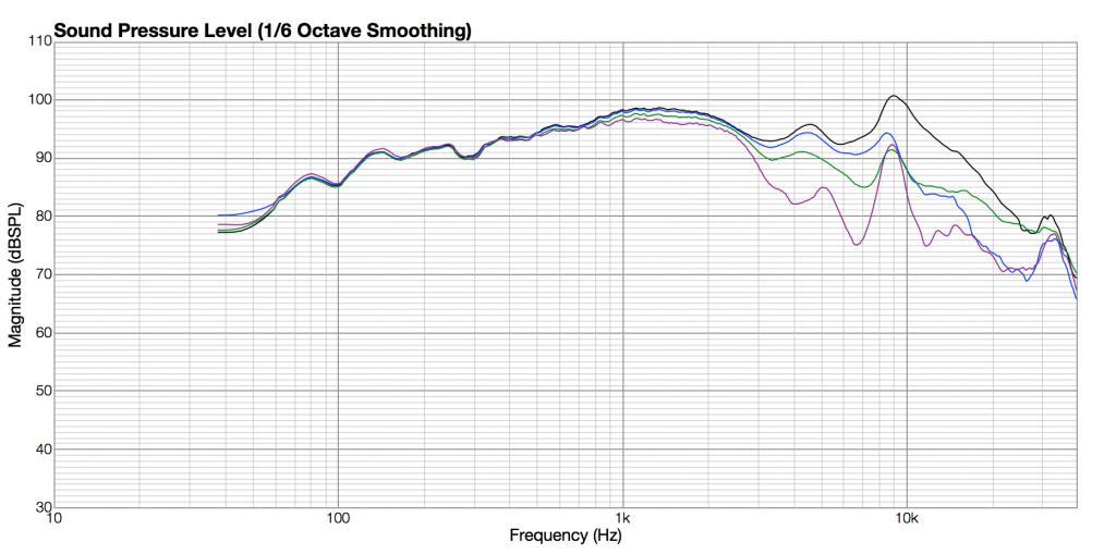

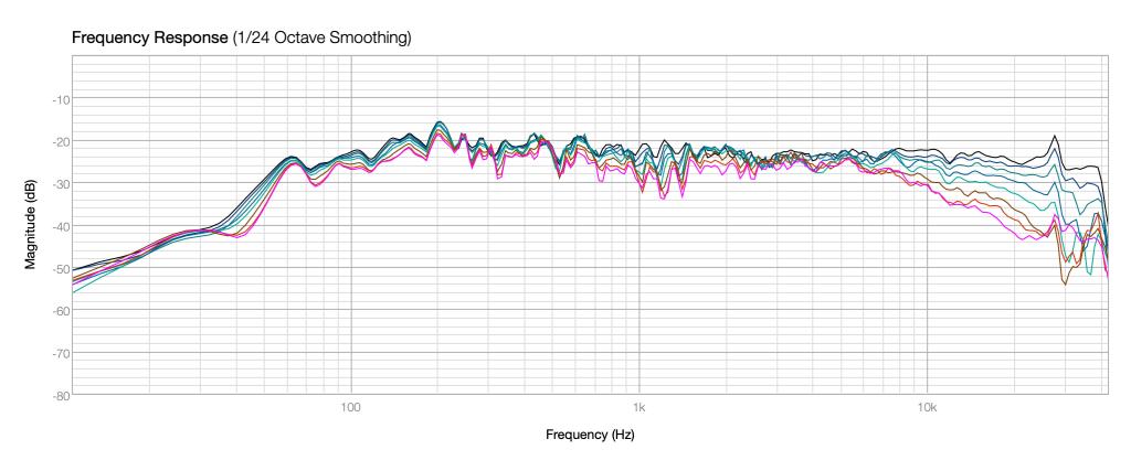

    Polar response, 0 - 30 degrees, 10 degree increments- this would constitute the typical direct sound listening axis.
Name:	Polar 0-30 Deg MkII.jpg
    Polar response, 0 - 70 degrees, this is the forward 140 degree arc. These sound very good walking off to the side compared with most speakers.
Name:	Polar 0 - 70 Deg.jpg

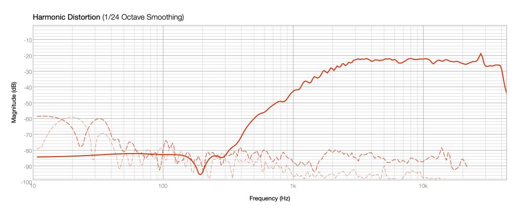

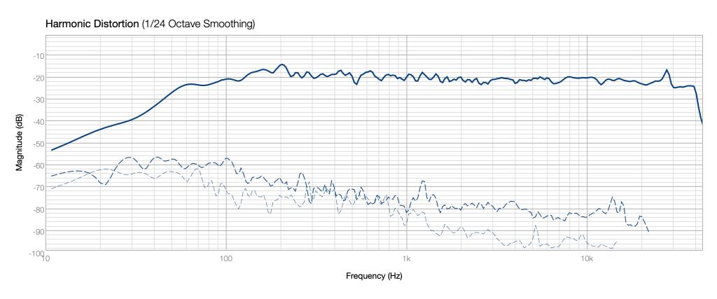

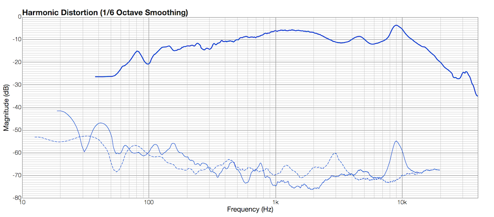

      A look at the individual drivers.
      And how do the drivers look individually with their crossovers?
      MW19P-8
Name:	MW19P MkII Disto.jpg
      DA25-TX002
Name:	DA25 MkII Distor.jpg
      You can certainly say it's a quirky build for the DA25, but with it's flat plate, stiff diaphragm and reasonably high performance motors, it's one of the best $300 tweeters I've ever measured of late... and the best one that doesn't cost $300.

            Graphs look very promising indeed and that DA25 is a great find. Very good to see this project progressing steadily. Steve you have to keep Jon on a short leash though as it seems he's coming up with more new and old/new projects to last him for years to come
            Seems I've dropped off a wagon for a bit though. Are these latest graps with DA25+ waveguide or a regular baffle mounting?
            Also I assume the drive level is your usual 2.83V and measurement at 1m (just to but THD plots in context).

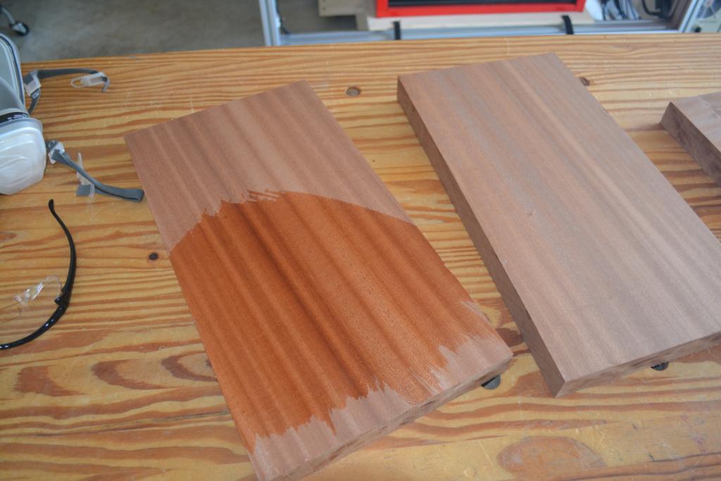

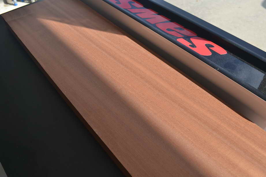

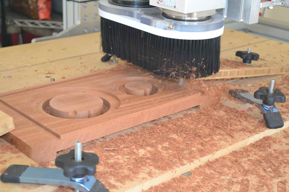

                Just to show Jon's not having all the fun of late and an idea for those interested in sprucing things up a bit. Here is a project just shipped out to a fellow group member who wanted to kick things up a notch.
                The process started with selecting a nice piece of quartersawn Sapele.
                A little water showing what it will look like after finish is applied.
                Machining in progress ....

                  No waveguide involved here- this is the "basic" MT design as a proof of concept for the new cabinet construction technique Steve has been woking on. Intended as a "demonstrator" of sorts, but also a decent basic design with some new drivers (for me).
                  Driver levels are the typical 2.83 VRMS- of course, the tweeter is padded down to match the woofer sensitivity. But it looks about the same running direct by itself.
                  I'm guessing that due to the relatively flat dome and the flat mounting plate, this accounts for the very consistent behavior on and off axis with just a steady drop off in level off axis with increasing frequency. I've measured a LOT of tweeters this summer and I just haven't been finding this level of consistency. If the motor wasn't good and clean, and capable of handling some power, that wouldn't be worth warm spit, but apparently the part was designed for high power handling and does quite well.
                  Now, I have done some weird things.. (not with the ones on this measurement setup above) - taken 4 apart, beefed up the kapton insulation and glued two of the faceplates together to make a stronger faceplate, leaving me with a couple of extra motor assemblies for a $100 each tweeter- net total cost.
                  Anyway, with the crossover design as it is, I can adjust the voicing just by changing the input resistor to the HF network. I think I'm close to a final value, checking and listening for hours (while I'm working!) but I've got a new DSP board coming in for the DAC so I may give it some time on that, too, before making my final suggestion to Steve. In the end, he'll listen and tweak too, I think.

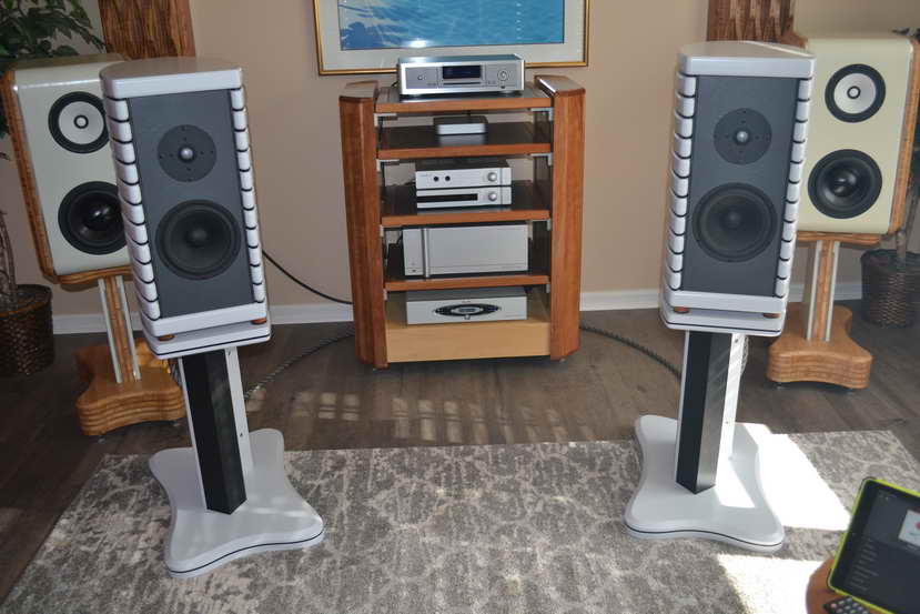

                  Current listening setup is a Tascam transport driving the Denafrips Terminator DAC (haven't had time to get the music server up and running or my I2S setup going), feeding a Hestia Preamp into a Hyperion amplifier- it's a condo system, all my big guns are in storage in Idaho. Got to bench and report on them soon, too, but very good sound for the money. But I'm sure it's a leap of faith for people to buy stuff from Singapore sight unheard.

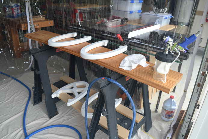

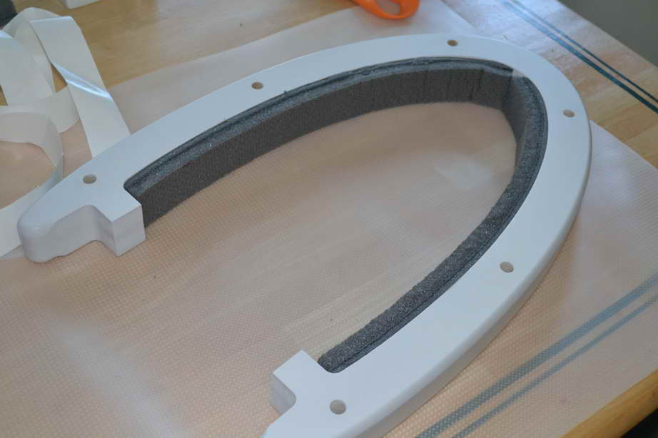

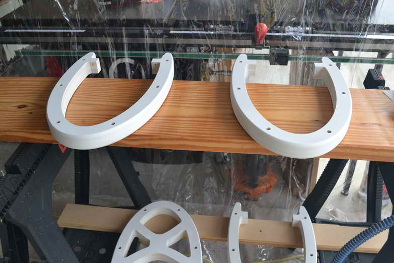

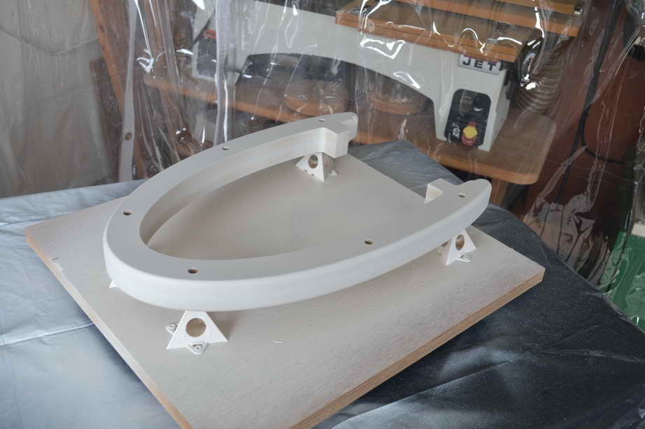

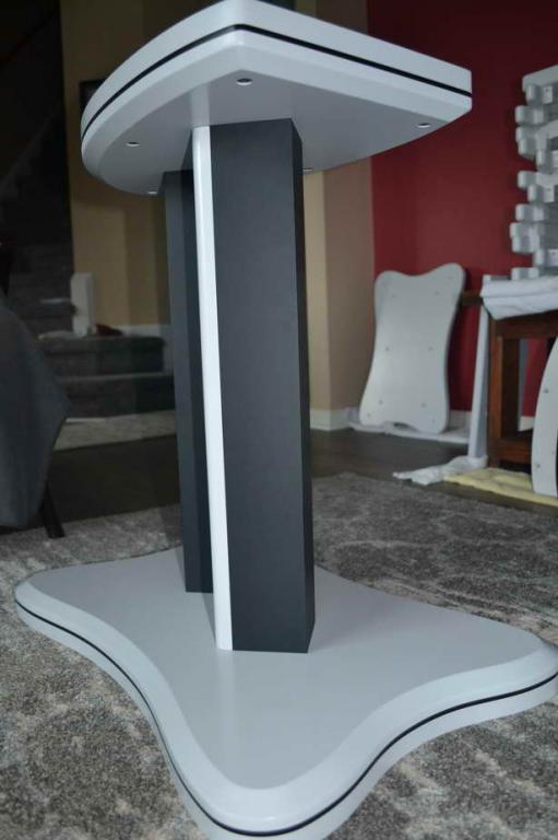

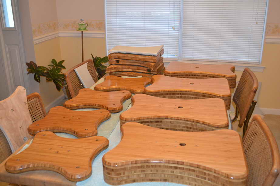

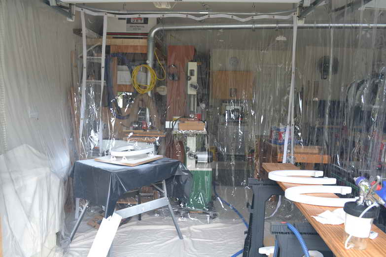

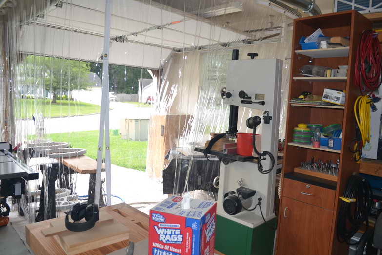

                              Figured I'd show a few pictures of the last area of upgrades to the shop, where I do any finish application. I replaced the hanging tarp setup with a track system and some heavy duty clear curtains. For the most part I can leave everything in place, close the curtains and get to work.
                              Here are some pictures of the cabinet parts getting a coat of primer ....
                              Of course it became apparent that I now need build a drying rack for parts .... it never ends.

                                -might be better for the finishes to "hang" parts in a *cabinet for drying (..assuming they can be hung like the one in that pic.).
                                *perhaps with temp. and humidity control (..along with dust of course).
                                  • 2142
                                  #151
                                  Completely agree with you Scott ...... unfortunately controlling the temp and humidity are not in the budget at the moment. I'd like to do a ductless mini split, but I would really need to replace my garage doors as well to make it worth while.
                                  I've thought about hanging the parts, though I only need to be concerned with the outside edge of the ribs, it's the only parts visible when the cabinet is put together. As such sitting them like I am won't mess with the "critical" areas of the finish. I am however priming the entire piece to make sure it's sealed to the environment.

                                    You can find a plug-in dehumidifier that should work well in either a large cabinet or small shed. Use low expansion foam to seal any openings/seams, and then put a gasket on the doors. It won't be high volume, but all-in, it should be cheaper than a new garage door.

                                      In the past I've gone this route as well. Typically when I'm done spraying I let parts sit in the house for about a week to let things setup better. Fortunately my wife is very understanding. :W
                                        This is a VERY cool way of doing this. I made myself one of these once as well to spray lacquer. I was able to drop my garage door, and then I had a HUGE attic fan that pulled air from the top of my shop down, and out the door. Really worked pretty well.
                                        Here's a link to the setup I used:
                                        I'm getting ready to start building two sets of Ochocinco's. I'm going to be building my Ocho's different than the original design. Because of that, I thought that I would try and do something that I've never really done in the past, document what I'm doing, and try and be diligent about it. Hopefully this information is

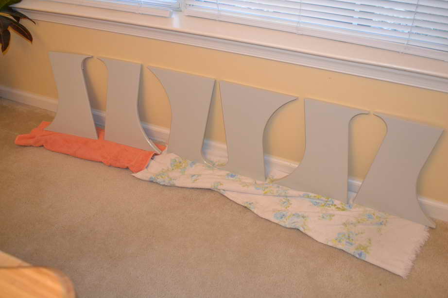

                                              A bit of an update ...... I found some folding racks for the spray area that has allowed me to triple my thru put. All the parts are sprayed and some assembly is underway.
                                              Speaker parts curing in the a/c ....

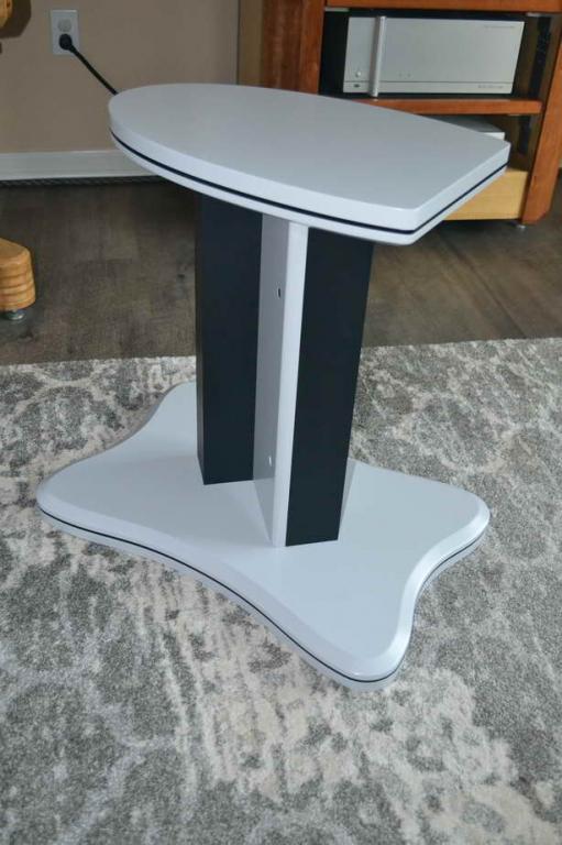

                                              First stand under goes assembly.

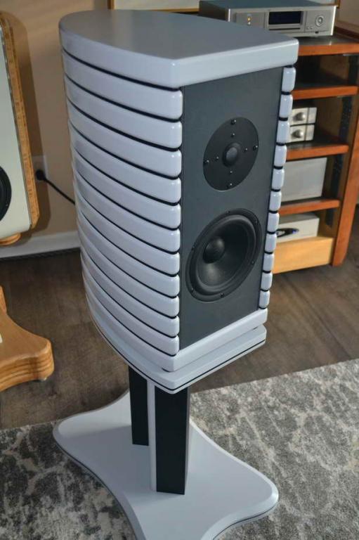

                                                            Since it's been a while due to working on a few other projects, I figured it was time for an update.
                                                            With all the parts finished I installed some dampening material to most of the ribs.
                                                            I also had spent a fair bit of time finding a good solution for sealing the ribs and spacers. This material ended up under the third times a charm category since I was not happy with my first two choices.
                                                            Installing the xovers that Jon sent out and working on final assembly.

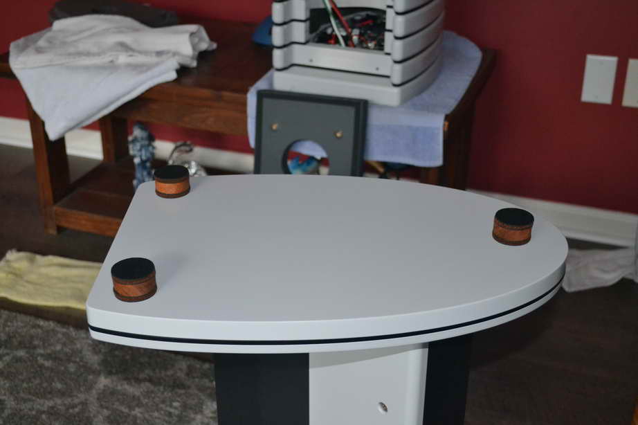

                                                            After much searching and not wanting to pay the crazy prices, I opted to make the feet for between the cabinets and stands since they need to be a specific height.
                                                              • 2142
                                                              #165

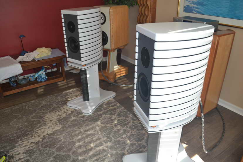

                                                              Feet finished and in place ....
                                                              A few shots of the finished speakers playing away.

                                                                  Very impressive- a strong combination of technology and craftsmanship.
                                                                    • 1044
                                                                    #168
                                                                    Looks great! I would have expected the ribs protruding beyond the face plane of the baffle would have created diffraction issues. I'll acknowledge immediately that you guys know what you were doing so did you not think that it would happen, or was it a risk that didn't materialize, or somewhere in between?
                                                                      • 2142
                                                                      #169
                                                                      Many thanks Master ET .... I aim to please.
                                                                      As to the sound .... only a short listening session yesterday. With them pretty much just plopped in the middle of the room and ~3' from my chair a fair assessment will come once they are located where they need to be. In other words I didn't have the energy to lug all these heavy cabinets around at the end of the day. :W
                                                                      Initial impressions though, is that Jon has done his usual magic with the design choices. Very clean and detailed, as Jon has stated this tweeter punches way out of it's price range.
                                                                      Diffraction issues were considered ..... edges are rounded over as well as foam strips are inserted vertically along the edges of the baffle to help with that. In an ideal world this would of course be measured, but test equipment needed for that are not in my arsenal of tools. This is a similar issue with the Ardent's. They are supposed to have a bunch of felt glued to the front baffle to alleviate diffraction at the edges of the facets. Take a look at how many folks have actually done that with their builds .... not many, but they still sound pretty amazing!
                                                                        #170
                                                                        Technical measurements of the unported test cabinet
                                                                        For those interesting in technical performance, these two graphs were taken from the development test cabinets which were not ported, but also located well out into the room to minimize boundary effects.
                                                                        While one always wishes to to provide a well optimized design, as with armed conflict, the enemy will have a say also; in the case of your listening room, it's the room acoustics and the speaker positioning that can be just as critical as the original design. One might review the measured in room performance of many of Troel's designs- some exhibit quite a bit of room interaction in most unfortunate ways... but that is more likely due to room size and positioning than the intrinsic quality of the design.
                                                                        Polar reponse 0 - 30 degrees
                                                                        On axis response with HD2 and HD3 distortion
                                                                        Cardas placement will usually produce the most optimum results, but may not be feasible for some due to space limitations and existing furnishings.

                                                                          How does it behave in vertical plane given rather large distance of acoustic centers at Y axis ?
                                                                          If the crossover point is low enough it might not present any audible problems but still...
                                                                          Tesla; George Carlin;
                                                                            #172
                                                                            The crossover is at 1800Hz, and the CTC is lower than past similar designs or the first test cabinet setup. The test cabinets had a combined CTC of 11", but at a listening distance of just 5 feet, the subjective response did not alter significantly between sitting and standing. This is not to say that hard data would not be useful, but it was not deemed worthwhile to measure with the original test setup, as the final CTC is much lower.
                                                                              • 2142
                                                                              #173
                                                                              CTC distance on the final cabinet is 7.688"

                                                                                            It should be understood that the crossover design used in the Wavecor Ardent is the same 3rd order alignment with the transition point at -6dB which actually requires a reward time offset of the lower frequency driver as used in the NatlieP and Isiris. In the Ardent style cabinet an upward directed launch is created, which makes up for it's diminutive stature compared with the Irsis.
                                                                                            in principle, there is no reason that a conventional tower cabinet cannot be used, though the launch pattern will change, and the midrange slightly more subjected to floor bounce.
                                                                                            The droids have been bushy at DFAL, and driver tests have proceeded as well as construction of test cabinets and some new system concept modeling...
                                                                                            It appears that the most likely driver complement for the value oriented version will use the Zaph ZA14, based on current test results; one more round of testing is planned over a more rigorous series of conditions in the near future.
                                                                                            Higher resolution tests are planned for both polar behavior and distortion at a number of output levels, but results are very interesting for the ZA14. a system using the ZA14 is only feasible with the WA style crossover.
Name:	ZA14 18_LA.png
                                                                                            This results from tests previously run at DFAL with older tools are quite encouraging, and considered together with the performance of the DA25, obviate the need for a moniker such as "poor man's Ardent"- replete as it is with negative connotations about the ultimate performance. Perhaps "Thrifty man's Ardent" is more accurate...

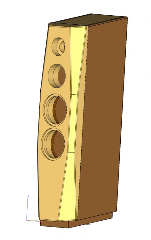

                                                                                            The Duelund concept is still being pursued, but this appears to require more focus on the driver selection, and a very limited number of possible candidates- and most likely abandoning considerations of cost/performance, and only looking at performance. Driver testing should commence next week.
                                                                                            Last, a cabinet concept is proposed which owes inspiration both to the Ardent origins and the Vimberg product line from Tidal Audio. A complete CAD 3D model has been prepared and is being detailed for a test build... this may be limited at first to the Duelund effort.
                                                                                            Note that the angle of the cabinet front and rear to the top and bottom remains the same as the original Ardent and the Wavecor Ardent, but like the Vimberg's, the back of the base is tilted up about 1/2 of that angle, to allow rear passage of the port wave, and to create a more nearly vertical front panel.
                                                                                            Of course, this concept could have room to grow, too, if using drivers like the AS168-9-470, as though the current test build is looking at just two woofers per side, there is no obstacle (other than cost) to expanding this to three woofers per side, with an appropriately lengthened cabinet. But it should be noted that planning for this is attempting to NOT increase the driver BOM compared hugely with the Wavecor Ardent, which limits matters to just two AS168 per side.
Name:	WAKIZASHI ARDENT DUELUND.jpg
