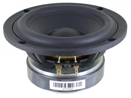

    replied
    That one is in the same shipment, but Steve has expressed a preference for the black cone material, and this is targeting the lowest feasible cost without sacrificing performance. But your input is duly noted and sets a specific target comparison for the planned listening tests.
    How would you describe what the differences in sound are, and have you measured and correlated it to specific performance characteristics?
    Unquantifiably better sounds as if you find that you prefer it, but you cannot quantify why- these situations arise, but generally they both merit and require more detailed investigation.
    Leave a comment:
  • wolf_teeth
    replied
    It might be a cost thing, but I prefer the ceramic model to the aluminum. The sound is IMO unquantifiably better.
    Later,
    Wolf

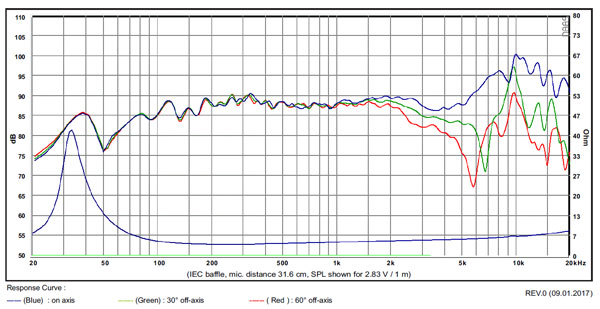

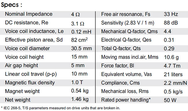

    replied
    Is there another?
    This one may be strong in the Force...
    And Steve tells me he finds the color most attractive....

    I wholly agree with comments about the ZA14 being an over looked part. There is also one other type just ordred yesterday which may- or may not- give it some competition.

    Originally posted by wolf_teeth
    The Anarchy has a black aluminum cone as well, so materials are not different.
    Which Peerless tweeter? DQ25 (relevant to ZA14 discussions)? If that is the one you refer to, I find it to be a pretty cheap sounding junk driver and don't like the broadband glare it emits. Other Peerless tweeters are great, like the Corundum TX line.
    Different strokes for different folks.
    Later,
    Wolf
    The corondum DA25TX; as I understand it's the one being suggested for the designs discussed in this thread.
    Didn't realize the anarchy had an aluminum cone as well, for whatever reason I tend to conflate it with the old extremis. I just remember reading Rick Craig somewhere saying they were essentially the same drivers as the Wavecors with different motors. I don't know how much (if at all) better the xbl^2 motor is than the wavecor 'balanced drive' motor, but if they're comparable it could give the design more longevity and wider appeal.

    I have to concur with the sentiment expressed above about the ZA14 - it has the cleanest midrange I have heard in my admittedly limited experience. I really think it's overlooked by many, I'm not sure if it's the cost, the looks, or limited distribution. In a way it's much like the Peerless tweeter; folks often seem to relegate them to budget builds when their performance is anything but.
    In terms of the woofers used for this project; is the anarchy going to be it for sure? I ask because it seems to be even more limited in availability than the ZA14; at least madisound will ship internationally. I wonder if it might be possible to have an option using the Wavecor sw182bd02 - I understand it's very close to the anarchy woofer, only with an aluminum cone and wavecor motor instead. A pair of them models nicely in a moderate sized ported tower tuned low, something I've been eyeing lately.
