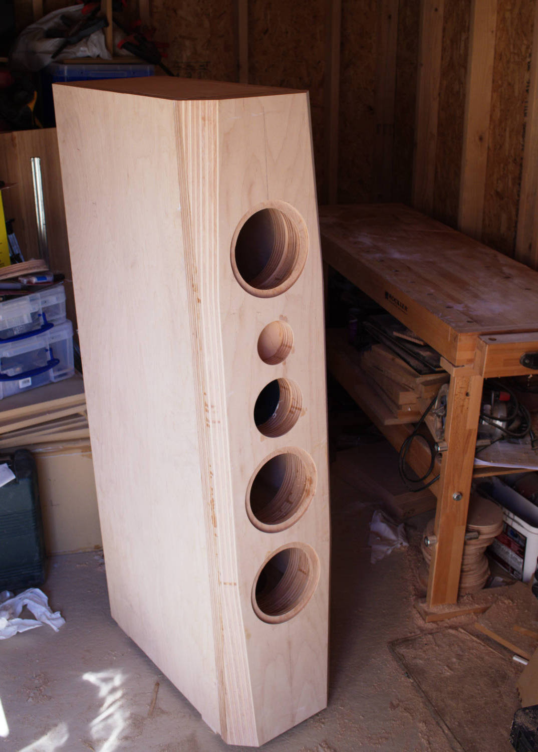

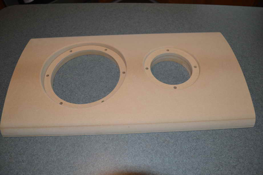

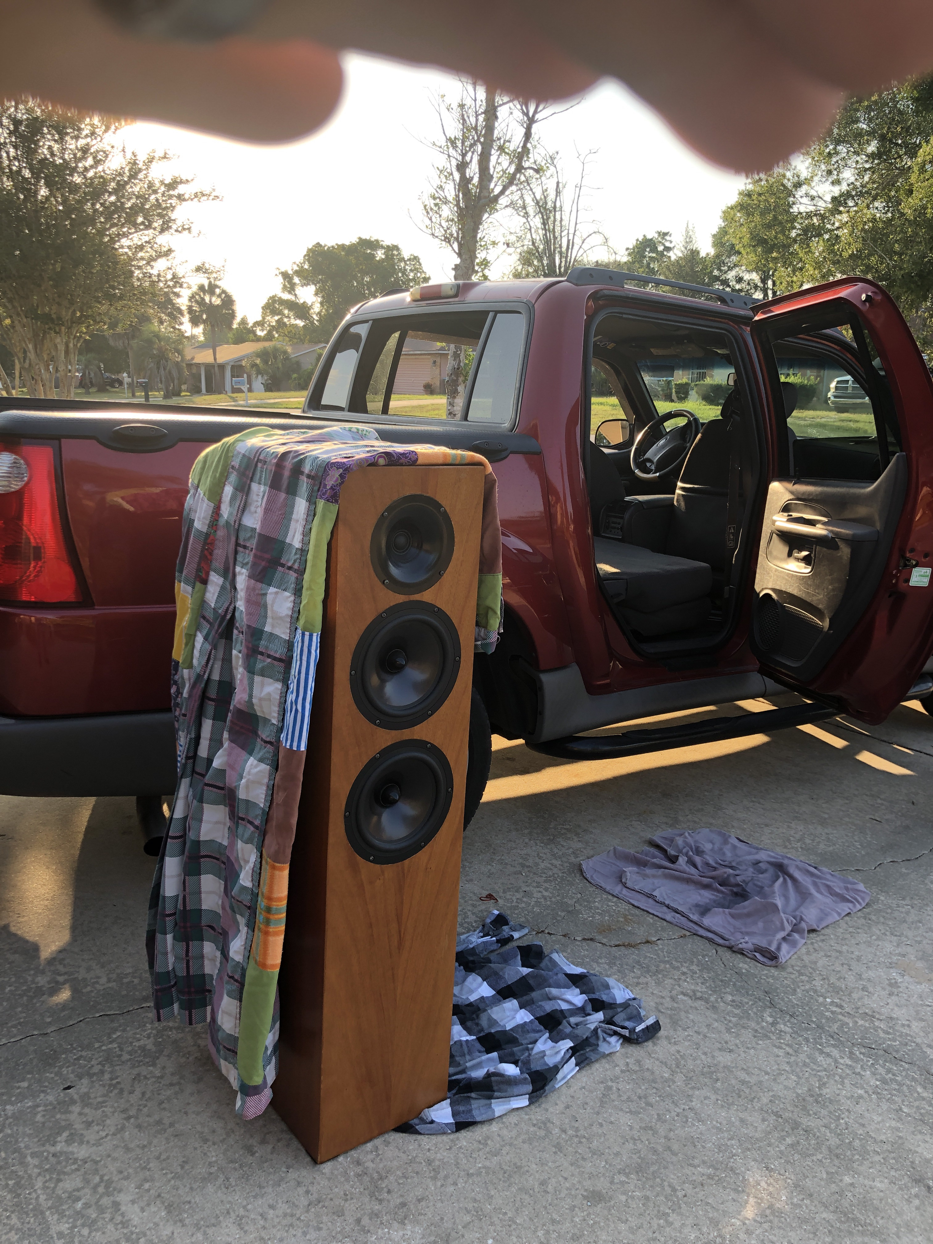

                Your lack of faith is disturbing...
                There are two sides to this issue....

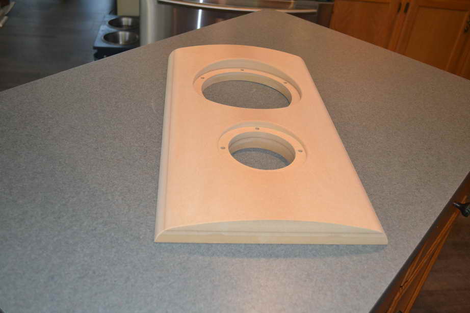

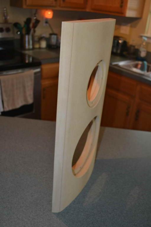

                What combination of tools is the minimum to accomplish the full design intent?
                What impact would a simple tower cabinet have on the results, apart from esthetics? (And one should not discount esthetics considering the many decisions in life most people make based largely on that...)

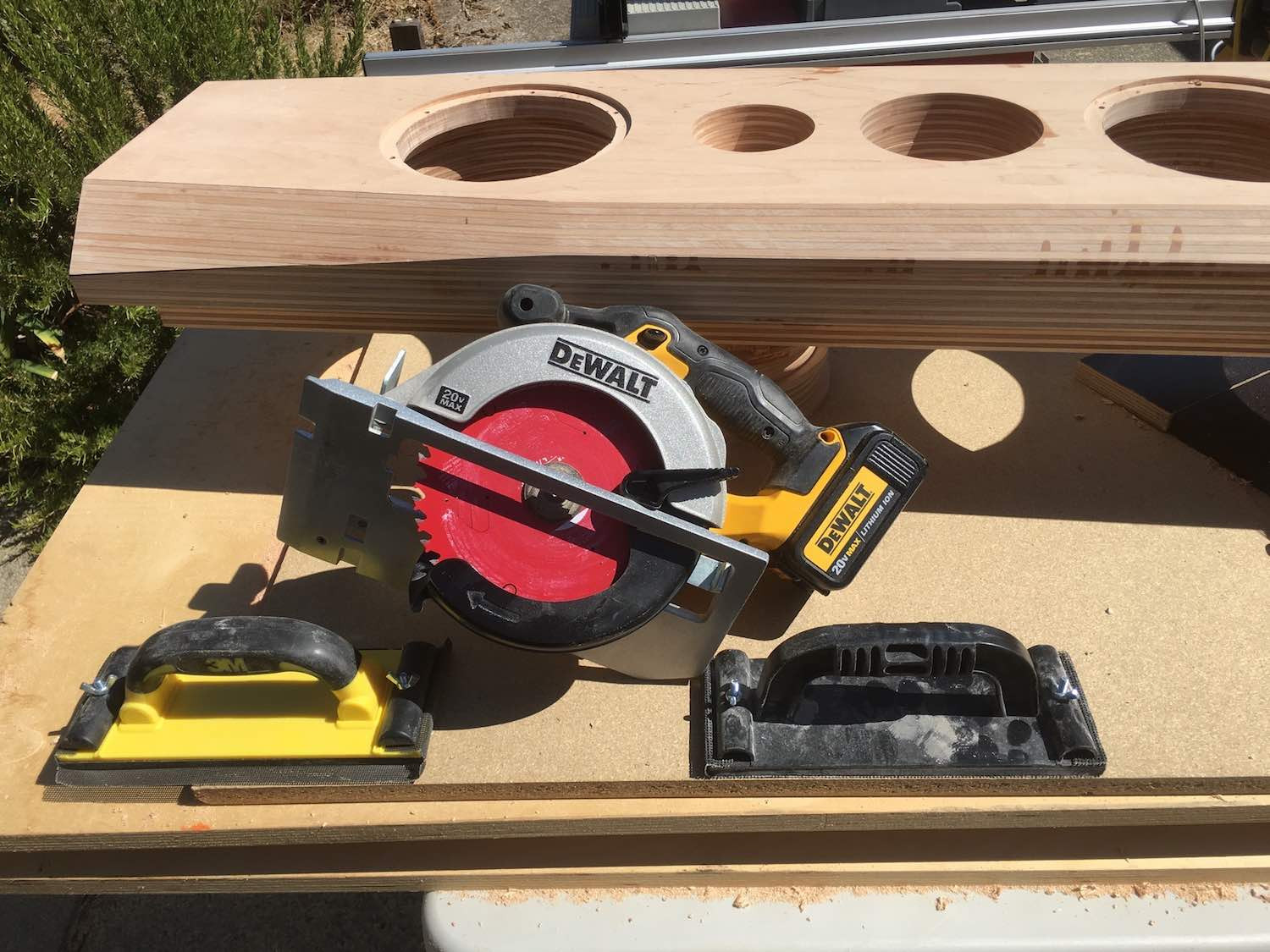

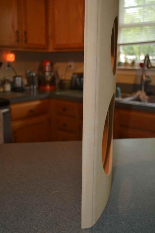

                Consider a recent, similar but more challenging project, currently in storage in the outer rim pending a "peace" negotiation with my primary employer (warning: never negotiate with a Sith).

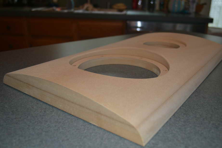

                Consider that it was built using a contractor table saw and a hand held circular saw... here you see when the facet detailing was implemented...

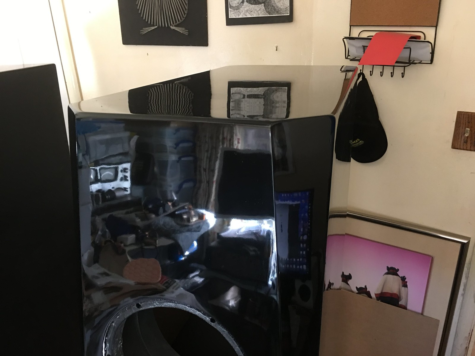

                As a nomad on the run from the insurgent rebellion, I have very limited tooling resources and space compared with skilled practitioners on the board such as Steve Manning and Renron.... they will tell you that my feeble misguided efforts at woodworking are for the most parts clumsy hacks, and I could hardly disagree with them, much as pride might urge me to do so...
                Still, I would argue that the results in the end speak for themselves...
                I also promote the concept that a budget BOM does not mean a budget effort... sweat equity is the foundation of DIY.
                But on to the other consideration- how much impact would the simpler front panel approach have?
                The narrowing of the baffle width will alter the baffle step frequency for the tweeter, there is minimal impact on the midrange driver. But this occurs in a frequency range well outside the operating point of any of the Ardent tweeter crossover concepts, whether the original Duelund or the quasi LR3 concept of the Wavecor Ardent.
                A completely conventional tower construction is feasible, but then, I think I can safely say that the effort loses some of the charm and first look impression...
                That is up to potential builders to decide upon.
                Do note that the tilted back cabinet front does have some other benefits for a system of this height- the midrange to tweeter and woofer integration has a limited vertical window, though broad with the LR3 crossover concept, and aiming it slightly upwards means there are more reverberant reflections from the ceiling, contributing to a slightly more uniform power response. Also, it means that at the listening position seated, one is near the bottom of the integration window, and standing up, one is more likely to still be within the upper limits of that window at any reasonable listening distance.

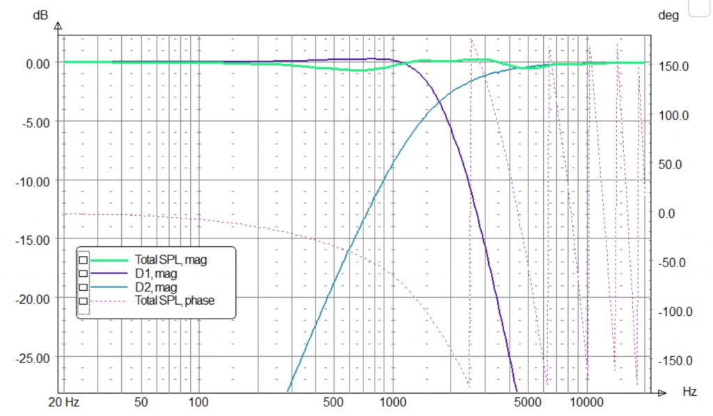

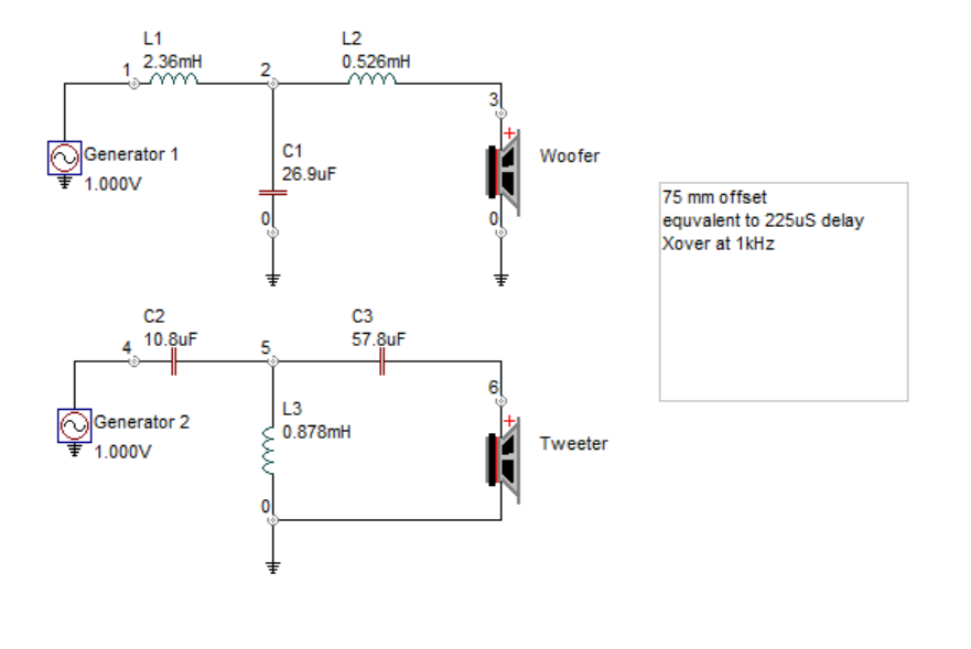

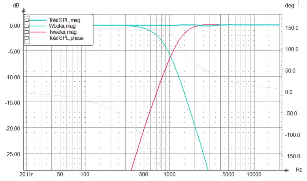

                            #193

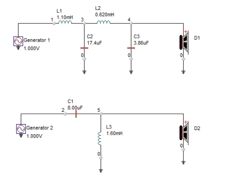

                            Time offset crossovers
                            Originally posted by augerpro
                            rsbonini> as mentioned above, the breakup of the ZA14 makes pulling off the 2nd order slopes tough. In my own testing as I got over 2.5khz LR4 an "edge" began to creep in. Now this was a shootout of woofers, all actively crossed to LR4 acoustic response but no special filtering to accommodate breakups. Because of that I never experimented to see if the issue is solvable (linear distortion) or not (non-linear distortion). That might be something ET wants to check for himself since the breakup is easy to notch on this woofer with a small cap across the first inductor. What I can say is if you cross 2.3khz LR4 or lower, it's the cleanest and most musical of the woofers in that test (SB15NRC, Scan Disco, PEerless Nomex, Dayton RS150P). And it sounded pretty much the same at all volumes until the I finally the bottomed the woofer. Impressive.
                            ET> what is the acoustic center difference for a given XO for that quasi-LR3?
                            There is an optimum point, of course, but also some flexibility. The example shown, which is normalized to 1kHz, uses a 50mm offset- this produced the least overall perturbations when tweaked to as reasonably theoretically flat. This can be scaled directly from 1kHz for the chosen crossover frequency.
                            However, a larger time offset can be used with reasonably similar results, but then the optimization process will resemble "wack a mole" somewhat more, as flattening in one area will produce issues elsewhere. This a schematic assuming a 75mm driver time origin offset.
Name:	75mm 1kHz Schm.PNG
                            And the resulting SPL plot.
Name:	75mm Graph Plot.jpg
                            Now, Hawksford and others have published papers, some in the relatively distant past, about asymmetric crossovers, some using time offsets, most not. This can be thought provoking to research, and has resulted in an experimental concept for a couple of the recently proposed high efficiency/very low distortion design concepts.
                            An example for an 1800 Hz crossover is shown here....
Name:	1800Hz Asymmetric Schm.PNG
                            The result, while not to as tight a tolerance as many might desire, enables high performance with certain physical classes and combinations of drivers...
Name:	1800Hz Asymmetric SPL Plot.jpg

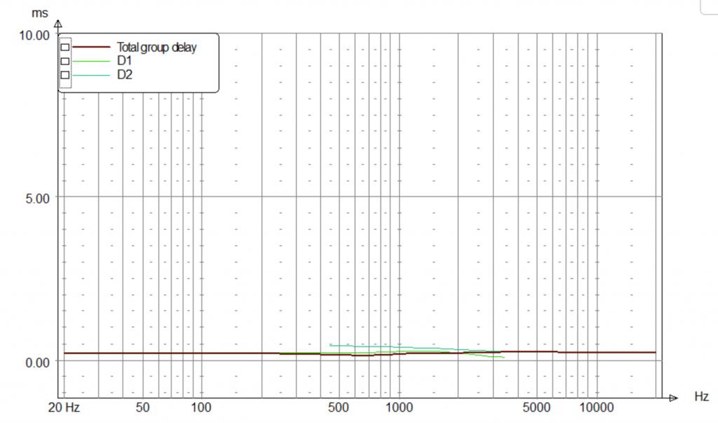

                            And has some very interesting characteristics... most interesting...
Name:	1800Hz Asymmetric GD Plot.jpg
                              #194

                                                                                          New Baffle Option
                                                                                          Just to let folks know, early tests on an actually 3D sculpted baffle looks rather promising. This has been on my list of things to figure out and was prompted by on going work into center channel designs by Jon.
                                                                                          Here are some pictures from the test run. This is essentially the same size baffle as what's on the Calliope MT.
                                                                                            Master of None
                                                                                            • Jan 2014
                                                                                            • 1665
                                                                                            #225
                                                                                            That looks great! I like that look and think the Ardent D’s with a baffle like that would look irresistible for me. Would this also make assembling easier?
                                                                                            Painter in training
