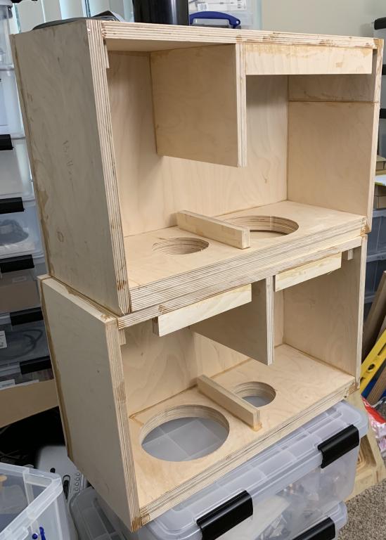

    Something to keep in mind there, is that it is the Lumen cap that is enhancing the Clarity, not the other way around.
    We've used the Lumens before for some other builds, including the Minerva, so that guided the choice. Clarity MR or CMR just seemed too over the top for this case.
    But you know, that's a very individual choice and dependent on the overall system usage and factors like DACs and other sources.
    Right now, I'm favorably impressed after putting a few 10's of hours on the drivers and crossover, but this has only been with the DAC's built in to the TC Konnekt driving a Cambridge 840e preamp and an Aragon 8008 X3 power amp, my standard driver test setup. Since moving in February I've been so busy with work I haven't had time to setup my sonic orbiter based music server and Signature Rendu and Terminator DAC and Hyperion power amp. Working 7 days a week at your day job tends to give one very little spare time, haver to prioritize on the most important tasks...

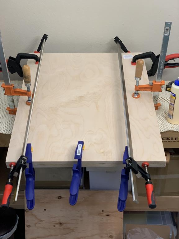

                                When you can't buy 1-1/2" BB ply, you make it
                                I need some 1-1/2" BB ply for the test baffles for test enclosures on the Left Coast for finalizing crossover design and checking things out before the handover to Steve...
                                It's a shame, but the only thing close to that is the 1-3/8" maple Piano pin block ply, which is very fine stuff (see Kurosawa thread) but way too dear in price for this test box. So the only thing to do is to make it...
                                And to think Steve wonders why slow work takes time on the Left Coast...

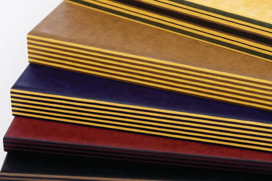

                                  I tried talking him into some of this lovely stuff ..... it comes in thicknesses up to 3". He didn't like the ~$3K per sheet price however. 8O

                                    I think he's talking about the panzerholzen or something- it's a special laminate made for armored cars, primarily.
                                    So if you gotta stop bullets without hauling around a ton of metal, it's for you!
                                    Yeah, I'm a cheap skate when building test enclosures, though not cheap enough to shop HD plywood.

                                      Nope, Panzerholz is cheap compared to this stuff ..... this is Richlite. https://richlite.com/

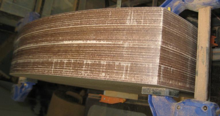

                                            There's always DIY-laminated HDF-ply, as I've done. I will tell you though- the power tools will laugh at you when you go to cut it.
                                            Attached is 4x 1" thick (8x 1/8" layers) slabs clamped together for sanding to the same dimension, and not completely finished sanding as some tool marks are still present.
                                            And yes- this has been the most difficult material I've worked with.

                                              Does not look like fun....

                                                Now that would be time consuming, though rather solid when your done.

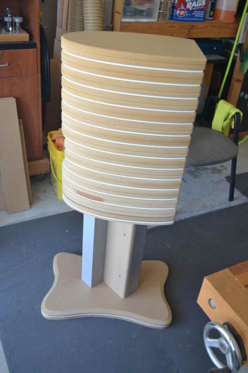

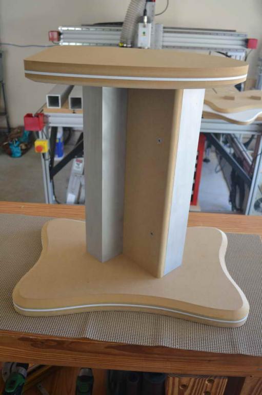

                                                  Yes- I have a lot of time in these. A full 2' x 4' 1" thick 8-ply was easily 50 pounds. To make the pair of boards, I troweled on the Titebond between layers to get coverage, then laid on the next piece and kept going, alternating rough/smooth sides to keep bow at a minimum. I had a clamped straight edge on one end using a 2' x 4' sheet of MDF as the clamping surface while drying. The perimeter was clamped, and large 25# weights placed in the middle to push it down. I do have a slight bit of bow to attend to yet, but that is fixable. It took just shy of a gallon of Titebond to make the 2 boards. At ~$6/sheet, multiplied by 16, and add a gallon of TB, and that is the cost of the material for me.
                                                  The slabs will flank the middle like this:
                                                  It's not unlike the Nimbus or Aurora from Vapor, except the fact that this has more layers and is non-curved. The central portion is a mix of HDF and 1/4" ply underlayment for a total of 45 pieces between the outer pair of plywood layers.
                                                  Time consuming, and not for everyone.
                                                  Wolf

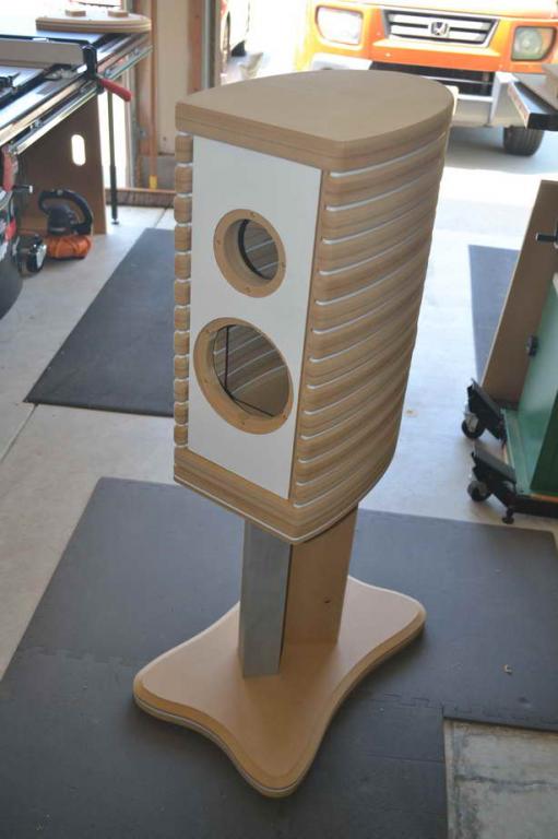

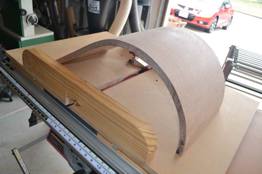

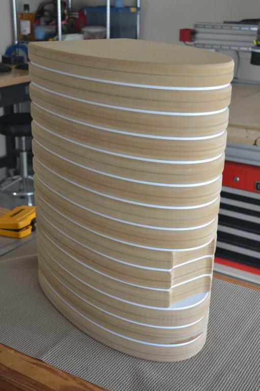

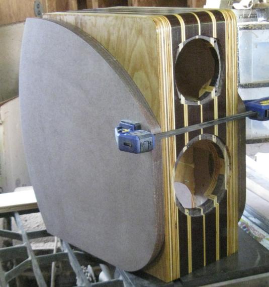

                                                    Very nice Wolf. I did some playing around with some slightly thicker HDF for a test for a stand design. Kind of a proof of concept ..... just because you can draw it doesn't always means you can make it. :W Only 4 layers and it certainly is a solid mass when your done.

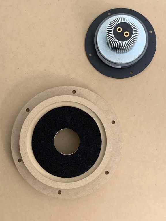

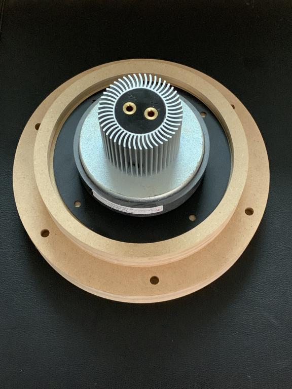

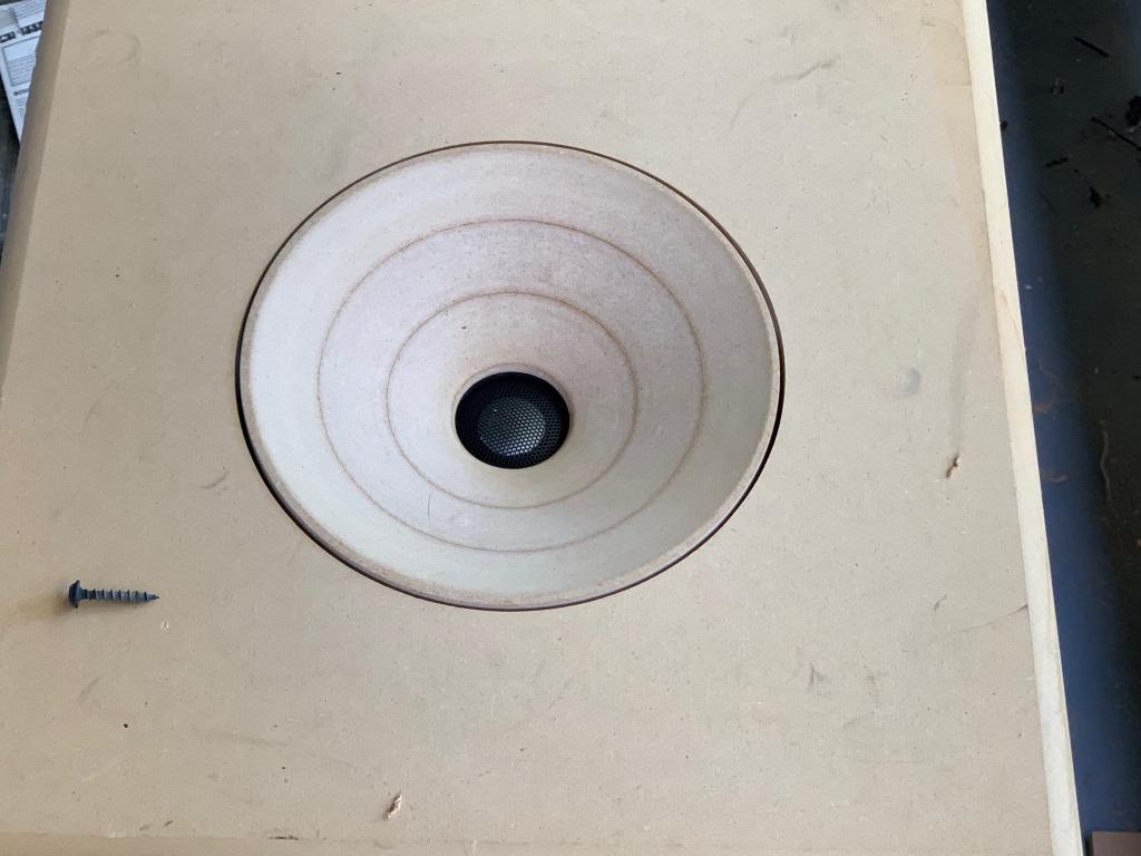

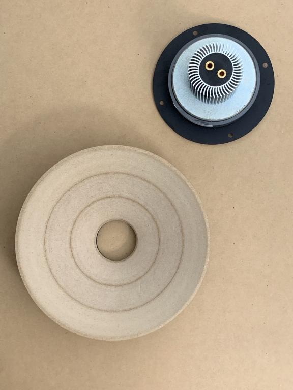

                                                      Up for testing soon...
                                                      It's near the front of the queue....
                                                      I have to finish a primary test baffle first...

                                                        I'd love to see how this compares to the SB26ADC in one of Brandon's (Augerpro) waveguides. They have similar sensitivity, but the SB26 is a 4 ohm part.

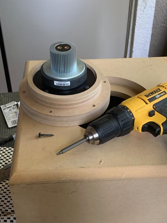

                                                          Slow work takes time...
                                                          Who would believe the fastest way to get setup for testing a waveguide is a small sub enclosure?
                                                          Binding post plate ready to mount, might be able to find time to test Thursday....

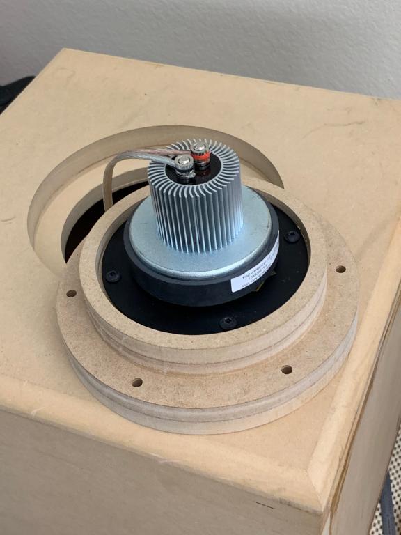

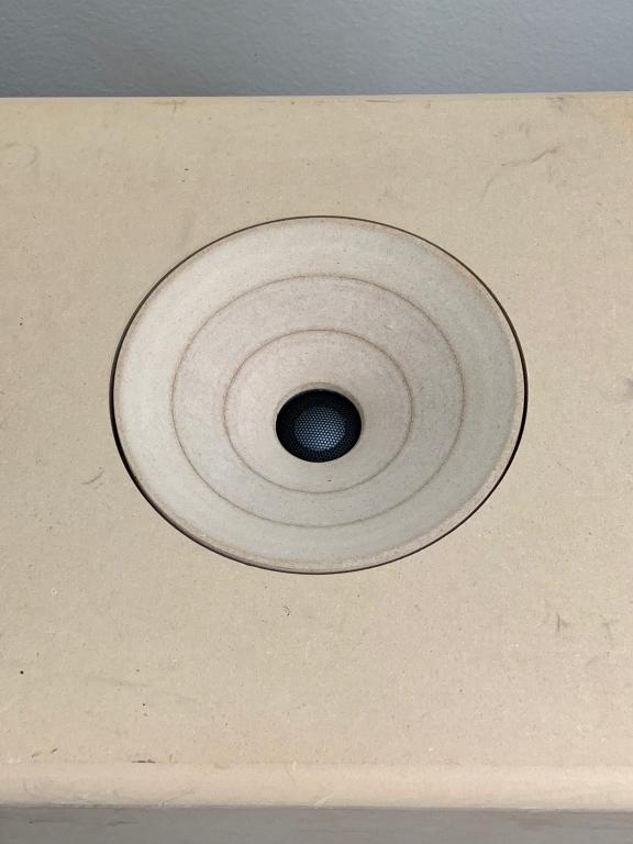

                                                            Finished putting it together for test..
                                                            A new binding post plate and some RTV to do the job... testing on Thursday.
                                                            Who ever heard of testing a tweeter waveguide in a subwoofer cabinet? Clearly a sign of desperation... non-removable back, so a few dots of RTV to hold the wave-guide in place.

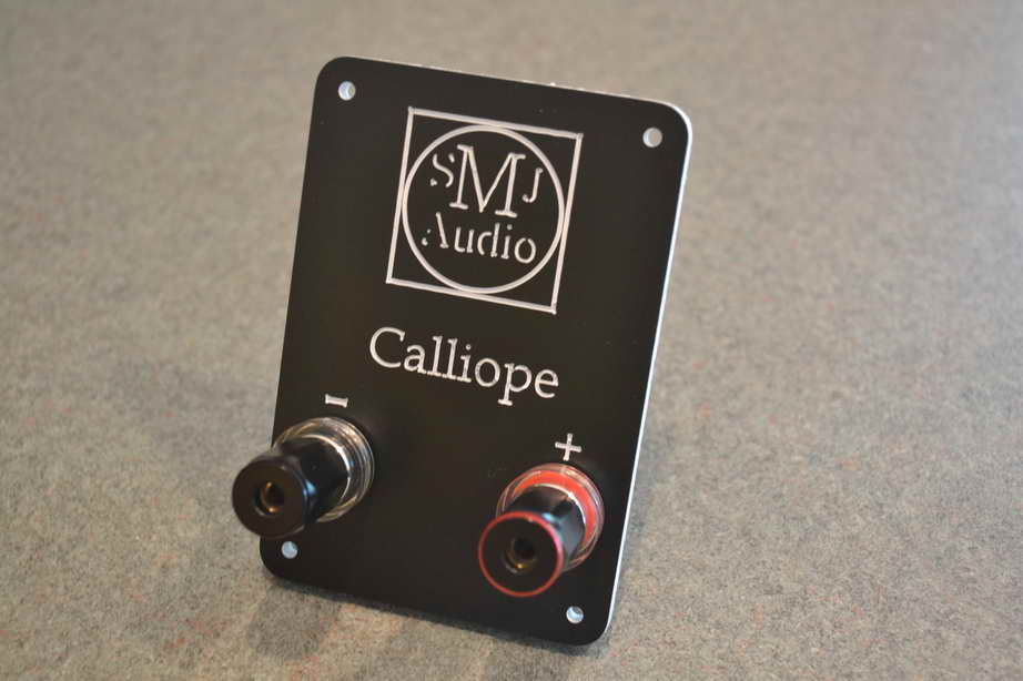

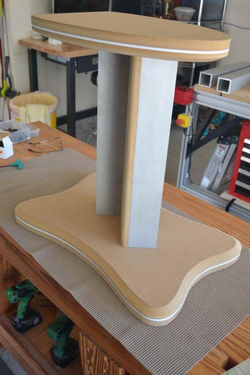

                                                              To follow up on an earlier post by Jon .... We turn some renderings into reality.

                                                              The new router bit worked out well for the chamfers.

                                                                Nice!
                                                                What do you plan on doing regarding paint?
                                                                Type, color, production metod - and will you do it or outsource it?

                                                                  Finish is going to be a waterborne tinted lacquer, comes out looking like paint, at least for mdf. If one were to go with Baltic birch or bamboo you would use a clear finish. I'm looking at a light grey for the bulk of things with black for the spacers. I'll be spraying it myself.
                                                                  Now, the intent is to sell the machined parts and let the customer do the assembly and finishing themselves. Though for those interested finishing will be available.

                                                                    Any chance for a pic from the rear? Looks like you have an area flattened out somewhat for an input plate?

                                                                      Here you go Danny
                                                                      Playing around with name/binding post plate.
                                                                      As an FYI the largest size can have a flat area large enough for a plate amp .... If one wanted to go with a powered bass section.
                                                                      Not sure what was up with my email, I've been getting stuff today.

                                                                        Looks real nice Steve. How are you making the plates? Someone local with an etching machine of some sort?

                                                                          Thanks ..... No I made the plates myself on the CNC. That was the first one, I made a few more that I tweaked a few things for better results.
                                                                          There are inserts all over the place in these ..... I should own stock in EZ Lock.

                                                                                  I'm still putting together some basic test cabs- have a new batch of crossover parts that should arrive today- 2nd pass on the crossover, with higher precision time offset data, and some tweaks to the design concept. Should be looking good- we'll find out. And testing two driver layouts. There's some other "different" things going on in these test cabinets we'll tell you about later if they work out.
                                                                                  Ugly at this stage, but they will be sanded and painted when finished, (probably!) nice enough for workshop speakers.

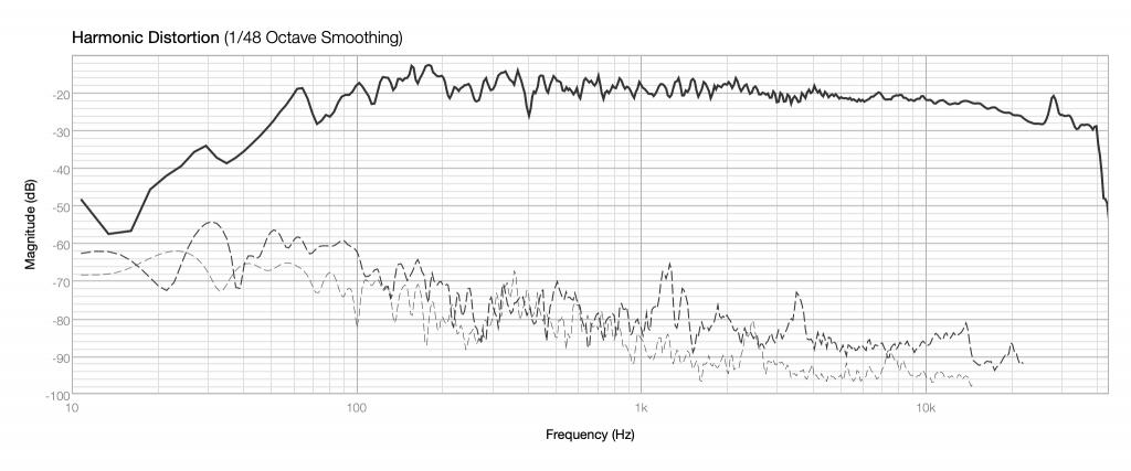

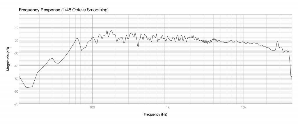

                                                                                      For this current effort, I've got a test article that can use one switch and go back and forth between "flat" and "Voiced". Those will get sent back to Steve once I have a stereo pair built and tested.
                                                                                      Flat
                                                                                      Click image for larger version  Name:	Capture V2XOVER Flat.jpg Views:	1 Size:	62.1 KB ID:	864434
                                                                                      Voiced
                                                                                      Click image for larger version  Name:	Capture V2XOVER Voiced.jpg Views:	1 Size:	60.9 KB ID:	864435
                                                                                      My preference would be just to go with the voiced mode, I think, but Steve owns this, and he's the one to make the call on what his preference is.
