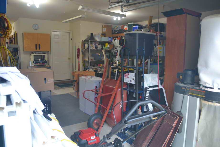

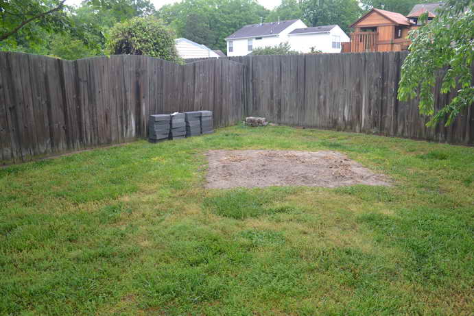

                So, what has transpired to this point in getting that process moving …... Once the decision to do this was out of the way, I did an evaluation of my shop and how well that functioned. Even though I already had a decent setup for tools it was certainly not very efficient. With having to share space in my garage with bikes, painting supplies, coolers, pet supplies and all the other things that make one’s life go, I was restricted to having tools on wheels. Also, the basic mode of operation was set up a tool, use it, move it, set up the tool for the next operation, etc.

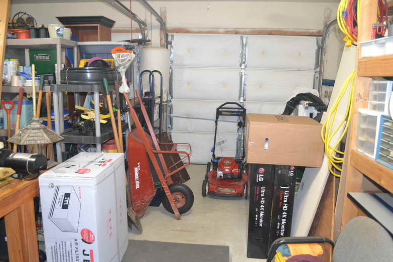

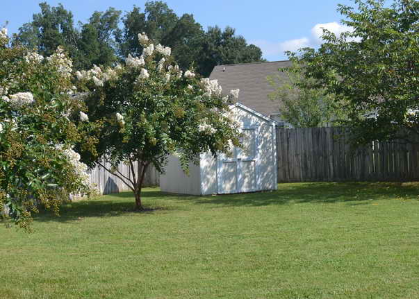

                Looking at a few options and working with a limited budget, a new 2000 sq. ft was not in the cards, bummer. :cry: Though it was clear I needed to get “stuff” out of the garage. I opted on getting a larger shed in the backyard to help with the situation.
                This was our existing shed, 8' X 8' which already had a fair amount of "stuff" in it already.

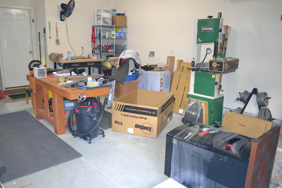

                Before anything could be done with the shed it had to be emptied. Which pretty much halted all woodworking in the garage.

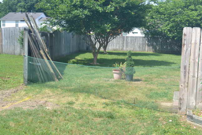

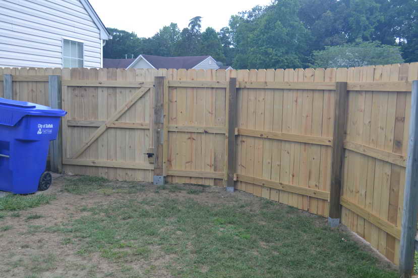

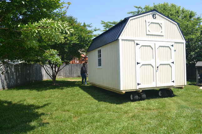

                A rather large hole had to be made in our fence to make room for the new shed to be delivered. No I did not build a new one myself.
                  • 2142
                  So this the reason for the hole in the fence .....

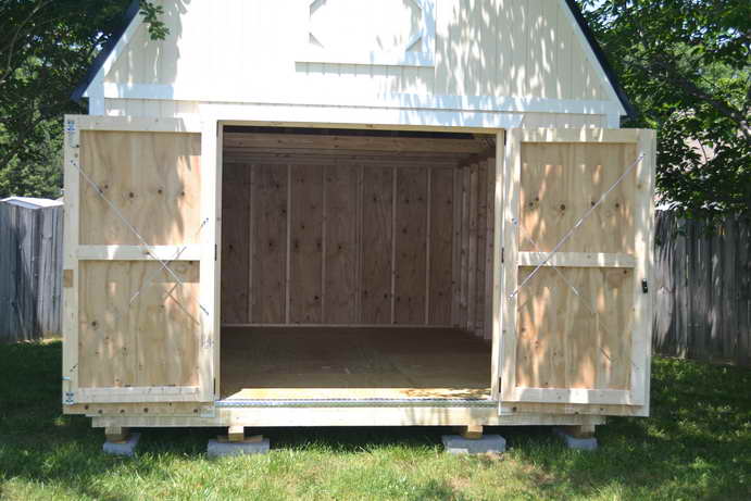

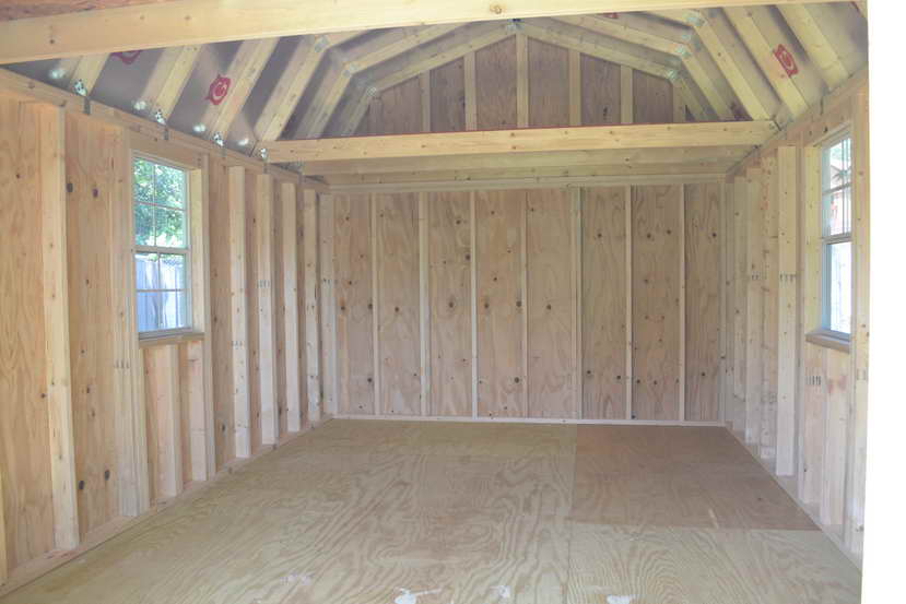

                  The new shed is 12' X 16' with loft areas and gives us a ton of extra space for that "stuff".
                  Of course the hole in the fence had to be closed.

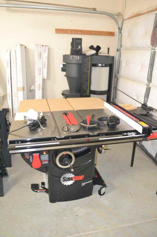

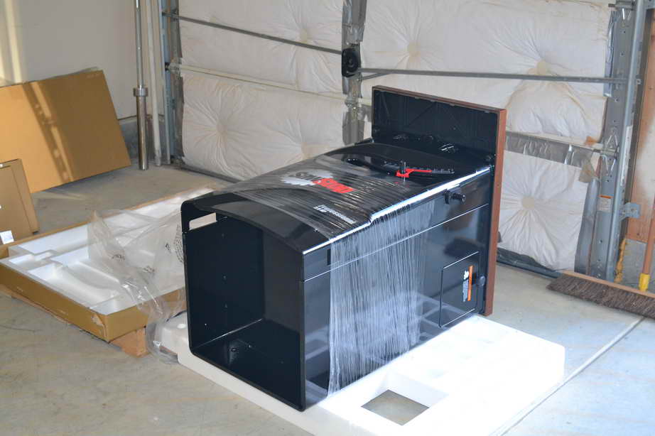

                          Well after much moving of stuff, I now had some room to start the rework and upgrade process in the garage.
                          With some of the new design concepts we had been discussing it made sense to do an upgrade on my table saw to something with a little more oomph. This is what I decided on after much research.
                          With help from my neighbor and a whole lot of grunting, we were able to get it out of the car so I could start assembly.

                          Saw finished ...... I was also able, with a few tweaks, to use my existing out feed table.

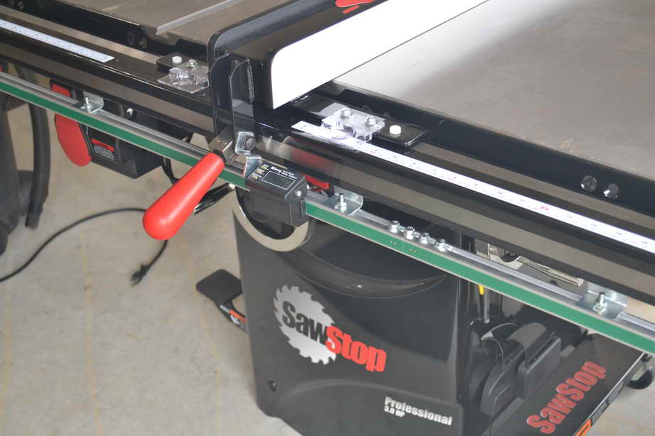

                          One addition I had been wanting to do with my old saw was to add a digital readout on the saw fence. Makes life a lot easier for repeating cuts.

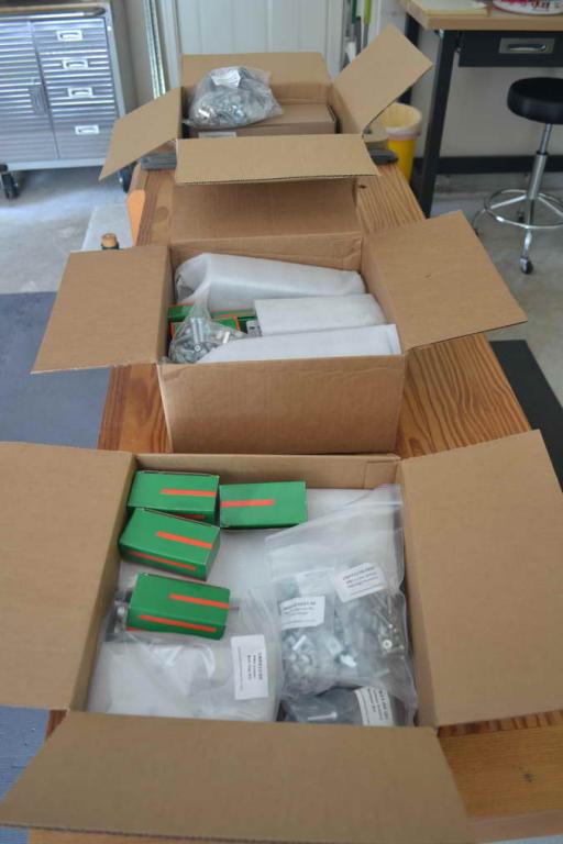

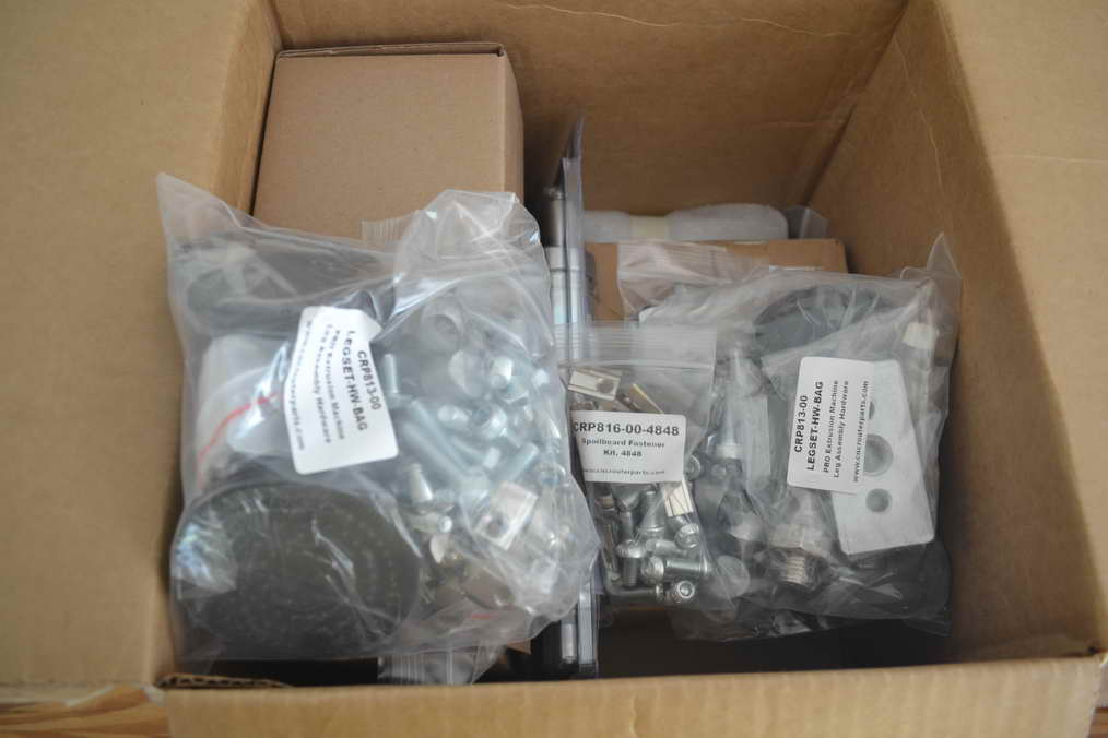

                                About the time I was finishing putting the new saw together, the really big upgrade showed up. This has been something I have been wanting to get for a while now ....... any guesses?
                                The UPS guy got a work out bringing in box after box of parts.
                                And like one of those nesting dolls, opening the big boxes lead to even more boxes.

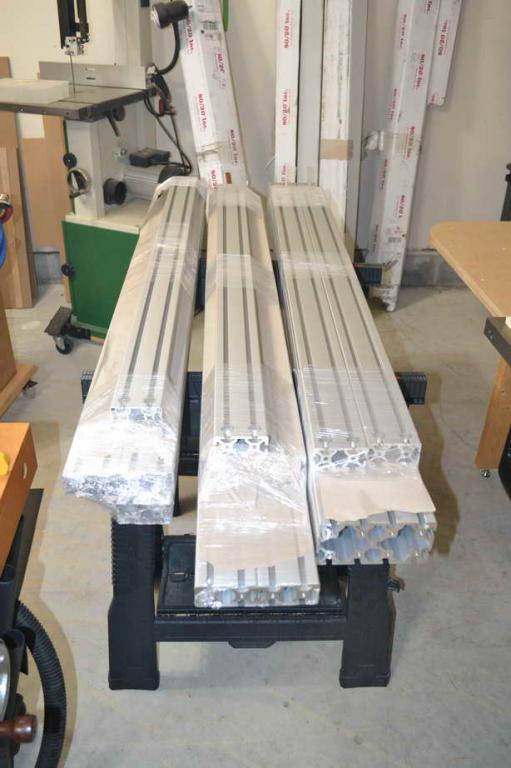

                                And then there was a whole bunch of aluminum delivered.
                                This project certainly falls under the category of "some assembly required"

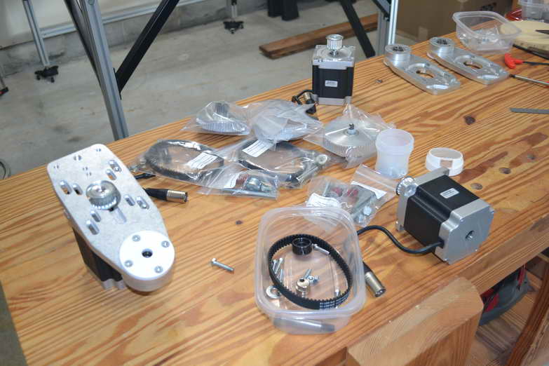

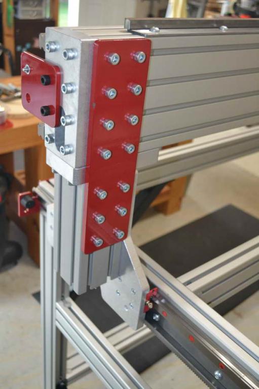

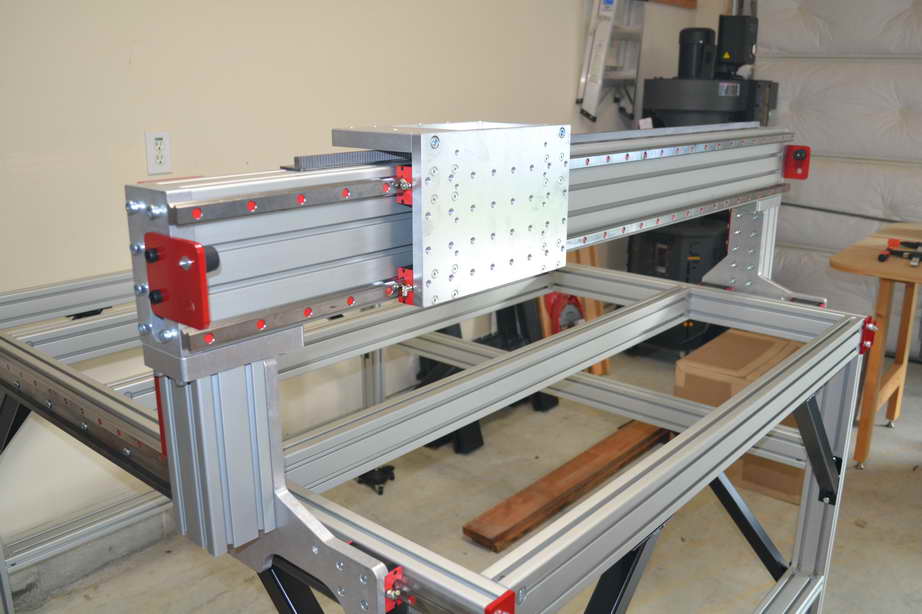

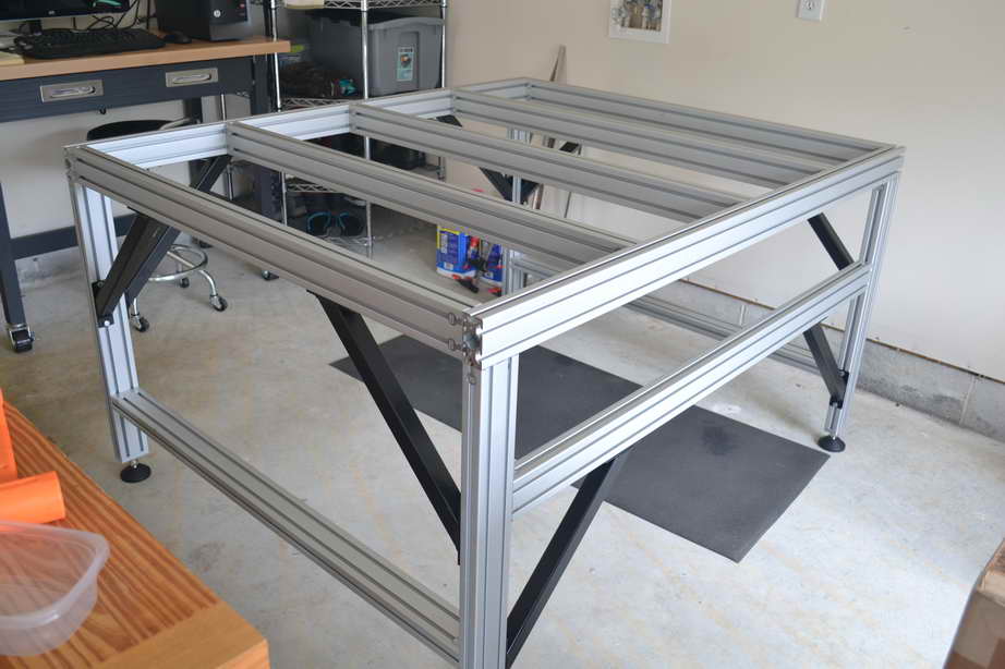

                                            The process of putting this beastie together got underway. I have no idea how bolts I installed to put this thing together.
                                            Once all the frame work was done, it was on to the drive system and all the wiring.

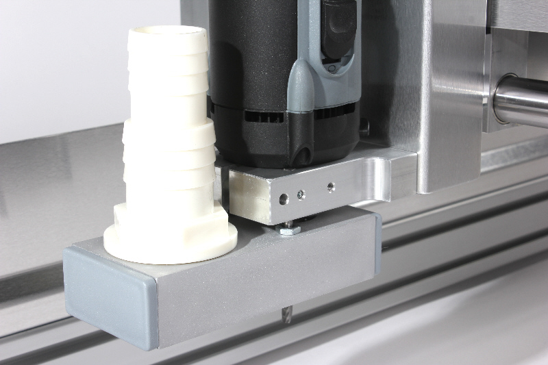

                                              Have fun with the assembly - though it'll take time I'm sure. Even the 3D printer as a kit from Prusa took some 8h to assemble, so this will surely take you several days. It's also good to take it slow as missing something critical at right time can multiply the time in end.
                                              4' X 4' is a good size already. Mine is 39in x 23.5in (100cm*60cm) - thats a bit too short for milling out a full floor-standing speaker front or side. But mostly I'd do the speaker holes on CNC and rest with track saw / table saw, so it's workable too. I have a space constraint as well. The CNC is in basement that is warm. Garage is bigger but not heated over winter and I would not want to keep it there.

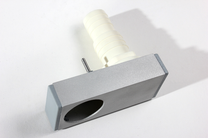

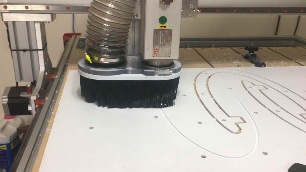

                                              I've not found a good dust boot commercially for my machine. The one from the manufacturer is crappy for the 89EUR asked for it.
ID:	864250Click image for larger version

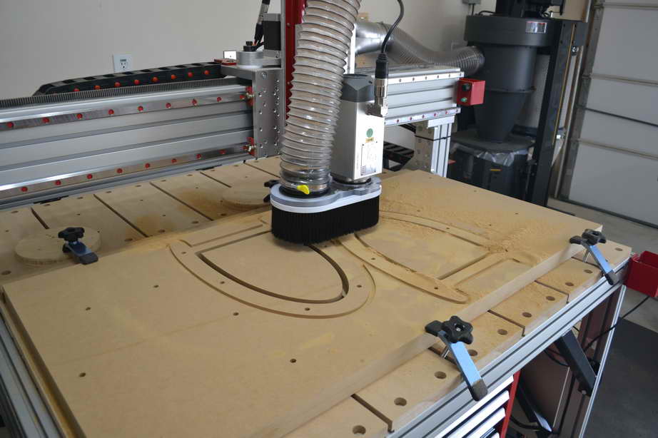

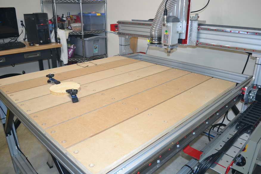

                                                    Yeah, with that being the cutting envelope I think I'll be good to go for most stuff. If I do need to go bigger I laid out a grid pattern for alignment dowels where I can do a larger cut in two stages.

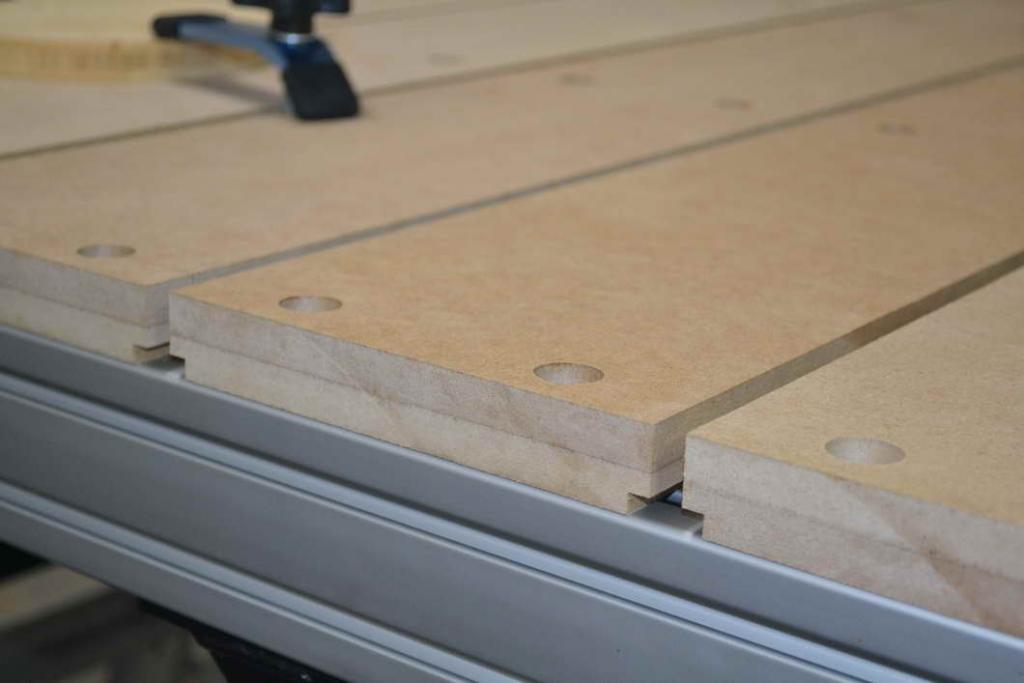

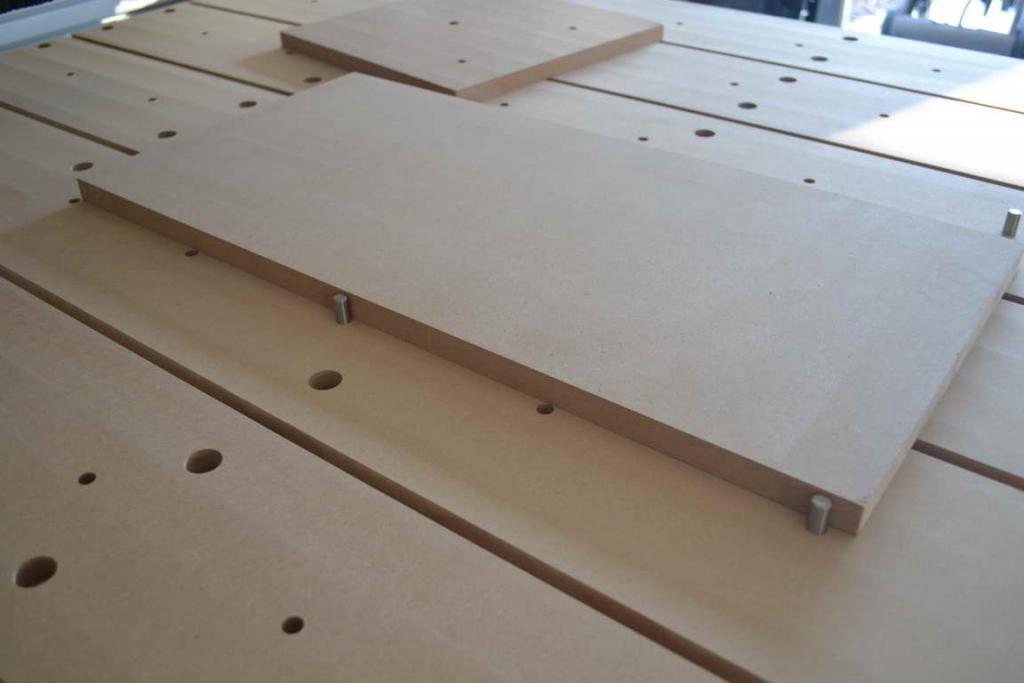

                                                    Your on your own as far as a work surface, so this is what I came up with.
                                                    I made built in T-Slots for fixturing.
                                                    This is some of the align holes that I drilled. Their spaced every 6" across the entire table.

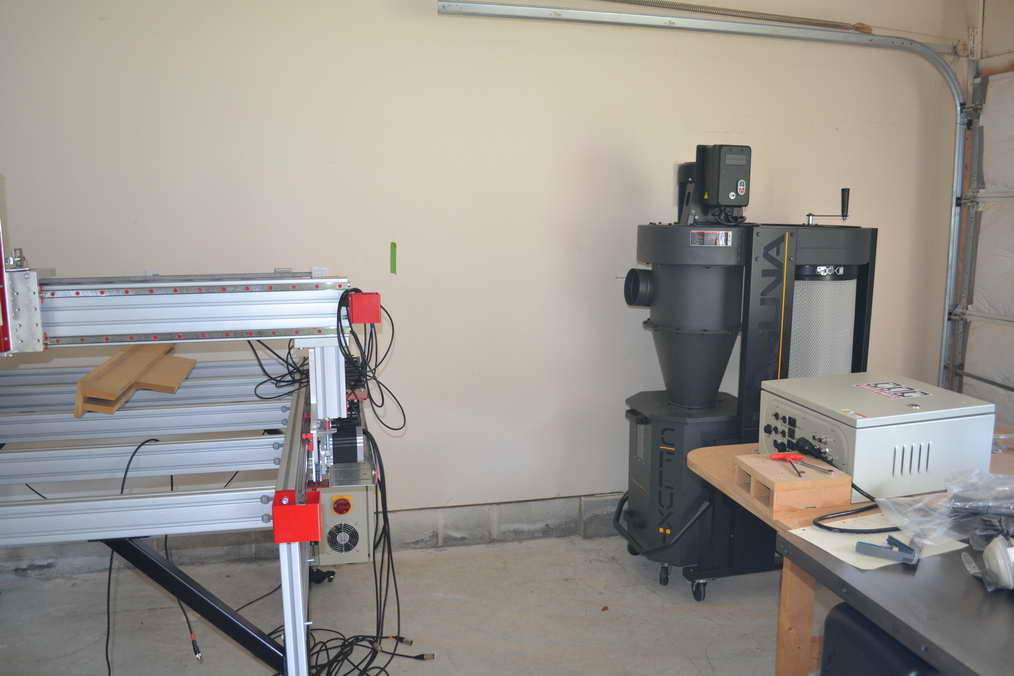

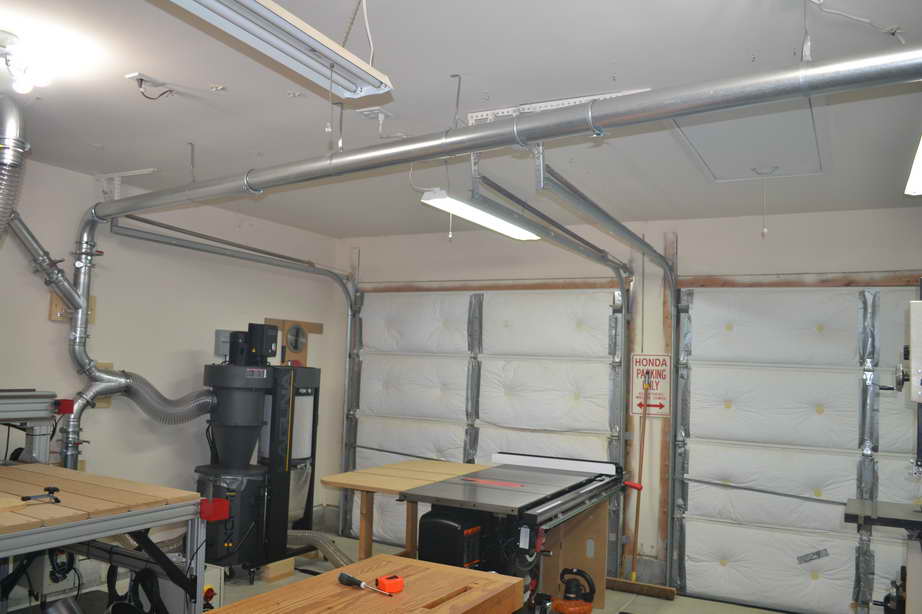

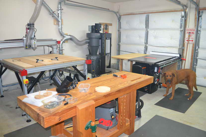

                                                      To follow on with the dust collection topic ..... now that I can leave the major tools in one spot I did a major upgrade in that area as well.
                                                      I went with a larger dust collector than I had originally.

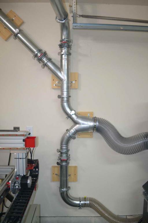

                                                      I also went with fixed ducting for the saw and CNC.
                                                      I did run a line over to the other side of the shop to take care of the bandsaw, jointer, planer, etc. Still not enough room to have everything in a dedicated spot. Each of the runs has a blast gate so I can direct suction to where I need it.

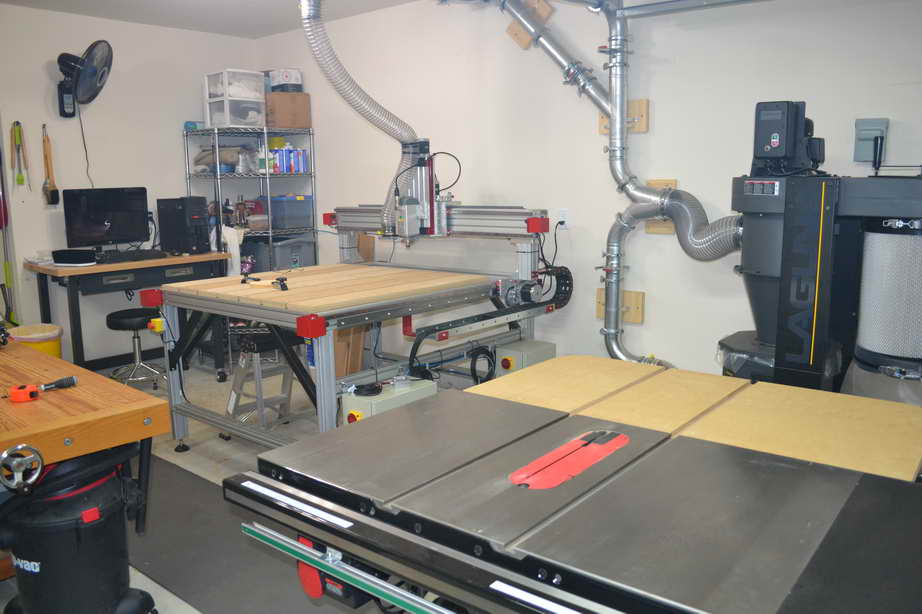

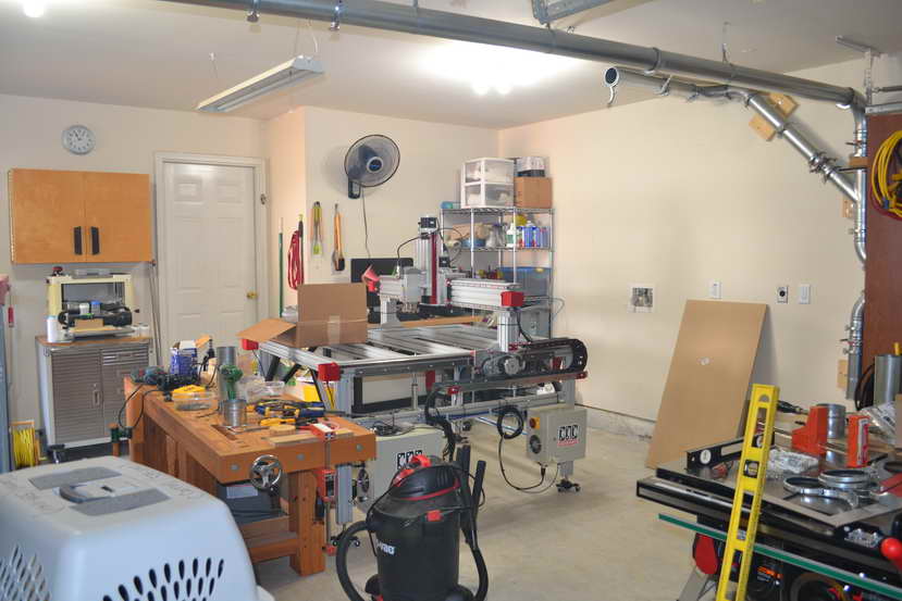

                                                      A couple of shots with things more or less buttoned up.
                                                        • 698
                                                        Some very good ideas for the CNC spoil board Steve! Top one of mine is running thin soon and I see myself replicating these ideas
                                                        The dust collector system looks great too and with long spans with metal pipes should be good as you can ground those for safety against chips creating too much static electricity to be dangerous.
                                                          • 2142
                                                          Thanks Ergo
                                                            [ATTACH=CONFIG]29301[/ATTACH]
                                                            [ATTACH=CONFIG]29303[/ATTACH]
                                                            [ATTACH=CONFIG]29302[/ATTACH]
                                                            [ATTACH=CONFIG]29306[/ATTACH]

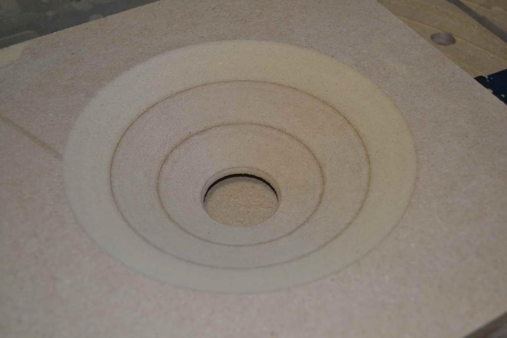

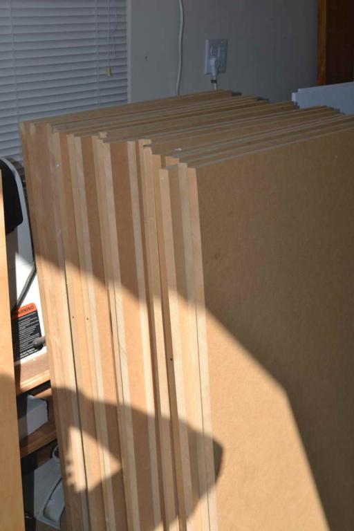

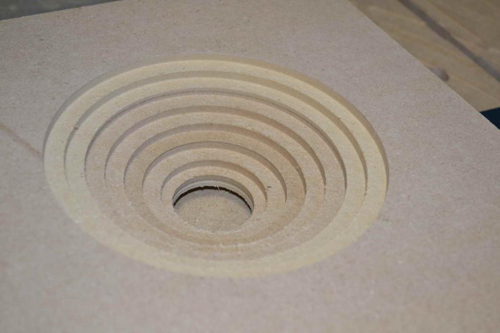

                                                                  Well if I'm going to be accused of it I might as well do it right ...... here's a few teaser pics of things we're working on.
                                                                  Picked up some cabinet grade mdf to play with and figure out how to program and run the CNC.
                                                                  Mdf was glued up into 2' X 4" X 1.5" thick slabs for machining.

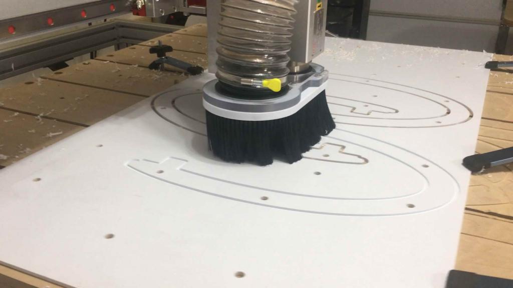

                                                                  Also did some cutting on high impact styrene.

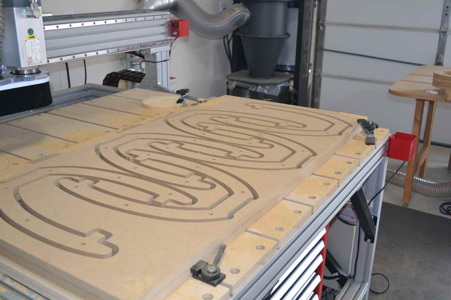

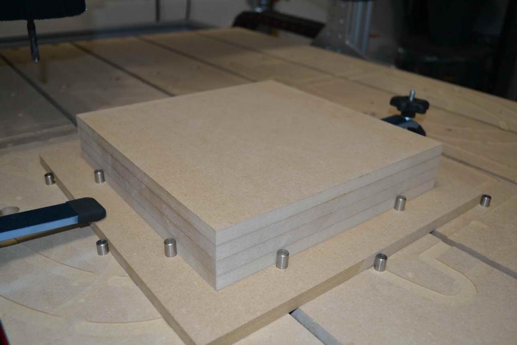

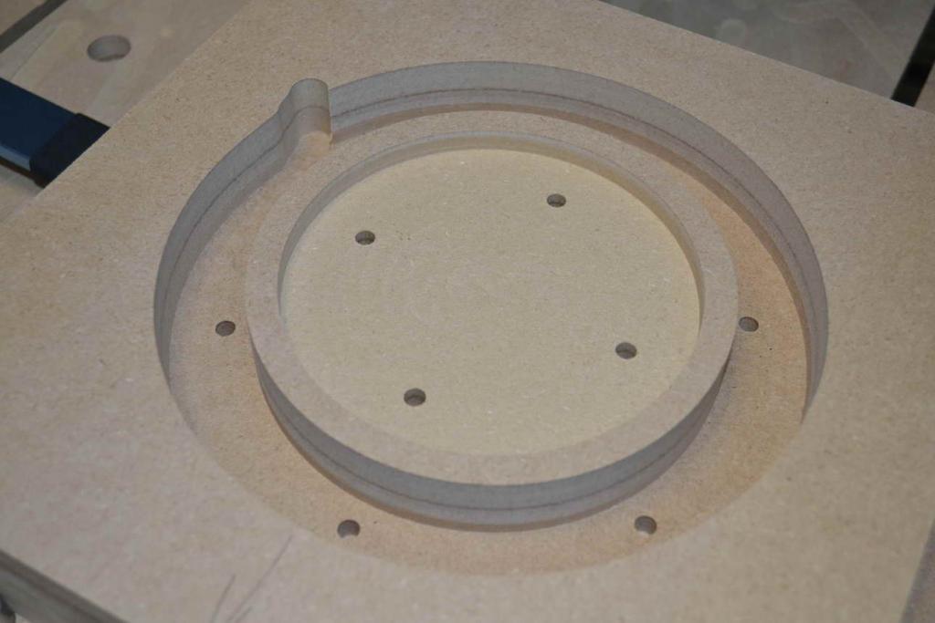

                                                                    A few more ......
                                                                    The first set of cuts were more of what they consider 2.5D type machining, mostly done in 2 planes. This was a test at true 3D profiling cutting in all 3 axis at the same time. Very cool to watch.
                                                                    This was also a test of double sided cutting using the dowel system mentioned earlier.
                                                                    This is the backside of the part.
                                                                    Part was then flipped and machining continued.

                                                                      One might wonder what that WG test is for, but let's just say at this point, we're in the process of testing out a number of ideas. More to come very soon.
