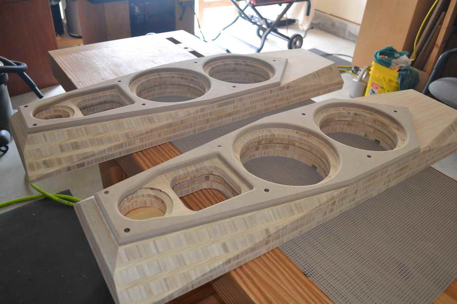

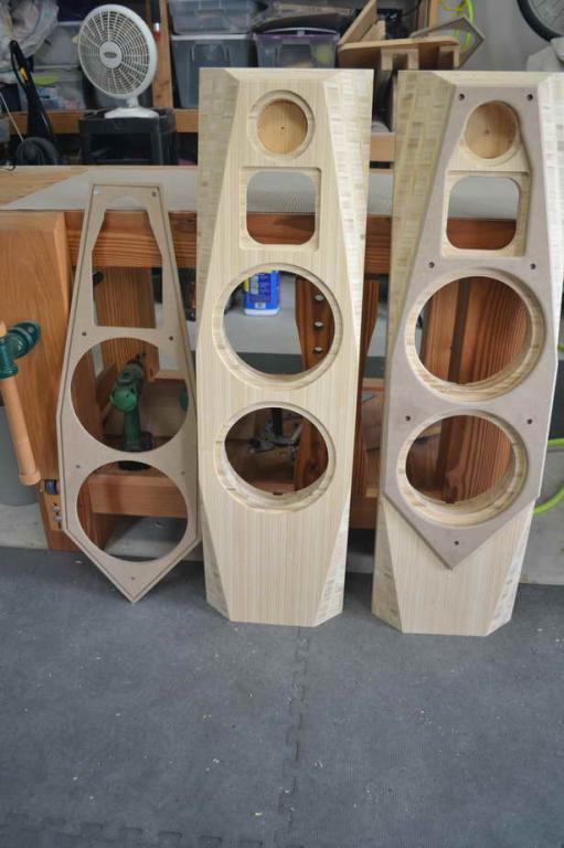

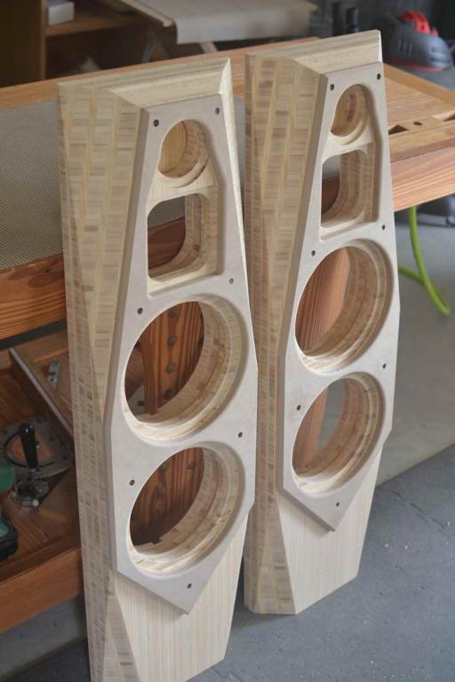

    By the way, here's a few pictures of the second set of Ardent baffles that I did. These will have grills (dog slobber protectors, is my understanding). The grills are attached with hidden magnets.

      This is really awesome!!
      I recently bought a knock-down kit from Parts Express for a sub. It was part of a deal, and at the end of the day, I wanted to try a kit to see what that was about.
      I was very impressed with how it all went together, and I'm sure that yours will have the same attention to detail. It may have actually spoiled me from making boxes in the future!!
        Hey, those look familiar! Once you have a Newfie you kind of start expecting the drool to end up everywhere - including the ceiling. Considering making some large vinyl covers to put over these once complete...just in case.

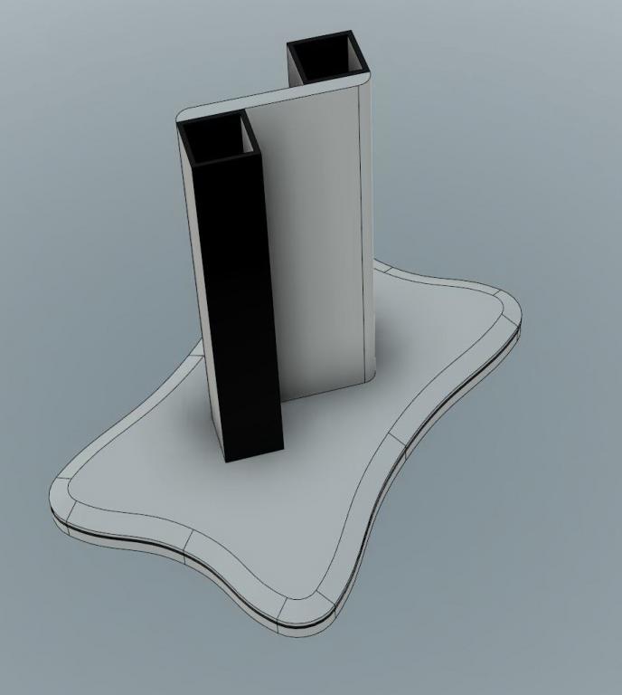

            So, a little more info on this MT design we have been talking about. Well Jon sends me a link asking me what I thought about a speaker that he and a friend had auditioned on a trip to Germany a few years ago. Though they thought the cabinets were great, the sound was lacking, especially for the $264K asking price. Of course, there was the wouldn’t it be great to make our own conversation but make it sound better. Of course, that’s when the mayhem began. Doing a little digging into the company we found that they make a full range of this style speaker.

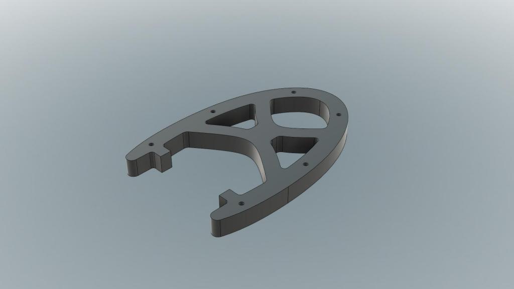

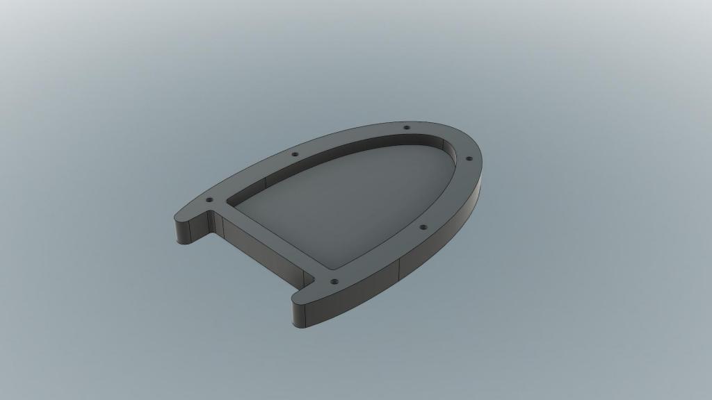

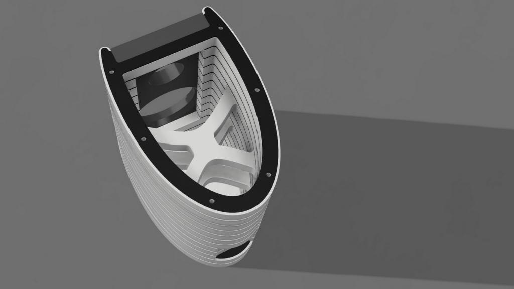

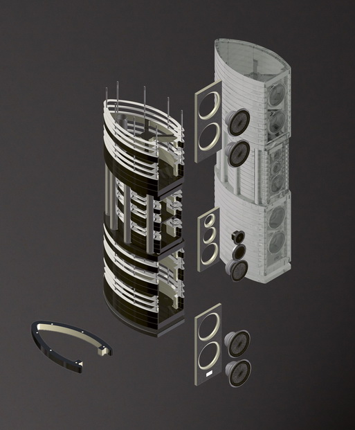

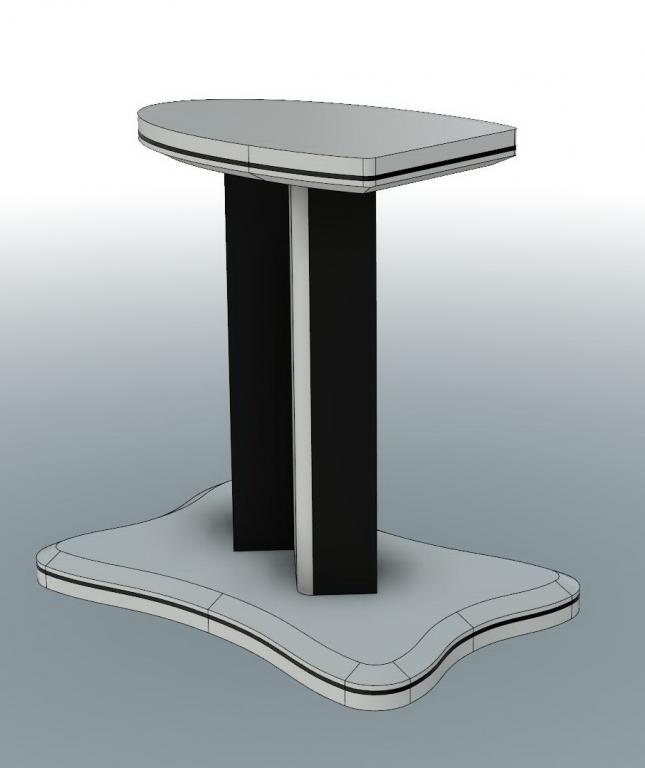

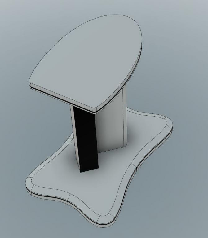

                                  To continue from earlier, what we liked was the modular approach of the cabinets, which inspired us to look at making a possible series of speakers in different sizes, as well as modules that could be combined to improve the performance of a system over time. It also appealed to me since I’m a bit of a fan of translam designs as well as curved sides. With regard to the translam idea, this derivation of it, eliminates some of the inherent problems of that type of construction while adding some advantages.
                                  So, with considerable time spent working on drawings and researching fabrications options, we have come up with what we feel is a unique option for you DIY enthusiasts for making cabinets.
                                  To break the renderings down a little, a group of standard parts was developed to pick and choose from to make a cabinet of your desired volume and features.
                                  This design also gives a unique option in that if at some point you want to turn your MT into an MTM you don't have to build/buy an entirely new cabinet. You just buy the additional parts to increase the volume and away you go.

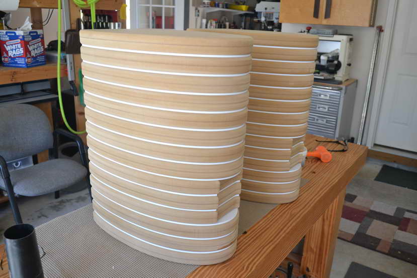

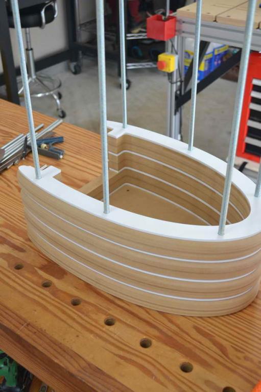

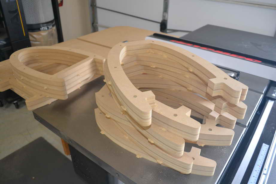

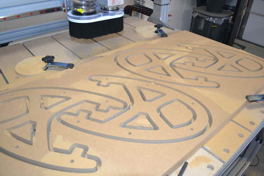

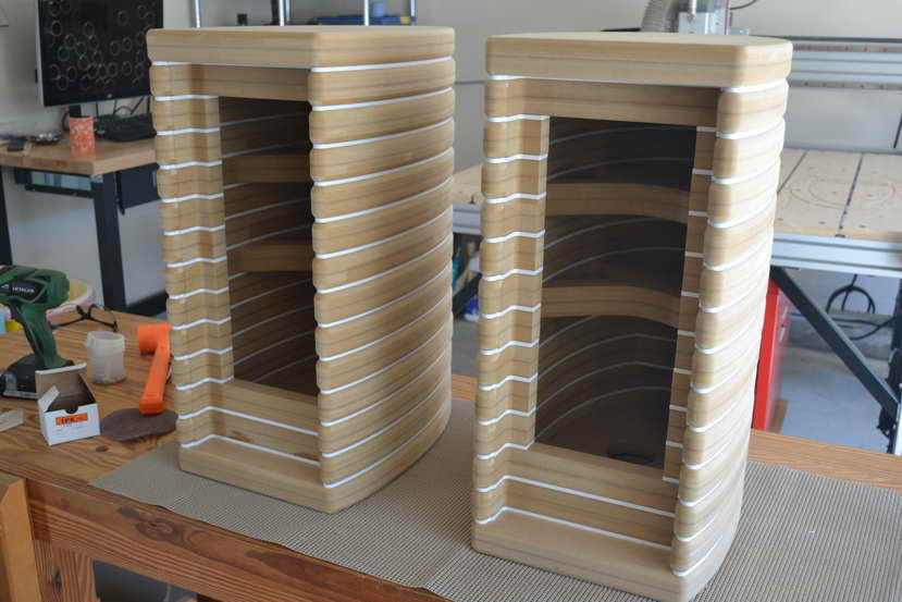

                                    Just to show this has progressed well beyond the pretty picture stage ...... Parts have been machined to make a full pair of speakers.

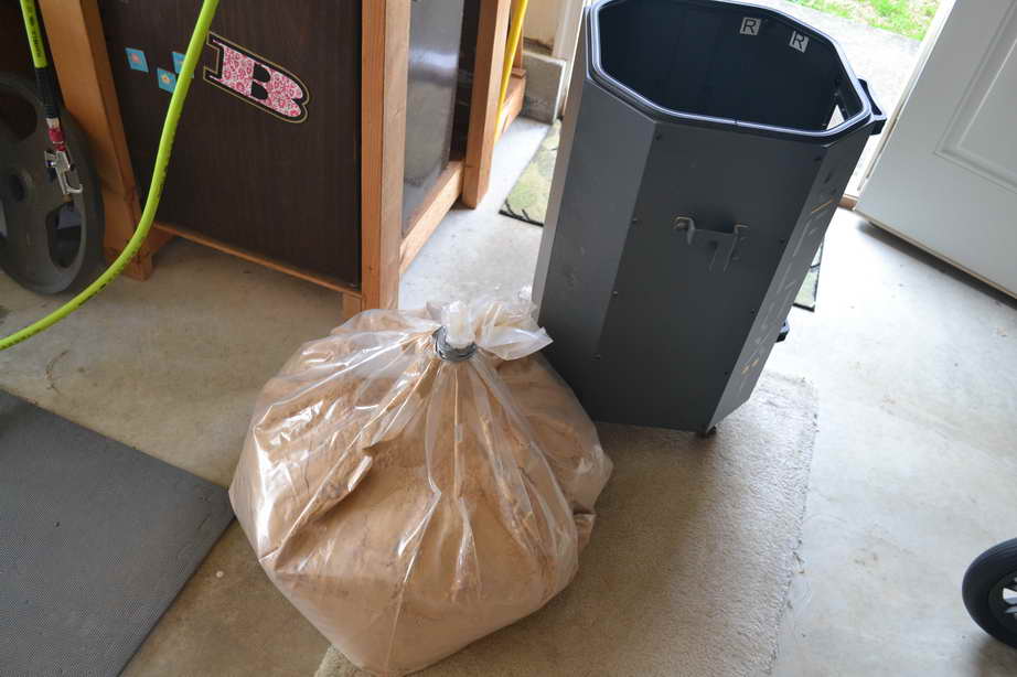

                                    By the way this CNC with a 1/2" diameter bit can churn out a boat load of dust. As I recall that's a 30 gallon bin for the dust collector.
                                    Checking fit up.
                                      • 2140

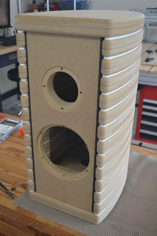

                                      A few more ..... This is a 1 cu ft cabinet, net volume. There will be a 7.5" woofer and tweeter for the music part.
                                      This is what we are calling our small size cabinet, where a 7.5" driver is the largest it will handle. The mama bear size will handle up to ~10" and the large up to ~13" drivers.
                                      Again, you can make the volume what ever size you need to match design requirements.
                                      • cochinada
                                        • May 2014
                                        • 661
                                        Very nice! :T
                                        I have a question though: I see you are using rods to assemble the cabinet. Aren't you afraid this might prevent or constrain the layers from moving or are you confident the plastic will eliminate all potential problems?
                                        There is a thread in another forum of a guy that built a huge translam array where he used rods but didn't have plastic in between. I'm sure you saw it as he's a perfectionist like you. He faced the same issues most of all had and I remember there was an endless debate about it. I think he's also in this forum but I don't have the link at hand.
                                        Joaquim
                                        DIY 4 way speakers.
                                        DIY subwoofers.
                                        Zaph ZD3C.
                                          • 2140
                                          Very nice! :T
                                          Thanks ..... I want to say that I did see it and a I recall the rods just aligned things but he ended up still "hard" mounting/gluing things ..... I could be wrong on that. Nothing here is hard mounted, including the baffles. They are bolted in place with a gasket between it and the cabinets. There is also a non permanent rubber coating on each side of the spacers for sealing, so I don't expect to see any issues with materials splitting like most of us have had in the past.

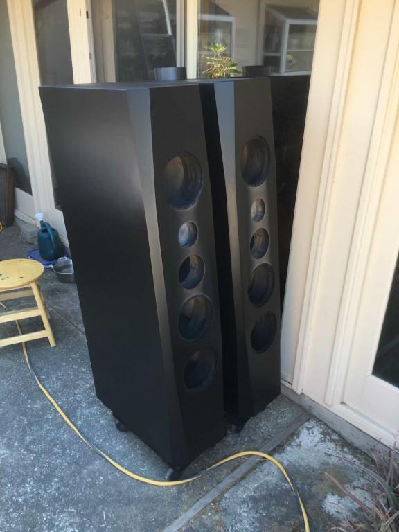

                                            Now, I may be one of the poster children around here for heavy and expensive... guilty as charged. Most of you guys won't remember my X1 SLAMM Klones... but many of you will remember these, prior to final coats and polishing, made completely of 1-1.25" maple ply normal used for piano pin block construction- stuff that makes BB ply look like laminated balsa wood.
                                            These are parked in climate controlled storage in Idaho, and will start getting some attention again in 2021.

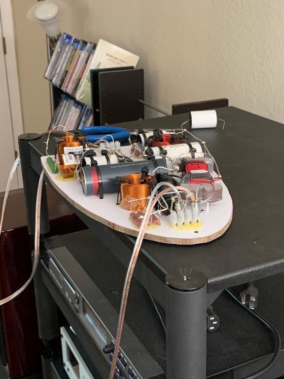

                                            And as I mentioned somewhere a while ago, a first test crossover is going together... but I have to admit the shape of the crossover board is a bit more of a challenge!

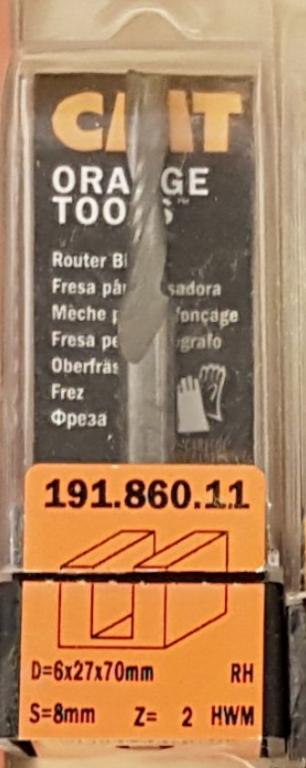

                                              Milling processes can create a lot of dust. I'm wondering though why you use 1/2" diameter bit. Does it allow faster speed? It should not be cheaper... My main driver for that type of work is a CMT 6mm bit which is close to 1/4'', so would make 2x less dust
                                              Anyhow, I'll be asking you after you've run a punch of these on what are the good bits and also feeds and speeds. Improving the know how on that front can always help.
                                                  [ATTACH=CONFIG]29362[/ATTACH]

                                                  The main reason for going with the 1/2" bit is cutting length. The "ribs" that make up the cabinet are 1.5" thick, that pretty much rules out 1/4" bits right off the bat and even 3/8" if you want to make sure you have enough clearance to the bottom of the spindle. Since I'm very much in the learning mode with the CNC I'm being conservative. At present I'm doing a .55" depth of cut at a feed rate of 225 IPM. The machine will do over 400 IPM but for now that's where I'm at.

                                                    Sweet shop. Nordfab ducting? I'm jelly.
                                                    I'm not a woodworking expert, but I think plywood laminations are risky for big projects. Doesn't wood move mainly perpendicular to the grain? If so, it moves mainly in width and thickness, and usually thickness is a small enough dimension that it can be ignored. However, build up enough thickness and movement becomes non-trivial. At least from a woodworking standpoint, I like the MDF idea better
                                                      • 2140
                                                      Thanks Browncoat ..... yeah, it was a little more of a splurge for the Nordfab, but the flexibility of the system and time saved was worth it.
                                                      As far as things go I'm certainly not an expert either. As far as movement a lot depends on how the log/wood is cut, as well as the humidity in your home over the year and all that fun stuff, so if your weather is all over the place, like where I live, it can be an issue.
                                                      Typically it will move with the grain, which is across the width of a board. Now if you can get a board that has been quartersawn it's very stable across the board because the grain lines run into the board. Plywoods are pretty stable across the sheet but they will expand across the thickness as a number of us have found out with Baltic birch. If you constrain it by doing something like gluing a baffle in place you can have a real issue.
                                                      All of this has led us to going with the design we have been talking about and not gluing up all of those layers in the first place.

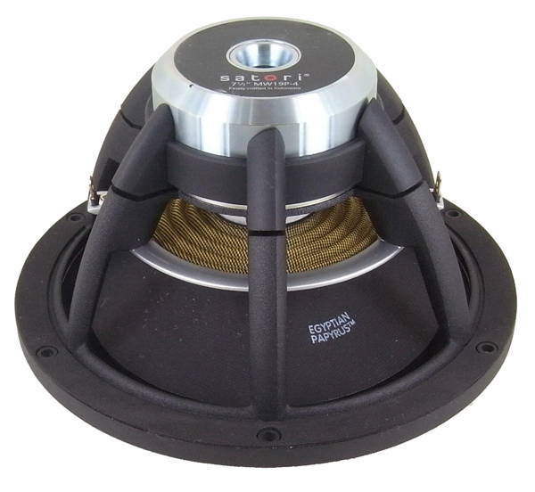

                                                        And just to take a bit of the suspense out of this Sunday tease fest on my part, this is the Satori woofer for this system, arrived at after testing quite a few drivers:

                                                          Last week was one of those weeks that felt like trying to wade quickly through cold molasses... and then you step into an unexpected sinkhole!
                                                          The sink hole was my 15 year old ACO Pacific mic and preamp developing an output offset and noise, couple with a LF roll off- out of action. I contacted the vendor/Mfr. here in the Bay Area, and got a new one on order... which did arrive today. But that has set some things definitely behind schedule... I'd figured to maybe have a little spare time for this on the Memorial Day weekend, and that didn't work out either.
                                                          So, just be advised, I think there might be a chance Steve will just convert this to a speaker stand making outfit, based on the latest renders he sent to me... do you think this is a hint?
                                                          I tried to explain things to Steve today... not sure it went all that well...
                                                          But Steve's stand renders look pretty righteous to me...
Name:	Aluminum Stand Color 2.jpg
Name:	Aluminum Stand Color 3.jpg
Name:	Aluminum Stand Color 4.jpg

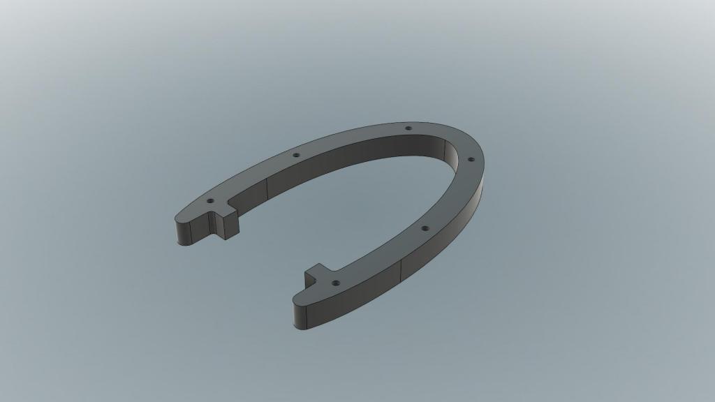

                                                          And what Steve can render, Steve can build... this we know.
                                                            • 698
                                                            A nice looking and technically very nicely though out stand. I assume the spacer lines are the same plastic material as the main speakers?
                                                            Making that very shallow chamfer is something that makes me scratch the head. With hand-held router It would be hard to find a bit like that. Table saw is also out as the shape is not straight lines.... so I'll be following with interest on what magic makes those happen
                                                              • 2140
                                                              Thanks Ergo .... yep, same material for consistency.
                                                              Your right about the shallow chamfer being a bit of a pain. The way I see it, is I have two options if I want that look. Do it on the CNC and a first stab at programming the profile, it looks to be ~20 minutes machine time for each piece. The other is buy one of these, https://www.toolstoday.com/v-5840-49416.html and be done with it. It's certainly not the cheapest bit, but time wise it could be the way to go.

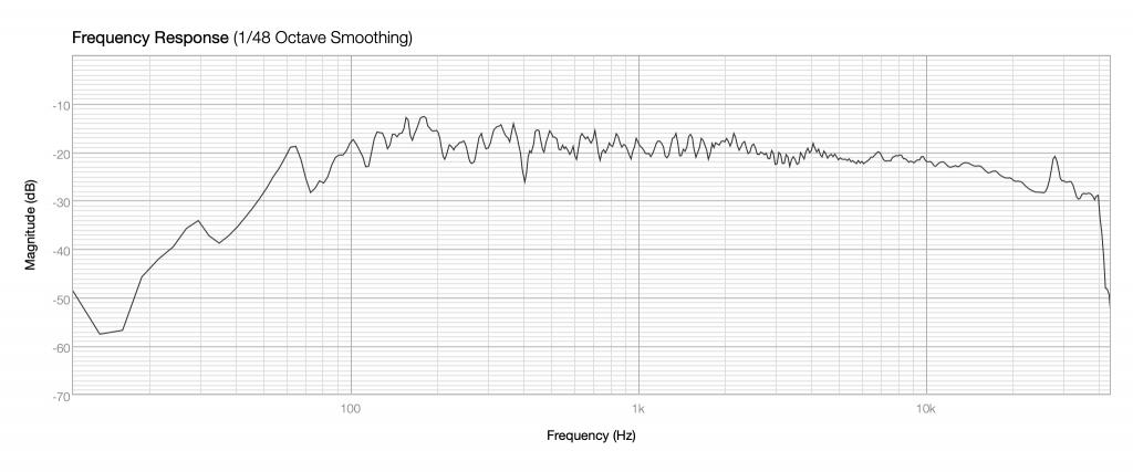

                                                                                • 16166
                                                                                Well, all this router bit business is very interesting, I suppose, but I have my 60 degree bits for some time... and besides, I'm more the wires and sparks kind of guy, though I can avoid hurting myself around a big table saw or 3-1/2 HP router...
                                                                                Speaking of wires and sparks... in the end, it's all about the SPL's...

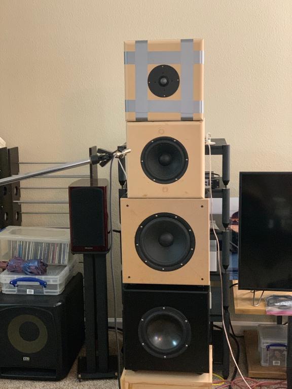

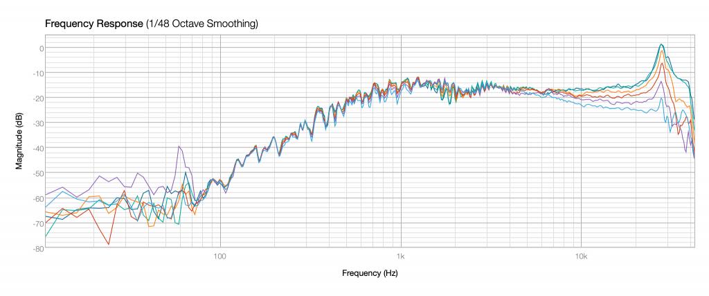

                                                                                So, having measured drivers in some test cabinets that have the right overall baffle width, and having built a test crossover to evaluate whether the demo concept will work, well, of course the next step is to test the crossover with the drivers in their somewhat non-optimum but quickly built cabinets...
                                                                                By non-optimum cabinets, I mean some Denovo knock down kits that you can throw together with nothing more elaborate than a few clamps and some glue or epoxy...
                                                                                If dress for success applies DIY, no one is going to be impressed....
                                                                                Only the top two cabinets are involved - the others are just a "stand" for setting up the test. Also, the MW19P Satori is just sealed; we have a sort of trick ported arrangement to try out, but haven't gotten farther than just modeling it.

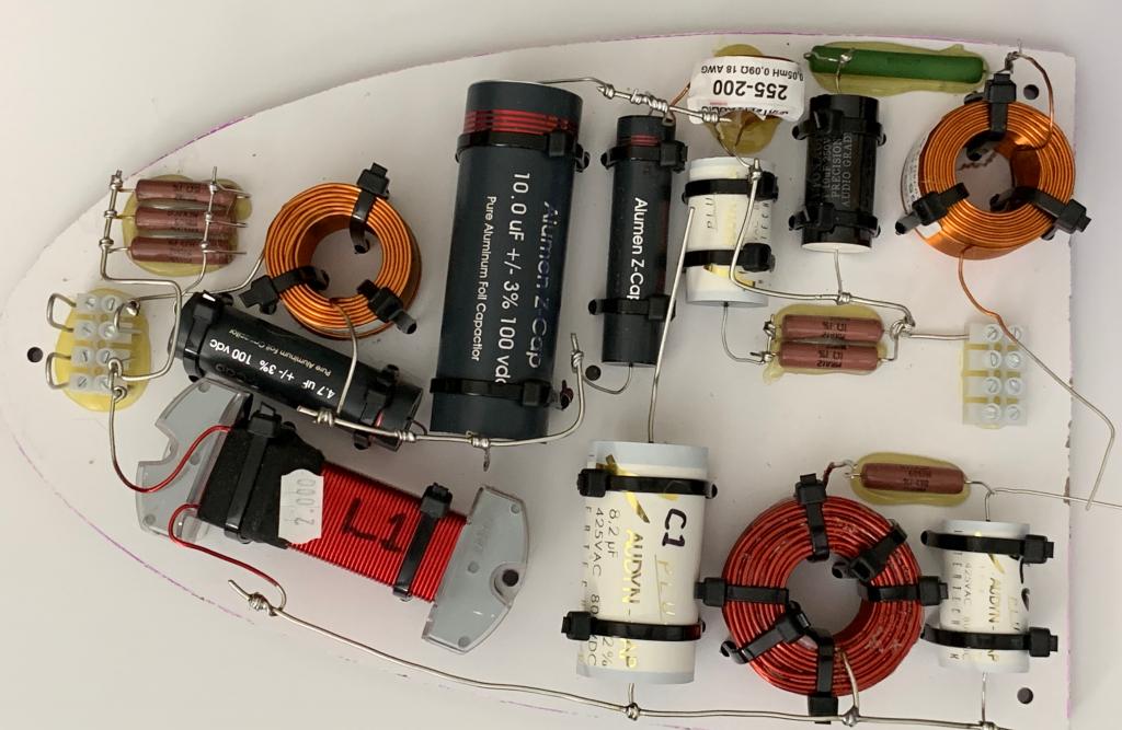

                                                                                Here we have the crossover, built to the target form factor to see how comfortable it might be- lots of room on the board, actually. It's a mix of what I would call "upper mid Fi components" along with some better than average tweeter caps (Jantzen Lumen capacitors- pretty transparent sounding but without any glare or etch to speak of).
                                                                                With the drivers spread so far apart in this test setup vertically it's a relatively narrow window in the crossover transition region, but it wasn't hard to find... in fact, pretty much exactly where it ought to be!

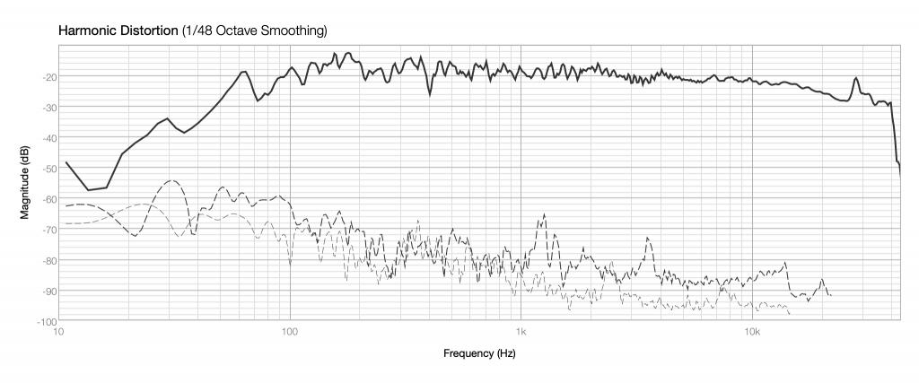

                                                                                This crossover does incorporate the voicing concept with a gradual 1-1/2 to 1-3/4 dB roll off above 1kHz. There are some other tricks, too... but we can only see if they work fully looking at the distortion plot...
                                                                                My initial reaction is that mission appears to be accomplished from that perspective- I was shooting for an Ardent like distortion characteristic, trying to keep HD2 down as well as HD3. This was measured at 2.8VRMS.
                                                                                All I can do for the moment is listen to it in "glorious mono" using VOX on my 2014 MacBook Pro used for testing drivers and speakers. Not state of the art, though the Cambridge preamp and Aragon amp are pretty decent for the day and age.
                                                                                Test cuts include Sting, Cuandero, Howard Jones, Edie Brickell, Maire Brennan, Poor Claires, Fourplay, Spyro Gyra, Jacque Loussier Trio, Daria, Alice Gomez, Steely Dan, etc.
                                                                                I didn't have time to do off axis checks with the full setup, but a quick walk around with various program material shows the tweeter living up to expectations based on the raw the measurements in the same test setup. Excellent subjective behavior out to 60 degrees off axis. Probably the best $300 tweeter $50 bucks can buy...

                                                                                  About the crossover, i'd put something beneath it if the shelf is made out of metal so it doesn't mess up the values of coils.

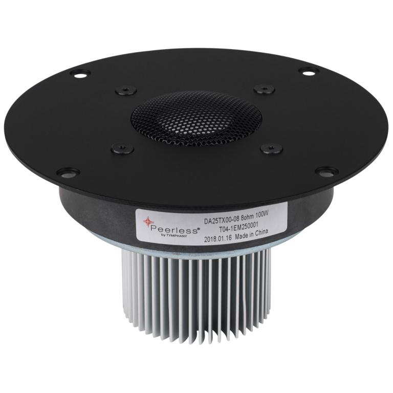

                                                                                    Jon which tweeter are you using? Sorry if you posted above but I can't find it. Or is it something special that only ET can source?
                                                                                      • 16166
                                                                                      Originally posted by Zvu
                                                                                      Great stuff Jon.
                                                                                      Good point to bring up, but the shelf is just fancy duded up HDF. The crossover base is phenolic, fairly thick, from Leecraft.
                                                                                        • 16166
                                                                                        ET can get a better price than I can, but it's this really, (well, I hesitate to use the word "odd", but maybe it fits?) tweeter from Peerless... the DA25TZX00-08. It's rated 100W, which sounds a bit preposterous for a dome tweeter, except that it has this pretty unusual heatsink on it, with the input connectors on the back of that. And while you can take the front plate off (carefully) the motor VC is clearly connected back through the assembly to the banana sockets on the back.
                                                                                        As you can probably see, its a pretty monster ferrite magnet on it, too. The dome is the so called corundum dome; it's rather flat and shallow, and I don't know if that contributes to the wide off axis behavior. The grille is held on magnetically. These are bigger than maybe they look- about 4-3/4" in diameter.
                                                                                        There is a 32mm version which will undoubtedly play a bit louder, but doesn't measure as nice.
                                                                                        With the right crossover approach, it's my pick over a number of other tweeters I've gotten in to evaluate in the last several months which are generally 5-8 times more expensive.
                                                                                        Go figure...
                                                                                        And yeah, ET has been playing with this part in waveguides- the shallow construction and flat plate makes it pretty ideal for rear mounting... this supposedly has something to do with the "Tiny Technological Terrors" bit because he's found some off the shelf inexpensive WG that works pretty well together with this tweeter... not as well as a full blown optimized custom one, but still significantly better than unaided- about 10 dB improvement in loading in the lower frequency area.
