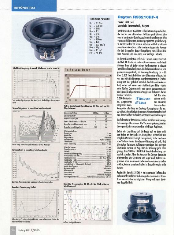

Question for Jon i guess,
Have you ever considered using Dayton Audio RSS210HF for Ardents ?
Measurements from Hobby Hifi attached:
Looking at them, they have very similar TS parameters, both have aluminium cone, and model very similar (volume differs by 5-10 liters depending on what you want to achieve and in what type of cabinet). Daytons are easier to get in US, cheaper and by the looks of it - it wouldn't cost you much of a performance, if any. Wavecor does look a bit sexier with smaller dust-cap and shallower cone.- Bottom
I thought occasionally about it, I have one or two on hand, but in my experience the actual sensitivity seemed even lower, the Qts is rather high, and the Sd is somewhat less. Of course, it does win out on price.
But I'm sure it could be used successfully with some alteration of the design. My recollection is that it also had somewhat more issues with the breakup mode Q.

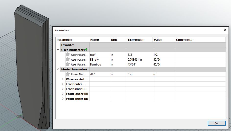

I'm also getting ready to attempt the Wavecor Ardents in their original form. As a preparation I've been going through the many threads and gathering pics, tips and descriptions into a OneNote notebook. I've separated out the box drawings, box build tips, crossover topics, driver topics etc. At one point I'll try to make this available for download too, but that'll take some more time to both gather the data and clean it up nice enough.... What I can say is that after going through the threads and seeing the many ways these boxes can be done it does not feel as intimidating anymore
I've also started to redraw the box in Fusion 360. Few purposes with that
* teach myself the Fusion
* it has very easy ability to switch between imperial and metric
* it has a 2d sketch -> 3D model driven logic
* one can create "project parameters" for material thickness for example
So in theory if done correct one can change these material parameters for BB or Bamboo and the whole 3D model adapts accordingly.....
I'm some way away from being able to do the Ardent box like that but a simple rectangular 2way box did work and scale nicely if I tried 18mm versus 22mm versus 29mm... or change driver holes and flange cuts via 2D source drawing etc.
