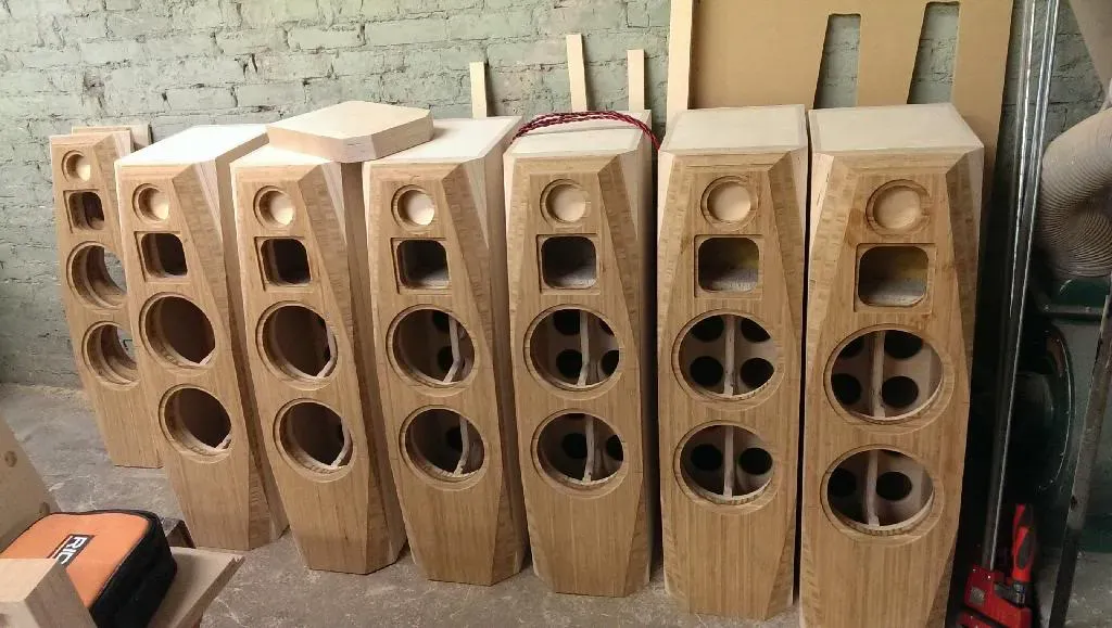

                                                    Well I was wondering when someone was going to ask for the easy button 8O
                                                    Fdas it is okay to scratch your head and wonder how this can be done when you have limited or no tools or woodworking skills. The first run was done all CNC, 6 completed cabs and 2 baffles ready for cabinets. notice 2 assembled baffles on the left, they were shipped to a member to do his own cabs!
                                                    We did this to facilitate a 3 different time crunches, 1. Ben was leaving town, 2. Poor Jon had no time and 3. we used a unique facility in our city that allowed membership and access to some very nice machines by monthly cost. Ben had the CNC skills and I had the layout and woodworking experience. I mentioned in the first few pages of our build that many cabs could be done like this if members were local to each other. The other way is have a cabinet maker make the cabinet parts for flat pack to be assembled and finished. The individual baffle layers could be made then assemble and facets cut and these could then be shipped with the cabinet parts all flat packed ready for final ensemble, veneering and finish. Now if you had a bulk buy going, the cabinet maker would just add material and labor cost for each buying member and the different shipping cost. If you are on your own you could give the cabinet guy all files needed and have him make then to whatever end you want, just flat pack, assembled, or fully finished ready for drivers and xovers.
                                                    Now because we have such skilled guys here they went at them selves with there own skills, tools and time lines. If you could find a guy like this and butter him or her up and even promise to be by his side through it all maybe. There are lots of wood workers with really big egos that might bite just for the challenge! If you buy him some blades and clamps and of course some "wobblely pops" he would do this for you! You know when I was getting back at speaker building I made several cabs for practice for others at no cost.
                                                    So don't give up show the thread to your fav cab guy! He might want to do other speaks for himself!
                                                    Last edited by theSven; 24 May 2023, 17:13 Wednesday. Reason: Update image location

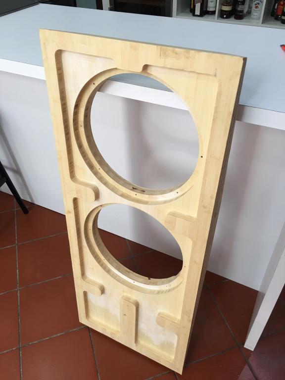

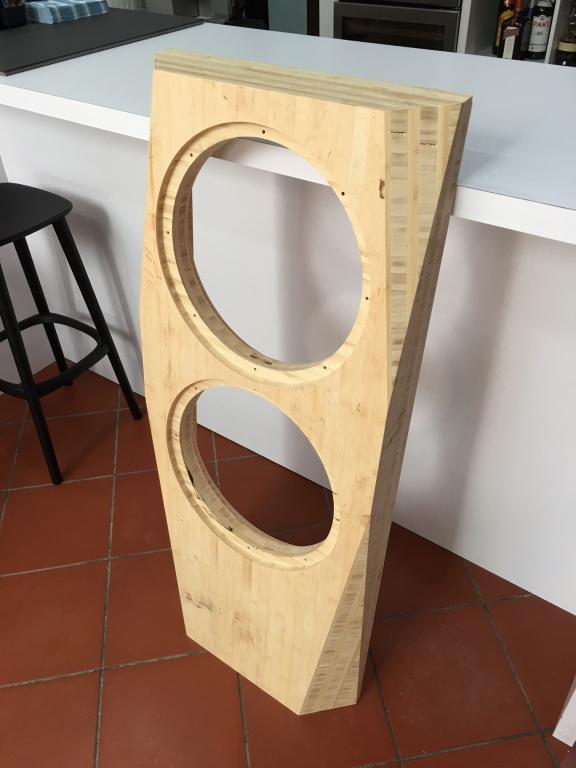

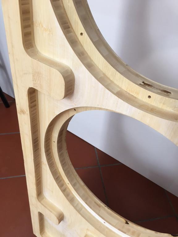

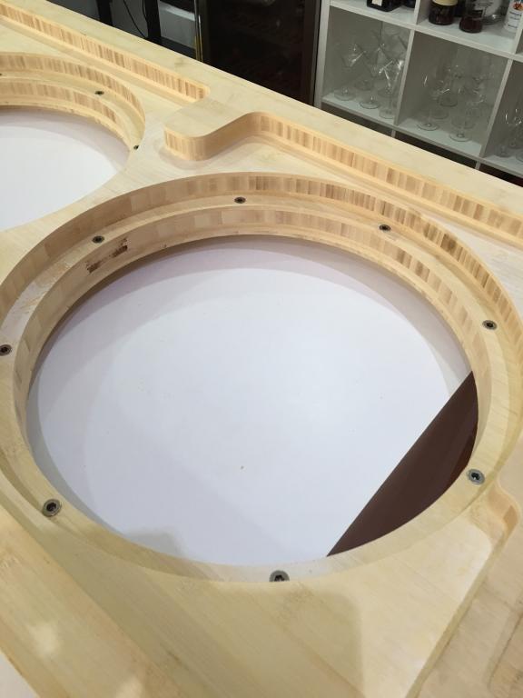

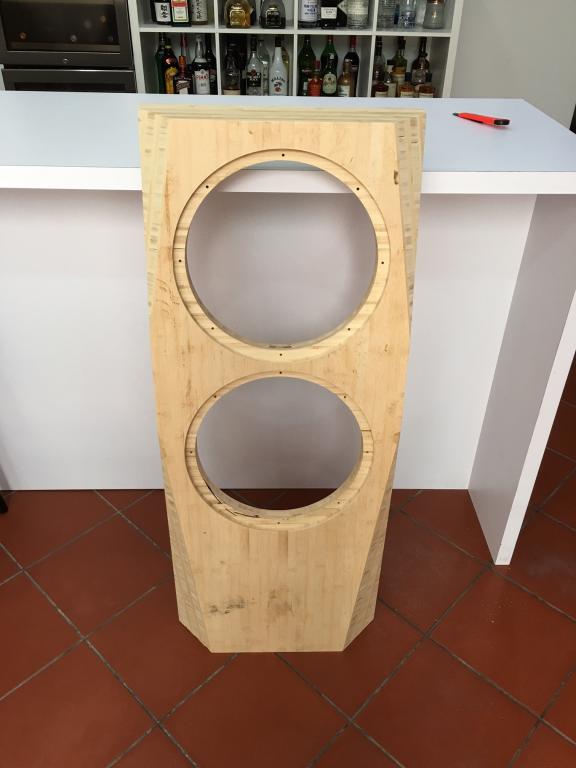

                                                                                    All... one way to go the front Baffles is to CNC Machine them. Its expensive, but would give you excellent accuracy and save a bunch of time and potential equipment costs. If there was a group interested, I would happily price material/machining/Shipping... Assuming a Pallet for shipping, it would probably need to be 6+ sets to make it "affordable" to ship to the US. My machinist has proved to be very good machining all of my Baffles for the big Isiris build...
                                                                                    • meb46
                                                                                      • Jul 2010
                                                                                      • 398
                                                                                      #357
                                                                                      CNC Machining quality out of my Singapore supplier...

                                                                                        #358
                                                                                        Way to go Mike, we slip you the file you make the baffle 1/16" bigger all around and they build the box and trim the baffle to fit their final cab! Now what 6 builders are going to to step up?
                                                                                          • 2121
                                                                                          #359
                                                                                          Mike did your guy glue all the layers of wood initially and then machine, or did he machine a layer at a time and then glue those together?
