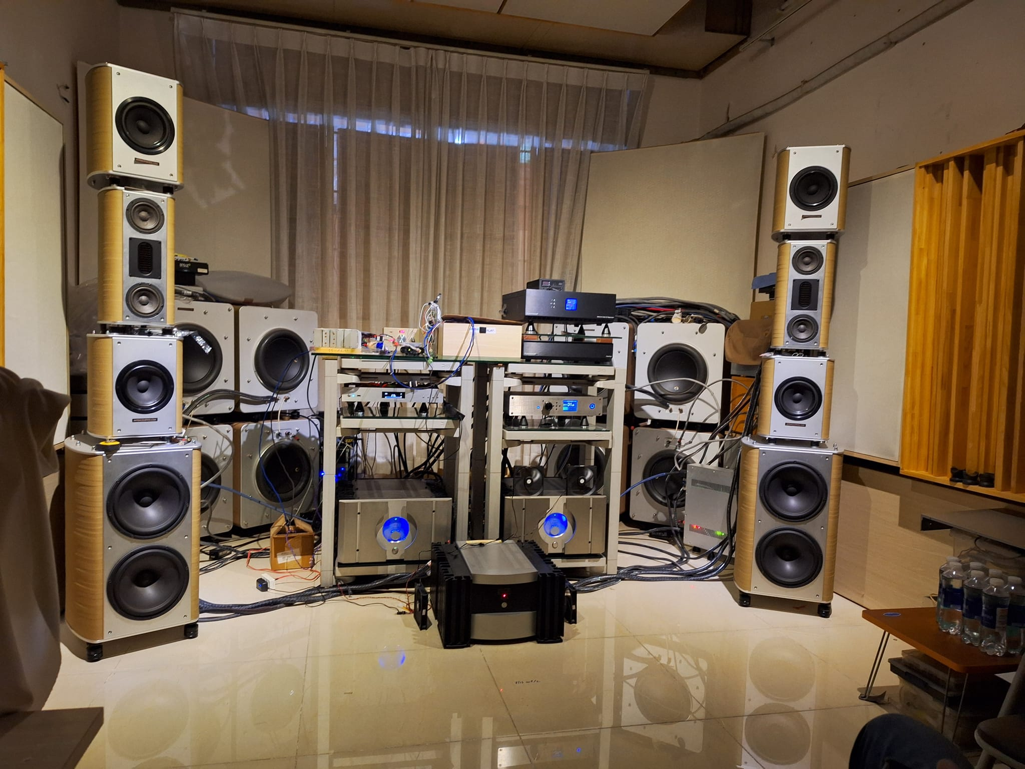

                                  Something we forgot to mention Kevin is that we did a modified version of the Wavecor Ardent for Renron, using a Scanspeak 4” midrange. They’r discussed in this thread, in passing, and they worked out quite nicely- go look at the frequency response specs for that part. I have all the documentation for it the design, should you be interested and not want to figure it out on your own… but the latter would be a good homework assignment, if you have some measurement gear and use the free design tool VituixCAD!
                                  There’s a picture of Ron’s I took at his home on page 18 of this thread…Ron is an absolute wizard on wood working and finishes, so if you have questions and can get hold of him by posting here or sending a PM, he can definitely point you in the right direction. I’m just a wires and sparks guy, but I can get by without screwing things up too much when it comes to builds.

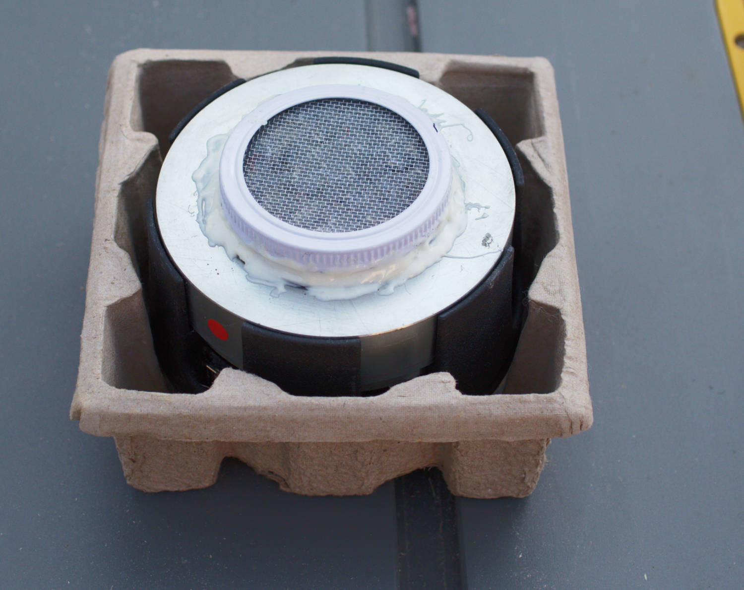

                                        And if you really want to have something a bit off the beaten path, I have several new pairs of Peerless DA25TX, and combined with the 12MU4731 things look pretty nice... partly due to the ultrasonic notch filter in the tweeter crossover. That tweeter is now only available in OEM quantities, and would require some modification of the cabinet rebate and cutout, due to it's larger size.
                                        Click image for larger version  Name:	fetch?id=866386&d=1639523674.png Views:	0 Size:	48.1 KB ID:	927184
                                        Click image for larger version  Name:	fetch?id=866387&d=1639523735.jpg Views:	0 Size:	87.8 KB ID:	927185
                                        Click image for larger version  Name:	fetch?id=866388&d=1639523827.jpg Views:	0 Size:	80.3 KB ID:	927186

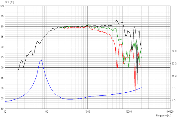

                                            The midrange I'm looking at for this update is the Faital Pro 5FE120, originally designed for high output line arrays. Very clean, especially the top end and excellent dispersion (red plot is 45 degrees off axis!)
Name:	5FE120 SPL-Z.png
                                            I've measured and verified it myself, note the slight dip between 300-400Hz is an issue with most of Faital's SPL plots, not with the driver! Looking at this for a CC project, too.

                                                                OK, have the data now for the ScanSpeak 12MU4731- have FRD and ZMA files, too-
                                                                First, a composite set of curves at 0 degrees, 15, and 30:
                                                                Here's the impedance curves- point to a fairly clean motor with good inductance control:
