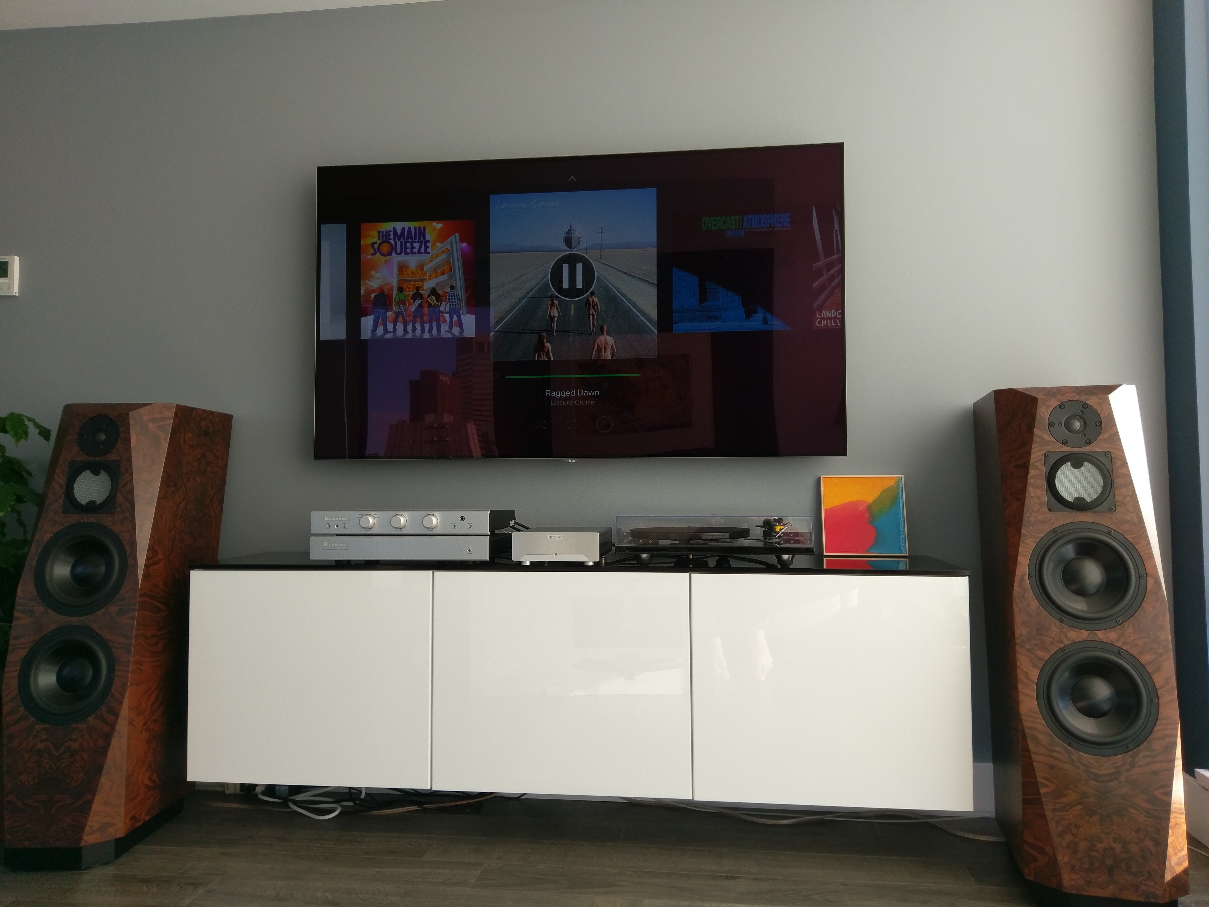

                            Ardent check in here:
                            Tek, I'm jealous of your room. Looks like a great place to spend time.
                            Jon, that is both comforting and alarming, the room left in the Ardents!
                            Although I think I'm finished for a while. I picked up a 65" OLED on a Black Friday sale...lucky for me Canada has borrowed that tradition from our American friends.

                              Just love your finish Ben! Congrats on your new TV. 65" OLED sounds like a killer!
                              I expect that I will stay with my Marantz prosessor and sony projector for some more years. Waiting for the really large tv's to be more common and drop in price, then I might target a 100" 4k tv and replace the prosessor with something newer that supports 4k...

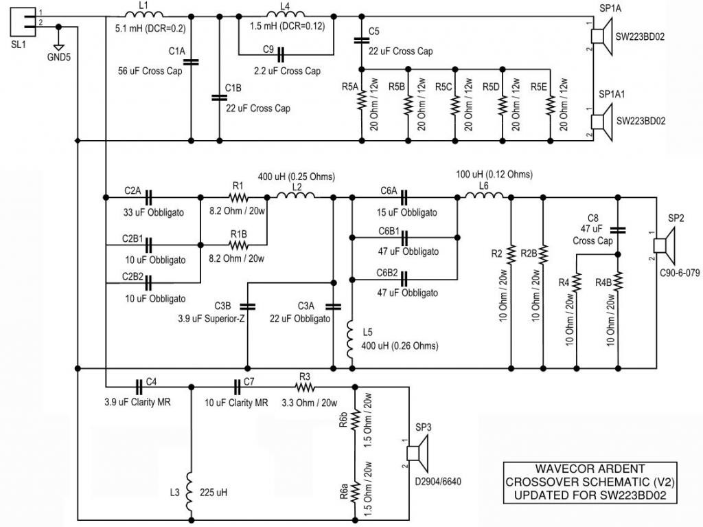

                                                Quick crossover question. Do the midrange C3A and C3B capacitors want to be a higher quality capacitor? In the schematic I put together (BD002 Schematic) I show an Obbligato/Z-Superior in parallel but some have recommended something cheaper like a Jantzen Standard Z-Cap. I recall you recommending the use of Obbligatos in these positions (maybe in Bob's thread), but perhaps I misunderstood. I'm not looking to skimp on my build, but if there is no real benefit to a better capacitor I might as well save a few bucks.
                                                What are your thoughts?

                                                  I was going to test that and see if I could hear a difference. A little gear rolling early on and I figured that if I didn't hear a difference it was just because the rest of the signal chain wasn't up to it. I never got around to testing with a 22 µF cross cap for C3A. I have it set up as depicted.
                                                  As you said, it's only a few bucks to remove some doubt later on when you're upgrading your gear. That's going to hurt. I have a Cambridge 851D arriving tomorrow. Now I need to rebuild my Aleph-J to accept balanced inputs and get out the A75.
                                                  Hope you start building soon, Horio.

                                                    Horio, in general.............."IN GENERAL" there are always exceptions, if you are using Obbligato (gold quality) caps and not exotics like Clarity MR or Purple $$$ caps then spending money on "better" caps used in parallel won't gain you much, if anything. Caps used in series will provide more "bang for the buck". Higher quality caps in the first stages of a XO will provide better acoustics than using the same quality caps in the last stages of the filter. Hope that makes sense.

                                                          the Obligatto's are good resonance controlled caps- good bang for the buck, especially from UK's HiFi Collective. the mids are quite important, and the C79 is a pretty transparent driver- I'll go back this evening or tomorrow AM and check over this again and get back to you-
                                                          On the one hand, I could say, it depends on how far you plan to take the rest of your system, but what usually happens with Ardent builders is that the speakers sort of drag them into upgrading other stuff, because they're good enough to have a considerable payoff with better source and amplifying gear.

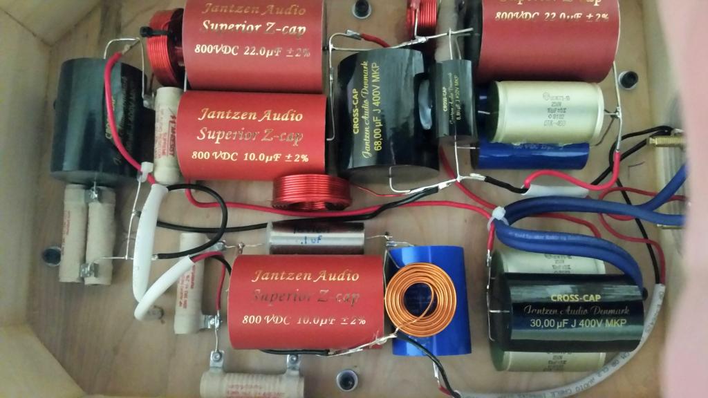

                                                                  These are used in the high frequency roll off path.
                                                                  The usual assumption is that shunt is not as important as direct in series- that may be true- but the electrostatic-stiction forces that can occur with the signal in series ALSO occur with it in parallel.
                                                                  Think of the network as a frequency dependent L-Pad- which it is. Would you want to use a Mundorf on the series side, then an low buck resistor on the parallel side, as any modulation on it due to nonlinearity appears as a signal across the driven device?
                                                                  The human ear is most sensitive in this frequency range. I like your own redraw of the schematic, and I'd personally recommend staying with that configuration- I would in your shoes... \
                                                                  Click image for larger version  Name:	31845377071_6de2009483_o.jpg Views:	0 Size:	125.2 KB ID:	937459
                                                                  (not that that is much of a recommendation- everyone knows I'm crazy... but OTOH, I've heard the difference stuff like Paul Hynes shunt regulators make in a difference, and Schnerzinger cables, and a variety of other things- better speaker caps are relatively mundane and easy choice, in my book. )
                                                                  It really depends on how far you want to take this-
                                                                  ponder that I can readily identify 100% of the time the difference between the original Benchmark DAC and the original Berkeley Alpha DAC, on cheap Logitech passive computer speakers. But the better your speaker system is, the more important these differences become in the long run...
                                                                  And on the other hand, you wouldn't want to have to apologize to ET like Captain Needa did, for using the wrong caps? He has had some influence through the power of the Force on these decisions and evaluations (you know how weak minds are so easily influenced...) :W

                                                                    Thanks for the feedback everyone. I'm going to stick with the schematic I posted, and not worry about the few extra $$.

                                                                              I have been happily using an old Music Reference RM-5 preamp in my system and another benefit is added warmth in the winter. Those in the frigid climates might start thinking tubes! Happy New Years guys.

                                                                                Because Jon doesn't have enough to do in his (spare) time, I gave him a pair of lower cost NOS Russian PETP 10 Ohm K73-16 capacitors yesterday for testing. These have been reviewed favorably by many, many people. Metal case, hard epoxied end caps silver leads all the good stuff.
                                                                                We'll see what the Magic Scope says.
                                                                                Ron
                                                                                Interesting.. most interesting. This appears to be the local system equivalent of NOS from the Empire- the similarities are striking.
                                                                                So, I only think it appropriate that the Empire should strike back, and stock up at these prices... it's doubtful that rebel scum will fully appreciate them, and I have some upcoming small builds that will benefit from a selection of relatively high quality compact low cost parts...
                                                                                Perhaps I will leave a few left for others to buy... perhaps not.

                                                                                  I have tested them against the Obbligato gold and copper, Audience AuriCap and the lower end Mundorf Mcap Supreme of the same value, The K73-16 stayed in the amp. Listening tests only. YMMV. Mundorf Mcap supreme had cleaner highs but floppier mid and bass, IMO.
                                                                                  I hope I have helped the empire in some small way.
