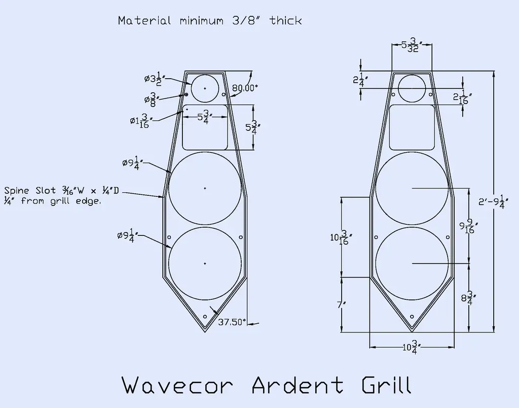

    Thanks Jon, 1 more to update. Thought they would start asking for the grill, didn't add our cutout for the felt we used. Most making manually can decide on their own thickness and material for their grill and make a cutout to suit. Anyone CNCing can get Ben's file off the model.
Name:	Grill Manual Layout.webp
    Last edited by theSven; 24 May 2023, 15:46 Wednesday. Reason: Update image location
      What material did you use? Bamboo?
      I guess that for us that can not source bamboo that MDF is the best choice?
      From my experience, large thin sheets of plywood have a tendency to buckle.
        • 16176
        These can be done with MDF or HDF- the latter is harder to get, and at times, a subtle distinction. Either mills well, and yes, I think plywood of that thickness may often not be all that dimensionally (planar) stable, without some type of bracing.
        I'll update/add this to the front this weekend.
          Any information about what the tweeter, mid and bass chamber should be lined with internally, as well as the amount of fill to add to all chambers?
          I expext that the tweeter camber is left empty, but would like a confirmation.
          Also know Jon lined his mid chamber with led first, but not what if it also should be lined with something more.
          Remember that the bass chamber on the isiris was lined with carpets(?), but dont remember to see anything about it for this build.

            Hello TEK,
            What I did was line the mid/tweeter chamber with lead, then with ~16mm heavy felt, then stuffed with long fiber wool.
            The bass chamber was not lined, as the natural wall resonant points are well above the operating frequency range of the drivers; I stuffed mine with Acousta Stuff, a synthetic fiber material designed for loudspeaker stuffing, but I believe high quality fiberglass would work just fine. An empirical way to determine the ideal amount of stuffing would require measuring the impedance curve, and keep adding stuffing until the resonant frequency starts going up, or there is no further decline in the impedance peak. It's not really very critical, considering the greater influence room positioning generally has on the overall bass performance, but naturally, you're better off with the lowest Fb and greatest damping, unless the driver is already with too low a Qtc, in that case, you probably shouldn't be using it sealed anyway! :W

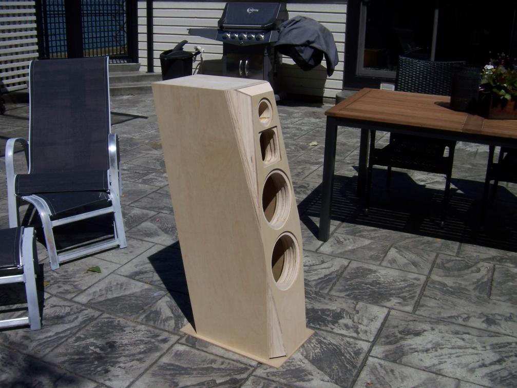

                                I'm finally making some progress!

                                    Pictures on the internet means it's real! Good to see the progress... What are your veneering plans?

                                      Wow! Nice.
                                      With all these Ardent style builds surfacing around the internet, you guys are starting to make it look easy to build something that great looking.

                                        Thanks guys! At one point I didn't think I would get this far.
                                        It is kind of like Bob's Poor Man build: could I do this with only very basic tools. Seemed to come out ok c/w all of its foibles.
                                        Veneering (sigh) I clad the out side with .25 maple veneer ply. That is truly horrible stuff but I think I will just finish doing the facets and leave it.
                                        I plan to do another set in the future.
                                        Cheers, Wayne

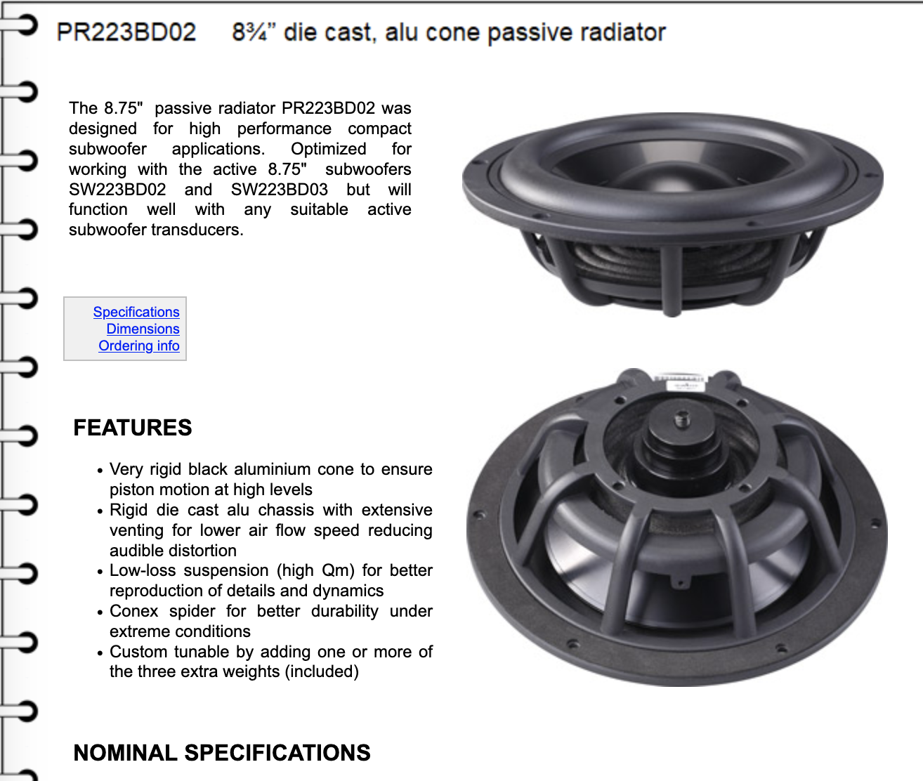

                                                    I just got my PRS223BD02 PR's today, which are going to be used in new experimental stand mount speaker- similar frames, but a lot lighter without those big magnets!
                                                    As shown here, they come with multiple weights, allowing easy tuning for the specific application; I've already figured out from the data sheet which combination should work in a 1 cu ft enclosure.

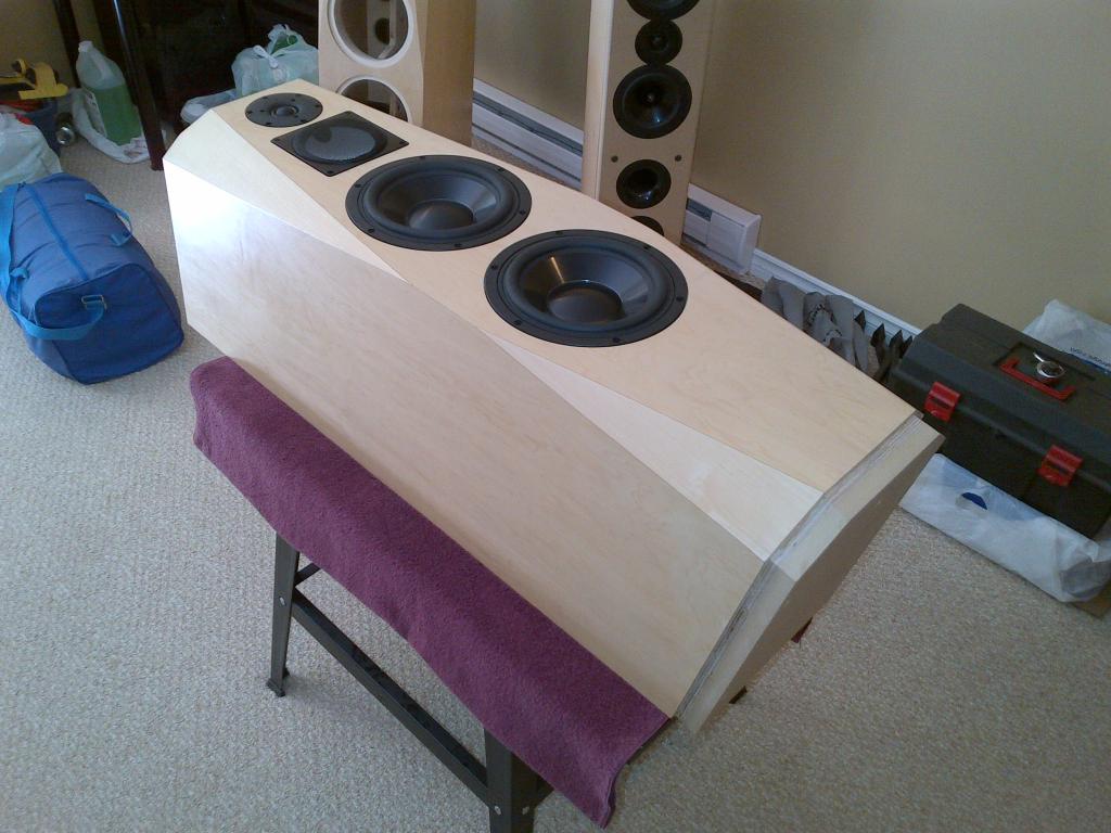

Name:	Wavecor Ardent.jpg
                                                            My dream is a little closer!
                                                            A really big thank you to Dar, Ben and Jon!

                                                                  Looking great Wayne! The veneer looks very nice. What technique did you use for gluing/applying the veneer?
                                                                  • Wayman
                                                                    • May 2014
                                                                    • 89
                                                                    Thanks Horio!
                                                                    The front and sides are .25 maple veneer ply. The facets are pre-glued veneer. 3M I think.
                                                                    I tried several finishes. In the end I used 3 coats of Minwax hand rub satin poly.

                                                                        Interesting. So instead of putting down 1/8" hardboard prior to veneering as others have done, you simply glued veneer ply onto the main cabinet faces. Something to think about.
                                                                        In the past I've had good luck with raw veneer and heat lock glue (iron on method) but my max panel width of 11 inches. I'm a bit worried about splitting with the larger panels that would be necessary for this speaker. Ironing might work great for the facets though.

                                                                          Yes Horio, for the reasons you stated. I haven't done much veneering so it seemed the easier way to go. What ever type of ply they use tho is horrible. Next time I might try pre-gluing the veneer to some .125 BB.
                                                                          I 45* the front corners and it seemed to come out ok. A bit stressful to line up for gluing tho.
