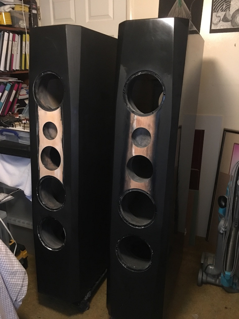

                                                                          I'm slowly gathering the parts to build a pair of these. Are people just making their own baffles at this point?
                                                                            #532
                                                                            I think everyone after the initial group did our own baffles. Not nearly as hard as it looks. Mark the facet edges. Handsaw off most of the facet then use a plane/power plane/belt sander to the pencil line. Done with all cuts in about the time it takes to build and set up a tablesaw jig.

                                                                              I'm not too terribly worried about the facets, it's the laminating that I always find to be a tedious, messy process. No way around it though.
                                                                                • 1670
                                                                                #534
                                                                                Lamination? As in laminating together several pices of plywood to get a baffel of the wanted thickness, or as in veneering?
                                                                                I placed the plates on top of each other and used drilled holes and wooden dowels to avoid that the sheets moved sideways when I glued them together.
                                                                                But one advice is to ensure that you add a side sheet of thin plywood for the whole side of the speaker to ensure that you do not get a edge between the baffel and the sides of the speakers. As the baffel is very thick and the wood are in another direction than the side of the speaker - this will easly happend if you do not take actions to avoid it.
                                                                                If you do not like veneering you could of course go for spray paint :-)
                                                                                  #535
                                                                                  I took the easier way out - since I had excess material I just glued two layers together with a clamp across each end until I had a few vertical clamps tight. Repeat with the double layers after driver cut outs. Then used a 2" flush trim bit guiding on the third layer down - it was most recessed on one edge. You're going to have to trim the 1/16" excess baffle width anyway, so I used my tablesaw to trim to width so that it just needed a touch of sanding to go flush.
                                                                                  I went the epoxy route for sealing. You pretty much have to do a gloss finish after it, and need to coat the show side with epoxy after lamination because there will be bleed through. And I still have a little bit of seam telegraphing through. I'd probably go TEK's route if I did it again. My girlfriend says they look and sound great and I am not allowed to re-veneer them.
                                                                                    • 1483

                                                                                    Laminating as in gluing several layers of materials together for thickness. I just find it messy most time I do it. I like the idea of adding an additional layer to the sides. Unsure how I'll finish them, honestly I might just pay someone to veneer, coat, and polish them (or fiberglass, paint, and polish them) as I really don't enjoy that part of the job. We'll see what's available when the time comes in 2020.
                                                                                    Is that being a bit too pessimistic?
                                                                                    Also not a bad idea. I'd rather have a little too much wood than not enough, especially when we're talking about bamboo. Though I might follow what our dark lord did with the Kurosawa project and source some of that pin block material, at least for the baffles. Do you think he'd mind if I went with a nice shade of white?
                                                                                    I think I feel my throat tightening already...

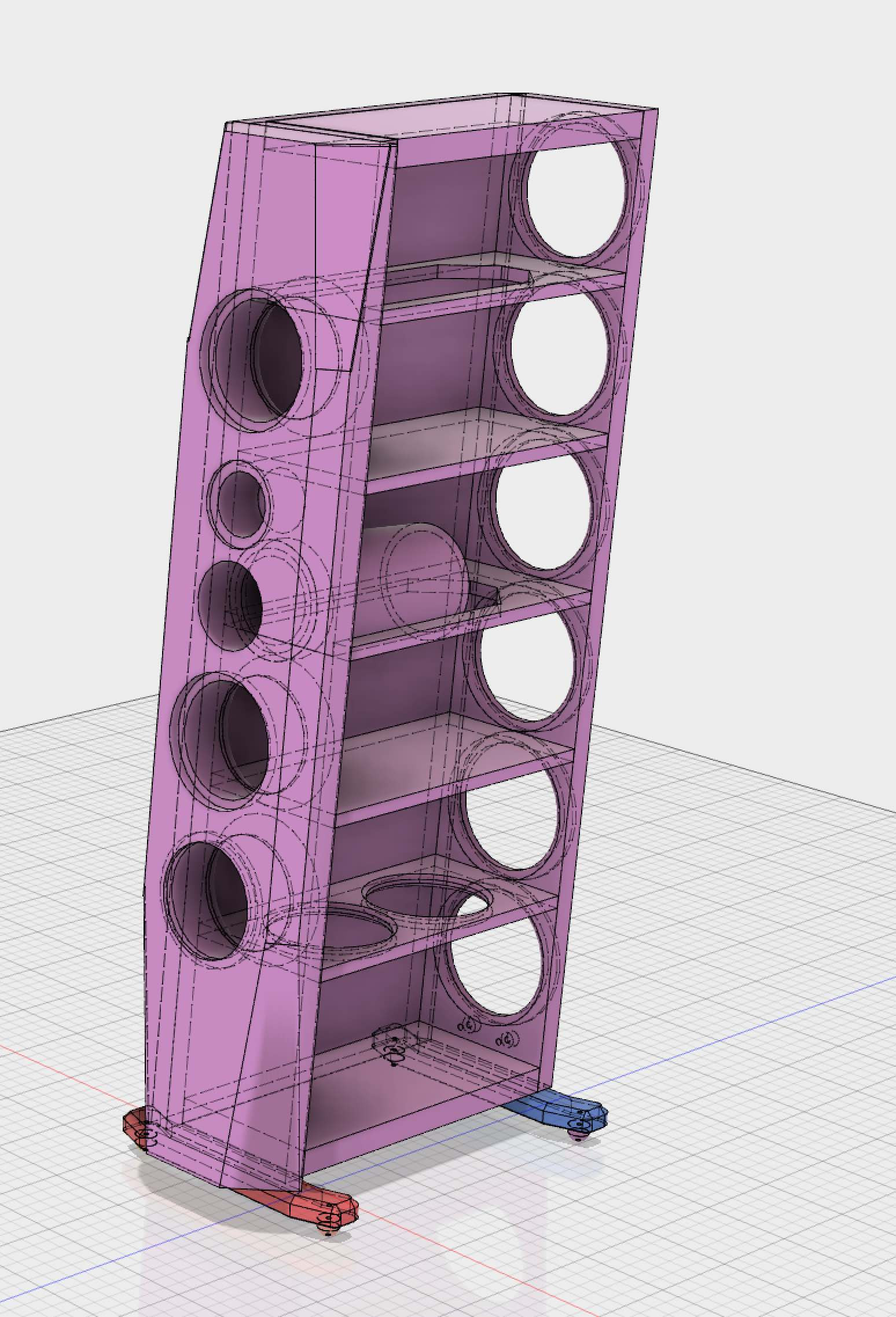

                                                                                      If you look at the original Ardent thread, you can see some stuff about laying up and clamping pieces to make the front panel; it's recommended unless you have a dedicated beech work bench to use some heavy angle iron to assure basic alignment and no warpage of the pieces.
                                                                                      I'd go into more, but short on time, I'm in a McDonald's in Winnemuca NV finishing a light lunch, before proceeding to Boise.
                                                                                      It's been a busy month.
