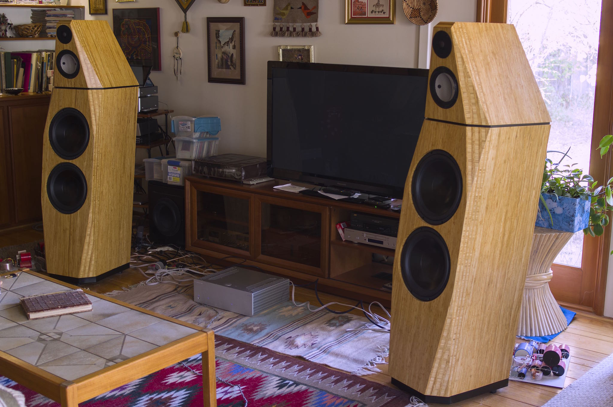

                                        The key targets for the Ardents were as follows:
                                        • Relativeliy compact form factor, with relativey high WAF (there are always exceptions, but these are much better tolerated than, say, the Isiris, by the fair sex)
                                        • Very low distortion - particularly 3rd order and high order- and like the Isiris, they use a woofer that straddles the boundary between sub driver and conventionasl woofer in order to have some extra Xmax and use a very linear motor with monotonically decreasing distortion wtih frequency for the woofer.
                                        • Good bass extension for the size, with the capabillity with correct room placement (and optimized boundary reinforcement) to have subjectively flat response to the 30's.
                                        • Wide power response- very good off axis behavior
                                        • Under $5K in basic BOM cost
                                        To get significant extensions in low end and some improvement in sensitivity while retaining the very low distortion performance means a much larger system... which blows out the first prime directive and the last one. The core woofer volume for the Ardents is 40L for both drivers. for a moderately optimized PR version, we'd need to push that to 50 or 60. The smaller version of the Isirs (like I have) is 110L for the woofers.

                                        The calculated BOM cost for the original version of these was $10K. This pair is in the middle of an upgrade process, with active drive and DSP equalization of the low end; this will add about another $1.2K to the BOM cost- for now I wouldn't count the brand new updated crossover parts sitting in a box- about 25% more expensive than the original crossover against that BOM. But realistically, this means about $12K BOM cost. It is an open question as to whether they will match or exceed the Dai Katana's... the latter, I here, are using a full Duelund crossover design, which was tried and discarded for the Isiris because of the driver time alignment issues.
                                        Of course, you can get high sensitivity drivers at lower cost than Accuton, for example, but I haven't found ones at lower cost that match the linear and nonlinear distortion behavior. That doesn't mean they couldn't be fun systems for certain kinds of music- having good dynamic range and being able to play loud is a certain kind of quality in and of itself, but I started outgrowing what I would call HiFi PA systems for the home in the 90's, after building a set of Wilson Audio X1-SLAMM clones, which would certainly play loud, but had about a 15 dB lower distortion floor due to the Eton, Focal, and Audax woofers used.
                                        These days, after looking at the driver SPL response and impedance, and freedom from resonances, even minor ones in the pass band (big problem with paper cone drivers still) (just look at the impedance curve bobbles- that's the give away) is all about the non-linear distortion.
                                        Those Accuton AS190 and AS250 drivers are very impressive in that regard, but they don't come cheap...
