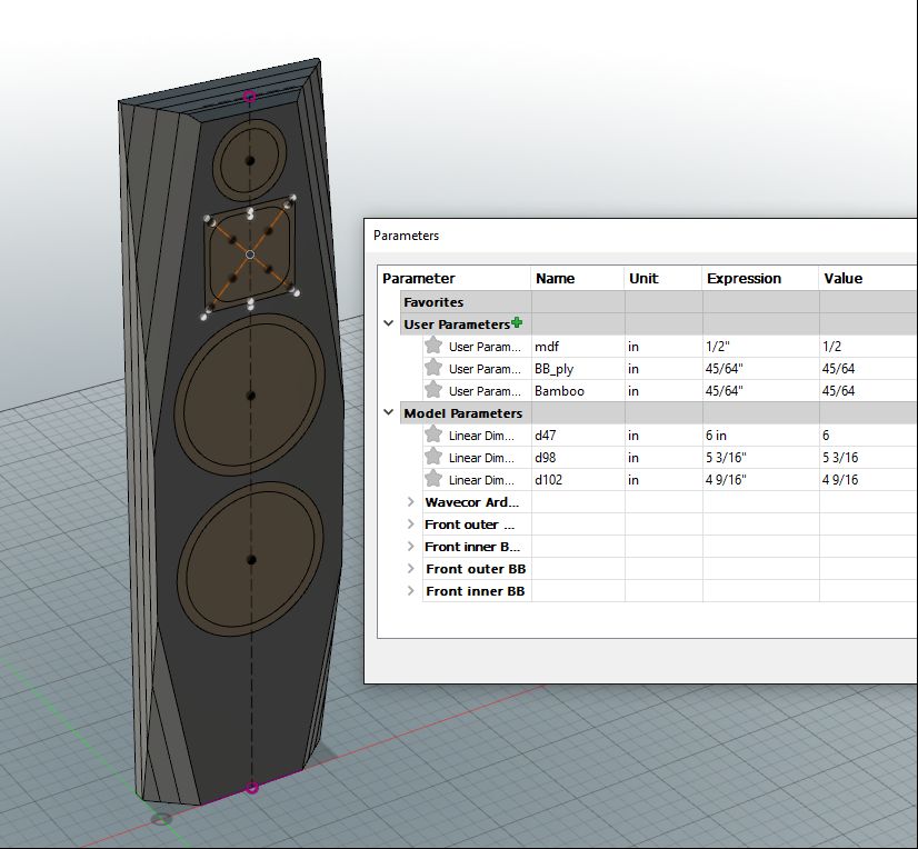

                            Building the Ardents virtually for now, but making some progress.
                            The project parameters work as they should - so the model scales nicely if I increase the layer thickness of the panel materials. Now on to the box modelling during the weekend.
                            Original intended baffle material thickness's

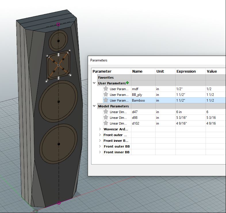

                            With both BB and Bamboo set to 1 1/2 inch just for a try
