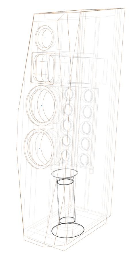

                                                                        Well, while you're thinking, you can peruse this...
                                                                        CAD work isn't completely finished,but it's getting close, and I'll be doing more cabinet piece work this Saturday at least. I'd like to say I'll be gluing a box or two together, but I know better than to be too optimistic at this point. If I get the sides completely finished cut and routed, and the braces cut, drilled and routed that will probably be pretty good. Picked up some good hole saws and an interesting finishing saw today.

                                                                          That's a sexy cabinet...... So is it an open back mid? Or there is just a tunnel for the midrange chamber? I'm guessing the later.

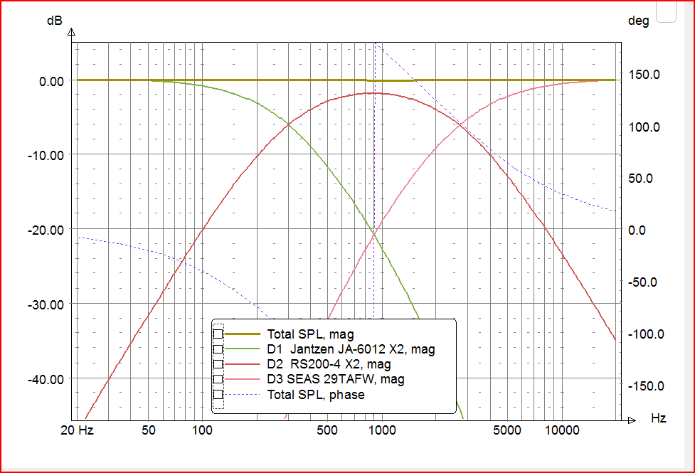

                                                                            Jon I must have missed it but where are you crossing the Accuton mid to the SEAS woofer? And this will be a Duelund filter? I really like the overall concept of this Ardent, and Accuton is IMHO one of the few really doing hardcones right. I've been eyeballing both the 2" and 3" for a WAY in the future project. Both are nice, with the tradeoff being where the designer would rather crossover-in the middle of the midrange, or higher but above where the ear is most sensitive.

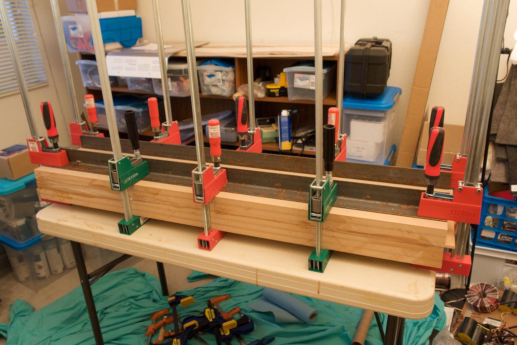

                                                                                Jon (or others) - a question I've had pending since the first of the clamp money shots - have you looked at vacuum clamping? I figure that if I'm looking at this as a chance to do vacuum veneering, why not also use it for clamping. Not only save $$$ on clamps, but also storage and organization space. Of course, I haven't looked into the practical realities of trying to do precision layups in a vacuum bag, so this may be a bad idea.....

                                                                                  I plan on doing the high end version. I'm really not sure how long it'll take me to do the cabinets as I've never had a space for a shop until now so I've always built them in my kitchen and dining room.
                                                                                  I haven't heard much of vacuum clamping. I do know a vacuum system can run some bucks as well though. I'd love to get a vacuum setup for veneering though as I keep hearing its the best way.

                                                                                    vacuum clamping?
                                                                                    I've heard that you need something like 300 or 400 psi of clamping force for a good bond when glueing up speaker cabinets. I don't know if this is really true. But some of my clamps are rated to do 1100 psi. How would you get this kind of pressure with vacuum clamping? Also, is there a point where the bonding agents need air to cure properly? Waiting on this project. :Z It's going to take too long to get my shop properly equipped. :T
                                                                                        This is the target crossover function that has been used for modeling and evaluation to date:

                                                                                        It is a Duelund alignment, forgot the aleph at the moment, it was chosen based on crossover frequencies and bandwidth requirements for the midrange, tweeter, and woofers, in that order.
                                                                                        Yes, some of the Accuton's are fairly special; I've got C88's and C89's I've played with, but the C79 is the choice pick in their "small" midranges, in my opinion. Nice workable response and sensitivity, and very good distortion behavior.

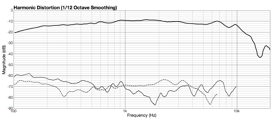

                                                                                        @ 90 dB output, 2.83 VRMS drive
                                                                                        For clean phase and amplitude tracking with this target function and nominal 300Hz and 2700 Hz crossovers, the mid should be capable (at least at lower level) from 100 Hz to 8 kHz; not an easy target.
                                                                                        Note that you can see the effect of cone resonance amplification in the 3rd harmonic plot (dashed - following the same amplitude curve but at 1/3 frequency), but the level is quite low. The C79 has a very short stiff frame, compared even with the C88 and C89, and this seems to avoid resonances which sometimes show up as bumps in the distortion curve.

                                                                                          I actually have the drivers on board for the 'cheapie' version, but I'm thinking the cabinets will be a 6+ month project at least - given how fast I move it could easily be over a year. I guess there was no real need to be so aggressive on the drivers :roll:
                                                                                          That's some interesting question, but I wonder how that would work out in practice?
                                                                                          I've looked into vacuum veneering, and ended up getting scared off by the cost of a good pump and good large bags. Vacuum veneering can generate pressures of 10-12 lb/sq in. without much trouble. It's best done with glues like Unibond, though many folks still use PVA cold press veneer glue; sometimes it's a bit more hassle with the latter because the veneer will start to curl from the moisture in the glue- you have to get it under pressure quickly.
                                                                                          Now, I've see cold press veneer glue that quotes 100-250 lb/in (titebond) recommended clamping force (not remotely possible with a vacuum bag). Pro-Glue doesn't quote clamping pressure, but then it's a product of VAC-U-CLAMP (I've got two bottles of it as wellas the Titebond PVA veneer glue).
                                                                                          I've turned this portion of the cabinet work over to Evil Twin, who is convinced that he can do all the veneering with mechanical cold press techniques (can't complain about how the front panel worked out).
                                                                                          No, I don't own stock in Bessy, but maybe I should. I don't think a vacuum clamp for assembly operations would work well for what I'm doing; I'm actually using clamps at some points to line up work pieces initially, then moving them to more conventional positions after other clamps have been installed. And the clamping force on heavy pieces is much higher than what a vacuum bag can generate; plus, there's the heavy angle iron stock I use at times to insure the glued up piece is perfectly straight.
                                                                                          This will be documented in a lot of detail as I put the web site together; obviously anyone interested is free to innovate and come up with better ideas; it's what I'd expect out of you guys. :W
                                                                                            I think you are forgetting that 300 psi under the clamp pad is spread over a lager area as you clamp up. If we really needed that kind of pressure you're talking over 43,000 pounds of clamping force per square foot.
                                                                                            All you need is enough pressure to bring the pieces into uniformly close proximity. Assuming that your panels are clean and free of debris, you shouldn't need a lot of force to hold them together.
                                                                                            Even if you only pull 10 psi of vacuum you are getting 1440 pounds per square foot of clamping pressure. I've used piles of weights giving less than 100 pounds per square foot and successfully glued panels of multiple layers of mdf together. My standards aren't quite as high as Jon's
