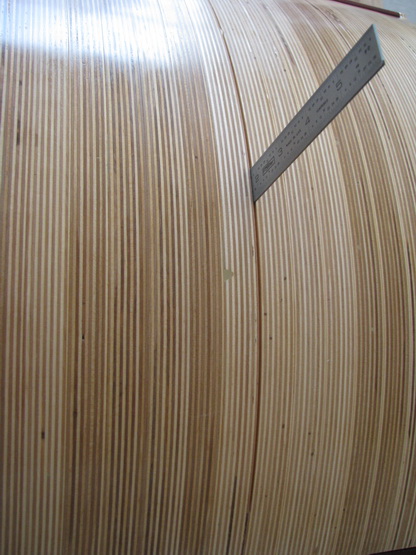

                                                I liked that analogy with the telephone game. I agree and go even further that this can apply not only to internet forums.
                                                This is a technical info taken from a catalogue of a supplier of plywood where I live. If we do the maths we came to the value of 680kg/m3 for BB:
                                                Anyway there seems to be more than one kind of plywood commonly or maybe erroneously known by Baltic Birch so perhaps that's the case. This 'Arauco' looks significantly lighter and we are at the same page about the 1/2" brace ply which I'm going to use.
                                                Those quotes were the first ones significant that popped up on a quick search but you are right about being cautious. Heck I don't even trust the most famous repository of information nowadays for that matter. Nevertheless I couldn't find another site mentioning that 'normal' BB was lighter than MDF.
                                                You offer some wise advice I grant you that . The problem with the sandwich that is kinda scaring me a bit is the increased amount of work and difficulty in the gluing process. After reading almost a dozen threads, some in forums I never even heard before and others so huge that if we extract the valid information this would not amount more than 1% I dare say, I liked this quote in particular by an another forum's member called Svante:
                                                "First, fibreglass damping inside the box has very little direct effect on structural resonances in the box. The main purpuse of box stuffing is to attenuate the acoustical resonances in the air cavity. On the other hand the fibreglass may actually reduce the vibration of the walls indirectly, since damping the air cavity resonances reduces the sound pressure at these; this in turn leads to less vibration in the walls, at the cavity resonaces.
                                                Second, people that I know that know structural dynamics tell me that the best way to apply damping to a mechanical structure is to make a sandwich construction. If the damping layer is in the middle of the wall (eg damping glue between two sheets of MDF) there will be strong shear forces on the damping glue, and so it will absorb a lot of energy.
                                                Applying damping material (asphalt, carpets etc) on the inside of the box is of course not bad, but it is far less effective than a sandwich construction.
                                                Third, bracing shifts the resonances upwards and makes them more resonant (higher Q). At these higher frequencies, the exciting forces are typically smaller, and this reduces the problem with panel vibration, in spite of the higher Q values."

                                                  Another thought is crossing my mind...
                                                  What if, instead of using BB30 for the outer walls I used only 24mm but with two identical layers of BB12 glued together? I'm thinking that perhaps 30mm is overkill as BB is stiffer than MDF and this way I would have the benefits of a double layer together with savings in different materials as the bracing would also be in BB12.
                                                  However... if any ply is actually made of several sheets glued together already I have trouble finding any advantage in gluing two sheets of BB opposed to just one with double thickness. :roll:
                                                  Now if we were talking about different materials...
                                                  Joaquim
                                                  DIY 4 way speakers.
                                                  DIY subwoofers.
                                                  Zaph ZD3C.
                                                    Agreed. I'd be surprised if the cost of 2 12 mm thicknesses would be significantly different than a single equivalent thickness.
                                                    The downside is more work laminating panels up, so IMHO you're better off just using a single thicker panel.
                                                    • cochinada
                                                      • May 2014
                                                      • 658
                                                      Actually 2 sheets of BB12 cost about 17% more than one single BB24 so I guess this isn't a good idea.

                                                        I found an interesting table of properties put together for some of the most common materials used in speaker building. According to Wikipedia the values seem correct enough in order to validate some considerations and choices.
                                                        This one for instance gives the equivalent thickness of materials for constant deflection:
                                                        Some interesting conclusions are made here where I also took the above pictures from.
                                                        These charts here look also very informative and cover even more materials.
                                                        Bottom line is that Baltic Birch has indeed the same density of MDF or just a tiny bit less, contrary to the general notion amongst most people, however as it's specific stiffness is more than 3 times the one of MDF an equivalent box can be made with only 68% of the thickness and hence be much lighter as Ryan (-k-) very well guessed.

                                                          Bottom line is that Baltic Birch has indeed the same density of MDF or just a tiny bit less.
                                                          3.5% less. You know, I've seen people make threads 30 pages long arguing over something more straightforward than whether 3.5% is "the same or just a tiny bit less." You better be careful.
                                                          Have you registered at apawood.org? I'm guessing they'd have your best information if you want to continue the quest. I got some of their printed guides on my shelf, but nothing plywood or mdf related. I'm to lazy to register for another website.
