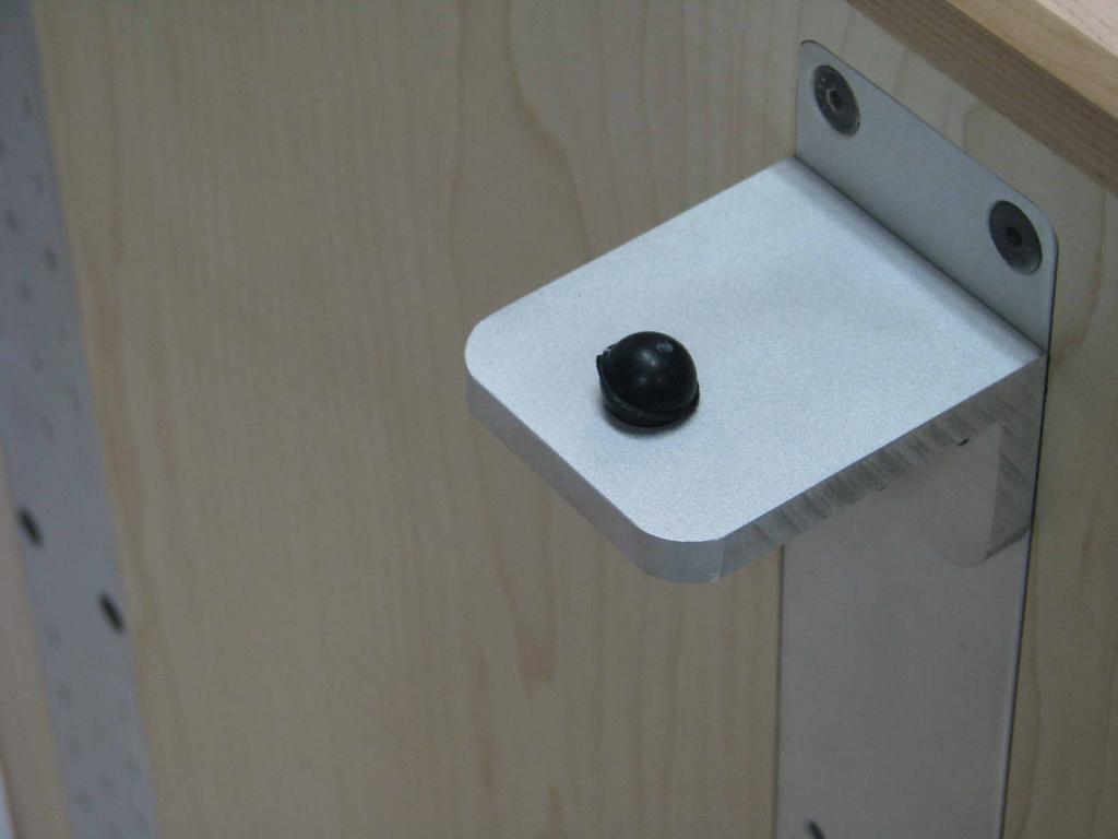

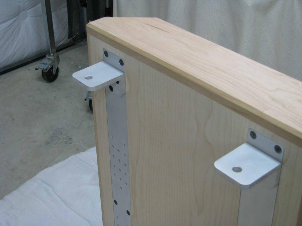

                                                                        I was going to suggest the same as Ryan with the bolt idea, another option that I did with my equipment rack and a set of speakers, is to float the parts on rubber ball bearings.
                                                                        The rubber balls are 5/8" in diameter and the holes that they sit in are 1/2" in diameter. Works very well keeping up with wood movement and very stable, not that they would hold up to small children and their antics, but other wise I've had no problems. Got the balls from McMaster Carr.

                                                                          #171
                                                                          Yep, put something soft between them, should be better than solid couplings. Should also imho be soft feet not spikes under them to isolate them from the floor.

                                                                              Thanks guys. Something soft like rubber of silicone seems the best option so far as this would for sure maximize the friction between the boxes.
                                                                              The spikes are already bought and I'm thinking the best way to mount them due to the weight of the thing...

                                                                                Hey guys I need to sort one small problem. I have the cabinets in my home right now but the thing is that when they are assembled they are not totally motionless. In other words, there is a little movement between each box. So what I need are some suggestions in order to minimize or eliminate this movement. My carpenter suggested a few drops of silicone to act like shock absorbers and also to make them stick tighter to each other when assembled.
                                                                                As these are made by a living and moving material I think that should be expected as long as they are not glued together.
                                                                                You describe it as "a little movement". I think that you should follow you carpenders advice, that should fix the issue and with the weight of these I'm confident that movement will not be a problem.
                                                                                As each speaker is in two parts, each part should be approx 84kg. Compare that to almost any commercial sub and you will still have a lot more weight and stability!
                                                                                Be sure to let the silicon dry before assemblomg the cabinets - at least if you are planning on beeing able to separate them at a later time.
                                                                                  For sure I won't forget that
                                                                                  Just one correction: each speaker is made of 3 boxes and not 2. The bottom one is the heaviest with 87 kg. The MTM weights only 16 Kg and the top box almost 65 kg.
                                                                                    That is sort of why I like the Blue Tack idea. No waiting to dry. No excess thickness. It will squeeze out to almost zero thinness where not needed and is easy to remove at some point in the future.
                                                                                      Interesting, particularly about the almost zero thinness although it says it is ideal for non-porous surfaces and I wonder if wood will work. Anyway I will see if I can find it in the local store.
