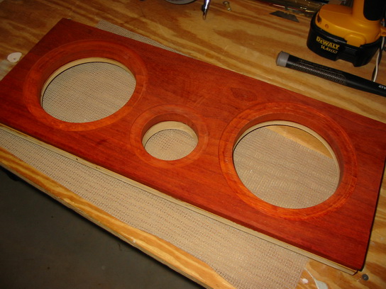

                                  Translamination. When you laminate strips of plywood and leave the plys exposed.
                                  I used this technique in my Ansonica Build (as was CJD's original build). I also have some advice posted here for anyone thinking of going this route.
                                  Someone also linked to this ambitious line array project that had some unfortunate issues (it was repaired in the end).
                                    A 3 way can be perfectly full range, especially when it comes to music. With some larger mids, and larger mid-bass's (10"?) you could have something with an f3 well below 30hz with the right cabinet setup. Just throwing that out there lol, I do like what you've drawn up but that's going to be one huge and heavy beast.....As mentioned I'd probably make them in 3 sections and make it so you can bolt them together through the inside or something.

                                                                  • 2142
                                                                  I did what your suggesting with gluing real wood to mdf and have had no problems with it at all. Of course it might be species dependent or that I just got lucky I've attached a few pics.

                                                                    It's also dependent on how thick the wood itself is. I have done with Steve just posted, but with much thinner wood. I used mahogany. The wood did crack about a very thin section, but this isn't visible as it's concealed beneath the drivers frames.
                                                                      • 2142
                                                                      My vote is for the BB version ....... if you do go the painted mdf version, Ryan is right about the edges telegraphing, my last project was painted and I can see some edges. Since then I have been doing a lot of digging and the best solution I found is to seal the wood with a polyester resin gel coat first, it's used in the marine industry to seal against water. You then paint over that, Wilson Audio goes this route and have some videos you can watch. I also ran across this stuff http://www.rustoleum.com/product-cat...surface-sealer which is supposed to work very well. I have not had a chance to try either yet.
                                                                        How long has this held up?
                                                                          Going on 8 years at this point with no cracking.
