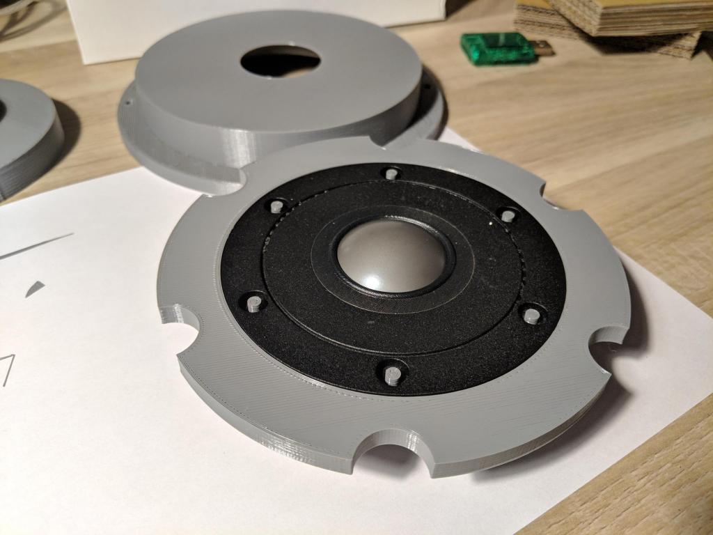

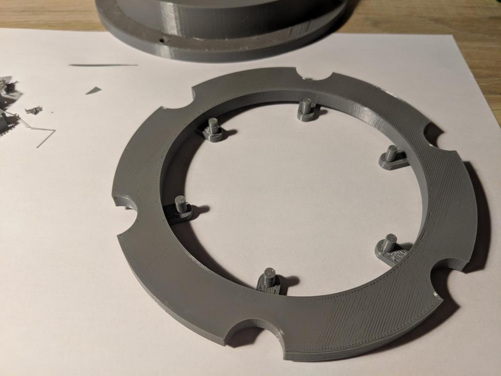

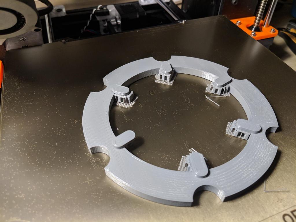

      Joaquim,
      I'm not super close to you, but still in Europe (Estonia). If interested I can help out with the 3D printing. I have a Prusa i3 mark 2.5. In last few days I've been doing a very similar project for my friend....
      You seem upto speed with 3D modelling. If you can come up with a model for pieces you need to couple a new tweeter to the existing hole then I could print these out. 3D printer needs STL files in end but if you'd have a model in Sketchup file or Fusion 360 file then I could export from those as well.
      Hope the below pics give some idea what to keep in mind. The 3D printing can not print mid air - so if there are overhangs than the print would need to use a temporary "support structure" that can be broken off later with relative ease. Material I've used for these samples is PETG plastic that is temperature stable upto 70..80deg celsius or so. PLA can have problems with >50 - experienced that with a mobile holder I printed to my car dashboard.
ID:	863879Click image for larger version
ID:	863880Click image for larger version
ID:	863881Click image for larger version
ID:	863882Click image for larger version

        Wow! That's awesome Ergo! Appreciate your kind offer and if I decide to go with plastic I will certainly ask your help.
        Thanks again!
        Joaquim

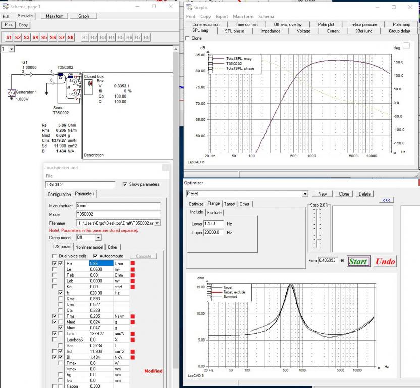

                Does anyone knows how to calculate Qms or Rms that are missing from manufacturer's datasheet for Seas Excel T35C002 E0055?
                This is all the data published:
                Nominal Impedance - 6Ω
                Recommended frequency range - 1500 – 25000Hz
                Short term power handling - 250w
                Long term power handling - 100w
                Sensitivity - 95db
                Voice Coil diameter- 35mm
                Voice Coil Height - 2.0mm
                Air gap height - 3.0mm
                Linear Travel (p-p) - 1.0mm
                Voice Coils Resistance - 4.6Ω
                VCA Inductance - 0.06mH
                Force Factor - 4.3 N/A
                Free Air Resonance - 620Hz
                Moving Mass - 0.47g
                Effective piston area - 11.9cm2
                Magnetic Gap Flux Density - 1.6T
                Magnet Weight - 35g
                Total Weight - 0.37kg
                Joaquim
                          As a bit of an hassle option I could trace back the impedance, then import it to LspCAD and then allow it to "optimize" the T/S of the respective driver parameters until it gets a fit with the imported curve. I have used that method for finding parameters for a passive radiator before, but it should work for tweeter as well.
                          • cochinada
                            • May 2014
                            • 661
                            #553
                            I never used LspCad but I do have the impedance already traced. Is it possible to download a working version or is it just demo?

                              Seems it should do the trick in demo mode... does not allow save or export but you would not need that. But it is sorta tricky process and I had LspCAD open for lookin at TEK-s project so you'r in luck - try these values Click image for larger version
                              • cochinada
                                • May 2014
                                • 661
                                #555
                                Thanks a lot ergo! :T
                                The values are bit different from the ones the manufacturer tells but it suits my purpose which was just to evaluate the cone excursion.

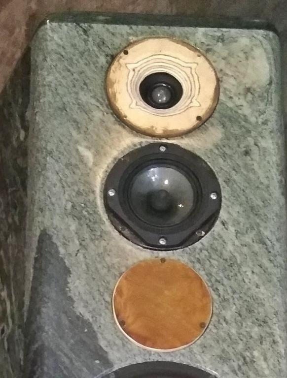

                                                On the picture below, on top we have SEAS-T35C002 with a possible adapter/waveguide with the same acoustic center of the medium. On the middle, a intermediate version and below the standard manufacturer face plate. It can't be a big waveguide. After all the customized diameter is 120mm vs. the original 110m.
                                                What do you think? I have zero experience with waveguides, although I've followed the one in this forum with great interest. There is also this detail of the screws that can't be countersunk as the thickness is not enough.
                                                  Using a countersunk screw head instead of the flat one in the figure that should not be a problem as far as I can understand.

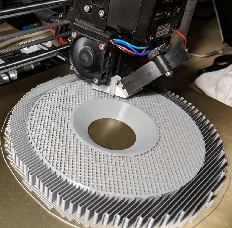

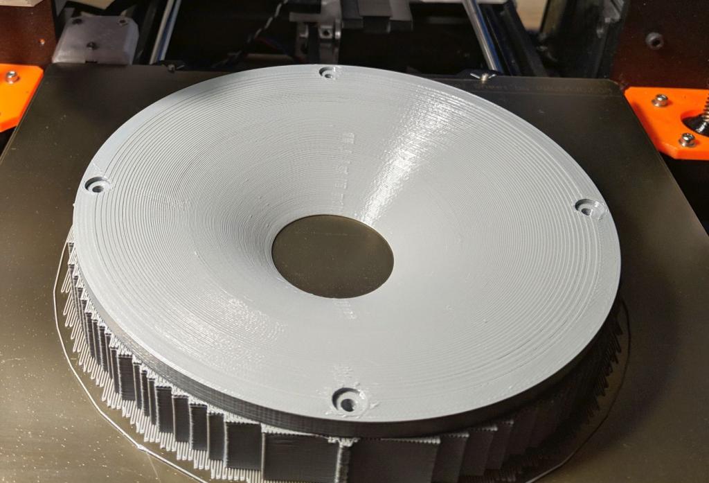

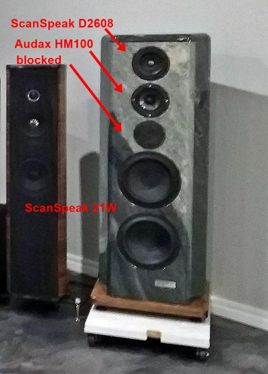

                                                      I have been struggling with similar adapter plate challenge. I bought very rare active speakers that have box made of stone plates, WWTMM configuration. I replaced it's analog xo with minidsp 2x4HD and changed configuration to WWMT with better MT drivers. Also two of woofers were broken.
                                                      The SS D2608 Tweeter fits in the opening of mid, but it is difficult to fit because it's front plate is actually a very shallow waveguide. I have modified the shape of adapter, but measured response is ugly. So far I used plywood for adapters and the project is on hold now, I will continue it later on with my son who is now abroad as exchange student.
                                                      Some pictures

                                                        Originally posted by Juhazi
                                                        I have been struggling with similar adater plate challenge. I bought very rare active speakers that have box made of stone plates, WWTMM configuration. I replaced it's analog xo with minidsp 2x4HD and used configuration to WWMT with better MT drivers. Also two of woofers were broken.
                                                        The SS D2608 Tweeter fits the opening of mid, but it is difficult to fit because it's front plate is actually a very shallow waveguide. I have modified the shape of adapter, but measured response is ugly. So far I used plywood for adapters and the project is on hold now, I will continue it later on with my son who is now abroad as exchange student.
                                                        Some pictures
                                                        That's very disappointed but it's good to know I'm not alone in this kind of challenge, although you seem to have more problems than I do. :roll:
                                                        This D2608 has 72mm of Magnet diameter vs. 74.5mm of the SEAS T35C002. You have one thing in favor though which is that the SS has a 26mm voice coil whereas the SEAS has 35mm and a more prominent dome which I guess intuitively would make the response with such a waveguide even more ugly! But if the hole you have is similar to mine with 120mm you have a bit more room for a waveguide than me.
