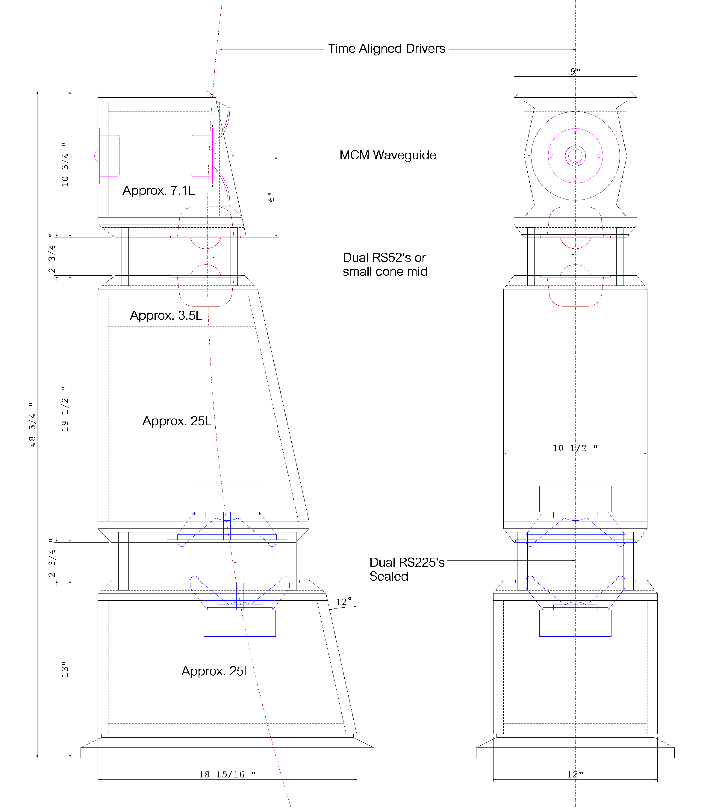

    Ok, that’s what comes to mind at this point. Next are some of the challenges I will need to overcome. For the omni effect, the midrange(s) will need to be upfiring, perhaps on a sloped baffle. Because the mid(s) will be performing in full space and because you are listening at more than 60º off axis, they will lose a good 6db of output on the listening axis. This means that there must either be two mids or one high efficiency mid (probably a Pro driver). If there are two mids, then you run into issues of needing to use some kind of delay circuit and/or lobing issues along the driver’s axis. Fortunately, I think the off axis db loss in the mids might match up quite well with the baffle step losses of the woofers.

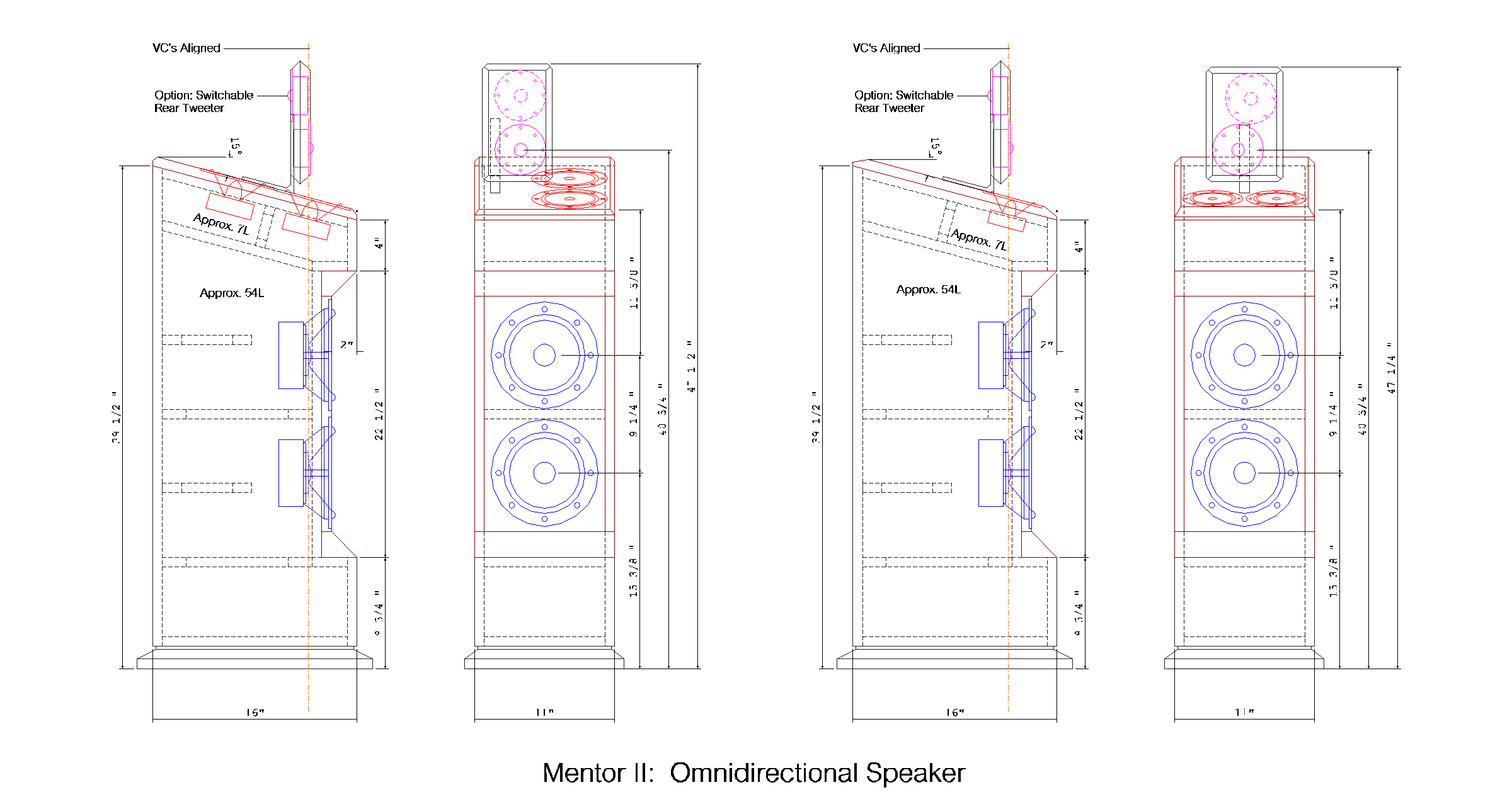

    Attached is an early plan with two options. The differences between the two plans are simply the orientation of the mids and the tweeter baffle. The dual front firing woofers are set back as needed to align their VC’s with the mids. How much they are set back is therefore dependent on the mid chosen. There is about 54L available for the woofers and 7L for the mids.
    I’m using a 15º sloped baffle for the upfiring mids. Mirage suggests that this is the optimum slope for a combination of imaging and omni sound, so I’m going to coop that idea. This will also mean you are not listening 90º to the driver axis, as is the case with the original Mentor, but at about 75º off axis.
    The tweeter baffle is direct firing, but I want to test the possibility of going dipole with the tweeter, either with a front and rear firing tweeter, or something like the Neo3 PDR that can be implemented dipole, as I understand it.
    To keep the box size down, I plan to use ¾” BB or mdf on the sides, with 1.5” baffles for the drivers, but lots of bracing and dampening to deaden the cabinets. I may change the design of the base to incorporate a place to put the crossover in, with an access to the outside.
    I’m far from thinking about finishing, but my first thoughts are either to use hardwood baffles over BB or mdf, with a anti-vibration material in between and a second type of hardwood veneer on the boxes (all natural, no stain for this guy), or to do a lighter hardwood veneer on the main box, but do a piano black finish on the woofer and mid baffles.

    Your Mentor 1 was a MUCH better design..
    The slanted baffle and in particular the dual radial driver approach is not a good idea. (think of the side combing it will generate.)
    To get "around" the problems of a an altered response depending on the driver's axis you will either need to use a small diameter driver OR lower the crossover point of the tweeter (..or both).
    My suggestion within your basic parameters:
    Radial driver (upward firing single driver) = Dayton RS52AN (small diameter DOME insuring no dispersion problems to as high as 2 kHz), good performance, good price. (..also it should be able to maintain spl quite a bit better than a cone driver AND it has a small acoustic center which means that imaging should be more precise.)
    Tweeter.. we want physical offset BUT we have a problem with aesthetics for a tweeter that resides ABOVE the radial driver. Additionally we have a problem with using a tweeter at lower freq.s because of the increased excursion. Solution: Use Zaph's Seas 27TDFC in the modified waveguide below the tweeter. If you want you can simply add another tweeter on the rear of the baffle in the same position to achieve a dipole character (..reversing the phase for that driver of course).
    For the midbasses - not terribly critical.. i.e. there are lots of choices here.
    The baffle should have some "tilt" to it - say 5-10 degrees.. and for the sake of aesthetics (and non parallel sides), I'd make all the side panels have that same "rake" (rather like a small obelisk but without the pyramid on top). This commercial design has the tweeter (though non-waveguide loaded) at the bottom:

        Hi Scott,
        Thanks for the feedback.
        I'm not sure I understand why you think the sloped baffle is a bad idea. This is what Mirage is doing on their new OMD-28 speaker.
        FWIW, Absolute Sound did a review of the OMD-28 and gave it very high praise. Acording to the review, Mirage claims that the 15º slope directs the rear wave more upward on the back wall, allowing the front output to open more fully toward the listening area and also improves imaging. Accorging to Mirage, this puts about 30% of the drivers output toward the listening area, with about 70% off side and rear wall surfaces, which they also claim is a ratio which closely mimics the characteristics of live music.
        Mirage OMD-28

                Hey Dan,
                A few thoughts about omni part deux.....
                An upfiring mid seems fine as you've had good luck with that. I agree with the earlier poster that 2 mids may create more problems than they solve.
                If you want to cross to the woofers at 4-500 (should be fine with a single small-cone mid), I'd fire one woofer forward and one back to keep the omni pattern.
                Likewise with the tweeters, I'd experiment with two firing front and back in phase to keep the omni radiation pattern. A dipole tweet will put the tweeter's power response down 5dB compared to the mid and woofers and a horn/waveguide will make it even worse.

                                                Here is another conceptual plan.
                                                It uses the centrally located up and down firing RS225 bass bin concept. In order to get more spl out of the mid (and less omni dispersion as a result) I', showing the tweeter baffle oriented over the RS52 dome with a circular area drilled out, sort of like the BeoLab omni speaker. This should redirect a lot more sound forward and less off the back wall. The tweeter baffle also acts as a partial baffle for the RS52. The rear facing tweeter, when switched on, could help to round out the omni effect at the upper end.
                                                I think I could build the tweeter baffle without too much trouble. I'd start by glueing up the 2-layer tweeter baffle first. Then I would clamp a couple more 3/4 pieces of scarp mdf to it. The I would drill a 2 1/8"-2 1/4" hole at an angle through the bottom of the baffle and scap pieces until th hole exits from the 2 layers on the glued up tweeter baffle.
                                                What kind of problems might occur from a diffraction or resonce standpoint I can't predict until I try it and take measurements.
                                                If anyone has any thoughts on this, I"d sure love to hear them!

                                                      I think I may need to step back and try to determine what will drive other decisions on this project. Perhaps it is to make every driver as close to omni performance as possible, or perhaps it is to utilize a waveguide tweeter for better power responce and crossover transition with the mid, or perhaps it is time (VC) alignment. This might make other decisions clearer. Right now I think there are too many variables I'm trying to juggle up in the air. :E
                                                      Alternatively I might want to start with one section, say the bass section. If I were to study it further and determine what type of aligment I wanted to use, it would help make further decisions on the mid(s) and tweeter more clear. Candidates might be up and down firing (omni) away from each other, up and down firing (omni) toward each other, driect firing front, front and rear firing (sort of omni or dipole), etc.
                                                      For example, let's say I go back to the up and downfiring woofer idea and use the model in the plans I have already done with them firing at each other. I can then study whether they should be offset in the baffle left to right or centered and front to back or centered. Once this is done and say I want to align VC's, that would allow only certain solutions for the mid(s) and tweeter(s).
                                                      Does that kind of approach make sense?
                                                      Dan N.

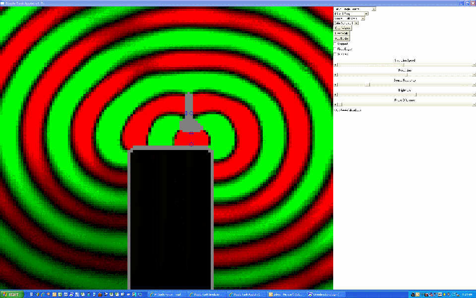

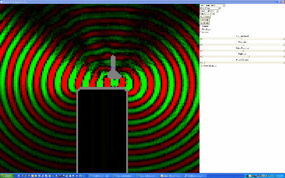

                                                          • 1456
                                                          What I want to do is create an omni that is an improvment on the first design. The first priority is sound quality improvement (that's oringinal ) and secondly in appearance/size. I'd like it to be a 3way without a sub built in. The other goals I listed at the start of the thread were intended to get the above things accomplished. I've sort of backed off the one about front firing woofers, though.
                                                          I'm skeptical that any single driver below 94db will provide enough output in an up or down firing scenario. That includes the RS52, though I have one I will test at some point to see what it is capable of at 90º off axis. I believe the traditional cone drivers used in most DIY products for midranges will have to be doubled up in an omni, which presents a whole lot of challenges and is the reason for the top box in the original design. I'm still hoping to avoid the top box scenario.
                                                          Potential answers I see are:
                                                          1) High effeciency Pro drivers
                                                          2) Deflection/redirection of some of the omni energy toward the listening area
                                                          3) Some creative arrangement of dual drivers

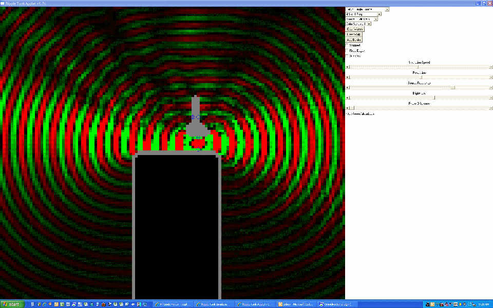

                                                          To that end, and it's probably a crazy idea, but what about two RS52's mounted face to face, something like the attached plans?
                                                          Also attached are some ripple tank studies at mid-low, mid, and mid-high frequencies. Unfortunately, I can't tell from the site what those frequencies are. They simply have sliding scale to set them.

                                                            • 1456
                                                            Ok, I decided to take a step back and do some rethinking on what my goals are. Here is my current thinking:
                                                            1) An omnidirectional, direct firing hybrid like the original with an extended omni midrange, maybe with a switchable dipole tweeter implementation.
                                                            2) A little more attractive design aesthetically, with higher SAF, a smaller front footprint.
                                                            3) No subwoofer included this time, instead with sealed woofers rolling off around 50hz.
                                                            4) Consider a crossover with lower order slopes and crossover points that don't push the drivers too hard. Entirely passive crossover.
                                                            5) Extending the omni coverage up higher in frequency by higher mid to tweeter crossover and possibly lower order slopes in a 3way design.
                                                            6) Equivalent or increased efficiency, but possibly higher output without strain on drivers.
                                                            7) Ability to include two drivers of each type if needed for efficient output
                                                            8 ) Possible use of a waveguide on the tweeter (and a rear firing tweeter opposite) for better crossover transition and controlled directivity though the crossover.
                                                            9) Time alignment of the drivers at the listening point (aprox. 11'-12').
                                                            I have gone back to the drawing board with these goals in mind. I realized that I was in error thinking the drivers needed to be veritcally alinged when they actually need to be on a curve relative to the listening distance and ear height. It looks like I have to keep the top box concept of the original to have the flexibility to meet goal 7. Attached is a new concept plan. The midrange drivers are at ear height, putting the tweeters 6" above. I'm initially thinking that the dome midrange (RS52) might work better in this configuration, because they might not introduce the additional complication of the driver cavities themselves when drivers firing at one another. I show a dome tweeter in the plans, but I'm thinking a ring radiator might be better with the waveguide, based on what I've read recently.
                                                            I'm looking for feedback. Not so much on the aesthetics, but on the design issues. What am I doing wrong? What am I doing right? What am I missing? Anything else I should consider?
                                                            Thanks! :T
Name:	Omnidirectional v2g_03-07-07.gif
                                                            Last edited by theSven; 03 August 2023, 17:21 Thursday. Reason: Update image location
                                                            Dan N.
                                                            • joecarrow
                                                              • 754
                                                              I think a really important thing at this point is to just do that measurement of the RS52 at 90 degrees. It would answer a lot of questions.
                                                              Also, taking a step back is a really good idea- I often find that it can rescue a design that's gone down the wrong path or been painted into a corner. Just keep in mind that in your new research you may quickly learn things that will change your assumptions and priorities- those are the things you want to learn first.
                                                              It's probably a good idea to figure out the acoustic side of this before worrying too much about aesthetics.
                                                              -Joe Carrow

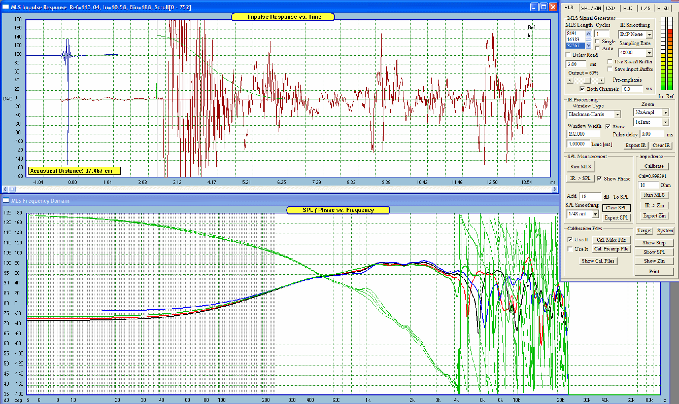

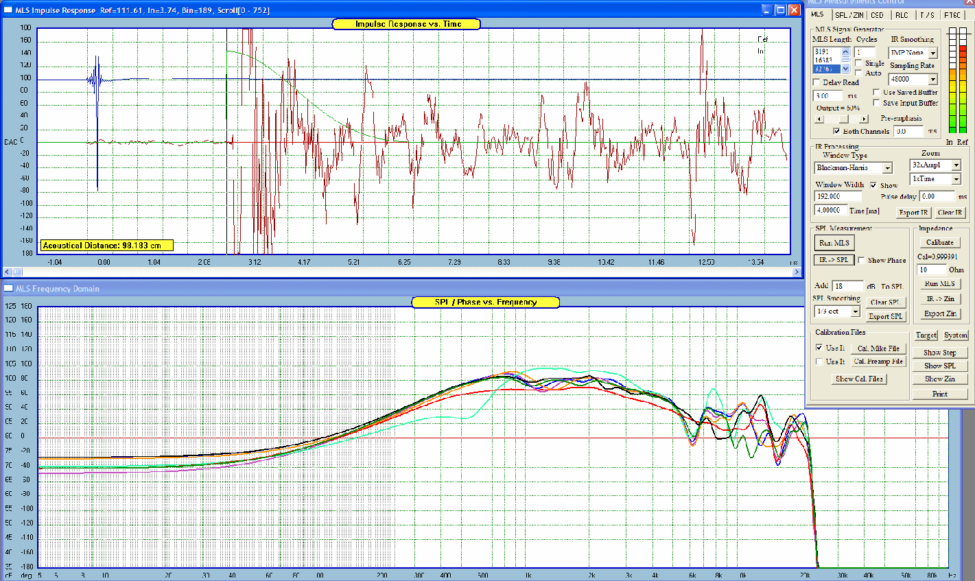

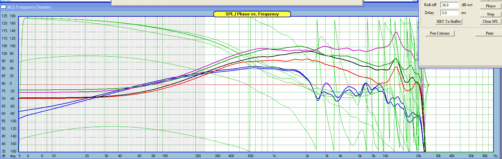

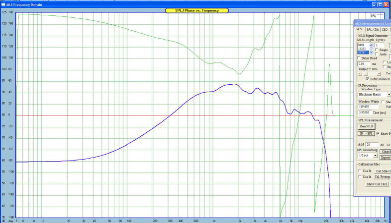

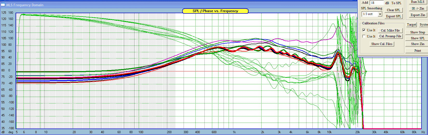

                                                                  • 1456

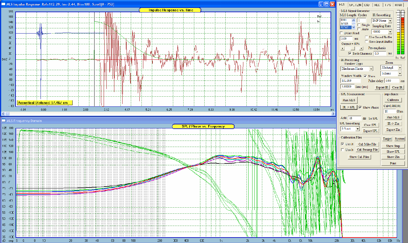

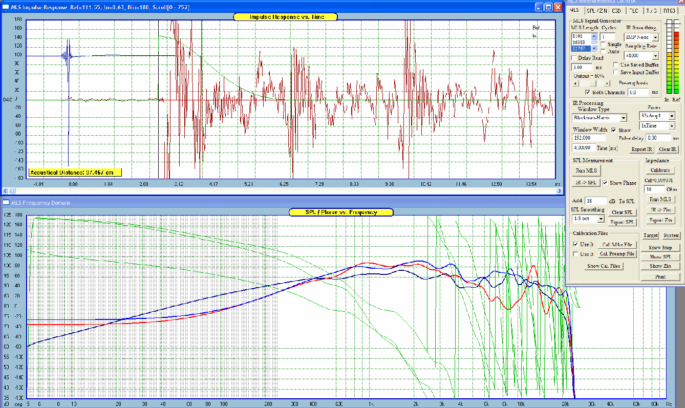

                                                                  I ran some prelim measurements tonight. I used a cardboard box and mounted the RS52 on the end. The measurements were taken with a 4ms gated window, so the FR is only good down to about 500-600hz or so. Measurements were at 1m distance at the driver height. The first graph below includes the following:
                                                                  Fine Lines (all meaurements on the listening axis):
                                                                  Red- baffle facing straight up
                                                                  Black- baffle tilted forward 15º
                                                                  Blue- baffle tilted forward 30º
                                                                  Green- baffle tilted forward 45º
                                                                  Purple- baffle tilted 90º (normal front firing)
                                                                  Heavy Lines (all measurements 90º off axis)
                                                                  *Green- baffle tilted forward 45º
                                                                  *The green was taken first and after looking at the roughness, I thought I might be getting some reflection off an adjacent TV, so I moved the box a bit further away for the other. The rest of them tracked very closely to one another and the rougness is probably diffraction off the square edges of the box.
                                                                  I'm not sure what to make of these, except a few things. There is a definite drop off on FR of around 8db from direct firing to full up firing. That seems to indicate that two RS52's would be needed in the upfiring position to get similar response to a single direct firing RS52.
                                                                  You can also see how the direct firing RS52 is pretty flat from 600hz out to 10khz. The 90º upfiring FR is pretty flat from about 500 to 2500, where it gently rolls off about 10db at 8khz. The 15º, 30º and 45º forward sloped baffles generally follow the same pattern as the 90º up firing, but with higher spl. The direct firing and 45º sloped baffle track fairly closely out to about 2.5Khz, where the 45º begins to fall off and the direct firing remains flat.
                                                                  The heavy plots, all 90º to the listening axis track very closely to one another regardless of the baffle slope, so off axis performance may not be effected much be the baffle slope. It seems to me that this indicates that you can slope the baffle forward from upfiring and not effect the off axis response, at least out to 90º. I will have take some measurements behind with from behind the baffle to see what reduction in FR there would be off the wall behind the omni speaker as the baffle is sloped forward from upfiring. I assume the amount of slope with reduce the omni effect as it is increased.
                                                                  I'm guessing I will need to crossover to the tweeter in the 2-3khz range and to the woofers in the 700-800hz range.

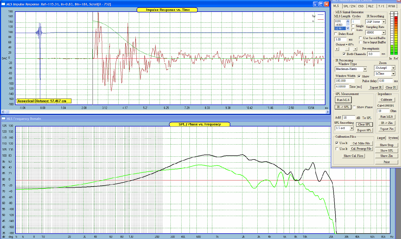

                                                                  Here is the surprise. The second graph is a shows the FR plots of 2 different single RS180s at 90º upfiring. The surprise is that a single RS180 firing up is about 5db below a single RS52 firing up. Unless I'm missing something, that would suggest that a single RS52 firing up would perform at about the same spl as two RS180's firing up. The single RS52, sloped 15º forward is about 8db above a single RS180. I did not include the RS52 on the 30º sloped baffle in this plot, but if you compare to the other graph (blue line), you can see that the 30º sloped baffle is about 11db higher than a single RS180.
                                                                  My assumption at this point is that 1 RS52, firing up is going to give a similar spl as two RS180's but extend the upper end another 1-1.5khz. and allow a flatter crossover slope between it and the tweeter. If I use a forward sloped baffle in the 15º to 30º range, I might be able to even pick up some several db over two RS180's. That said, it stall has to be matched with the two RS225's and the direct firing tweeter. I'm more encouraged about the possibility of a single RS52 doing the job.
                                                                  I'd sure appreciate anyone else's take on what these measurements indicate to them. Anyone willing to share their insights?

                                                                      To keep things cheap I'd still go for the MCM waveguide and use a HiVi K1 tweeter instead (perhaps X2 for dipole radiation or maybe even bipole radiation as long as the waveguide keeps any side combing well down in spl's).
                                                                      Again, consider the formula I mentioned previously with the waveguide BELOW the omni mid. Perhaps with a shape similar to this:
                                                                      What you have proposed via PDF - will have FAR less spousal approval than your previous design. Additionally, its also a LOT more complex, in ALL respects (..particularly the build process).

                                                                        I did some more testing of the RS52 this weekend. I first tried it with the 30º sloped baffle with various vertical tweeter baffle configurations, like shown in the last plan I posted. The results were not encouraging. There were too many interactions with the tweeter baffle.
                                                                        So, I decided to go back to the drawing board again and try a box/baffle placed directly above the RS52 as shown in the plan attached. I figured that it worked in my original design, so why abandon it. It seems that the FR is directly affected by how high above the driver the box/baffle is placed. I assume the FR is strongly affected by the distance the baffle is away from the driver. The FR is actually boosted some by a baffle placed above it and the closer the baffle, the more the boost. Also, the closer the baffle the higher in frequency that the driver is extended before significant anomalies show up(see the first graph below). The black is the up firing RS52 with no baffle above it. The red is with the baffle placed above the RS52, about 1.25”. You can see that the baffle provided a 3-4db boost in FR which starts to depart at about 600hz up to about 800hz out to about 6khz. I tested heights from 1” to 2” in 1/8” to ¼” increments in order to understand what effects baffle height had on the FR. The second plot shows the FR of various heights from 1” to 1.75”. I also tested the baffle at various positions front to back over the RS52 and side to side. The front to back positioning made a significant difference, but the side to side made little difference when measuring on axis.
                                                                        Up to this point I had been using a board about 6”x8” placed above the RS52. After an initial round of tests, I decided to rough out a partial box similar to the one in the design below and retested. The results led me to the combination of having the tweeter baffle edge lined up with the front edged of the hexagrid on the RS52 and 1” above it. This seemed to provide the best overall FR, with the most extension and/or the smoother roll off with fewer oddities high in the FR.
                                                                        I also tested that position at 0, 30, 45, 60, 90, and 180 off axis (see the third graph). The red line is the up firing RS52 with no baffle and the black line the on axis with tweeter baffle above for reference. The off axis plots tracked with one another quite well, except for the one at 180º from the listening axis. All but the on axis have a 10db or so dip at around 6khz, but I would think that would be comfortably attenuated by the crossover, which I expect to be in the 1900-2100hz range.
                                                                        Finally, I tested the baffle at various mike heights. I did not measure the angles, but simply raised the mike in 4” increments from 20” through 36”, with the baffle height being at 28” (I’m using a solid cardboard box for the testing for now). In graph 4, you can see the up firing RS52 with no baffle in black for reference. The red plot was at 28” and the others 4” and 8” above or below that. The spl increased as you went higher and decreased as you went lower, but the responses tracked on another quite well and the box has sharp edges, so they could be better with a chamfered or rounded over baffle.
                                                                        I think this design concept has possibilities and I may pursue it further, subject to feedback, if I get any. I’m thinking of crossovers in the range of 600-700hz and 1900-2100hz. The tweeter is undecided at this time. I’m going to stick with the RS225’s for the woofers and the single RS52 for the mid. I will include a plot of a single RS225 in my next post. I hope to use to use a less steep filter between the woofer and the mid, but expect to need a very steep filter on the top end of the RS52, due to the higher CTC I have between it and the wave-guided tweeter.
                                                                        I hope this design should have a higher SAF than the others I’ve come up with. It ends up at least 5” shorter than the original omni project and much narrower throughout from the front. The sloped sides and front will make for a difficult build, though, since so many parts have their own unique dimensions and angles. The drivers VC’s are all time aligned on an arc from the listening position to maintain time alignment.
                                                                        Some questions I still have are what tweeter? Would a ring radiator be better with the WG as reported in one of the articles linked to the WG thread? If so, which is better, a 19mm or 25mm, with the 19mm having a much wider dispersion than the 25mm? Is wider dispersion a good thing for a WG or not?
                                                                        What is the optimum distance between the 2 RS225’s? I may have to build test boxes and take measurements to determine this. This may not be critical at all since I’m not going to push it too high.
                                                                        What are the optimum crossover points, slopes and types for this configuration, given the FR of the RS225 and RS52 and the WG and rear firing tweeters?
                                                                        Is there any benefit to the rear tweeter being WG loaded as well? Should they be wired in phase or not?
                                                                        What else am I missing and need to consider? Anyone have any thoughts?
Name:	RS52baffle experiment_no1-compare-nobaffle.gif
Name:	RS52baffle experiment_heights_1in to 1-75in.gif
Name:	RS52baffle experiment_no1_mikeht-4in-incrs.gif

                                                                          Here is the FR plot of the single upfiring RS225. The RS225 is in green. Note I used a 4ms gated window, so the response is not much good below 500-600hz (same with the rest of these measurements). The black is the favored FR from the RS52 with tweeter baffle above.
                                                                          You can see that if you add in the second Rs225, the response should be close to matching the RS52, maybe a little below it. However, there may be some boost from the close baffles on the RS225, I don't know yet.
                                                                          Last edited by theSven; 03 August 2023, 17:26 Thursday. Reason: Update image location

                                                                            Its very complex.. and it prob. won't be as pleasing to any given spouse (in comparison to the original), BUT I think it looks great and the basic design gets a :T

                                                                              Very interesting. Doesn't a waveguide tweeter have more controlled directivity in the lower octaves, compared to a regular tweeter? I think this is a good thing for matching the directivity of a tweeter to a larger midwoofer, since the midwoofer would probably be beaming a bit by the crossover frequency.
                                                                              In your case, won't this make a sharp change from omnidirectional mid to directional tweeter?

                                                                                Probably true about the general SAF, however mine likes it better! :W She's not that crazy about the original, preferring my NaO Mini's instead, from an aesthetics standpoint, that is.
                                                                                This is also preliminary. It could end up with speaker fabric covering the middle gap if I can figure out a goo way to do it and have it removeable. I want the whole thing to divide into 3 parts for easy moving. I've got a bad lower back (had back surgery back in July) and I no longer try to haul heavy stuff around, so portability is something I'm sensitive to. Heck, maybe I can come up with a hood to go over the entire top kind of like the old Ohm's! That would probably up the SAF.

                                                                                  You may be right. That's why I was looking for feedback from the experts on the combination of omni and WG/rear firing tweeter.
                                                                                  My thinking was by having the rear firing tweeter, you might not have that sharp transition, but rather, it could continue a more omni-like sound, the degree of which seems to be dependent upon if they are bipole or dipole tweeters. I'd like to test both. Maybe they could be made switchable, I don't know. :blink:
                                                                                  From what little I understand about bipole's, they do approximate an omnidirectional soundfield (I've never heard one), so theoretically it seems that would be a good match in power response. Dipole, on the other hand has a similar enveloping soundfield, but with the nulls at the sides, which reduce side wall reflections (may be a good thing?). I'm unsure how omni and dipole radiation will match up in power response.
                                                                                  I'm also not sure if the WG helps or hurts in the bipole scenario. I hope some of the Wave Guide experts read this and can comment. It does help in the design by allowing all the drivers VC's to be time aligned while accomodating the optimum placement of the baffle above the RS52 for it's best FR, at least from the tests I've done so far.
                                                                                  What do you think?

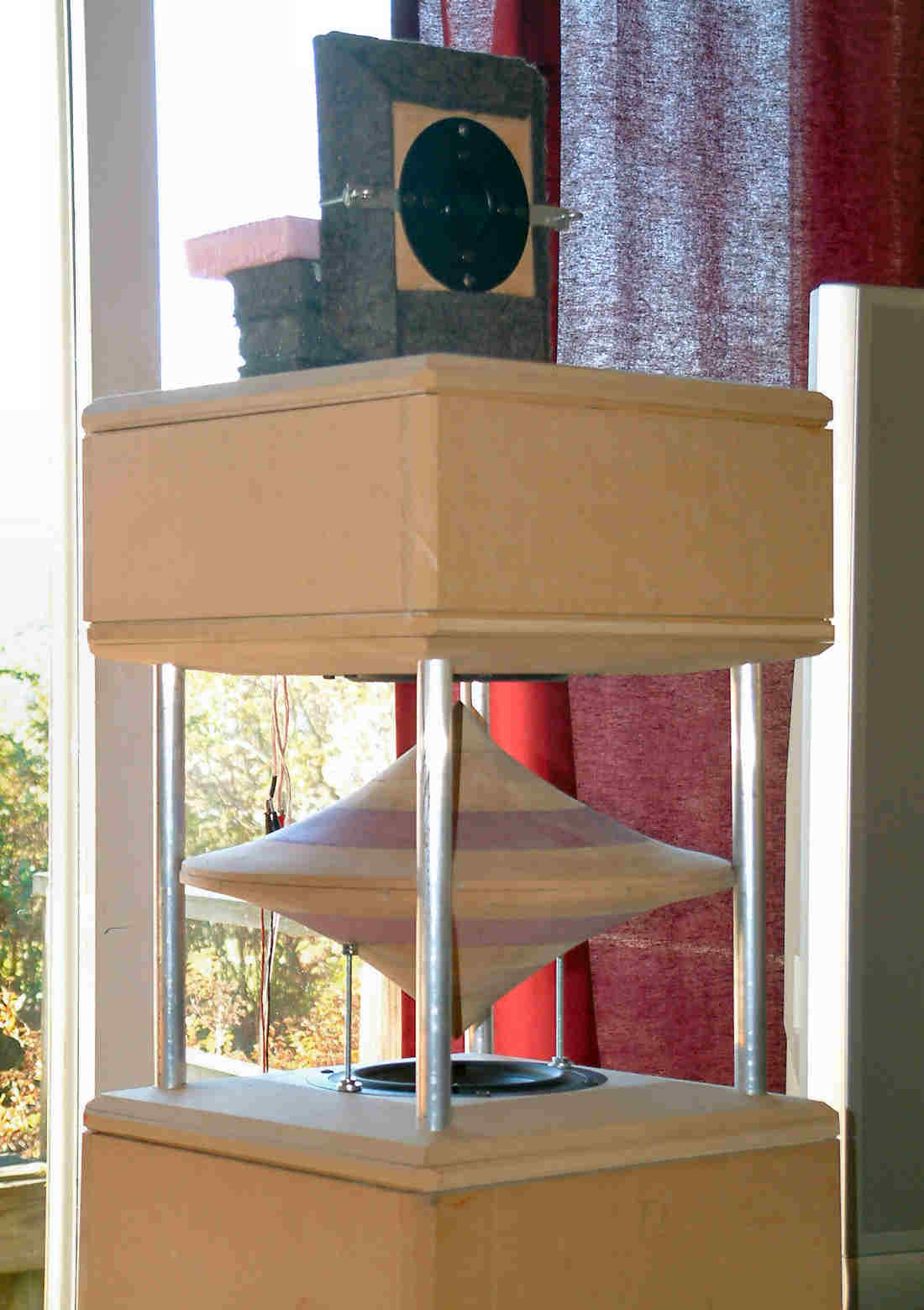

                                                                                        Here is an interesting tidbit. I had some Duevel-like concave cone diffusers made for the original omniproject. I very roughly tested one with the RS52 and with an RS150 by just propping them up rounghly over the drivers.
                                                                                        While this diffuser did not do much with the RS180 in the original project, it is interesting to see what it does to the FR of the RS52 and RS150.
                                                                                        The plot below shows the RS52 with the best response I could get with the box above it (red) and the FR with the duevel-like diffuser above it (light blue). Even though it has a notch at 4.5k, look how much flatter and extended the RS52 is with the diffuser than without it. The dark blue line is a single RS150 upfiring into the same diffuser. Unfortunately, I did not save a plot of the RS150 upfiring without the diffuser. As I recall, it had a much earlier, steeper drop off.
Name:	RS52and RS150 duevel diffuser-RS52baffle exp1.gif
                                                                                        Last edited by theSven; 03 August 2023, 17:27 Thursday. Reason: Update image location
