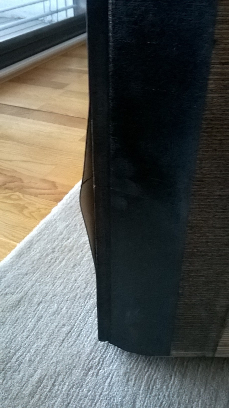

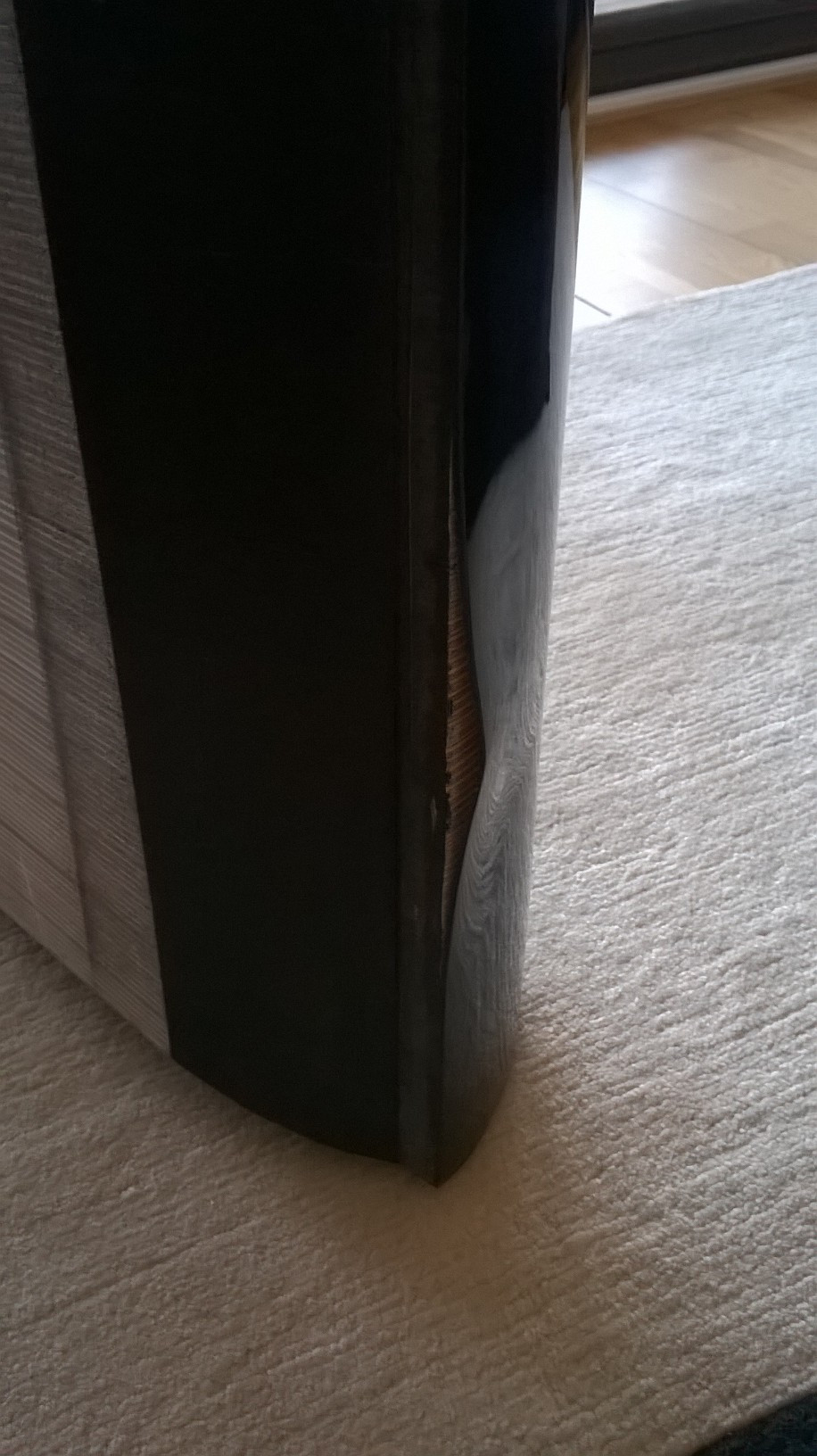

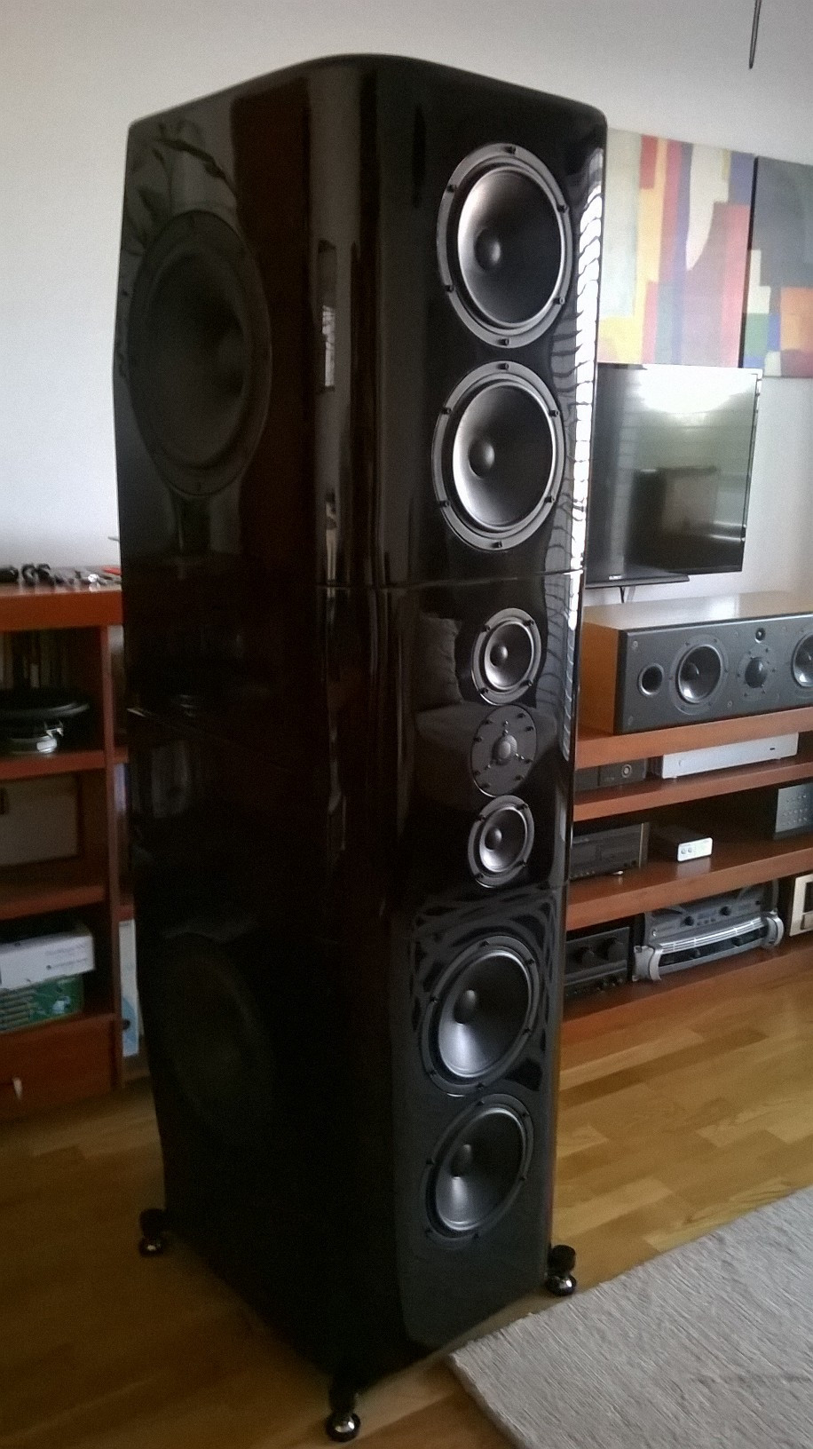

                        Hello my friends.
                        Some of you may wonder why I never posted pictures of my speakers after painting. Well the reason is that I have very bad news...
                        First of all I don't know what happened with my account in Photo-bucket as it doesn't recognize my user anymore so I'm afraid all the pictures I've posted before are gone. I apologize for that but I didn't know accounts could expire or be deleted just like that.
                        After 1 year and 3 months of waiting my carpenter/painter delivered me two of the three remaining boxes. To my horror and chock after a few days this is what happened to the smaller box... :cry:

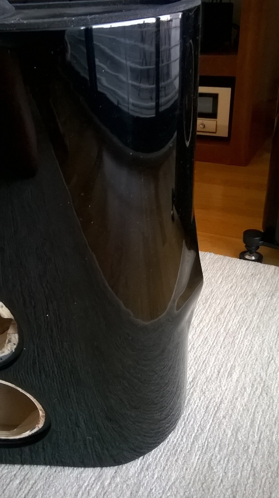

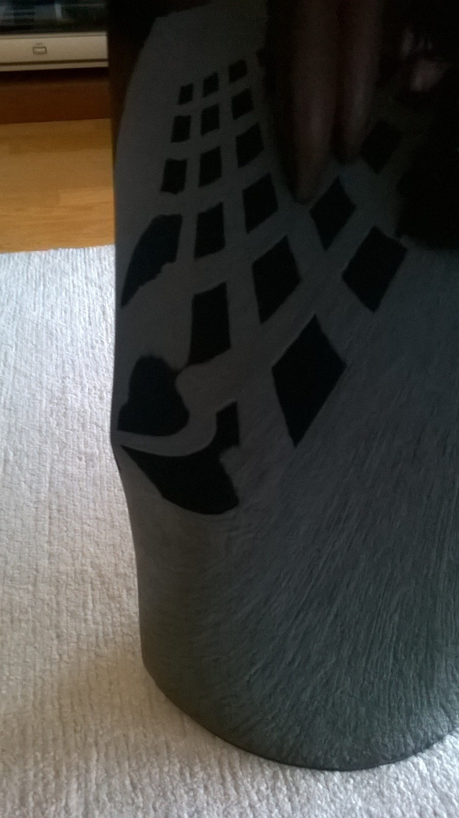

                          What the heck is going on in that last pic? Is the beffle vaporizing?
                            Hum?

                              That's really pity that the bad luck keeps haunting you with these 'nice beasts'. Might it be the indoor climate difference between the carpenters place and your that would cause the layer to loose moisture too fast and peel off like that. In past we've had similar issues with gray neutral gray paper glued to a composite back board. As long as those remained in Estonia there were no problems. But we shipped some to Taiwan and the higher moisture level there caused them to ripple bad in just few days.
                              • cochinada
                                • May 2014
                                • 661
                                #510
                                Thanks ergo. Let me explain some details of this nightmare so far. Somewhere in May or June I think, he told me he had finished painting but when he tried to assemble the boxes they didn't fit anymore as the middle box, the one with the issue now, somehow had expanded about 4mm. Later he explained me that it caught some drops of water in his paint shop that came from a leak in the roof and this was probably the reason. Now, how unfortunate is that? Then he decided to let them dry for a very long period hoping it would shrink again and so it did after more than a month just sitting quietly. Of course this meant a new painting again. To make things more challenging the 1st painter quit and so did the new one after a while. I was waiting of course... Since August begun we had a heat wave here in Portugal with record breaking temperatures for about 5 consecutive days relentlessly above 44ºC or 111ºF. Now it is not so hot but still it's above 30ºC. In my house it's probably 26ºC to 28ºC but his paint shop is certainly hotter.
                                  I think it's just reflections from the floor showing up near the bottom two upper bass drivers.

                                    I'm little bummed when i see as nice loudspeakers as this with so much issues regarding that last step - finish. You are very patient fellow.
                                    I don't think that there is a solution that will work in long term in such high temperature and moist extremes and with cabinets that are built the way yours are. With so much joints there are just too many weak spots. I've watched guys here closing the wood by dipping it in some resin that is heat activated, and forcing the resin into the wood by vacuum. Then they'd put the wooden parts in an oven to activate the resin. Finished product looks like a brick and is quite stable.
                                    Something like this:
                                    If you find someone with large enough vacuum chamber and autoclave, anything is possible. Though that would require pealing of every layer of coating and filler.
                                      Yes. It is the reflex of my acoustic carpet.
