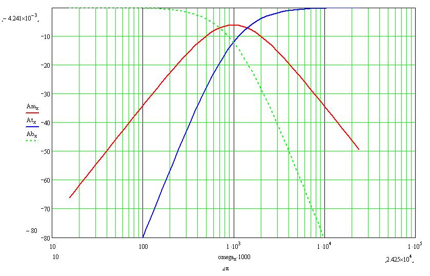

    Great link on the duelund filter. I am absolutly fascinated. It has been along time since I have done any s-domain math.
    Is this a typical process for designing a 3-way type crossover?
    Any more references to this type of work? I would really love to become more well versed.
    There are more slight variations on the theme, but nothing I've come across substantially different.
    This method is interesting and sound because it treats the filter design for three way as a whole, not as an attempt to glue a pair of two way crossovers together. This would be the way to do it in the old days, as Steen describes.
    Now, one might implement the desired transfer function in MathCAD, import the acoustical targets into LspCAD, then develop and fit the crossover using your measured driver data.

              Reading through, the "a" value was a term used as the denomonator of the damping factor. His first choice being a=2 or a .5 damping factor, critically damped.
              I noticed earlier in the thread that the dark master suggest another value, a=2.82. Damping of about .35. Now I'm sure there are some other considerations that will change the overall response of the system. However, I'm not sure what those would be. I'm sure the volume and driver mechanical Q would effect this??
              I wasn't sure about Fc, his examples use only one angular variable w. I assume that it can't be only 1 frequency for the entire network, but how do the substitutions work. The numerator of the equation is evidently a term for each w of the x-way system, but which w goes in the deonmonator for D1 and D2 equations?

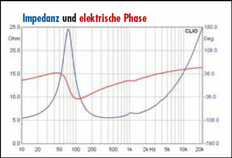

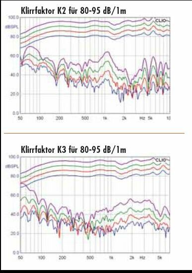

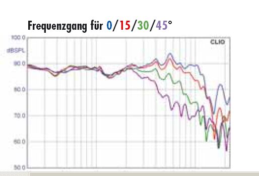

                            Here are some results....MCH002
                                    jw (actually, omega, not w), is the frequency variable in radians in the S plane; to calcuate the transfer function in MathCAD or Maple, you'd define a range variable to index a vector, I usualy use a simple ratio function with exponential terms to get a certain number of data points spaced in each octave. I'll post this after I get back from my business trip to Austria, after the Christmas holidays. I want to transfer this to Maple, but maybe I'll just do this in MathCAD again.

                                      I believe the one of my old nemesis from Dagobah would say something along the lines of...
                                      "Do not try, it is doing you must.."
                                      It is apparent that Seas does not yet understand that concept.
                                                      Yest dark one. I realize the use of j(omega), just used w as a substitue for the curvy greek numeral.
                                                      The real question is if the omega is the same variable throughout the transfer function. It was mentioned that the Fc's would change, and omega being (2piFc), would change. So the question is, What is Fc for a three way polynomial numerator if each term is meant to represent T, M, or W? Also what is used for omega in the denominator? If there is only 1 Fc for the whole system then again what does Fc mean? Is it the split between the T and M because they are the only numerators with omega terms? or is it the middle of the midrange coverage w/ the filters spread a certain distance apart based on "a"?
                                                      I'm sure I'm missing somthing obvious.
                                                      edit for learning
                                                      I went into MathCAD and figured out some of the equations, along with the selection of omega steps in the array calculations. Fc looks to be the center of the midrange. So there is only 1 Fc. I think I've cleared it up somewhat. If the plots look like what should be expected, I'd be happy.
                                                        • 15297
                                                        Fc is the center frequency- every thing else derives from that and the gain/damping coefficient "a". "a" sets the corner frequency spread, Q, and midrange level. Sort of like a unified field theory, really, as the mathematical relationship of the HP and LP are all with respect to the center frequency and "a".

                                                                                        Let us consider the details of this Duelund transfer function calculation.
                                                                                        The Sith still use the old ways, revering the original creation of MathCAD under the primitive Disk Operating System used prior to the development of windowing operating environments.
                                                                                        The basic transfer function can be calculated normalized to one radian; first, an index and indexed range variable for frequency must be defined:

                                                                                        The derivation is explained in Steen Duelunds papers available on the Hypernet. Note that a wide range of variation in net transfer functions for a three way are obtained with varying values of the damping coefficient aleph; if this value is reduced to the square root of 2, the midrange section disappears completely and what is left is an LR-4 two way.
                                                                                        Next, using the absolue magnitude function and converting to dB (taking the log of the transfer function and multiplying by 20), the individual transfer functions are plotted, in this case using an aleph value = 2X the square root of 2. Note that the LP and HP networks show an ultimate slope of 24dB/octave, while the midrange is 12 dB/octave.

                                                                                            • 1532
                                                                                            The interesting properties of the Duelund approach to synthesizing the three way filter at once are several-
                                                                                            • The combined transfer function sums to unity across the frequency spectrum as does a simpler two way crossover, and starts from only one equation
                                                                                            • The transfer function is set by the center frequency Fc and the coefficient damping factor, aleph, and can realize a range of transfer functions with wider or narrower spread of the corner frequencies for LP and HP and midrange level just by adjusting aleph
                                                                                            • If aleph is reduced down to the square root of 2 (~1.414), the midrange portion by that point dissappears, leaving an LR-4 two way.
                                                                                            • For aleph = 2 or more, the step response has no ringing- fast transient settling.
                                                                                            • For aleph = square root of 3, the transfer function is a three way Bessel with the HP, LP, and peak of midrange combining at - 9 dB; midrange driver efficiency and output level requirements are the least, making the smaller wide range drivers (Tangband, HiVi, etc) suitable for a midrange filler while keeping frequency requirements reasonable for woofer and tweeter with Fc of 1400-1800 Hz.
                                                                                            • The complete transefer function from low to high exhibits only one phase rotation through the entire three way function, with lower group delay peaking than a single LR-4 two way.
                                                                                            • The midrange is wired out of phase to the woofer and tweeter (a minus sign in the complete expression of the numerator for the midrange)
                                                                                            • All three drivers are always in matching relative phase at any frequency, so the possibility of destructive interference or off axis lobing is minimized. This results in a reported sense of integration and not being able to identify sounds as coming from one driver or another
                                                                                            Note that there is a greater sense of driver overlap because the graphs are posted with a scale extending to -60 dB. I will post an example later with a more typical Y axis scale.
                                                                                            This is for another project in consideration with a dome midrangea and small form factor dome tweeter.
                                                                                            Note that the drivers are -6dB at the crossover frequency, not -3 dB as in most conventional crossovers. This may be adjusted to fill in the power response; it matters whether a BBC dip is preferred (better for most commercial program material), or something closer to flat power response, which could justify elevating the midragne level a couple more dB.
                                                                                            This suggests a two or three way switch control- "Presense".
