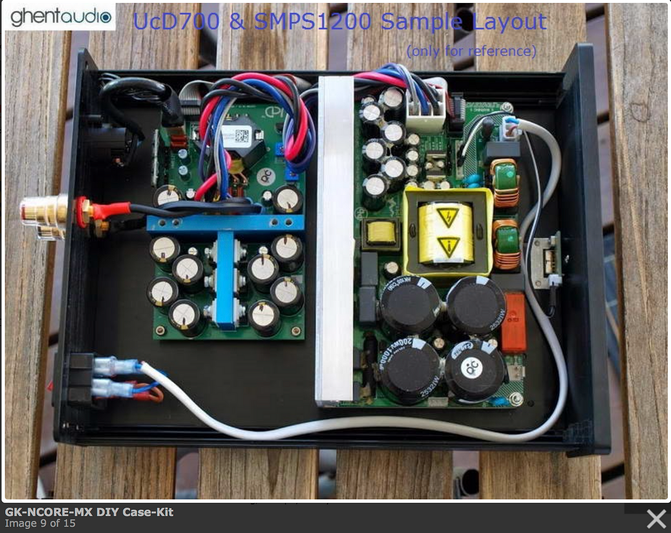

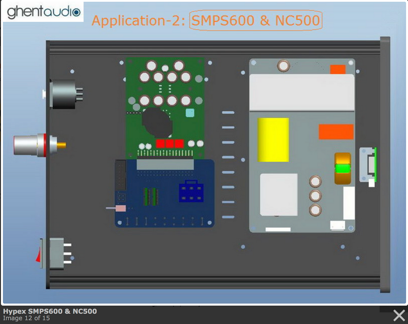

      Go have a look at this page on Ghent Audio- their "mono" chassis is adaptable to a lot of configurations, including NC500 modules and SMPS1200 as well as SMPS600.
      Click image for larger version  Name:	ghentaudio%20---%20NCore%20NC500%20_zpsj80ezzhs.png Views:	0 Size:	938.1 KB ID:	940021
Name:	ghentaudio%20---%20Hypex%20amp%20NCore%20NC400%20NC500%20NC1200%20UcD700%20Case-kit_zpsuuyybnze.png

        From the image you posted I see that ghentaudio is using the one I identified as a candidate, pin j5 pin 3 (Positive Unregulated Auxiliary Output Voltage (+21V)) and pin 5 (ground).
        So I will need to take the led down from 21V.
        For the 12V standby trigger I will have to split pin 5 (ground) so I can have one wire to the led (in front) and one to the standby jack (in the back).
        And I have to figure out some way of mounting both of them.

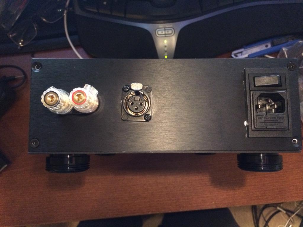

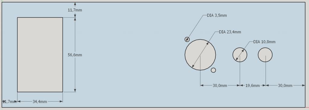

                Planned backplate. The plate is in 3mm aluminium. I will have to do the cutouts myself. I'm a bit unsure about the connector. i see now that having the fuse, switch and plug in one snap-in module might not be the best idea when it comes to how this affect the strength of the backplate. I'm a bit worried that it will twist when I make that large hole in it.
Name:	nc500 mono amp back panel.jpg
                And I will also need a 23,5mm drill as well as a 11mm drill. 11 should be no problem (I hope), but I will guess the 23.5 will have to be a 24mm. Will have to go out looking for those later today.

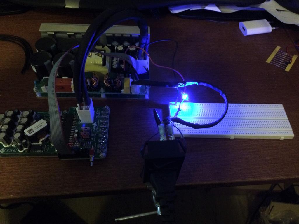

                  Blue led prototyping...
                  Jon's input was:
                  With regards to the power on LED, thing to remember is the need for a current limiting resistor- most LED’s are in the 3V range, except blue, which are around 4V; run it off 12V, and you need to have a series resistor to limit the current to the preferred range (5-10mA or so), so if it is a 12V source, then 12V - 4V = 8V, 8V/0.01=800 ohms, nearest standard value would be 820. There might be LED assemblies with a built in resistor
                  In my case I have a 21V source. The led are 3V/20mA.
                  That should mean that to run them on 10mA on a 21V source line I would need a 1800 ohms resistor (21V-3V = 18V, 18V/0.01 = 1800 ohms)
                  I guess I could regulate it up to 20mA if I would like a stronger light by using a 900 ohms resistor instead (21V-3V = 18V, 18V/0.02 = 900 ohms).
                  I guess I also could have two resistors with a switch to select which one to use, but I think I will start out with just one at 1800 ohms. After all it's just a prototype.
                  And guess what, I actually had a 1800 ohms resistor laying around :-)

                    Serendipity? But is it the preferred brightness for you? Often it may be too bright, in which case doubling the resistor value may do the trick.
                    BTW, you wouldn't believe how many circuits I put together and tested on protoboards like that back in the 70's. No SPICE, no computers, it was the only way to try things out...
                      [ATTACH=CONFIG]25008[/ATTACH]
                      Can you get hole punches? That would be a better way to do the large holes. I was using Greenlee punches back in the 60's when I was a kid working on amateur radio stuff- never used anything else since then.
                      http://www.all-spec.com/products/Gre...FUhcfgod7vcKSg
                        I had actually not heard about hole puncher for metal. Had to go over to You tube to find some diff
                        However, since this is just a prototype build I will use my dremel as well as drills to make the holes that I need.
                        Later on I will plan ahead and make sure that any holes needed is added when the case is ordered.
                        About the led, I'm not sure. I will make the led so that it points down to the ground, so no direct light will be visible when looking at the amp. That may cause me to need a bit more light then other equipment. So I will build a small board for mounting as it is now, and then I will consider it then.

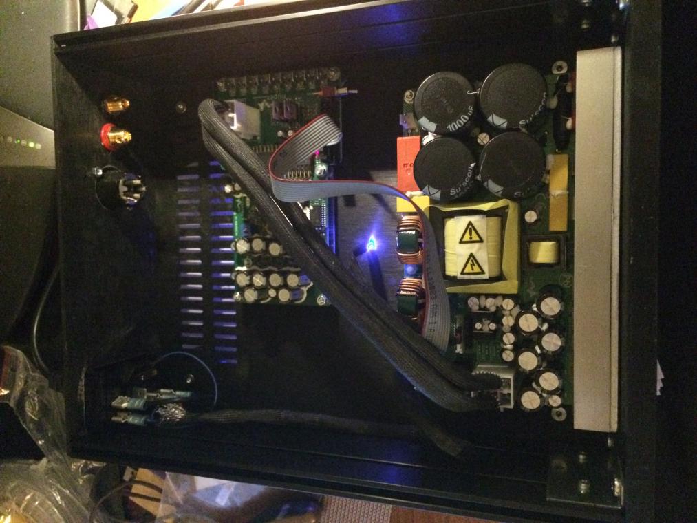

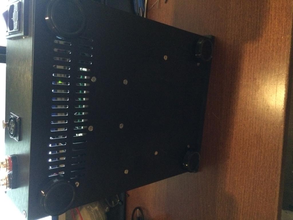

                              OK, it's getting somewhere now. I have made all the holes and both the SMPS, the NC500 and the adaptor board is now mounted to the chassie. Also the power plug/on-off switch/fuse is mounted(dont have the right fuse yet, so that is bypassed... ouch) as well as the XLR input and speaker output terminals.
                              XLR input and speaker output terminals are not connected yet. Also the blue led is mounted.
                              I do however have a issue. Please give me any input if you have, if not I will probably have to run this trough hypex.
                              When I power up the amp the first time it powers up just fine. It takes about 2-4 seconds from I turn the power switch to on before a relay clicks, the led turns on and it all looks OK. It can stand on for several minutes and everything continue to look the same.
                              However, if I turn it off, just waits a couple of seconds and then turn it back on it takes 2-4 seconds and the relay clicks, the led turns on and then after a short time (maybe 1/4 to 1 second) the relay clicks again and all leds goes off, indicating that the SMPS shuts down.
                              If I then wait for some minutes before I turn the power on again it will start normally again.
                              So, it seems like if I turn it back on again a short time after turning it off - it will shut down by some reason that I do not understand. That does not seem OK.
                              Oh, and another question. As you can see I have mounted the SMPS with the heat sink against the front plate. On some other builds, for example the one posted by Jon earlier in this thread, they have placed the heat sink between the SMPS and the NC500.
                              Is there anything that would cause one to be preferred over another? (My reason for mounting it up against the thick front panel would in effect cause the whole front panel to act as a heat sink).

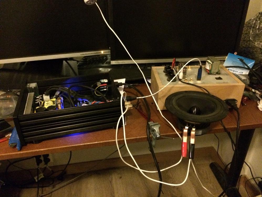

                                  And there is sound...
                                  Test setup (did not want to risk blowing up the ardents on my first attempt...).
                                  Dragged out a old tupe preamp and are using my phone as a source. For a long time I did not get ANY respons - until I figured oit that I had forgot to insert the plug from the xlr connection into the adaptor module ops:
                                  I have more info on the shutdown issue as well as some comments on the heatsink. More details and question about the prototype will come as well before I build the the next one.

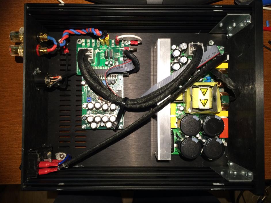

                                  Now this will get a try in the real setup 8O
                                    That's great, should be fun when you get to speaks.
                                    I think I would orientate more like the Ghent case example, power in on one side and output on the other. Make output cables as short as possible with nice tight twisted cables, although the Ghent cable looks like it could be done nicer. Not sure on twisting that ribbon cable. Is there an alternative to even using that ribbon, seems most computer setups do away with ribbon now.
ID:	861140Click image for larger version
ID:	861141Click image for larger version
ID:	861142Click image for larger version
ID:	861143Ai, ai, ai...

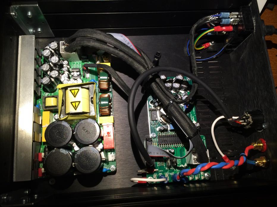

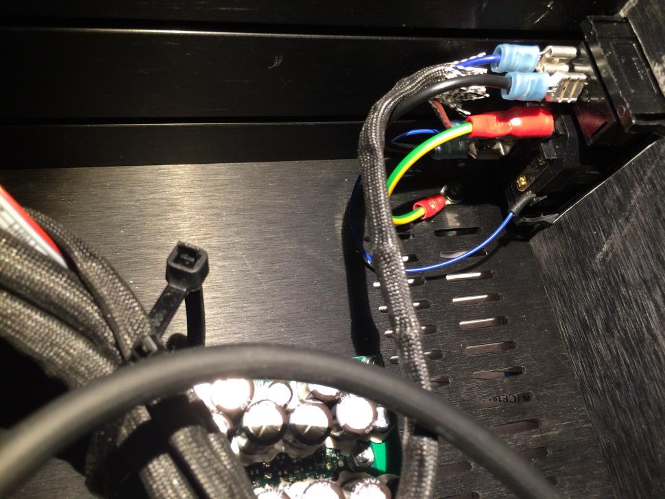

                                      I had a very low hum in the test setup - probably from the tube amp.
                                      Just to test I tried to disconnect safety earth to see if that had an effect on the background noice.
                                      Holy shit - that was noicy!
                                      It seems like I was able to disconnect the element fast enough - it does at least still play.
                                      What happens is that when I disconnect safty earth I get over 70V out of the speaker terminals. The terminals is isolated from the chassie, so this must mean that it is the amp that deliver this.
                                      And that happends, for some reason, when safty earth is disconnected.
                                      So, anyone has a glue about what might be going on?

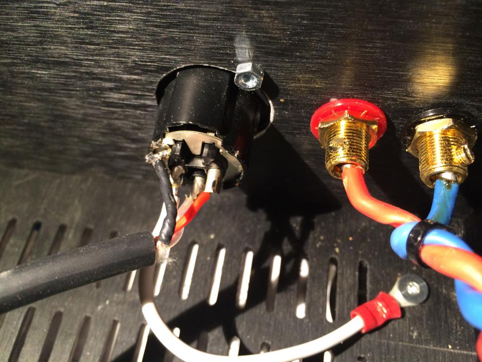

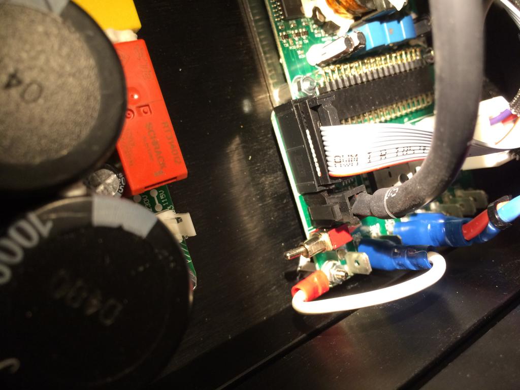

                                      I have the following ground connections in the amp:
                                      - from xlr input pin 1 and the chassie
                                      - from xlr internal cables screen to the chassie via the ground connector on the xlr socket
                                      - from the gnd faston plug on the adaptor board to ground via on of the connectors.
                                      - the screen on the internal cable is connecred to fnd on the connector board (through the 4-pins input connector).
                                      - from earth safty ground (power) to the chassie
                                      I'll attach some photos. Hopefully someone is able to see where I have done something wrong?
                                        • 16175
                                        It's likely a common mode problem- that is, a common signal voltage that appears relative to the amplifier signal ground to both input, because the ground is lifted when you disconnect the safety ground. An active balanced input can only reject so much, until the inputs of the op amp clips-
                                        This is the sort of thing I would normally trouble shoot using a scope and looking for a floating voltage. you may have current leakage from that heatsink assembly touching the chassis. Anodized aluminum is nominally an insulator, but it takes the right processing to make it a good insulator. One scratch, you get leakage current path.
                                        The insulation on the heatsink for the semiconductors looks quite well done. And the main metal bracket and heatsink of the SMPS1200 provide the necessary isolation for safety. BUT, I"m wondering about your tube preamp? For example, I would suggest doing another test using an inherently floating piece of gear (like an iPod, iPad, iPhone) as an audio source, and see if this works without issues. Then I would use a DVM or scope to look at the possible difference in ground potential between the tube preamp and the power amp with safety ground CONNECTED, nothing powered up. Your amp could be providing the path to ground when it has the safety ground connected, for leakage current in the ground path of the preamp. This has to be ruled out.
                                        Note, I don't usually directly connect pin one to chassis, but run it through a 50 ohm resistor and a 1 to 10nF high voltage cap. This provides RF shielding just find, but prevents low frequency AC current from flowing through the shield.
                                        Back in the 70's I did some jobs re-wiring studios and audio shops- it's amazing what kind of problems you can uncover with different equipment. Much better to put a higher impedance test load (such as 16 ohms or more) and always a meter or scope to monitor).

                                            Another thing to check is the actual grounds being made to the chassis- anodized aluminum has to be complete sanded off so that a solid electrical connection is made. Some of the chassis vendors go to specific trouble to prepare ground points with screw holes and anodizing masking, but it's still a good idea to use a little sand paper and check connectivity with a DVM (ohmmeter mode). The photo of your pin one connection to the chassis is very suspect- all I see is black anodizing under the terminal lug.
                                              What you do not see from the picture is that the holes has been drilled by me and that I have made recess for the screw head, so right benith the connector is bare aluminium.
                                              Anyway, I took your advice and used the multimeter to check the ohm between all ground connections and the chassie. All resultet in 0 ohm resistance, so the impression is that the connection is ok.
                                              OK, today I have tested quite a bit more. And I'm kindof lost. I'm actually unable to reproduce the issue today. I have tried about everything, but it's working just fine both on and off earth.
                                              I have tested with and without safty earth connected, not connected, driven from the tube amp and from the phoe. I'm noticing the following:
                                              - It works flawless with both solutions in all cases
                                              - The background hum I mentioned before is a attribute of the tube amp. It's unrelated to safty earth beeing connected or not (it's also only noticable if you are a few cm from the speaker element)
                                              For now I have 3 hypoteses for what might have caused the behaviour I observed yesterday.
                                              1) During testing today I did notice that if I turn off the tube preamp while the amp is still on I get some very high pop's (and I can see the element beeing pulled all the way down).
                                              So the hypothese is that I might have experienced something related to on/off attributes with the preamp.
                                              I do not have mutch belife in this hypothese as I mean the length of the observed period the problem occured was mutch longer.
                                              2) I had a temporary ugly fix where I used a thin wire instead of a fuse (I have got a real fuse now, 2.5A, slow). If that wire, after the power plug was moved around because I removed the safty earth, touched the chassie there would be a connection between safty earth and one pole. This would have made a extra connection between one of the pole and other earth that again may have caused very strange results. Any action of inserting/removing the power plug, connecting/disconnecting safty earth might have affected this and would explain that the error could have disappared today.
                                              3) There is some bad connection or errornous connection in the amp (other than 2) that occures or does not occure and that caused the issue. If this is the case that would mean that the issue might reoccure at any given time, probably blowing out any connected speakers.
                                              Hmm, I actually just now discovered something. If the amp is on, the balanced input cable is connected to the amp but not to anything else.
                                              Then I will hear noice from the speaker. Kindof a even pulse. If I move the cable around the noice differences in loudness from barly noticable to very easy to hear.
                                              Unblugging the cable from the amp or plugging it into the pre-amp causes the sound to disappare.
                                              The sound I got from the speaker yesterday was the same kind of pulse - just extremly mutch higher.
                                              That is just an observation, I actually have no idea what or even if, that means.
                                              My problem right now is that the amp seems to be working great. However, when that incident occure, there was a very unwanted signals going out of the speaker terminals. If that happends when there are permanently connected speakers to the amp - the result might be that the speaker will be destroyed.
                                              And as I'm unable to reproduce the issue, I'm also unable to say for sure that the issue will not reocurre. This makes me quite worried about starting to use the amp.
                                              Not sure what to do now...

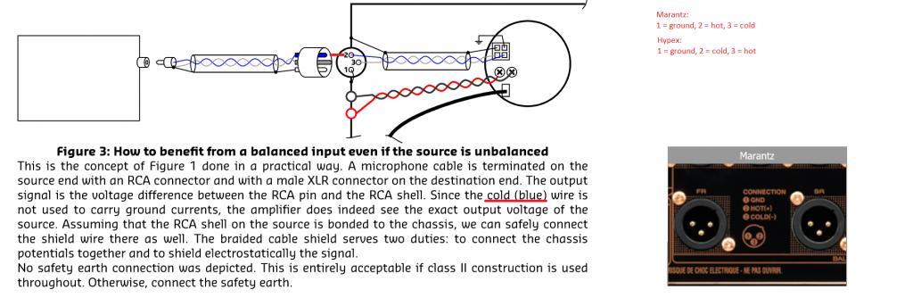

                                                      There is one thing with the design that I do not cuite get.
                                                      According to the Hypex drawings, the recommended solution is to connect pin 1 to the chassie.
                                                      Also, the screen of the cable going from the xlr side of the wire to the amp is supposed to be connected to the chassie - but at a different location. Then the amp side of the screen is also connected to ground.
                                                      Why two different connections to ground at the xlr plug?
                                                      Why is not the screen of the internal cable just connected to pin 1 on the xlr connector?
                                                      Why at all have a ground connection at the xlr connection point instead of just at the end? Is it because signals might be picked up between the input and output of the xlr connection?
                                                      I get the need for balanced cable, the thinking about hot/cold as the differential, but this several earth when going into the chassie I don't get yet. Maybe I have to read the documents again with this as a focus area.

                                                        Reasons: Redundancy, and start grounds. If one connection fails, the other is still there. The ground connections wind up going back to the same point on the system board. If they were daisy chained, in a conventional amplifier, any current flowing through the ground resistance would create a voltage potential between the two grounds; this is an example of how problems occur with single ended setups. Recall some of the papers I sent you about grounding in audio systems. A long read, but a necessary overview if you go working on this yourself.
                                                        I've still been short of free time because of work, but one of the issues you noticed with the inputs of the OEM module when they aren't connected is quite easy to explain, it's what I consider the one issue or vulnerability of how Hypex implements the input configuration.
                                                        Look at the circuit- the type of balanced instrumentation amplifier Hypex uses is largely immune to source impedance imbalance causing a deterioration in common mode rejection because there is no input resistor network as for a conventional balanced bridge single amplifier- there is instead just a high value input impedance. High input impedance if NOT connected to a preamplifier means "noise". There is intrinsic noise to all circuits which is just due to the resistance; the higher the resistance, the more. With the input not terminated, the input sensitivity even to electrostatic effects due to handling the input cable becomes apparent. With the input terminated by a low output impedance preamp, no noise. BTW, tube preamp output stages have much higher impedance than typical solid state, and yes,, that means more noise.

                                                              As you can see form the picture below, Hypex and Marantz have different opiniums on what is hot and cold in the XLR connections.
                                                              Wikipedia is siding with Marantz. https://en.wikipedia.org/wiki/XLR_co...ee_pin_-_audio
                                                              Does this make a difference? I'm not that familiar with balanced signals, but as far as I know the point with the hot/cold is to get the difference between the signals - and in such what is hot or cold should not make a difference, as the delta is the same.
                                                              Or will this work as with speaker cables, so that you will shift the phase of the speakers by swapping this channels?
                                                              If it makes a difference I assume that it is important to select what is closed to the "industry standard" (I assume there is none as Marantz is typing what hot/cold/ground is on all balanced equipment) as possible.
                                                              Are there a "industry standard" for what the different pins mean?
                                                              Does it make a difference if you swap hot and cold?
                                                              The answare to these questions might both affect how I connect the amp internal as well as how I will connect the cables I make.
                                                              (I think I will wire the amp to be according to Marantz so that I can use standard cables if I like to)

                                                                Hum never seen it different before always 1 ground 2 pos and 3 neg but the cable ends are positioned different between male and female ends. That's just to line the pins up. When wiring from the inside of your case just match the pins on your connector.
                                                                  Hmm, I should have read the wiki page better. It explains it.
                                                                  "EIA Standard RS-297-A describes the use of the XLR3 for balanced audio signal level applications"
                                                                  (Picture of connections)
                                                                  "Prior to the introduction of this standard, the wiring of pins 2 and 3 varied. The pin 2 "hot" and pin 3 "cold" convention was typically used by European and Japanese equipment manufacturers, but American companies used pin 3 "hot" and pin 2 "cold". This caused problems when interconnecting equipment with unbalanced connections. The pin 3 "hot" convention is now obsolete but is still found on vintage equipment"

                                                                      that may say cold blue wire, but the way it is wired, the blue wire is actually hot, and connected to the center tip of the RCA connector.
                                                                        Yes, I also notice that I have done it according to standar inside the casing.
                                                                        I think I was looking at the hypex wiring app note when I connected the internal socket to the chassie xlr, and there they refer to pin 2 as hot.
                                                                        In other documents they are more referring to non-inverting audio input and inverting audio input, where non-inverting is hot and inverting is cold.
                                                                        So, probably just a typo regarding naming in the nc400 datasheet then.

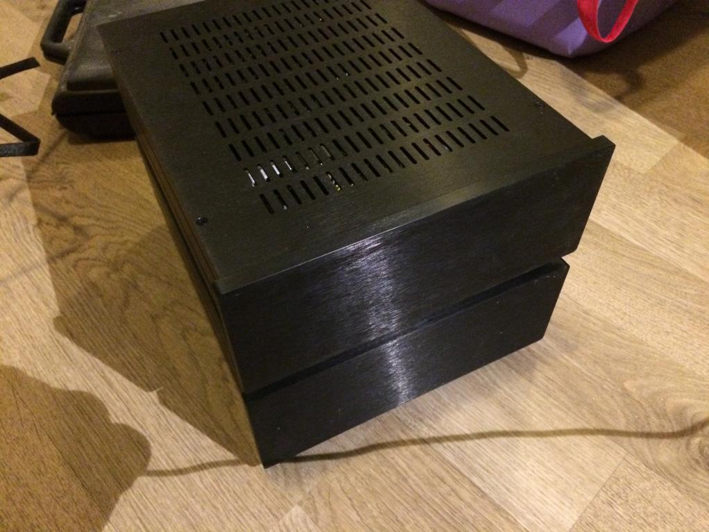

                                                                          OK, anyway, I have build the second one now. It was quite a bit more work than I had believed, and at the same time is it incredible how much faster things is done the second time around. Not having to figure out stuff, not having to buy new parts and so on makes the process a lot more efficient.
                                                                          I need to make a couple of longer balanced cables to get them and the AV8801 installed - and that (both making cables and install the AV8801) will take some time so I'm considering if I should do it tonight or wait.
                                                                          But the week to come at work will involve a lot of overtime and extra work due to a delivery this Thursday, so if I do not install it tonight I will probably not be able to do it before next weekend. And then I will not be able to enjoy it when I'm tiered after work... :unsure:
                                                                          Anyway, as I mentioned, the second one is done.
                                                                          I have turned around the SMPS1200 so it's the other way around (I have done that to the first monoblock as well). I have also moved the adaptor board a bit more away from the sides of the case. I have also moved the balanced input a bit more towards the center (the back panel drawing is updated) to make more room between the balanced input and the speaker cables. During testing of the first it felt a bit "tight" around the speaker terminals. And I have used a 3300 resistor for the led instead of the 1800 I used on the first. I will live it like that for now and compare them when they are in use to figure out what I like best.

                                                                            Nice! That looks sorted now turning the power supply around. Those cases are well done with venting on the bottom and top with the thick simple fronts. I think your going to love all the channels you have planned.
