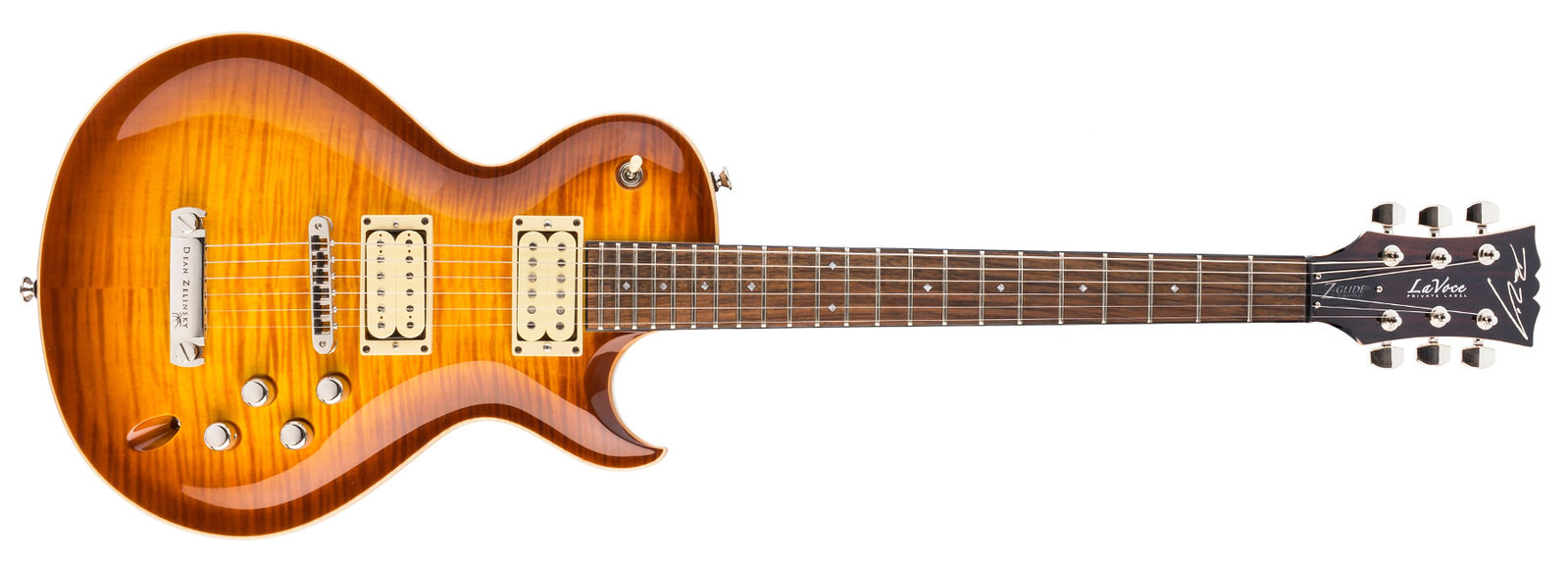

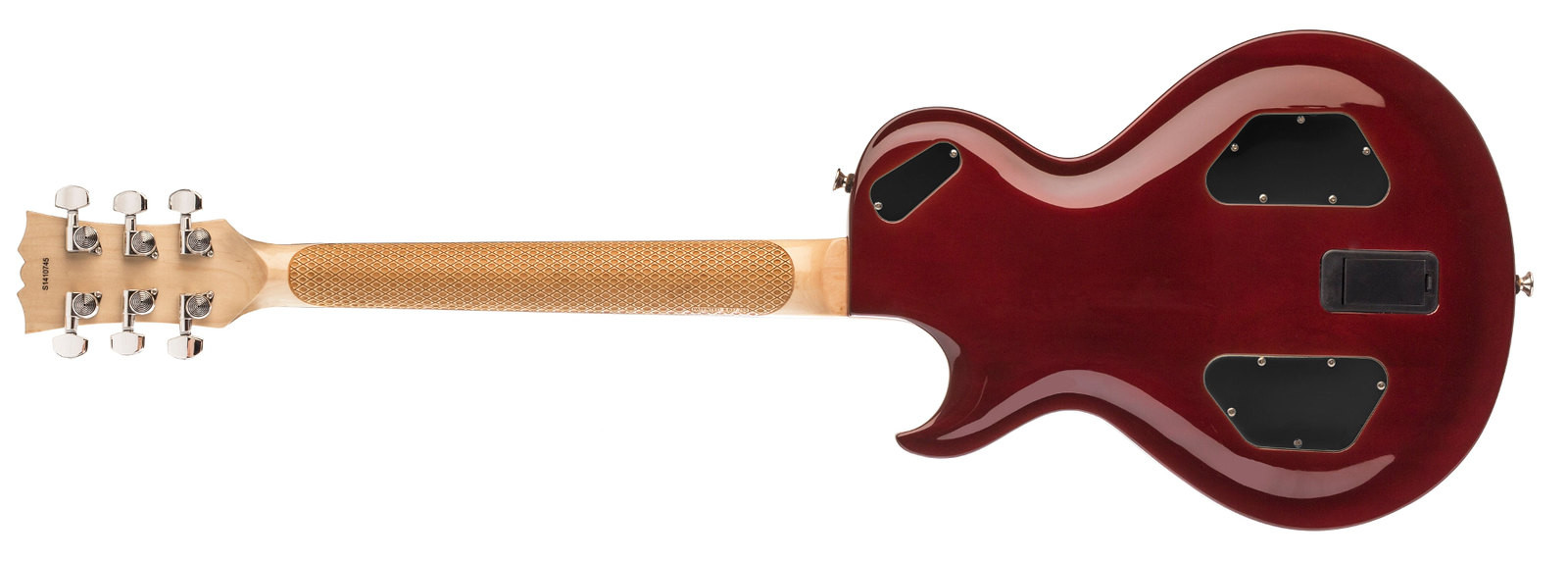

    And, in an act of sheer irresponsibity yesterday, I ordered a new guitar.... From the Dean Zelinsky private label company. More on that later, but it looks great, and demo's show that in single pole mode, the front pickup gives an incredibly good Stratocaster tone- nails one of my favorite Hendrix sounds, based on a YouTube demo. And the piezo pickup in the bridge does more than a passably fair imitation of an acoustic.
    Click image for larger version  Name:	23709883693_e3e258763c_h.jpg Views:	0 Size:	154.2 KB ID:	952225
    Click image for larger version  Name:	24254200771_4018c448f2_h.jpg Views:	0 Size:	113.1 KB ID:	952226
    Now, who worries about Hendrix sounds these days? That certainly dates me....

    Congrats with your new guitar btw :-) Looks very, very nice!
