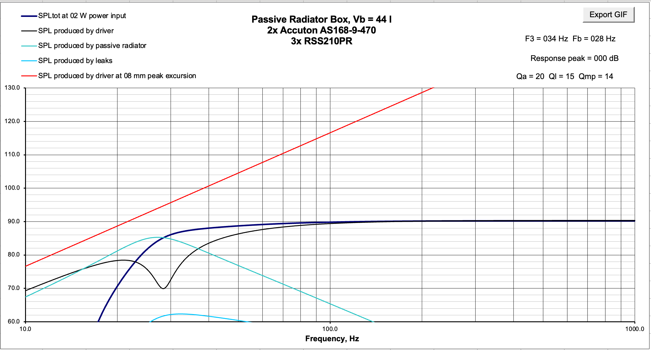

                              OK, a little bit of an LF modeling update, in consideration of changes being considered by Steve and Jim.
                              Quick review of the original configuration with two AS168-9-470 with two RSS265PR in Unibox...
Name:	Ardent D 2x RSS265PR PR.png
Name:	Ardent D 2x RSS265PR SPL.png
                              With 2x RSS210PR no weights...
Name:	Ardent D 2x RSS210PR no weights.png
                              IMO, 2 - 8" PRs is a less than optimum ratio of woofer area to PR area.
                              But what do I know?
Name:	Screenshot 2024-11-23 at 2.39.38 PM.png
Name:	Ardent D 2x RSS210PR SPL.png
                              Now, my preferred alternative if the 8" PR are to be used...
Name:	Ardent D 3x RSS210PR Design.png
                              With one weight disk added...
Name:	Ardent D 3xc RSS210PR SPL.png
                                • 2140
                                Good thing I hadn't started cutting any wood yet. So, what did the three of us miss when we signed off on the change a while back? Oh well we will adapt. 🙃
                                  • 16170
                                  That's about the only thing I'm aware of that has come up, and it was just in response to Jim's question to me this week. Asking why I originally had 10" PR's, and explaining the area ratio thingie and how it relates to frequency tuning an extension versus flatness.
                                  one can use the extra disk on just two of the RSS210PR, tuning to the same Fb, but you don't get the same coupling and output, where the woofer output starts to roll off, the whole system output declines. One can only change PR mass in disk weight increments, so no disks is 110g, 1 disk is 185g.
                                  Also, the Fb tuning is a function of individual PR mass and the number of PR's and net compliance.
                                  Click image for larger version  Name:	Screenshot 2025-06-21 at 6.30.36 AM.png Views:	0 Size:	147.3 KB ID:	958615

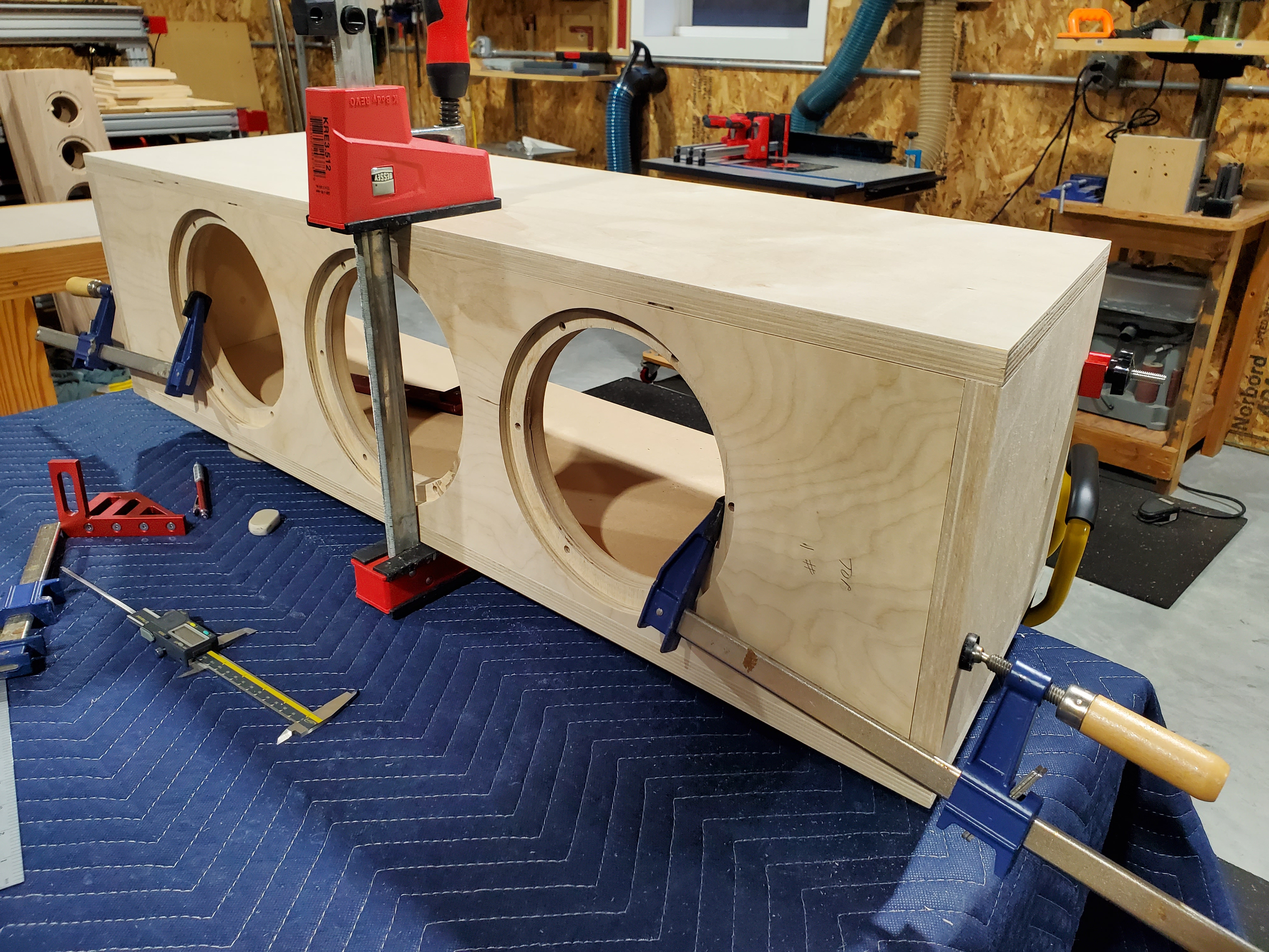

                                              Work has continued on the cabinet sides.
                                              Weather has been nice so I can enjoy the shop being open.
                                              A little sanding of the MDF to rough up the surface prior to glue up.
                                              Many clamps required as usual.
                                              After clean up of things.

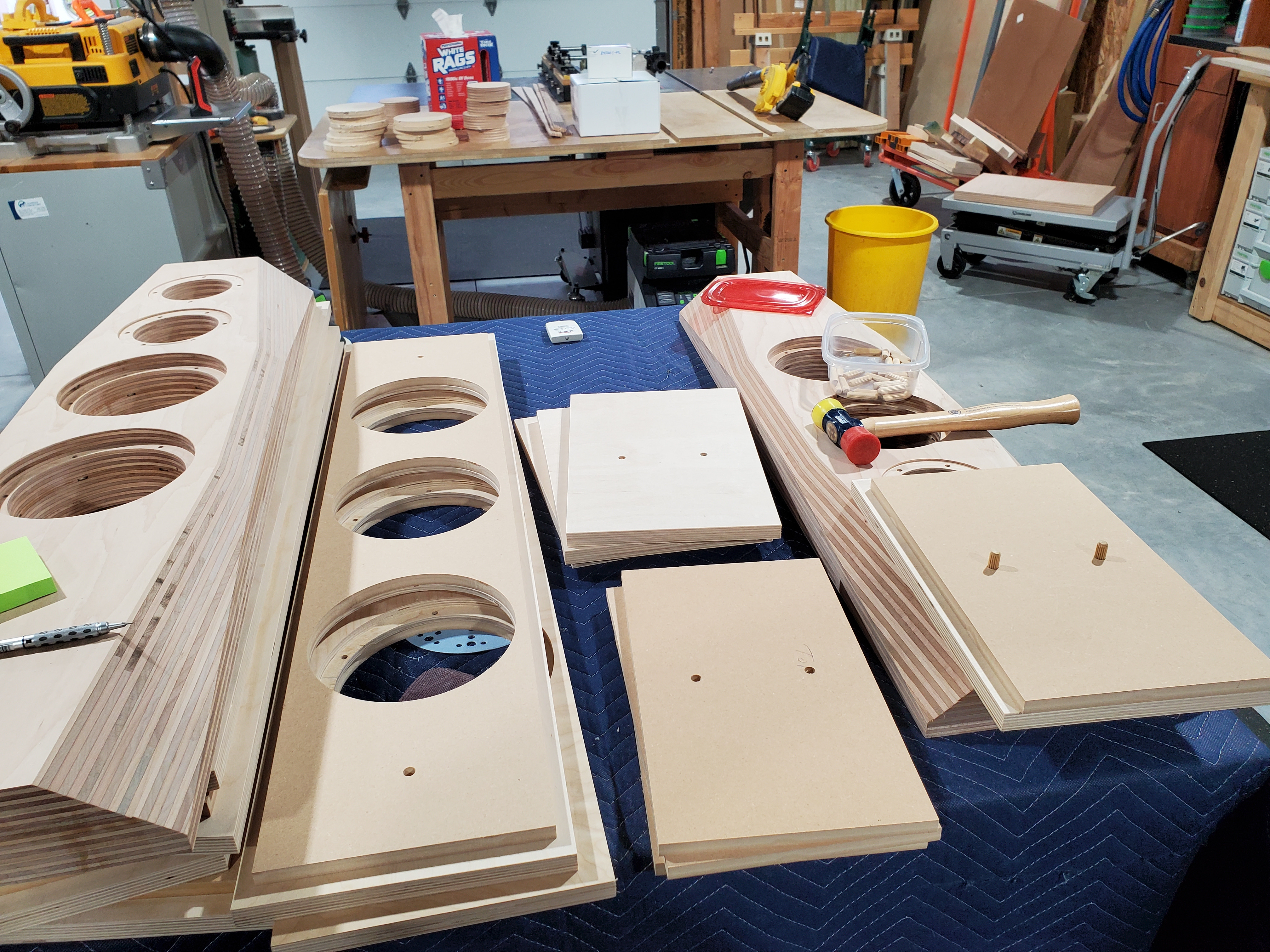

                                                • 2140
                                                Also managed to get things started on the baffles.
                                                Breaking the maple pin block down to rough length.
                                                Rough break down of panels next to a set of sides.
                                                Things broken down to final width and rough length for the CNC

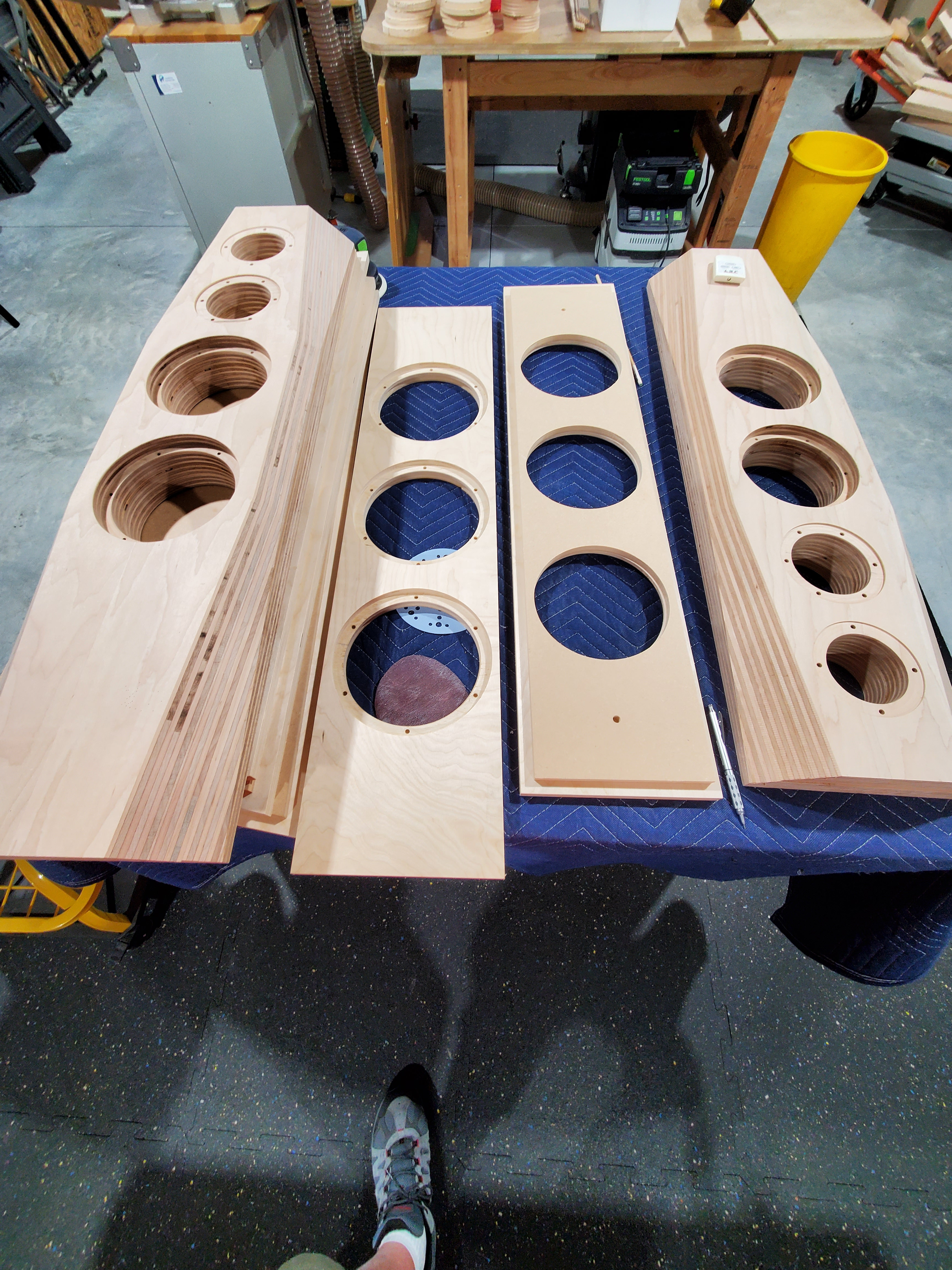

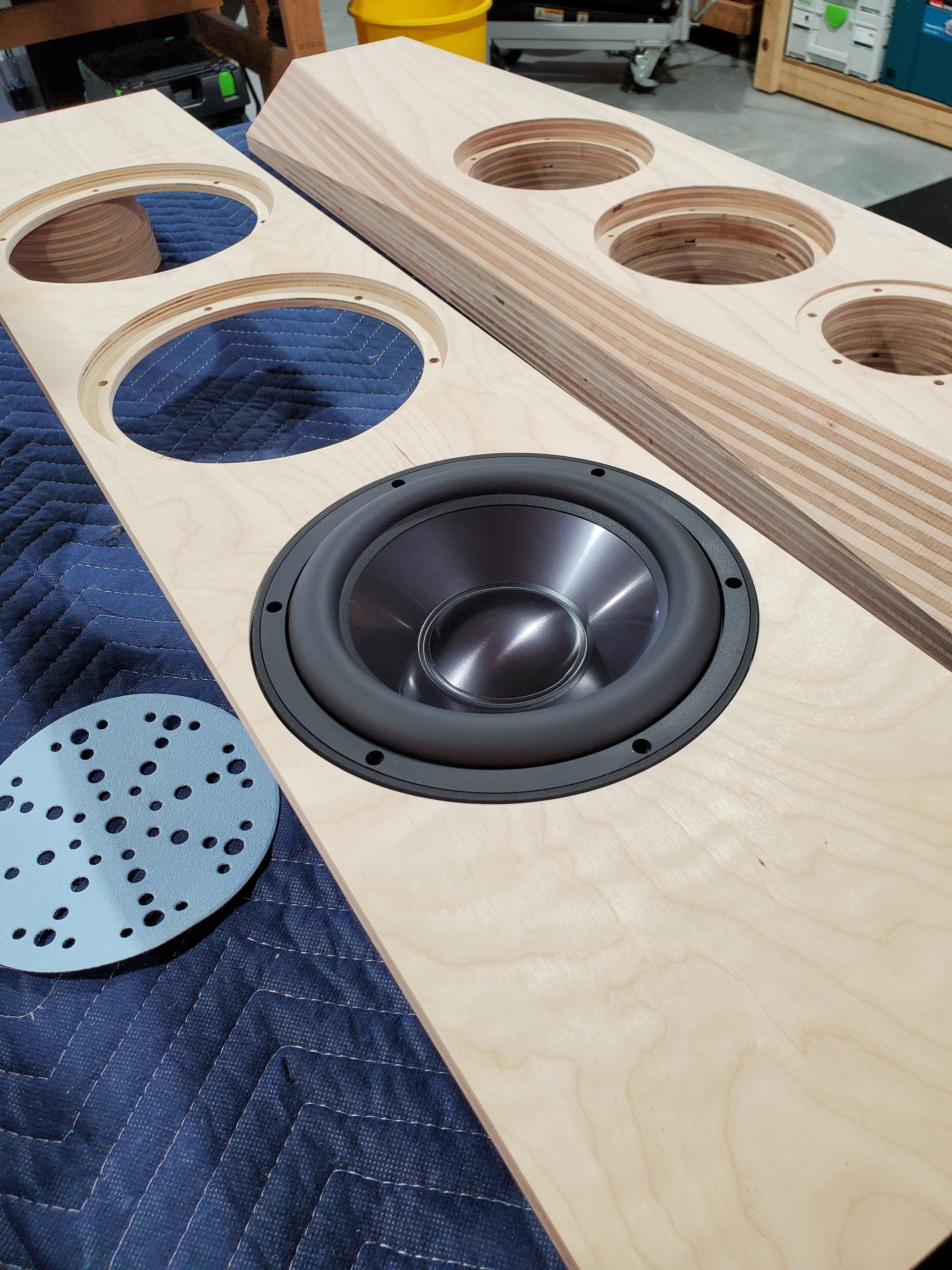

                                                    Been making some wood chips over the last few days. Turned the maple blanks into some parts.
                                                    The outer layer of the baffle.
                                                    As Jon has mentioned this stuff machines very well. None of the chipping and splintering of bamboo or Baltic Birch. Too bad it doesn't come in more useful sizes and less abusive on the wallet!
                                                    Test fitting some of the drivers.

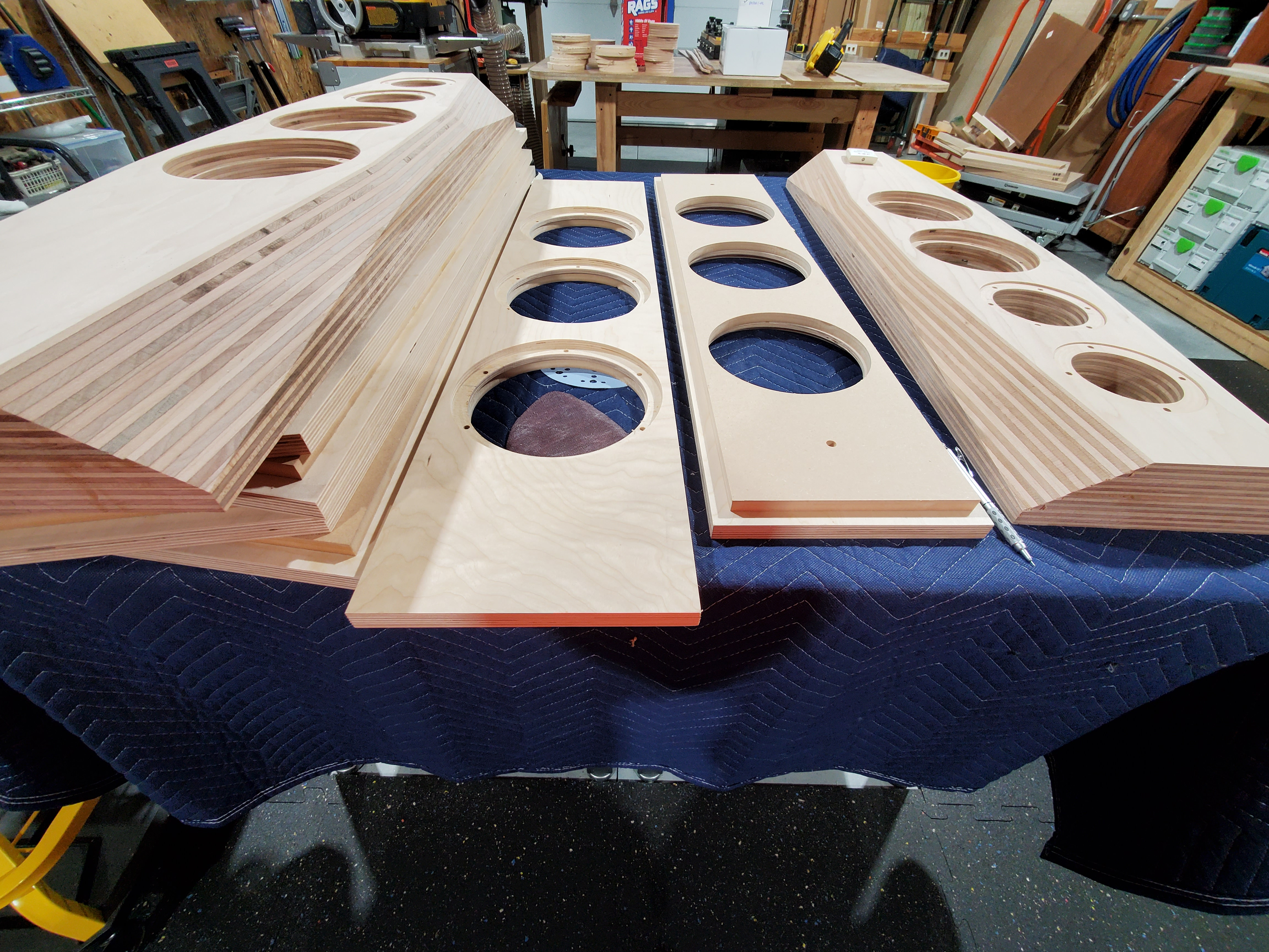

                                                      • 2140
                                                      Then started on the bottom layers.
                                                      Since the woofer mounting holes are so close to the edge of the driver cutouts, using standard threaded inserts was not an option. Sp I went with an offset option that will live in between baffle layers.
                                                      Here are the recessed pockets for them.

                                                              • 2140

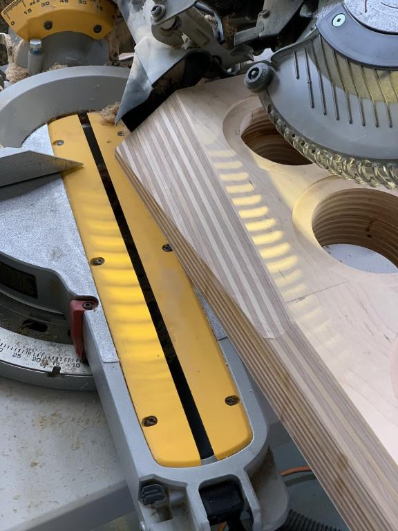

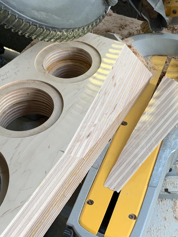

                                                              Well after building a number of Ardent baffles over the years, I opted to forgo the table saw approach which is a pain, unless you have a 14" slider. I decided to give it a whirl on the CNC.
                                                              It was a bit of a pucker factor, but things turned out rather well.
                                                              The start of the roughing process.
                                                              Like building a set of stairs.
                                                              First side done.
                                                              Both sides roughed.
                                                                • 2140
                                                                Then came the cleanup ....
                                                                The first side finished .....
                                                                All done.
                                                                The before and after comparison.
                                                                  All done.

                                                                        In this case, Steve's construction engineering and philosophy produce uniformly excellent results- and without tapping the power of the Dark Side...
                                                                        With only more basic tooling available, calculated consistency it not available- it requires the inspiration of the Dark Side...
                                                                        Click image for larger version  Name:	FacetCutOneSide.jpg Views:	0 Size:	113.7 KB ID:	959676
                                                                        Click image for larger version  Name:	And the other side.jpg Views:	0 Size:	115.4 KB ID:	959677

                                                                          Painter in training
                                                                            A Data Item update for Mr. Manning, regarding the LF alignment and PR configuration with one weight disk on each RSS210-PR (2x) - Jonmarsh was unduly tied up with health advocacy issues for others...
Name:	Ardent D 3x RSS210-PR Alignment.png

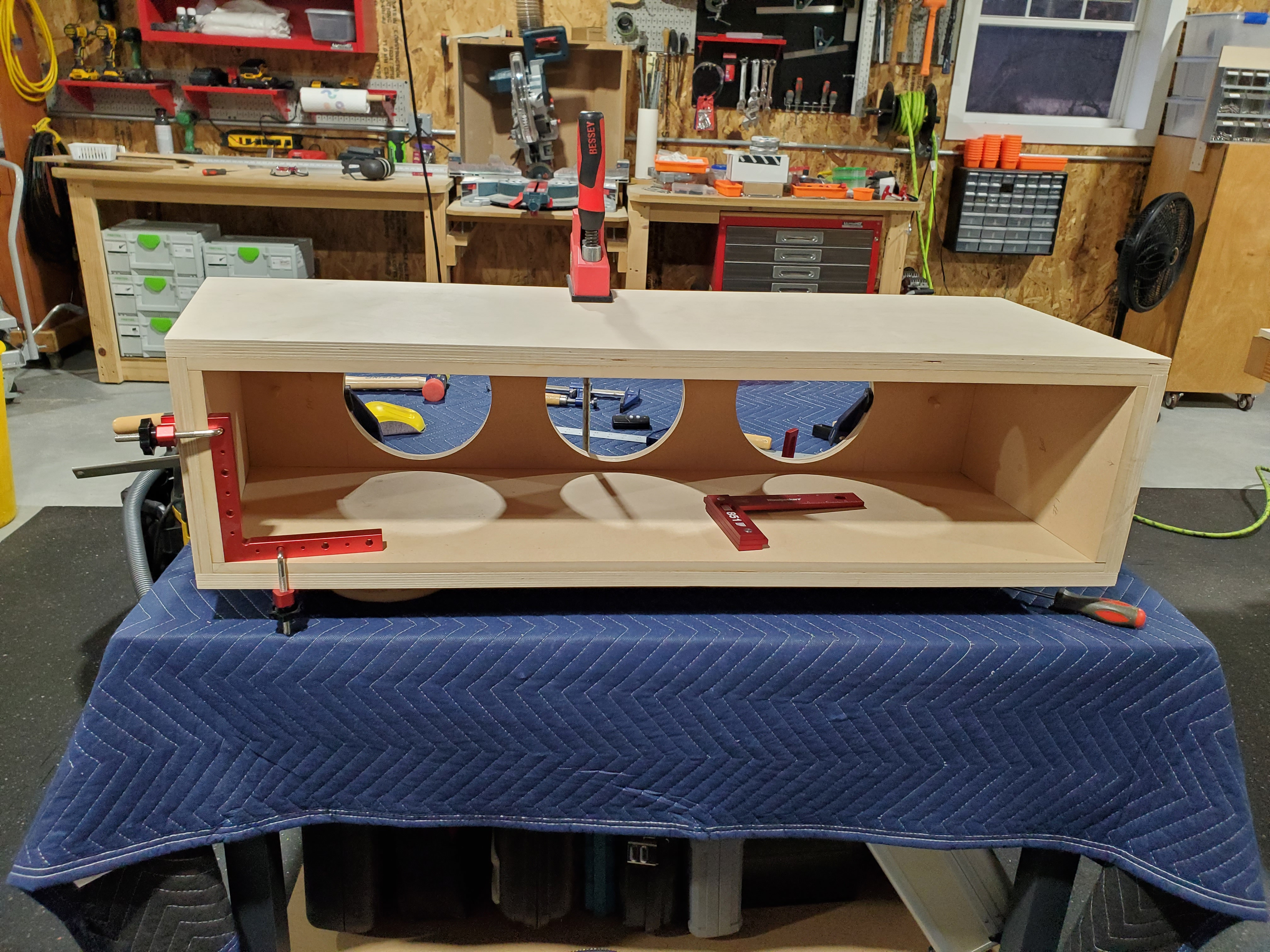

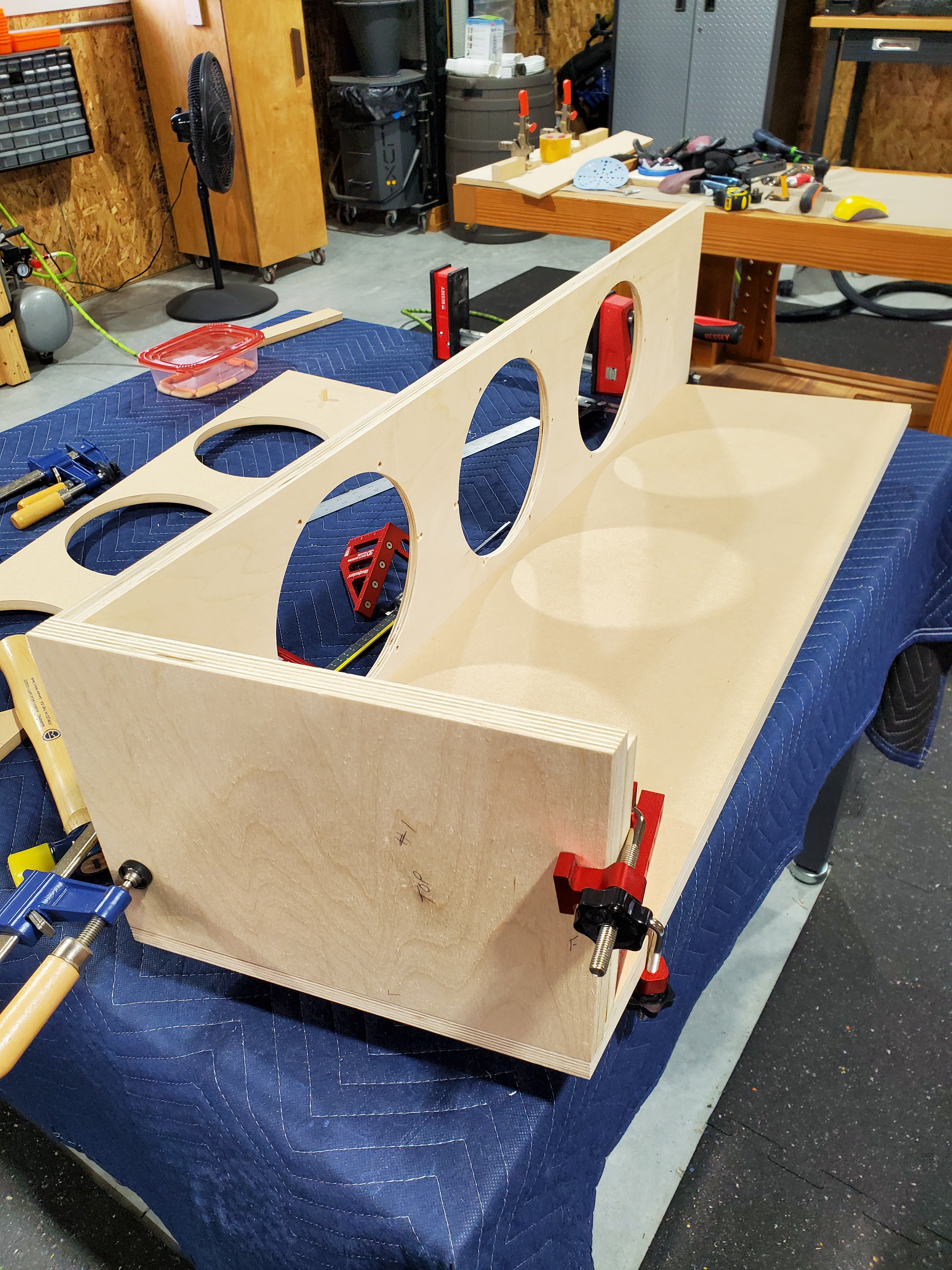

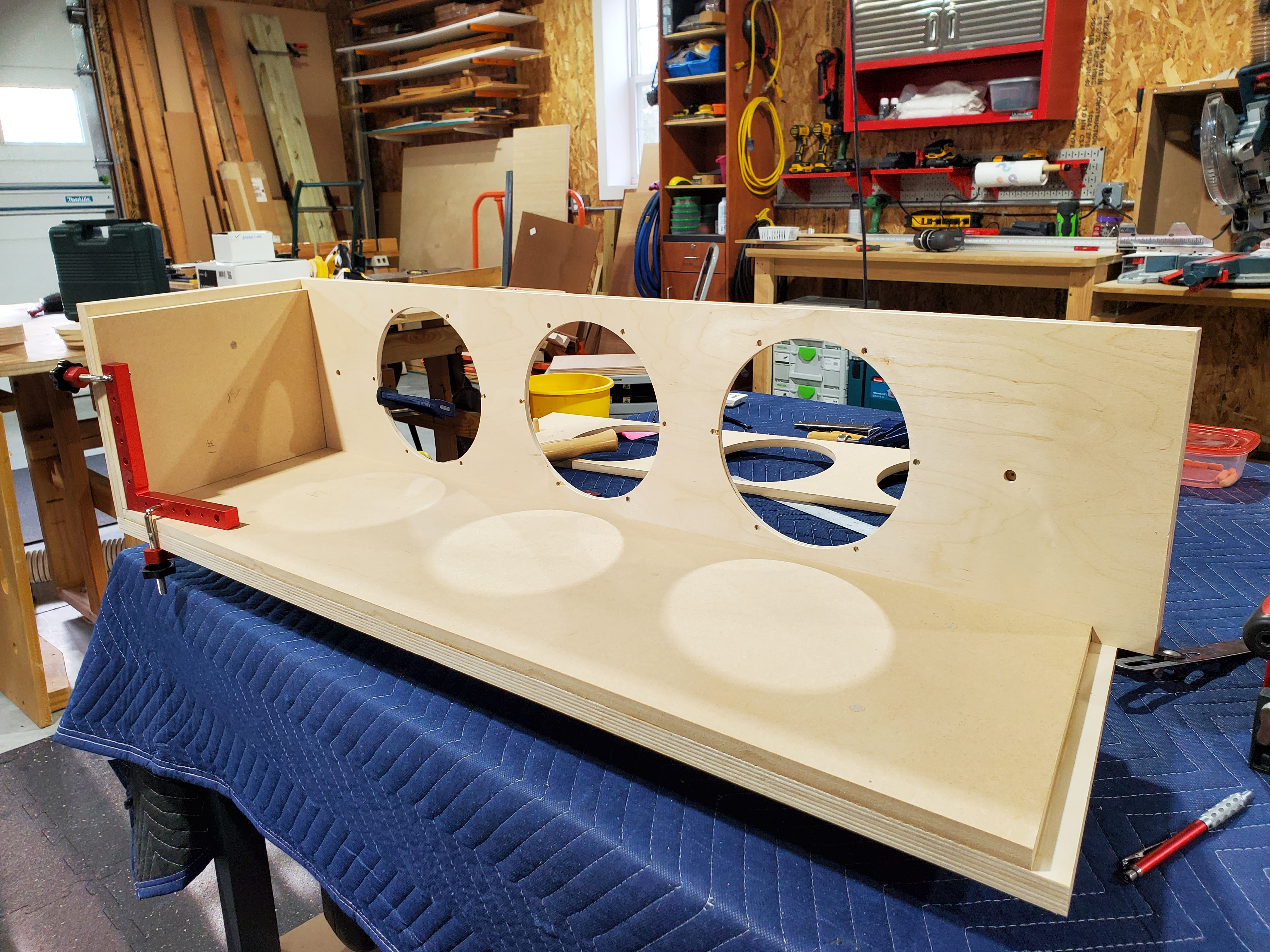

                                                                              Well speaking of said PR's .....
                                                                              Parts for the rear panels have been cut out.
                                                                              A test fit of one of the PR's and a reason to have parts on hand. I discovered the the flange thickness was ~0.1" off from the manufacturers drawing!
                                                                              Also got the top and bottom pieces cut as well.
                                                                              Of course lots of gluing and trimming to the correct length are next on the agenda.

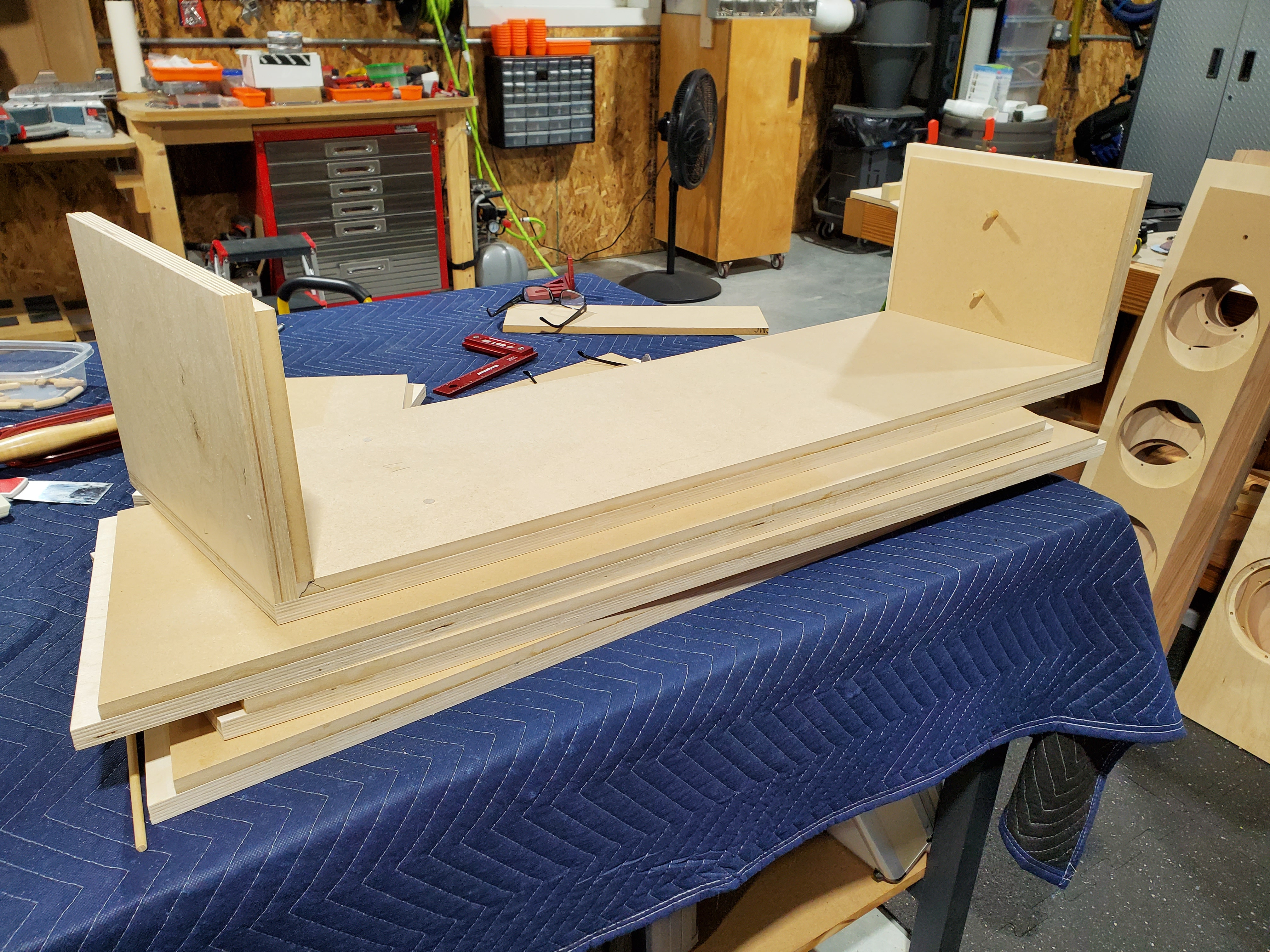

                                                                                  Getting layers trimmed to length with 10 degree bevels on the ends and then glued together. As Jon is fond of saying about slow work and all that .....
                                                                                  I can see where a 5 axis CNC would come in handy for stuff like this. That however, is waiting on a Lotto win!
