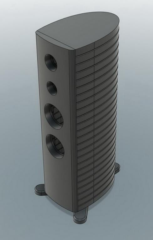

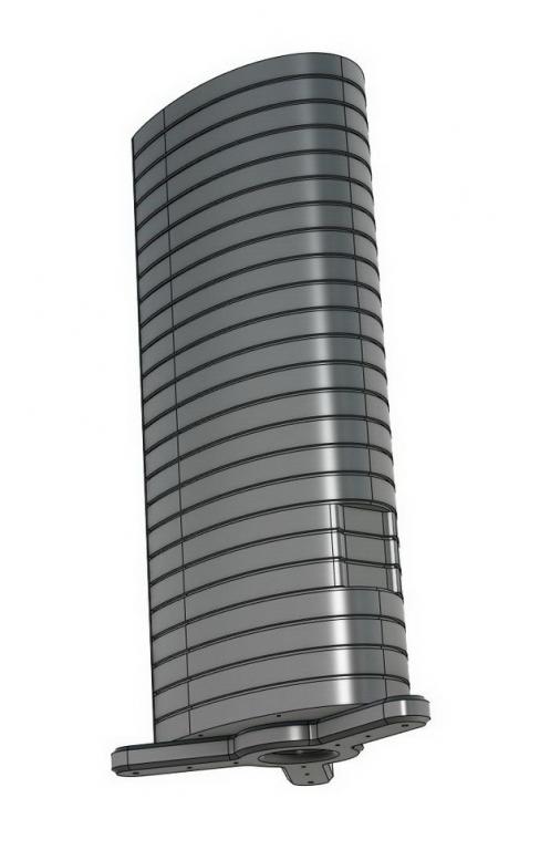

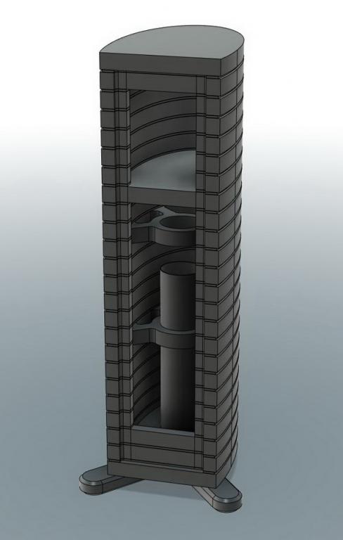

      As with the Calliope MT's that Sven did a little while back, I'll post some pictures along the way getting his parts ready.
      Here are a few pictures of what the design is intended to look like when done.
      This time around the baffle will be the curved version that I have been working on.
Name:	Ardent D Cabinet v15_resize.jpg
      With the baffle removed.
Name:	Ardent D Cabinet v14_resize.jpg
      The back if the cabinet.

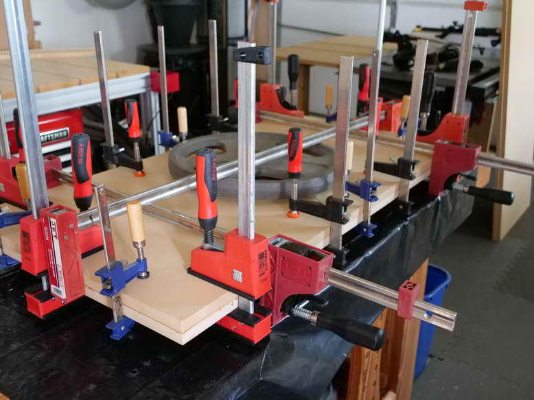

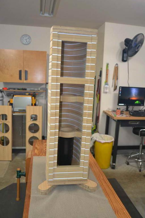

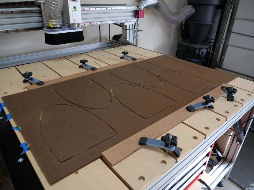

              Besides getting CAD/CAM files in order, parts have already started down the fabrication path.
              Lots of gluing up 1.5" slabs of material

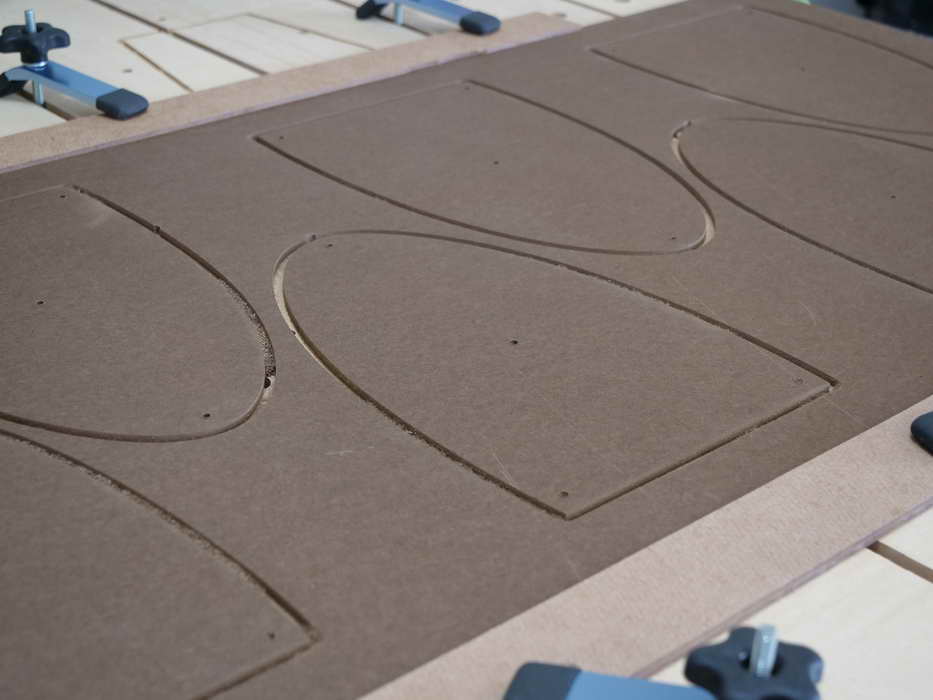

              Some mdf slabs as well the baffles waiting their turn on the CNC
              With the curved baffle design the modified ribs now have a flat front. This should help in getting all the parts aligned.

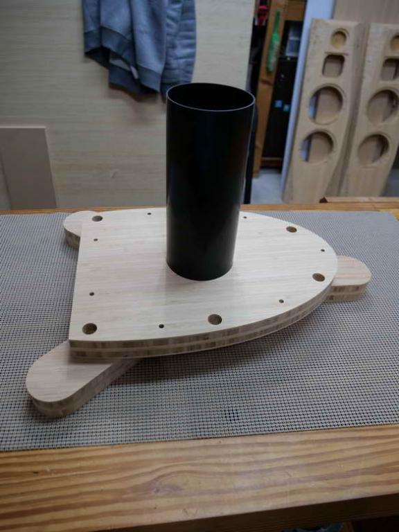

                • 2129
                Well despite a minor detour off into the weeds over Thanksgiving ..... I had to help with the Christmas decorations, there stored above my shop and it shuts down all work activities for the duration, progress continues.
                The cause of the detour .....

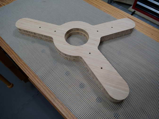

                One of the stands in bamboo ....

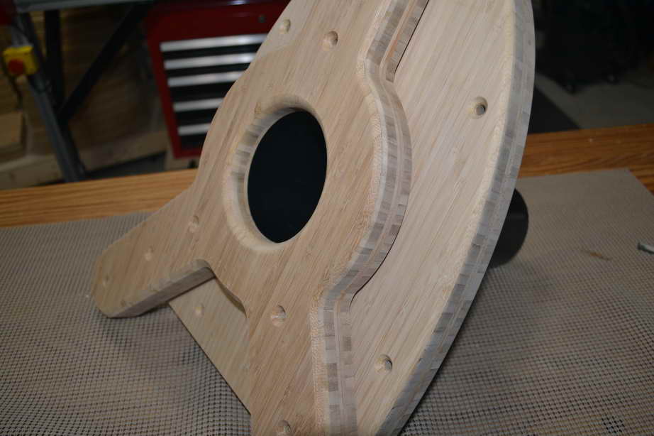

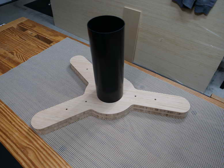

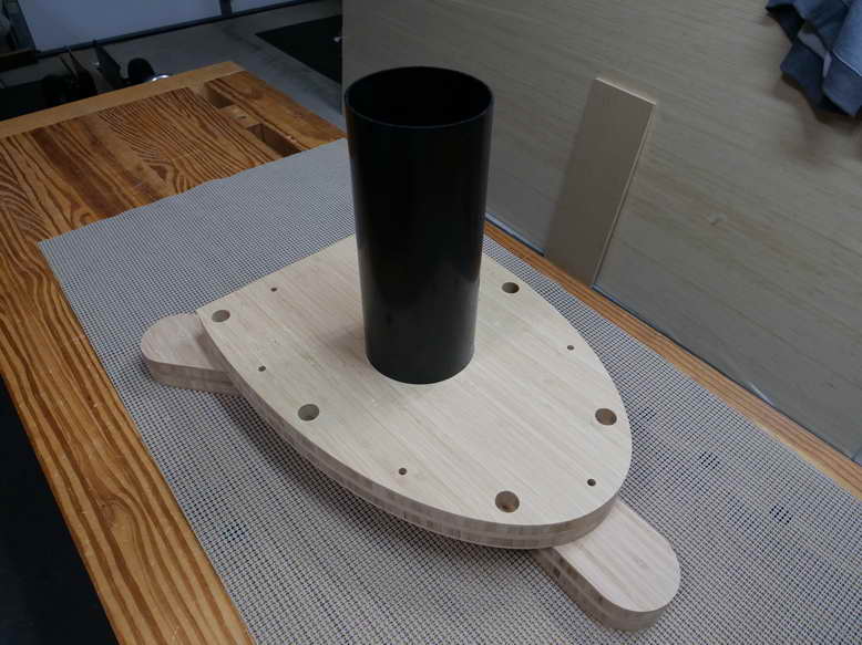

                Recess to accept port ....
                Port installed ....
                Underside ....... opening will have a round over when done.

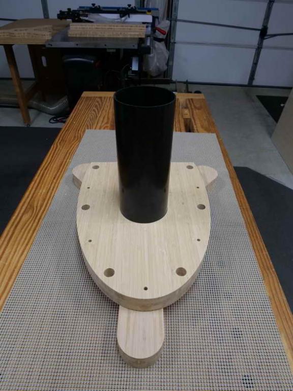

                  • 2129

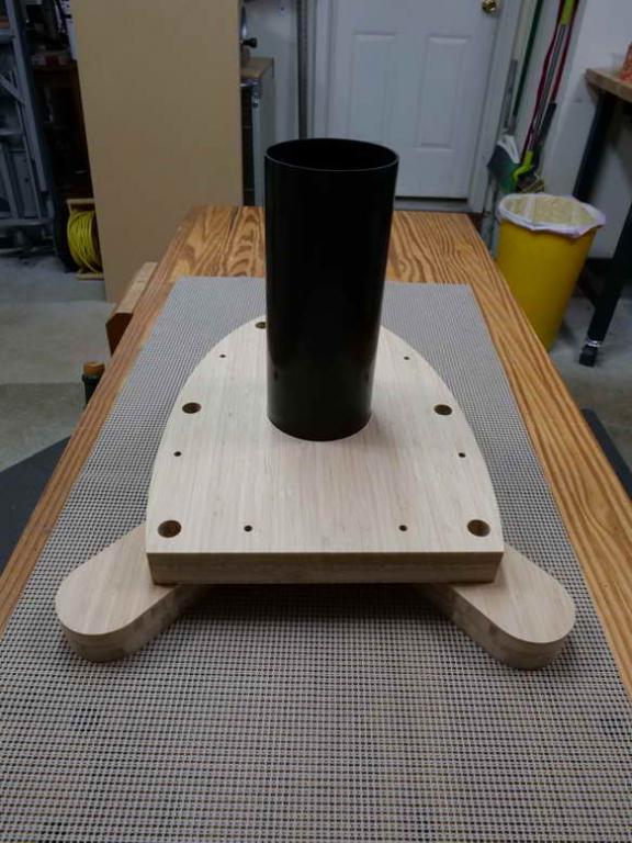

                  A few more picture with the base of the cabinet in place.
                  Progress for you as well Danny, your bamboo came in a couple of days ago .... that's it next to your baffles.

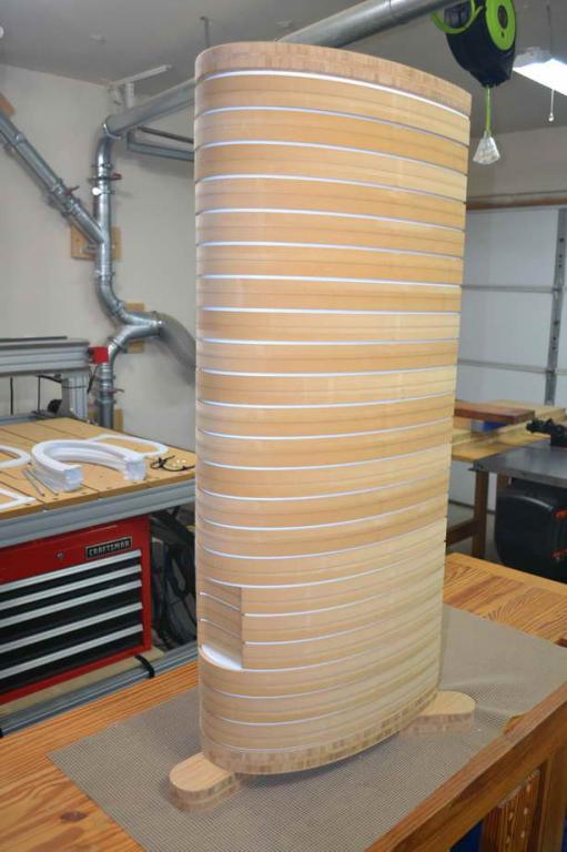

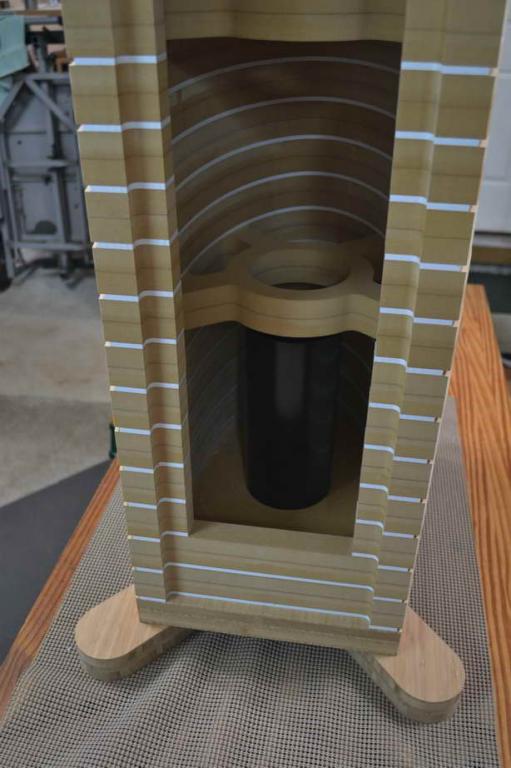

                                    • 2129

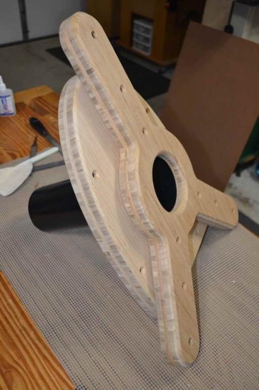

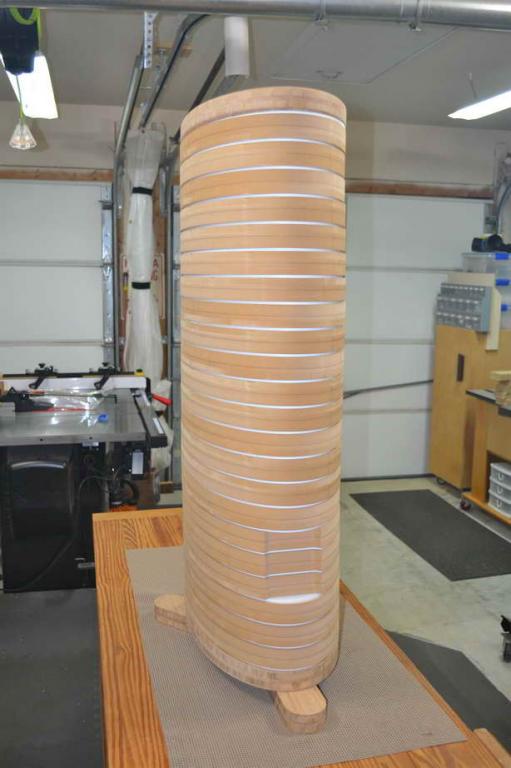

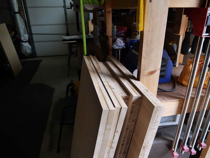

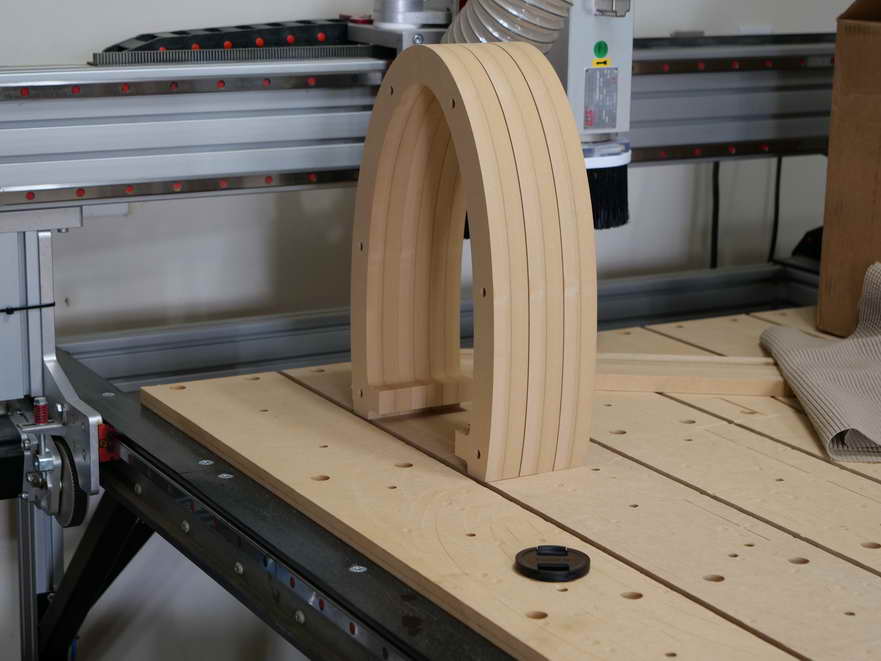

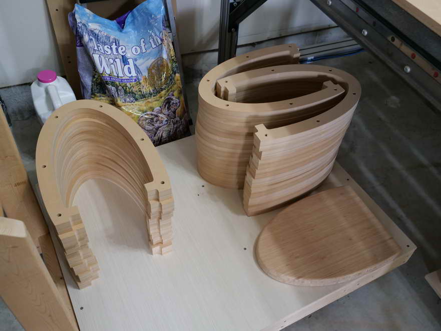

                                    Parts are stacking up ..... literally. All of Sven's ribs and spacers have been machined for both cabinets. I did a stack up of one cabinet to get a feel of what it's going to look like. Here's a few pictures ....
                                    Port will be longer than what you see here, ~22" for a tune of ~30hz.
                                    Next step is to apply round overs to all the ribs, as well as countersinking some holes to accommodate screw heads and threaded inserts.

                                      How tall is the cabinet? Very excited to see the progress and how the cabinet is going to look!
                                          As they sit at the moment, just under 43" tall. By the time you add all the gaskets, you will add ~1" and then the spikes. So ball park is 45".

                                            Man that thing looks SOLID. Any idea on weight?
                                                To paraphrase an old adage about restaurant prices....
                                                If you have to ask, you can't lift it.
                                                    Based on the lightest rib, which I just weighed, what your looking at is 70 - 75 lbs. So by the time their done ..... stout.
                                                          Just like the type of beer I like to drink, Stout! I thought about the weight and started thinking I might/should assemble these in the basement. That way I don't have to maneuver stairs.

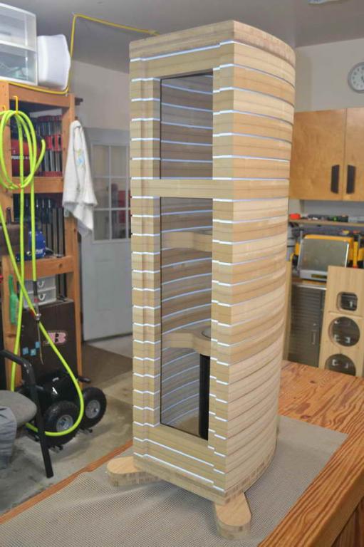

                                                            • 2129

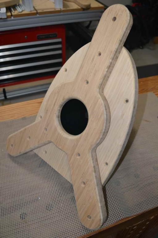

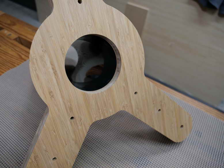

                                                            Round overs and chamfers on parts are done.
                                                            Some detail on what that looks like on the stand and a nice round over for the port.

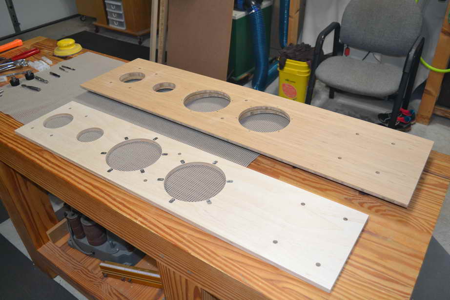

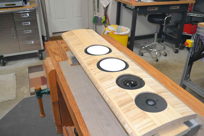

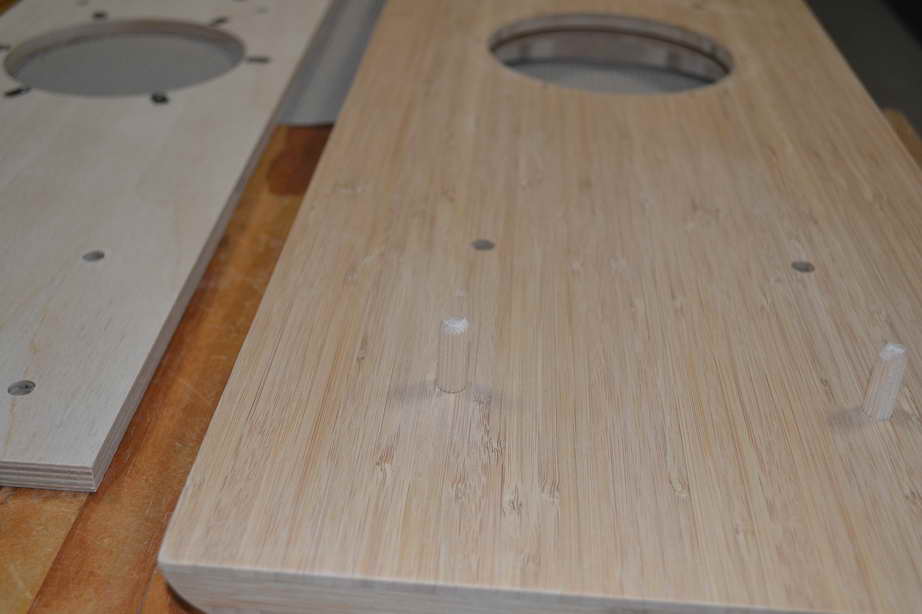

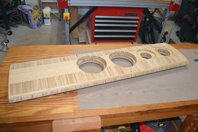

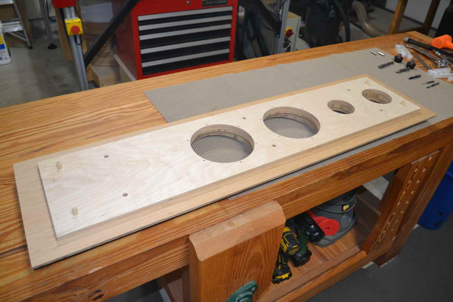

                                                                It's Baffle Time
                                                                With all drivers on hand so I could double check dimensions, work has started on the baffles.
                                                                Baffles are comprised of a 1.5" outer layer of bamboo and a .5" layer of Baltic Birch.

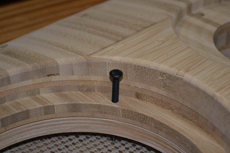

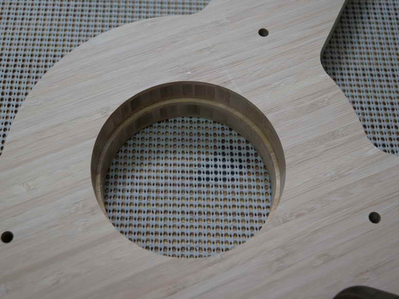

                                                                As Jon found out with his test cabinets, the bolt hols for the AS168 drivers do not allow the use of the brass inserts that I typically use. I found a different route using an offset insert that is inset between the birch and bamboo layers.
                                                                Layers are aligned with 3/8" dowels.
                                                                Layers combined.

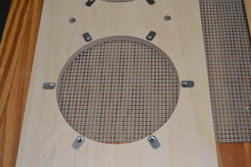

                                                                A test of alignment of the thru holes and inserts.
                                                                  • 2129

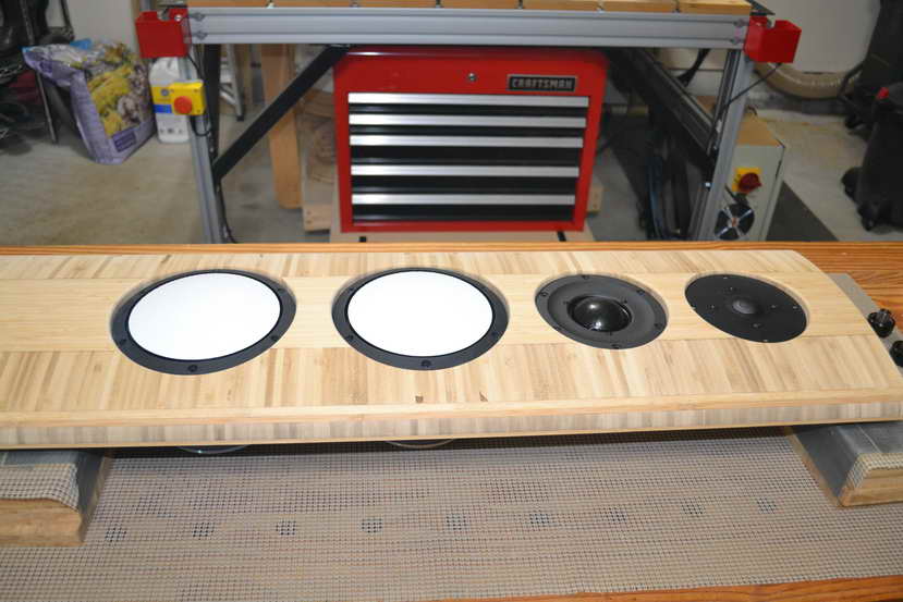

                                                                  A few more ...
                                                                  Top side of the baffle.

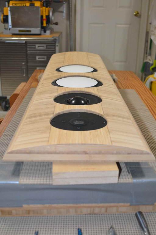

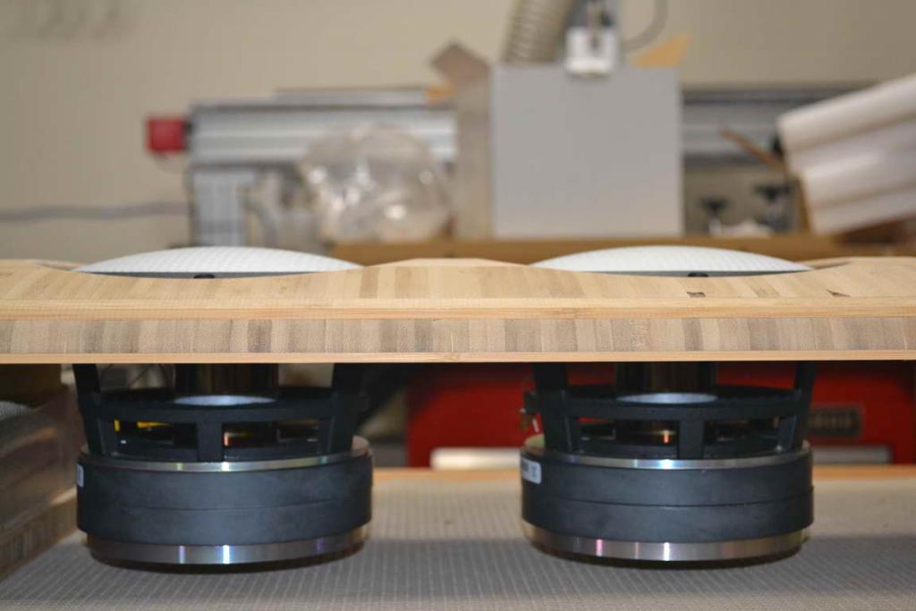

                                                                  Test fit of the drivers.
                                                                  Mid & Tweeter are sitting a little low since they do not have any gasket installed at present ...... add that to your to do list Sven.
                                                                  Side shot of the woofers. Their very stout considering their size. Very well made.

                                                                      The baffles are gorgeous!! My wife really likes them too!
                                                                      Painter in training
                                                                      • Browncoat
                                                                        • Oct 2016
                                                                        • 131
                                                                        Agreed, stunning work.
                                                                        Do you aim to have the top/bottom of the driver flush with the baffle, or the left/right sides? Or neither?
                                                                          • 2129
                                                                          Thanks Sven .... as long as your wife likes them your good to go.
                                                                            • 2129
                                                                            Thanks Browncoat ...... Each of the driver cutouts have a radius on their edges. I set things up so the top of the driver face plate lines up with where that radius starts on the right/left sides since their the high point. The radius in this case is 1/8". With the Accutons, since they don't have a flat face plate/edge, I line up where the edge stops being vertical and angles over.
                                                                            Hopefully that makes sense.

                                                                                    A small update ...... Made a half dozen crossover boards in preparation for Jon's final crossover version.
                                                                                    Also getting ready to order up a bunch of threaded inserts for installation so these cabinets can be put together.
                                                                                      Master of None
                                                                                      • Jan 2014
                                                                                      • 1658
                                                                                      will the crossovers all fit on one board or will it be two boards per cabinet? Yay on the threaded inserts, I can focus on my finishing work on this build.
                                                                                      Painter in training
                                                                                        • 2129
                                                                                        Actually there will be at least 2 boards per cabinet, maybe 3. Once the master gets me a parts list and I get the parts in, I can start building the jigsaw puzzle and see how it works out.
