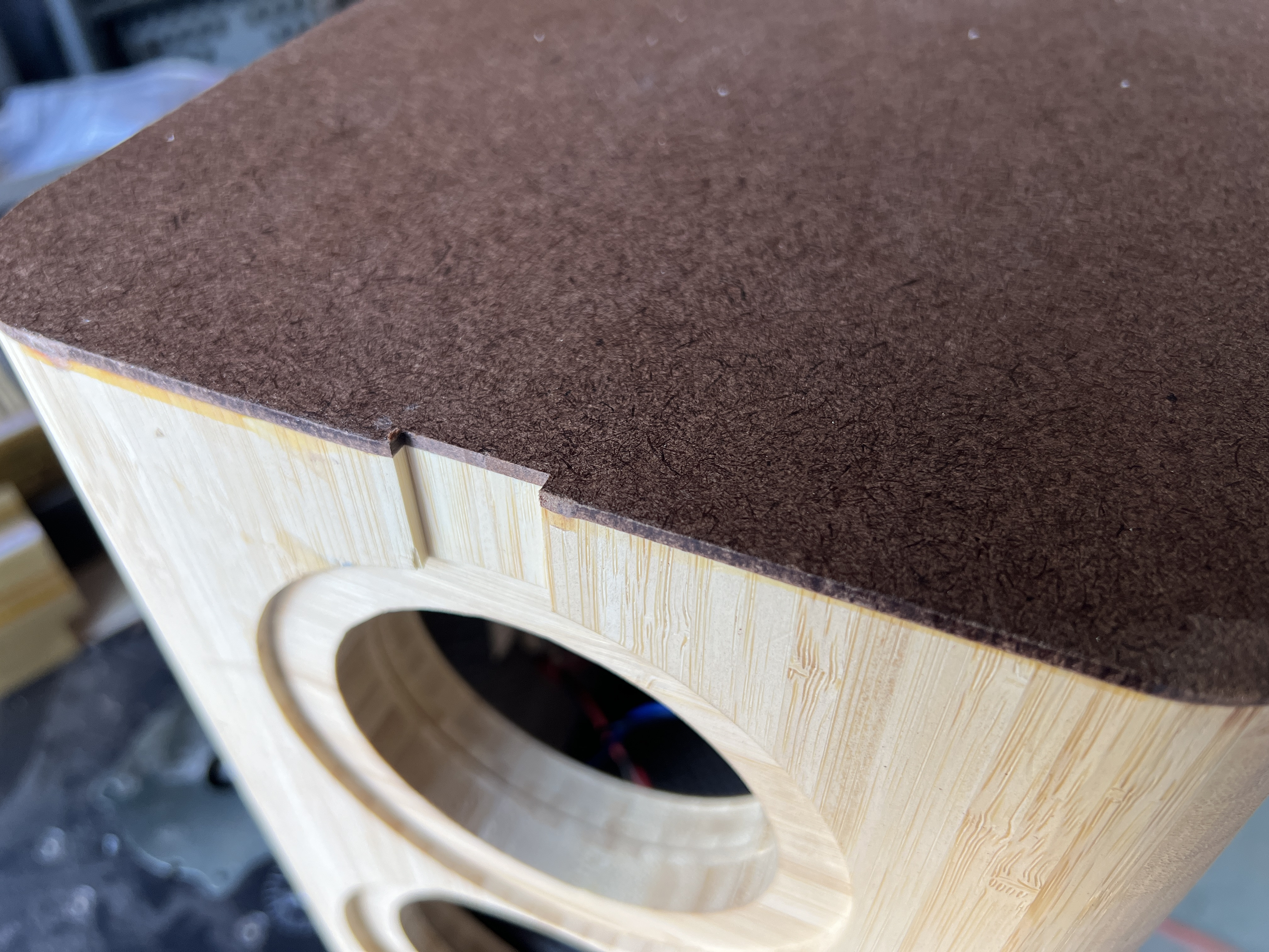

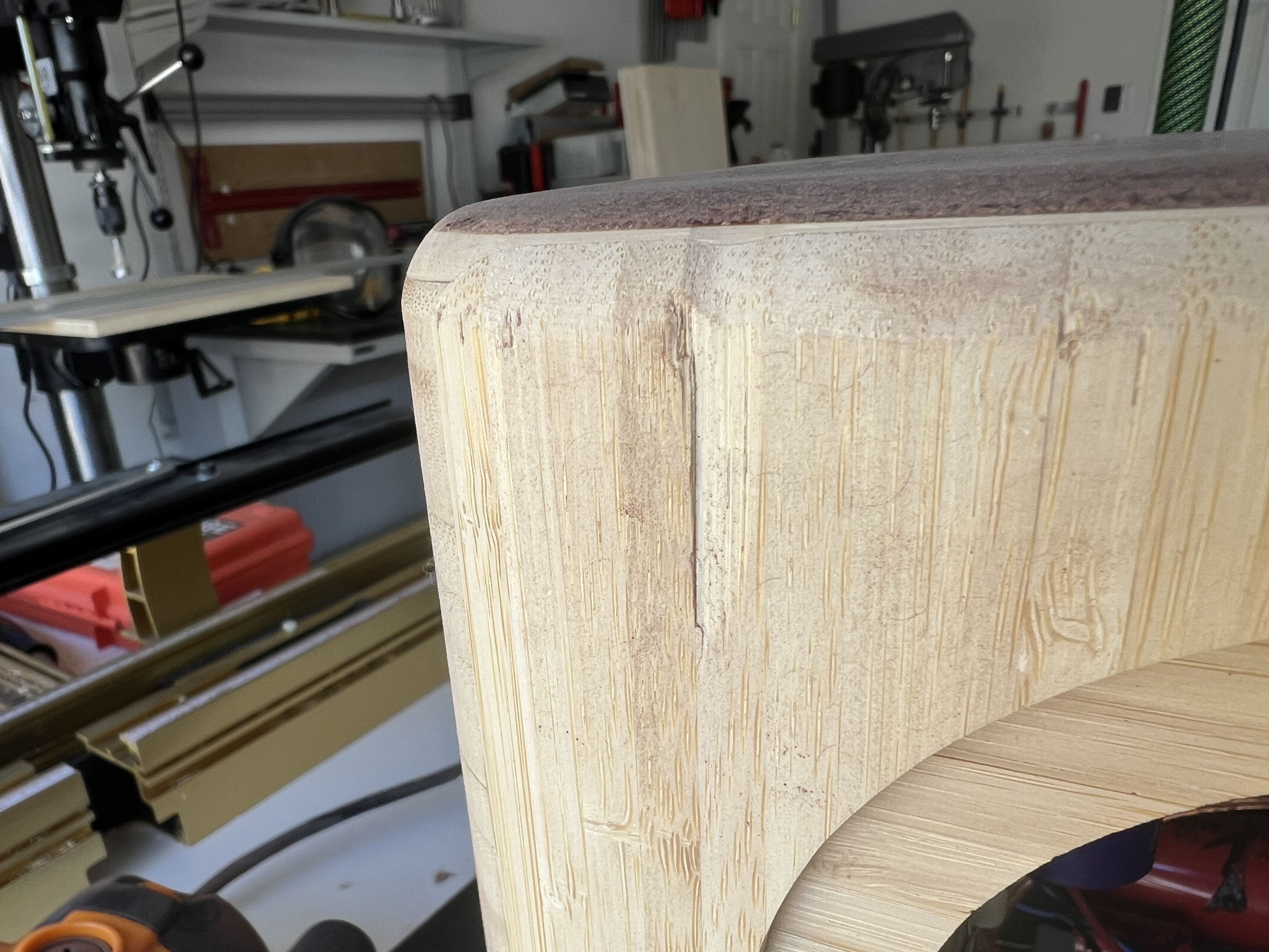

    I began my fix on the Keramiskas speaker I gouged the other day. Went pretty well! I just need to cut an appropriate size piece of bamboo to glue into the gap now.
    Click image for larger version  Name:	IMG_0987.jpg Views:	0 Size:	2.30 MB ID:	952567
    Click image for larger version  Name:	IMG_0988.jpg Views:	0 Size:	2.20 MB ID:	952568
    Click image for larger version  Name:	IMG_0989.jpg Views:	0 Size:	2.91 MB ID:	952569

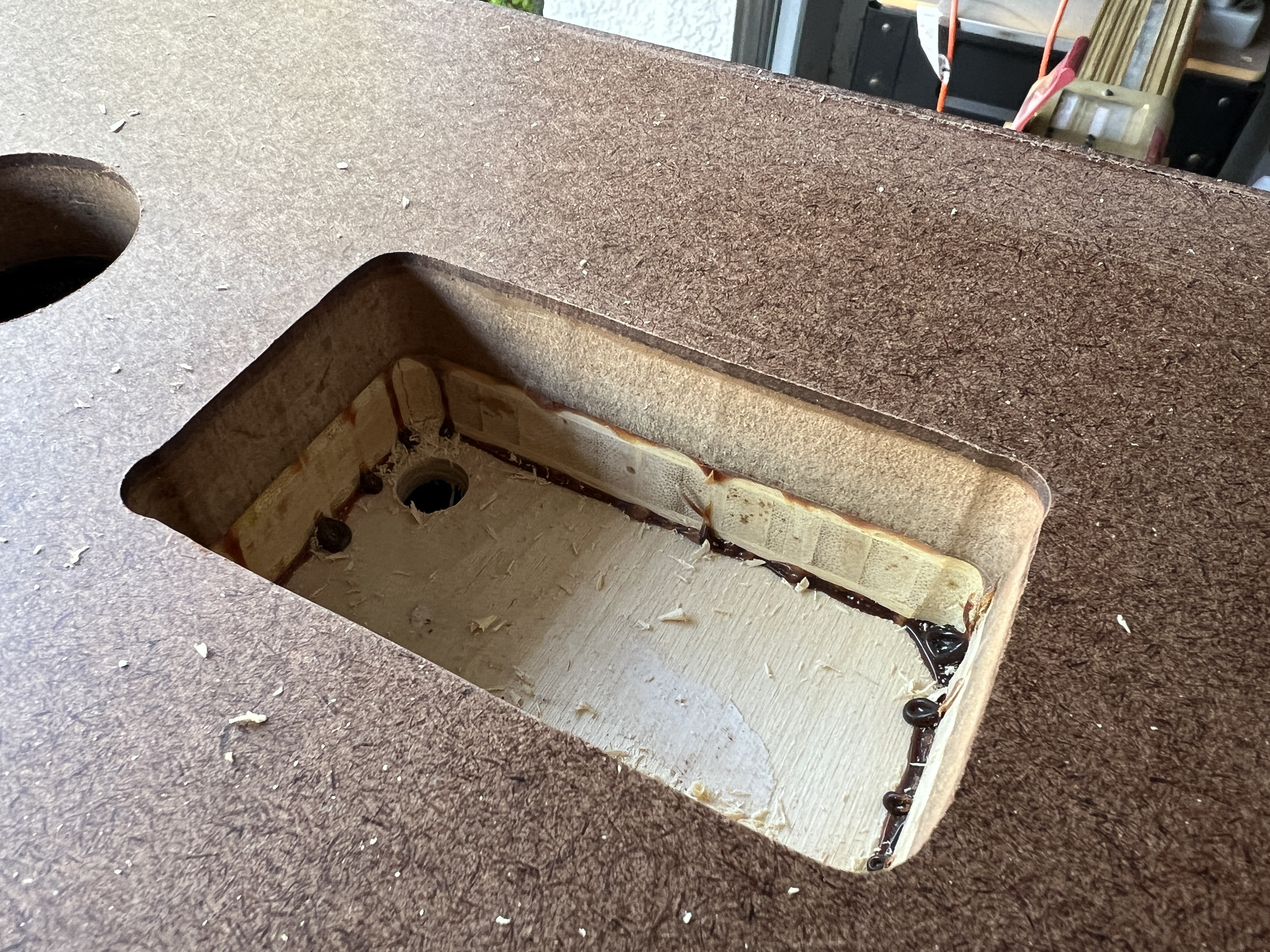

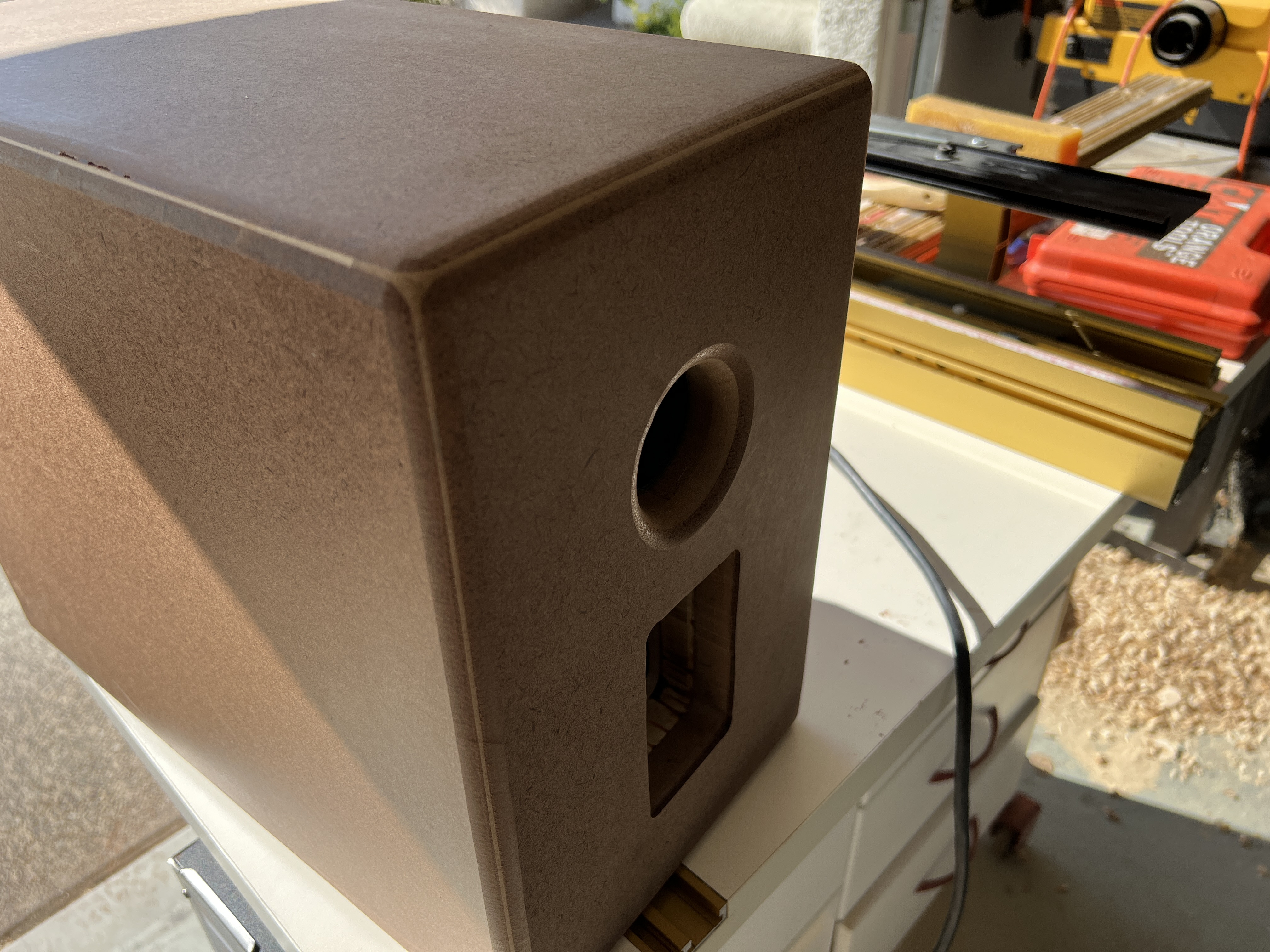

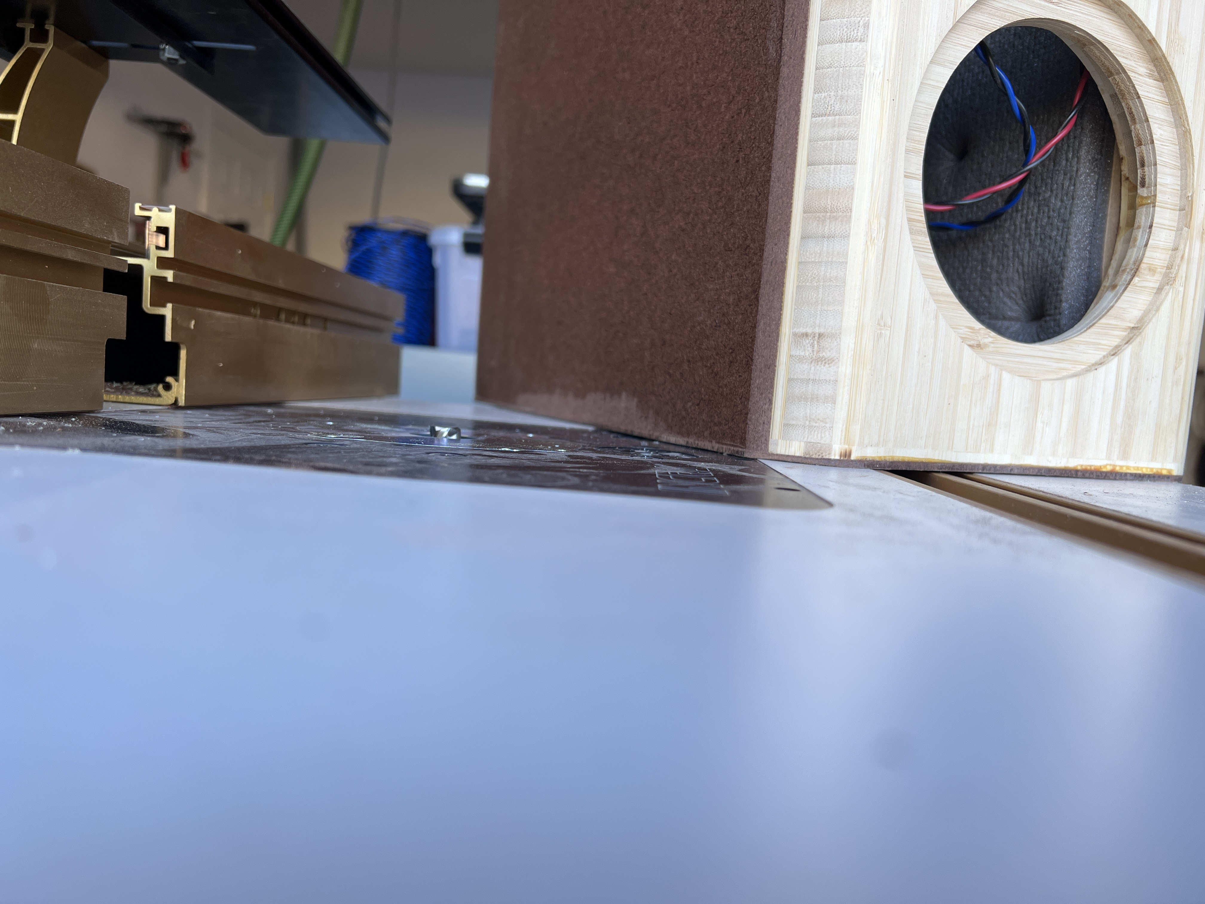

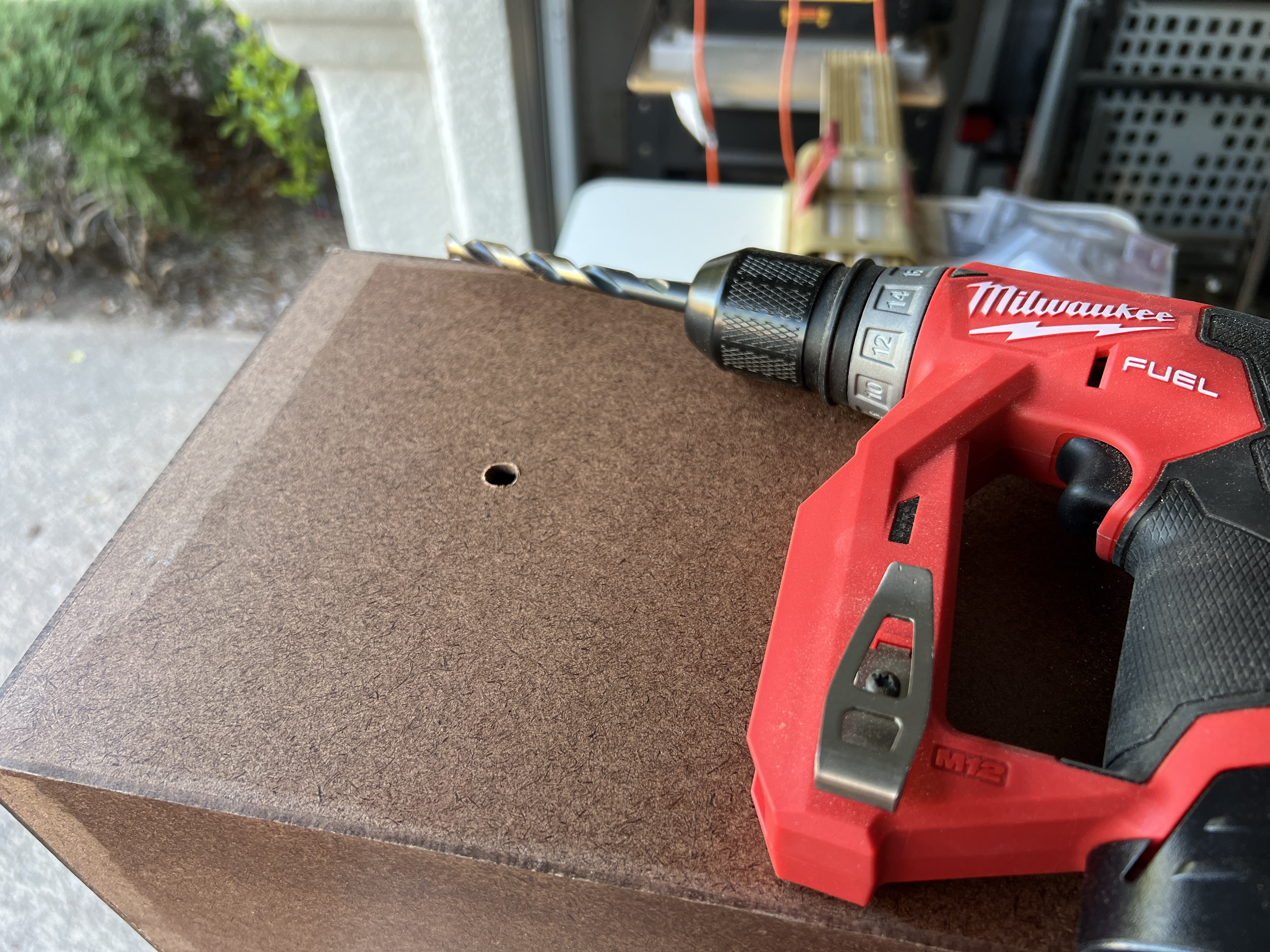

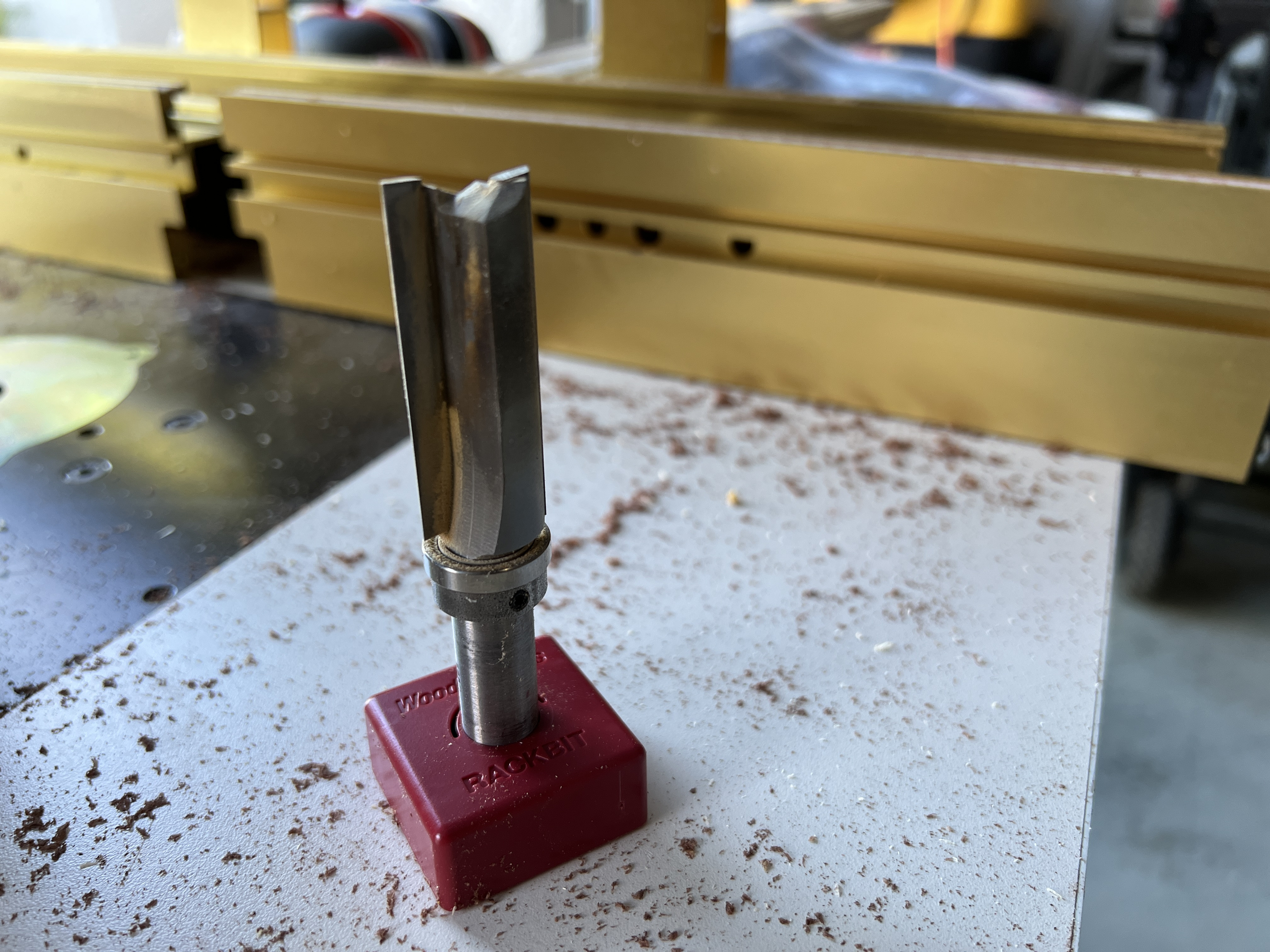

    After making this notch, I decided to open up the backside of the speakers to reveal the port and terminal cutout. I'm thinking about countersinking the terminal plate (a Dayton aluminum dual post plate) but I haven't decided how that's going to happen yet. It would need to be clean and even, so I can't follow the inside cuts since they were originally made with a jigsaw. Perhaps a coving bit and an edge guide, maybe?
    Click image for larger version  Name:	IMG_0990.jpg Views:	0 Size:	3.32 MB ID:	952570
    Click image for larger version  Name:	IMG_0991.jpg Views:	0 Size:	3.88 MB ID:	952571
    Click image for larger version  Name:	IMG_0992.jpg Views:	0 Size:	3.18 MB ID:	952572
    Click image for larger version  Name:	IMG_0993.jpg Views:	0 Size:	2.65 MB ID:	952573

      If your "repair" notch is centered in the cabinet width, why not fill it with dark walnut or similar to make a fashion statement.
      no matching of grain required.
        • 1033
        #93
        I did think of doing something like that - the notch is off center a bit, but it could be made centered - and I also considered a metal insert! I have a little cherry, mahogany, and purpleheart on hand right now so I could do it too. However, these are destined to be professionally painted so I elected to just fill it with a 'like' material since I have some on hand. Boring I know, but once we see the final color it will (hopefully) make sense!
